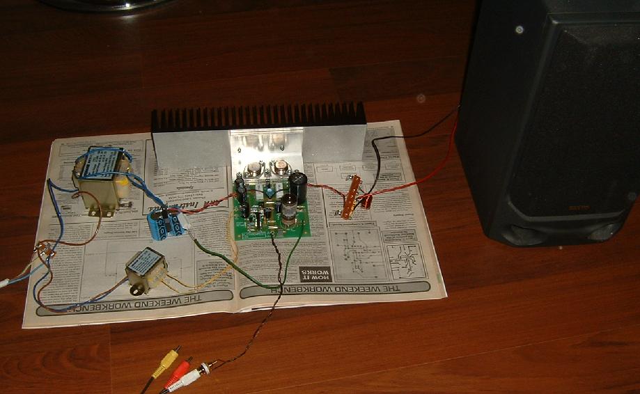

It works! - almost first time 🙂
I’ve given up on trying to get both amplifier channels working in the chassis this weekend.
The electronics shop local to me a bloody hopeless, with most of the misc hardware items I require out of stock.
So I just wired one channel up without the chassis, soldered in a 100pF Cdom cap, plugged it in, and turned up the volume.
Other than to set the bias current of the output stage and to measure the DC operating point and rail voltages, I haven’t made a single other measurement on the amp yet and it works and sounds great.
With the source plugged in the amp is absolutely dead quite.
The only hassle I had when I first powered it up is that the DC operating point was all over the place.
This was quickly tracked down to the fact that I soldered D5 in the wrong way round.
With all the pictures of the loaded circuit board I’ve posted here so far I’m a little disappointed that nobody was astute enough to notice 😀
When I get the amp installed into the chassis I will necessarily make some proper open loop gain and phase measurements to see how low I can go with Cdom while still maintaining stability into a capacitive load.
With the 100pF Cdom currently installed the amp is most likely overcompensated. For the initial testing I also wound an excessively large output coupling inductor just to be safe, but the amp seems to be perfectly unfazed running with or with out the load coupling network, into my crappy dusty Sanyo speaker from the shed.

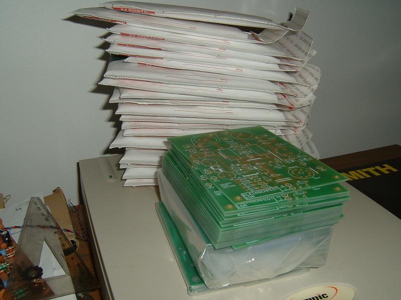

OK guys, I’m starting to get my act together. I’ve just finished researching the postage costs and will start replying to the received e-mails ASAP. I am very busy with other stuff, so please bear with me.
Today I received the remaining 30 boards (a lot earlier than I expected 🙂 ), along with the printed invoice, and I bought a bunch of padded envelopes.
Unfortunately I under quoted the price of the boards by a small amount, as I incorrectly assumed that the 50 board tally on the quotation I received included the tooling charges, which were listed separately.
The total cost for the 50 boards was AU$496.76
The cost for one board is therefore AU$9.94
The padded envelope is AU$0.90
For international postage I will be using Aust. Posts Express Courier International letter service, which is the cheapest letter service that actually allows tracking (on-line).
This service comes in at a flat rate of AU$11.85
For International PayPal payments, I will have to add 4% to the total cost to account for the 1.5% processing fee and the 2.5% currency conversion fee (all payments to be in Australian dollars).
That’s as cheap as I can do it without returning a loss!
Currently 22 boards have been sold via e-mail order, so there are 26 of the 48 remaining.
