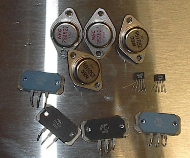

EDIT: A Goodwill expedition netted me a vintage receiver with 2 each 2SA627 and 2SD188. I guess I'll be using these. 😉
Hey, I found the datasheet for the 2SA627, but not for the 2SD188.
These parts seem to be obsolete, but fT for the 2SA627 is specified as 15MHz. Nice find. I had no idea that trannies suitable for low power audio this fast came in TO-3. I'm assuming that the 2SD188 is the complement with an equally high fT.
Be wary of a potential for parasitic oscillation if these devices are used in this design.
The data sheets are in the "Japanese Transistor Manual 1981", first Google hit would be Data sheet archive.
It lists fT as 10 for both.
These are obsolete, but I do a fair bit of "dumpster diving" looking for stuff that might have some quality components.
These were used for the Hiraga 20W Class-A amp, so they should be ok.
How to tame the oscillation if it occurs? Base stoppers maybe?
Here they are, with other goodies (relatively good anyway, for what they cost).
2SA705A, 2SD745A - 140V/10A/15MHz outputs
2SA798 50V dual monolithic high gain (250-1200) PNP
2SC2291 100V dual monolithic high gain(250-1200) NPN
The other usual suspects: transformers, heatsinks, etc.
