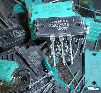

trannies suitable for low power audio this fast in TO-3.
Hitachi SB655A/2SD675A, 22MHz-100W TO3s, can be found in some Technics components.
Regular B653/B654/B655/D673/D674/D675 can still be sourced new, sometimes for $1.5. But they has lower Ft, Bwana.
Same goes for 14MHz NEC 2SB600/2SD555 TO3s, favored by both Mr Bongiorno and Madrigal ML untill the duo went obsolete, used in several Technics receivers.
For some reason Technics always fancied using exotic stuff, especially NEC candy.
Speaking of candy, apparently Toshiba initially bought the RET technology from Fujitsu, later released their own 2SA1095/2SC2565 ringemitter development to compete with Sankens LAPT devices.
