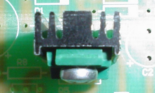

I'd still mount a heatsink tab on the VAS transistor. Dissipating 1W the TO-126 does get pretty toasty.

G.Kleinschmidt said:toasty.
Yes, master.

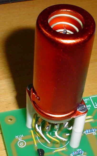

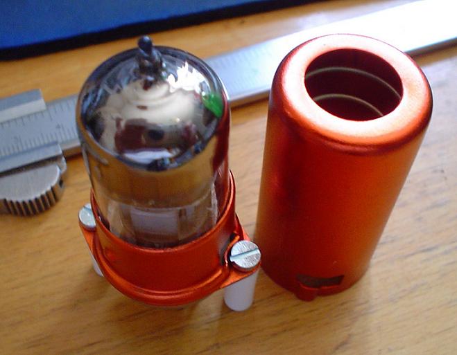

Even a regularish heatsink fits, only R1 needs a bit of a bender.
The idea is to have the valves protrude out of the case for about 1 1/2" and the covers conveniently hide the real identity of the Russian Y-Offs.

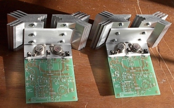

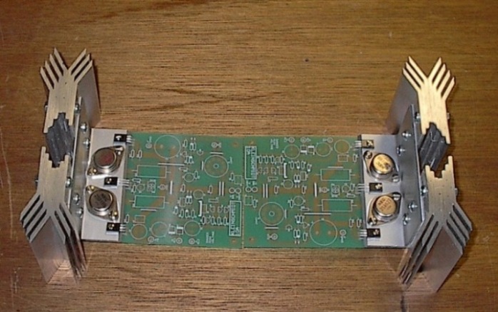

MJL21193 said:Custom heatsinks built, outputs installed.
Nice! 🙂
Not a lot of surface area though, so it might still get reasonably warm.....
The fins of my 300mm X 75mm X 48mm heatsinks reach about 15 deg. C above ambient directly opposite the mounting bracket.
Glen
Nice! 🙂
Thanks, made to look cool, but get red hot
No, there's more to it. I want these for the "sides" with a bottom plate and a top plate that is 3/16" aluminum and will join with these. This will increase dissipation.
As you have already done the hard part (design, layout and board), I will concentrate all of my efforts into the chassis.
