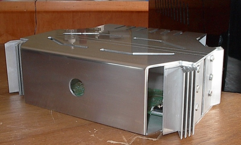

jacco vermeulen said:Oh, look see who's got a bench brake that handles 5mm alloy.
Pretty spacey, nice cornering.
Thanks Jacco,
I can't take credit for the bends - it came that way. A scrap angle - 36" x 11" x 8". No charge. 🙂

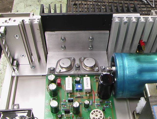

gain said:where did you all source the heat spreader the two TO-3's are mounted to? thanks.
I cut mine from a 2" x 1.5" angle. More scrap.
I think they sell aluminum angle stock at Home Depot or others.

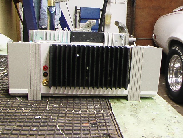

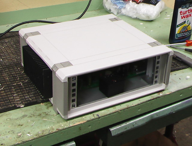

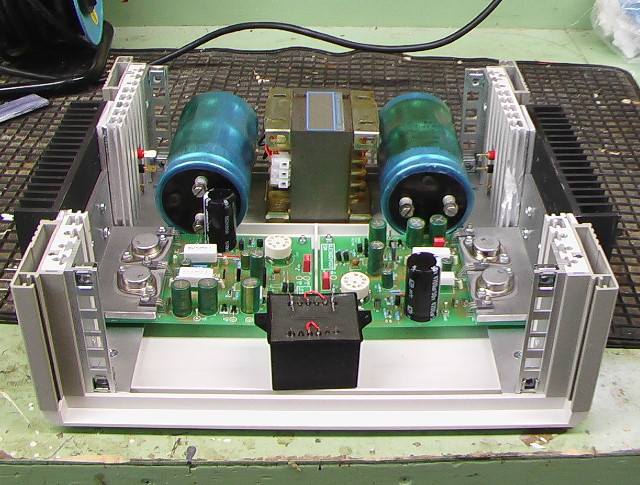

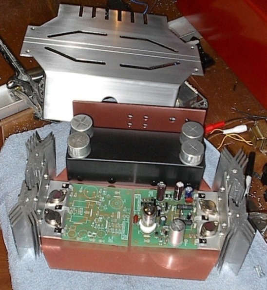

Some going on pictures
Hi folks
Here is some going on progress pictures. 🙂
Sorry for all other disturbances from my garage. I have just layed the transformers and electrolyths around to get a picture of what it eventually would end up in
I think it looks pretty good so far and maybe I can stress someone more in his building of this cutie 🙂
Besides the black heatzinks, everytning on each shortside (gable ?) is aluminum that serves as heatzinks.

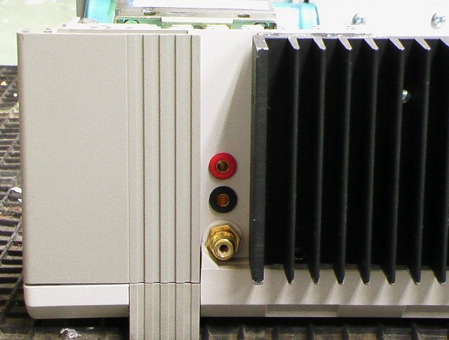

Looking good Radioman. 🙂
My only complaint is that the input RCA is a wee bit close to the speaker terminals. Make sure you wire up the input jacks with screened cable, and don't forget to stuff the inductor and Zobel behind those bananna sockets.

Yes, I can see what your after ...
It was the extensive milling process that got my brains memory dizzy
I dont think this will be any problem though. I have allready planned for screened cables for the inputs. Also, the bottom and top lids are all plastic.

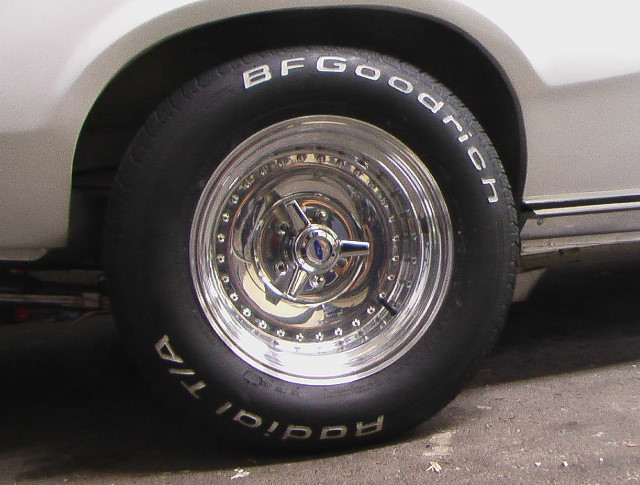

I didn't quite understand your answer about the wheel rims ...
Why can't you have american wheels on your "383cu in machine"? What kind of stupid machine is it ... any way 😀 For me "383 in" is the size of the engine and have nothing to do with the rims and tires.
Sorry, I may be a noob when it comes to cars from down under 🙂

Becaussseeee the wheel studs are on a metric diameter of 120mm and the holes in the Yankee wheels are on a 4.75" diameter which equates to 120.65mm.
And no, this has nothing to do with the engine capacity, which is actually a little over 383 cu. in. as the cylinders have been bored 40 thou over. The Australian built engine had a factory capacity of 308 cu. in, but I modified it a wee bit 😉
BTW, why are you are driving around in a puny 351? 😀 Or is this girly car for your wife?

I have one board populated and did a LOT of chassis work. Metallic painted copper on the inside. Black (handmade) steel box is where the 2 24V transformers will go, plus the new 30V.
I expect it will be some time yet...
