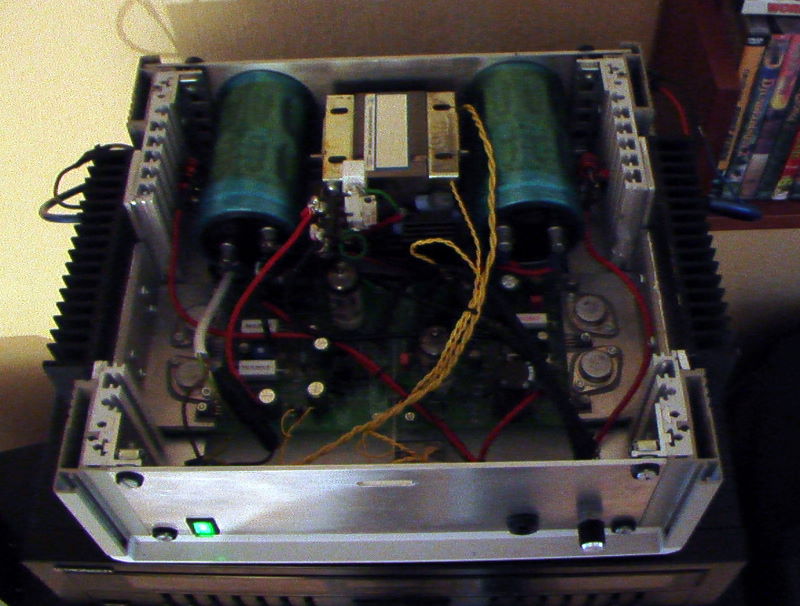

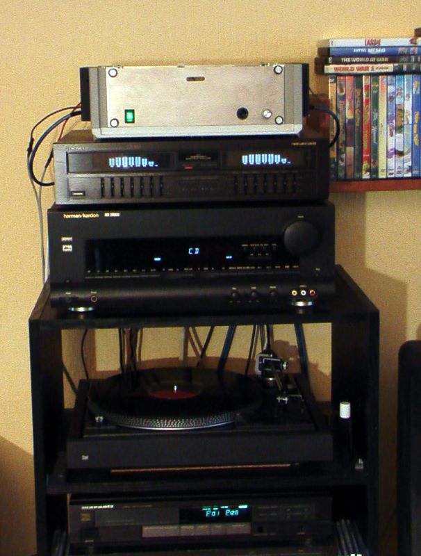

Hi all amp builders
I just wanna brag with some more progress 😱
I'm finished with the EM84 installation. Another baby transformer back to back connected to the first one.
Anybody interrested in the schematic I can show you here if you want.
I'll throw two teasing pictures at you. Next time I will have some measuring figures I hope 🙂

Looks great Ove!
How does it sound? What are the speakers that you are using?
I'm not even close to finished with mine. I don't have a pair of nice efficient speakers to use with it - a future project, no doubt.

I use some old speakers I built myself about 16 years ago. Modded with some, now classical, vintage oil cooled Dynaudio tweeters later on. Its 3 way 5" middle and double 10" basses. About 100 liter closed boxes. I don't have the data but 92-96 dB one meter.
For the moment I use some real small monitor speakers that sound quite impressive for their size. I bought them at a HiFi exhibition two weeks ago. Dynavoice Magic S-4 EX

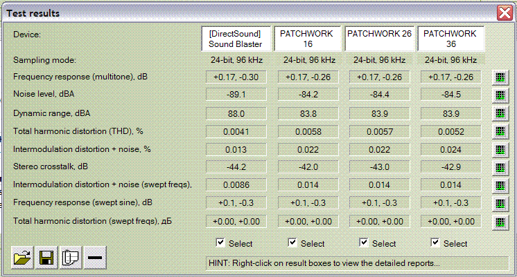

Today I also dis some measuring with the Rightmark tool I mentioned earlier.
I did a -1.5dB loop trough test. The only difference between audiocard and the amp was that the Kleinschmidt had 8 ohm resistive loads. The card burst out a sinewave in half second bursts every two seconds or something as the testsignal to adjust levels
Maybe I can get better sn. ratio at higher volume? Crosstalk is not the strongest either. I havent done any real serious test with this setup before so I can't compare. I have to tests some more amps so i know if I can be satisfied with these figures. Anyway, the amplifier sounds really good and the distorsion comes on smoth when it clips.

The measurement that you took don't look right. They show Glen's amp making an unholy racket!
Did you use a high output impedance attenuator for the soundcard input from the amp?

I used no attenuation at all at the output. Just trimmed the input volume (from the schematic) so that the output would be in par with input level.
I can see that it's not fair.
Is it fair to put out maybe 1 or 3 watt in 8 ohm and then attenuate it to be in par with the output at the soundcard?
Does the attenuators impedance influate that much on the results?
Which effect did you measure at in your tests above?

I think I used an voltage divider/attenuator with an output impedance of ~100 ohms. I tested the amp above at nearly full power - 140 watts.
I just measured the output before I connected it to the soundcard. There is always a risk, and I burned out one soundcard already.
