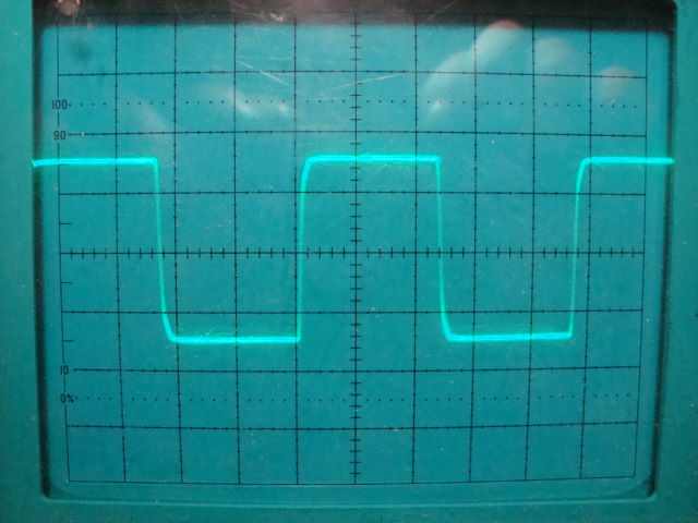

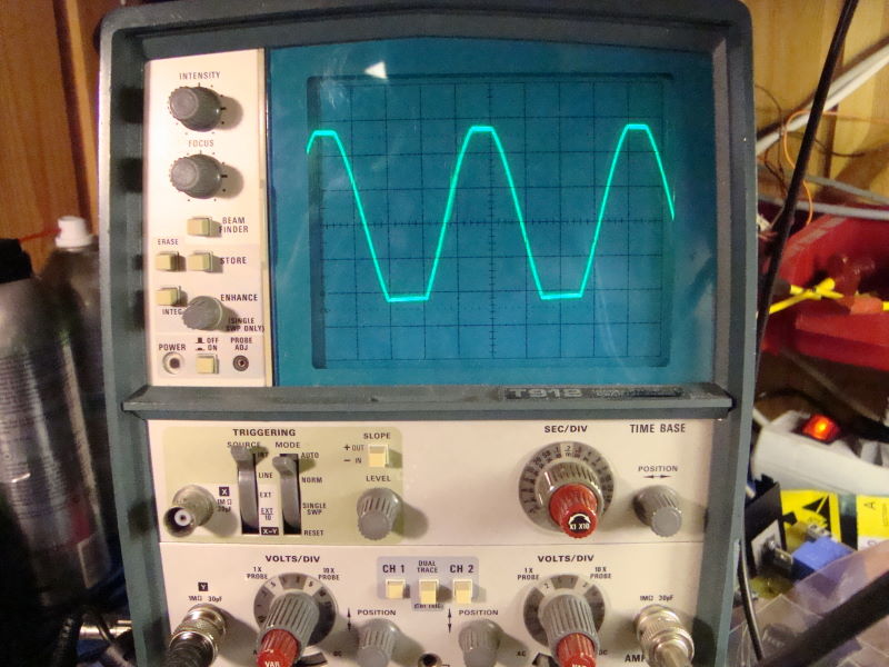

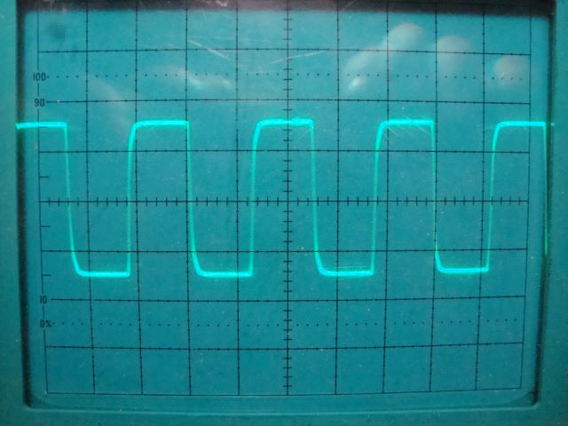

Operating. It has an amazing-to-be-working Hitachi Hitray tube that I scrounged out of a table radio from the early first half of the last century.
Typical sine wave at some lower frequency. Clipping is nice, but starts on the bottom first. Not sure able how much idle current there should be. This was at ~900mA/device. Too high? Too low? Glen?
Pretty sweet squarewave at 20kHz.

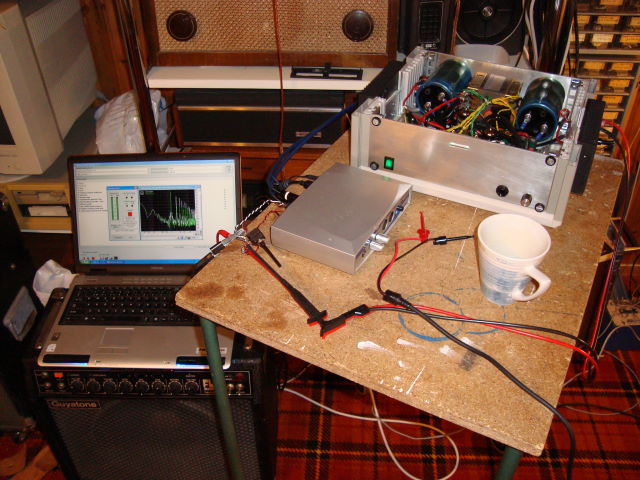

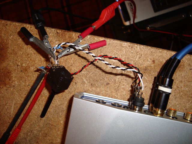

I have done some more testing and have nailed a kind of "standardization" so that I can compare with other projects of mine.
I use the amps volume (or the card) to have 1W over 8 ohm at the output. Then I attenuate the signal to have the same level at the input as the output from the soundcard.
Maybe a hard and unveiling test but at least I tell how I got the figures. This time a little better then the ones I presented above.
I will soon make a new link at my homepage about all projects, where I will present my strugglings testings and projects in a more uncluttered form 🙂 This year I really got into DIY audio, up the ankles and more lately
. I have to many unfinished projects right now. This one is the third near finished audio project this year
There will maybe be one or two more I hope. As you can see in the background there is more stuff in my cellar
I will present figures on my homepage, maybe next week. For the moment you can have some more pictures.
No coffee in the mug 🙄
My "standard" paralelled 16ohms 1/2W for each cannel)
Inside again
Klein10 clipping at 1kHz on my good old Tectronix 🙂
10kHz squarewave
20kHz squarewave
Oh, my card just gives about 765mV rms (0dB)MJL21193 said:Sorry Ove, I didn't see this. My amps input sensitivity is 1.2Vrms so the sound card can drive it close to clipping.
I have also clipped on a heatzink on those VAS's. I can touch it for a second or two, so maybe 55 degrees?MJL21193 said:
I assume that Q5 is the VAS, and it's running really hot. I put a small sink on it and it's still cooking. This normal Glen?
With my Sovtek there is nearly no thump. But with my Philips and Telefunken a really brutal "knmphh" The Sovtek also measured best dynamic compared to all other tubes I tested. My NOS ECC803S was worst ...MJL21193 said:
It has a brutal turn on thump. I guess it's the tube lighting up?
Inside again
10kHz squarewave
20kHz squarewave

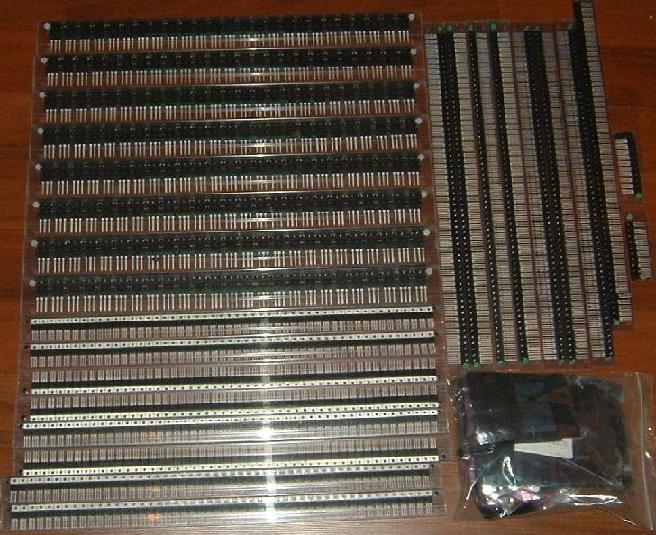

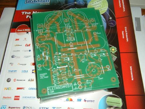

Ancient-thread resurrection. Have been cleaning up and sorting through my stuff - still have 6 pairs of boards left that are of no use to me.
This wasn't a for-profit adventure so I guess I'd be silly no to try to sell the rest of them.......
This is the best sounding hybrid amplifier on Earth, and now the entire universe as well as I've degaussed the remaining PCB's and cryogenically treated them in my freezer.

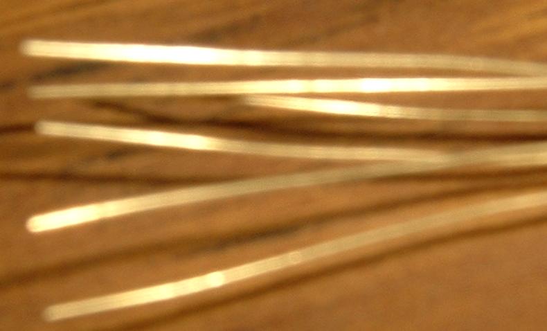

3 pairs left!
I'm degausing the gold-plated wire for the last three lucky buyers!
I will take 2 pairs. email sent
jim
- The Kleinschmidt 10A
