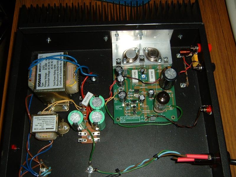

OK, I'll do that as a last resort. Anyway, the amp is singing away nicely. Expect at least some scope shots sometimes late tomorrow.
Glen

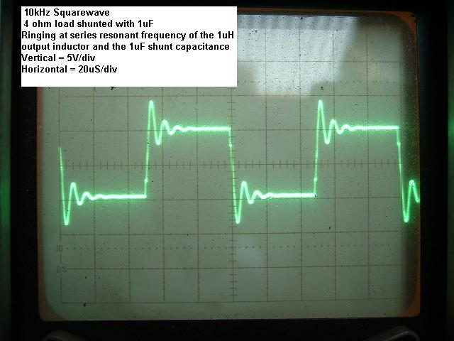

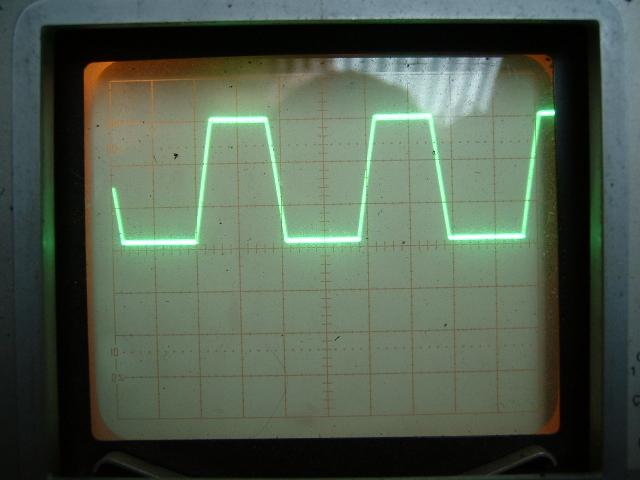

Finally, a 10kHz squarewave driving 4 ohms in parallel with 1uF.
The amp is unconditionally stable. The ringing is at the series resonant frequency of the output coupling inductor and the 1uF shunt cap + the 100n hybrid Zobel cap across the speaker terminals = 1/(2pi*(SQR(L*C))) = ~152kHz.
All squarewave testing was done without the input signal bandwidth limited and a 100pF Cdom capacitor.
