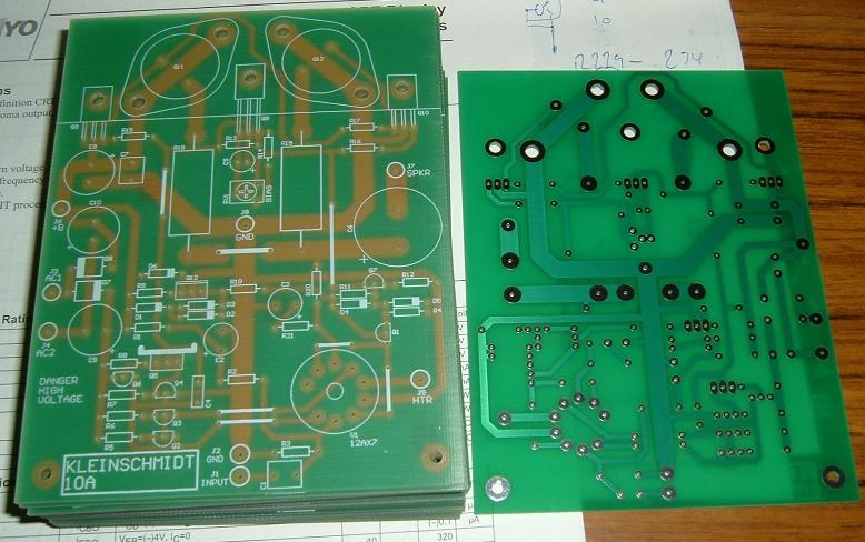

Guys, some good news and some bad news.
I got the boards today, but not without some hassle as they were sent to the wrong address, even so I explicitly stressed my preferred delivery address to the manufacturer over the phone just yesterday well before dispatch. 😡
And there is another problem. In my original e-mail to the manufacturer I requested for a quotation on the manufacture of 20 boards. As per the company’s usual procedure, they replied with a quotation for not just the manufacturing cost of 20 boards, but 30,40 and 50 as well.
When I rang the manufacturer to verbally confirm my acceptance of their quotation and have the job go ahead, I requested the 50 board option. However, this request was not fulfilled and I only received 20 boards.
I will see what I can sort out over the phone tomorrow, but since I only confirmed the 50 board order verbally over the phone, I may not have much success.
I’m really sorry about this, but unfortunately I have to warn that a few of those last to put their names down last on the list may have to miss out. 🙁
Now, on a more happy and productive note, the boards are of excellent quality and I will be posting up the beginnings of the webpage devoted to the design later tonight (if I get time, otherwise tomorrow night)
This will start with a comprehensive schematic incorporating most component values as well as the off board L//R+C combined output coupling and RFI suppression network that I recommend the amplifier be used with, as well as input signal RFI filtering at the input jack, used in conjunction with an optional volume or line level control potentiometer.
Glen

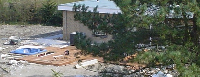

After a 4 year struggle, my classic-Bentley wrenching building inspection head dude at city hall stated last week that likely by the end of the year it's finally permitted to have the swimming pool overhere covered.
Fortunately, with a nextdoor neighbour having a whirlpool and sun terrace construction in progress, there's always a substitute to annoy me.
Cheers from the home reno front.

You're a gentleman Jacco. But lets see what I can arrange with the PCB manufacturer tomorrow.
Here is the link to the webpage:
http://users.picknowl.com.au/~glenk/K10A.HTM
Not much yet but it is a start!
I will do my best to get the first unit fully built and tested over the next several days.
Glen

Really nice cards 🙂
This could be great fun when we all start to compare our different aproach to this build. Case, outside components etc.
I'm trembling like a child in excitement
OK, good news on the boards. The tooling is being reused and the remaining 30 are being made for the originally quoted price.

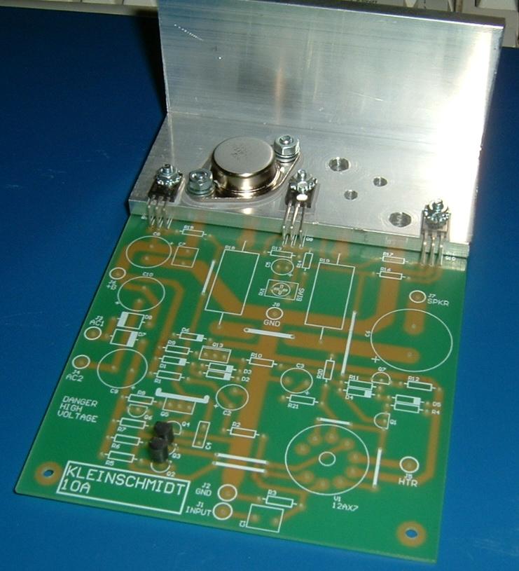

Progress report:
I had the opportunity to cut and drill the heatsink bracket this afternoon.
I used 6mm thick aluminium angle. I would have preferred to have mounted the PCB on one of these….
http://www.altronics.com.au/index.asp?area=item&id=H0538
6mm flanged heatsinks, but the supplier local to me was out of stock.
Anyway, tomorrow is Saturday and I will be able to spend most of the day working on it.
Glen
