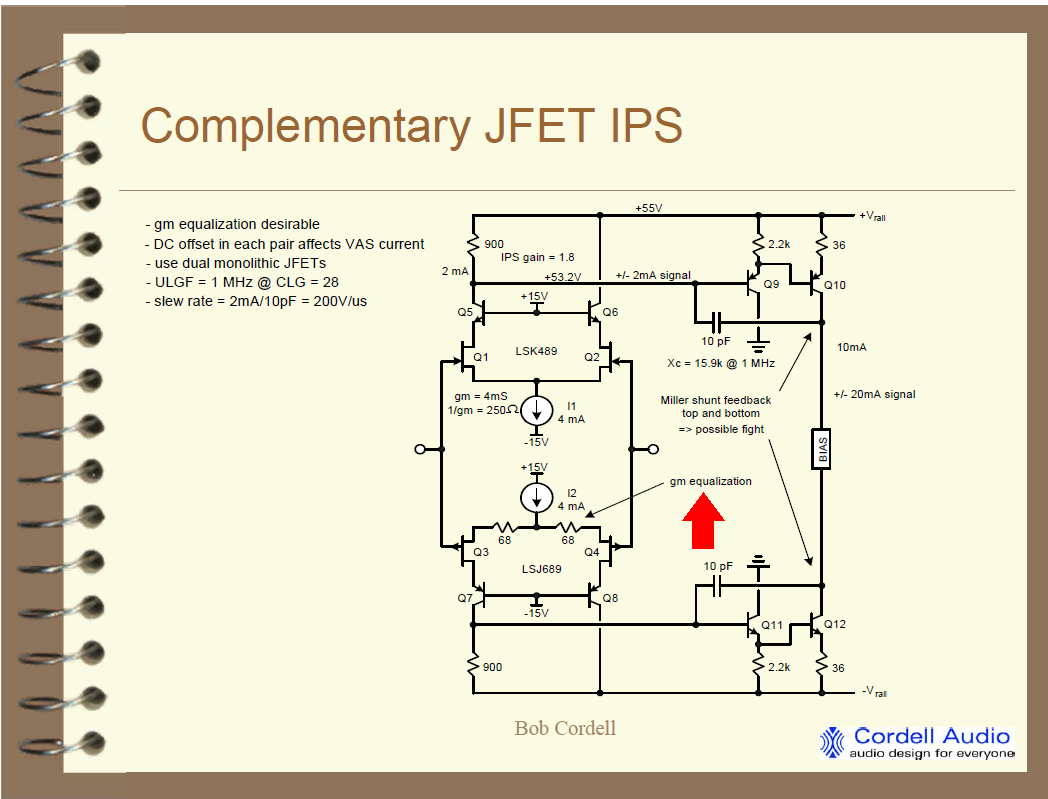

The JC2-HPA Headphone Amplifier
Watch Bob Cordell's presentation at Burning Amp 2016.
YouTube
Starting at 36:31 , he covers the JC2 circuit and at 41:30 he presents a very handy trick: forcing the NJFET transconductance to match the PJFET transconductance using degeneration resistors. And then he explains why.
At 43:10 he credits John Curl for the floating tail topology.
_

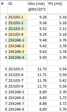

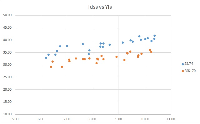

... How easy is it to find a matched quad?
Depends on what you're matching. Idss only to a few % is doable, Idss AND Yfs (Gm) is another story... Attached is some 50-ish I have, probably fakes. Each dot is 1 unit; you can clearly see the difference between sexes.
That's why I have my plan B, using only 1 N and 1 P per channel.

I wonder if you've had the opportunity to look into the (2S)J103 (2S)K246? They're cheap and plentiful, and Patrick (EUVL) said they're 3x noisier than the J74/K170: if we assume 10-12 nV/SQRT(Hz), we're still looking at something like a uV or 2 over a 20 KHz bandwidth, or -120dB for line-level applications, good enough, right?
Hey Scott, thanks for joining the fun.
Temporarily I'm not doing much, from the data sheet the noise would be a little lower than that but for line level fine. I'm using the N-Channel part in Bob's presentation as a MM phono input. Neither Bob nor I have seen the -60dB THD that PMA showed from a single long tail pair, more like -90dB.
In case you have not noticed Linear Systems has been trying for years as a serious business, it is NOT easy. No offense intended but you do not understand how this industry works.
Scott, no, I do not. I was in the aerospace industry where copying is more difficult. I am an outsider. I admire your work on the AD797 and appreciate your participation on this forum. I wholeheartedly support IP protection.

Unfortunately, Weilliang was not aware of that when he did the E4 PCB layout. If I buy the E4 kit, it will take some minor surgery of the PCB to add the degeneration resistors. It is doable.
The Sherwood S-6040CP power amp has complementary differential input using the 2sk270a/2sj90a pair. The input has 100 ohm degeneration resistors on all four jfet. Will that make the matching easier?
> BUT the matching between N and P is BAD!!!
If you are using them at 2mA as indicated in your spice files, then the N-P Idss match is of NO importance.
This applies equally for individually CCS biased IPS, and for floating tail.
Since you can spice, I'll leave you to find out how this works.
On top of that, if you use the source degeneration resistor, the Id will be reduced even at Vg = 0V.
Measuring Idss does not tell you the whole story.
FETs perfectly matched at Idss of 8mA or 11mA Idss do not always match (for Vgs) at 2mA.
If you want perfect match, you should always measure under operating voltages and currents.

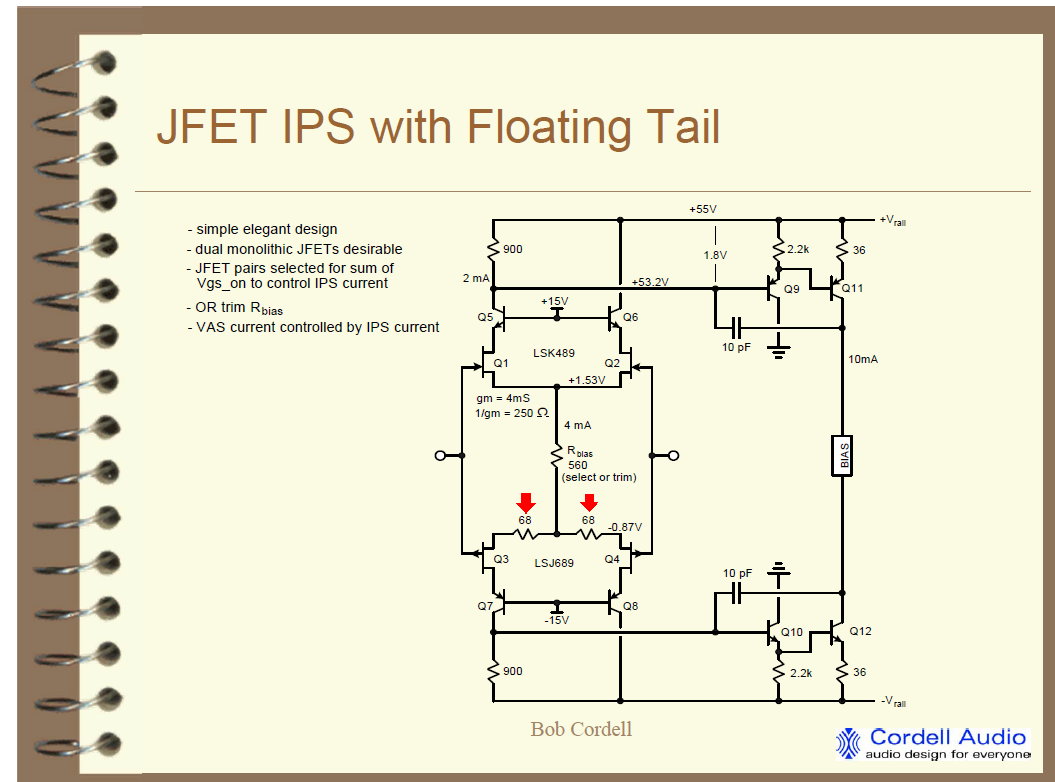

What he did not say is that the floating tail actually gives low distortion than 2 separate CCS tails.
It took me >10 years to understand why.
They have actually told you already in the datasheets.
If you want perfect N-P match, use 2SK163/2SJ44.

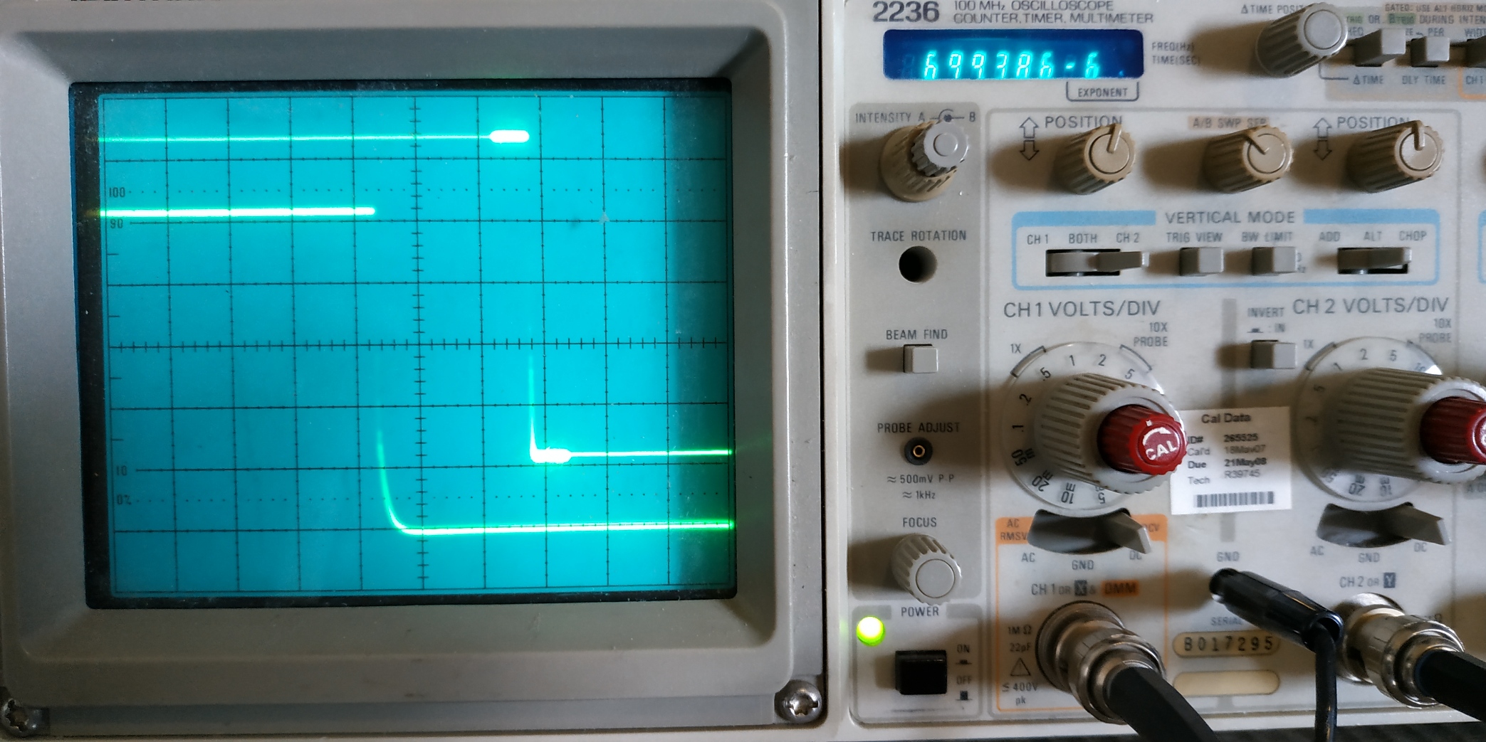

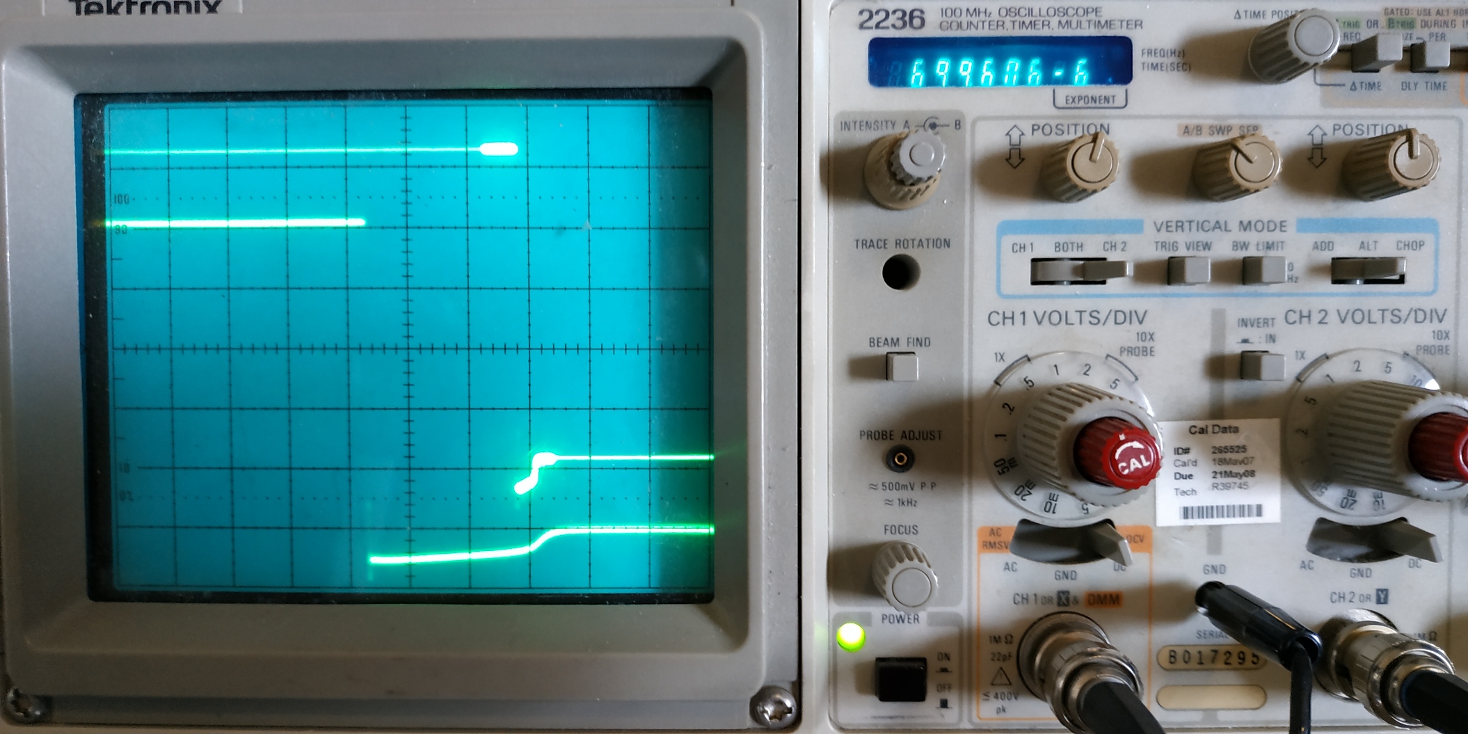

My Quasimodo is 90% up, so I tested some diodes/rectifiers with it:
  • SR520: Schottky, 20V 5A
  • FR608: Fast, 800V 6A 150 nS
Conditions: Drain of the MOSFet (Rs = 4.7K) -> Diode -> Load (4.7K) -> Scope.
I take the Schottky anytime.

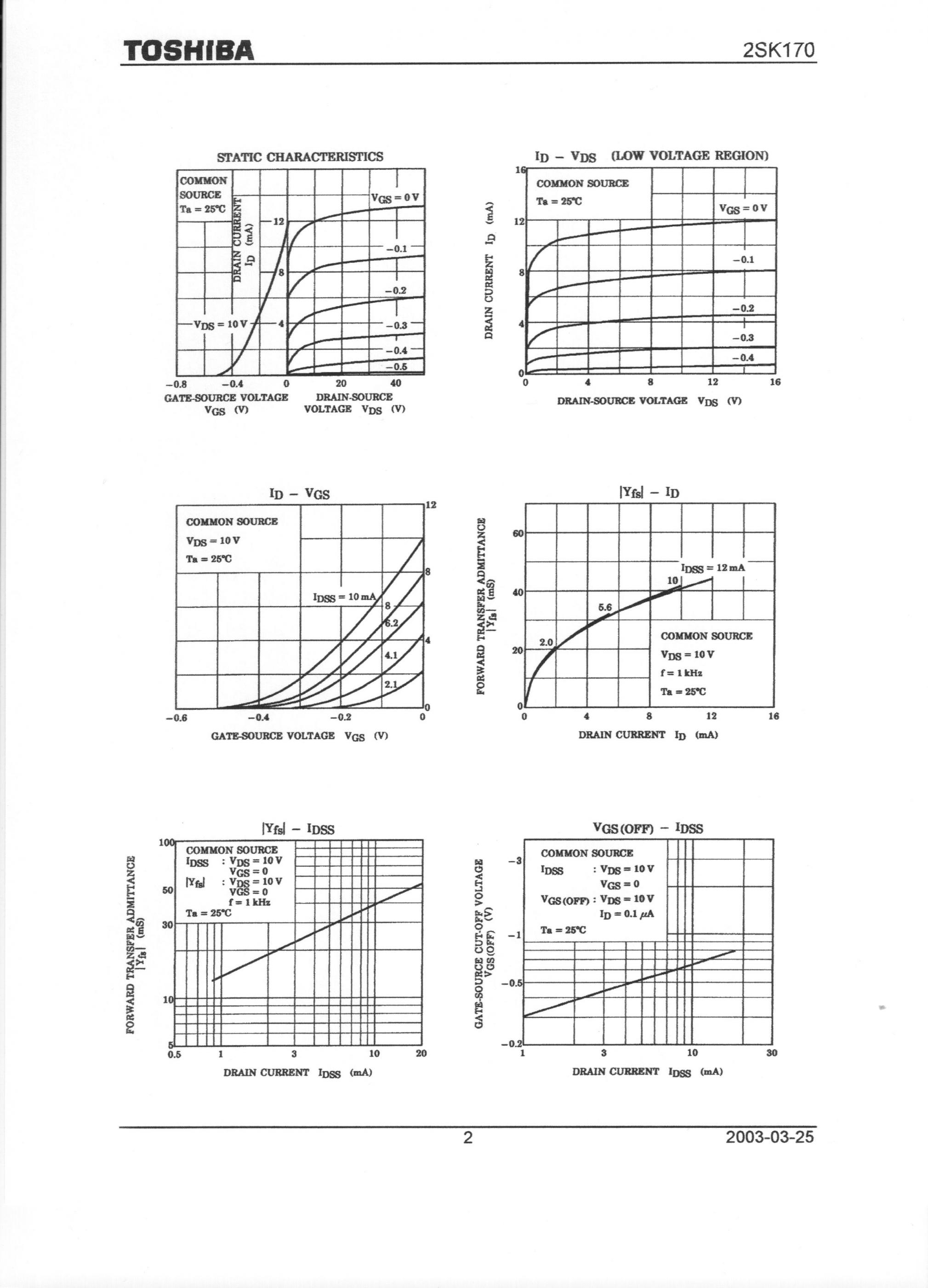

Hi everybody! I have finally found this nest of inputs regarding some of my stuff. I have learned from some of your inputs, especially in power supply optimization.
I don't know if I want to address everything I have found, but perhaps in the near future.

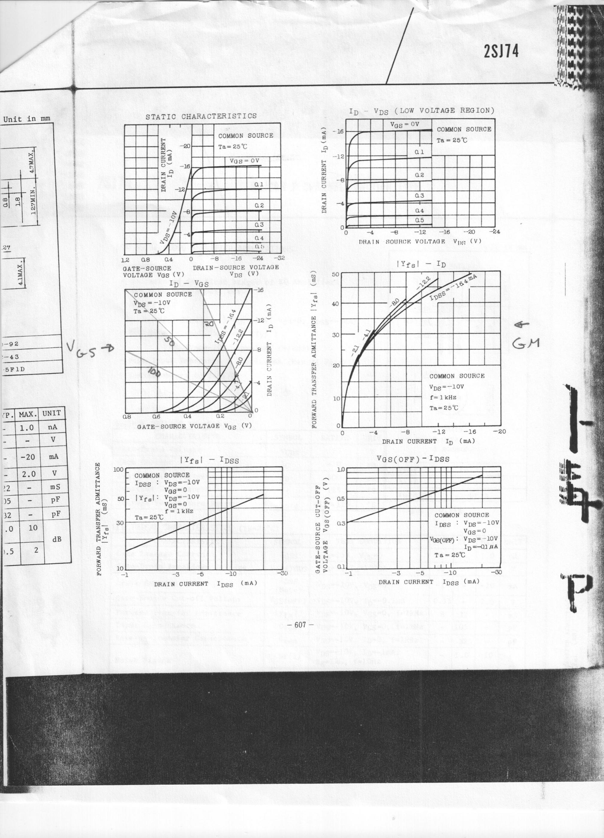

Zung, you probably have fake jfets, the n and p Toshiba devices should be almost exactly the same for Gm. Yours differ. (for example)
Scott, you should more carefully check the data sheets, before challenging me. MY Toshiba handbook shows at 4ma: 28,000 for the 2SK170, and 29,000 for the 2SJ74. It is the CAPACITANCE that is so different.
