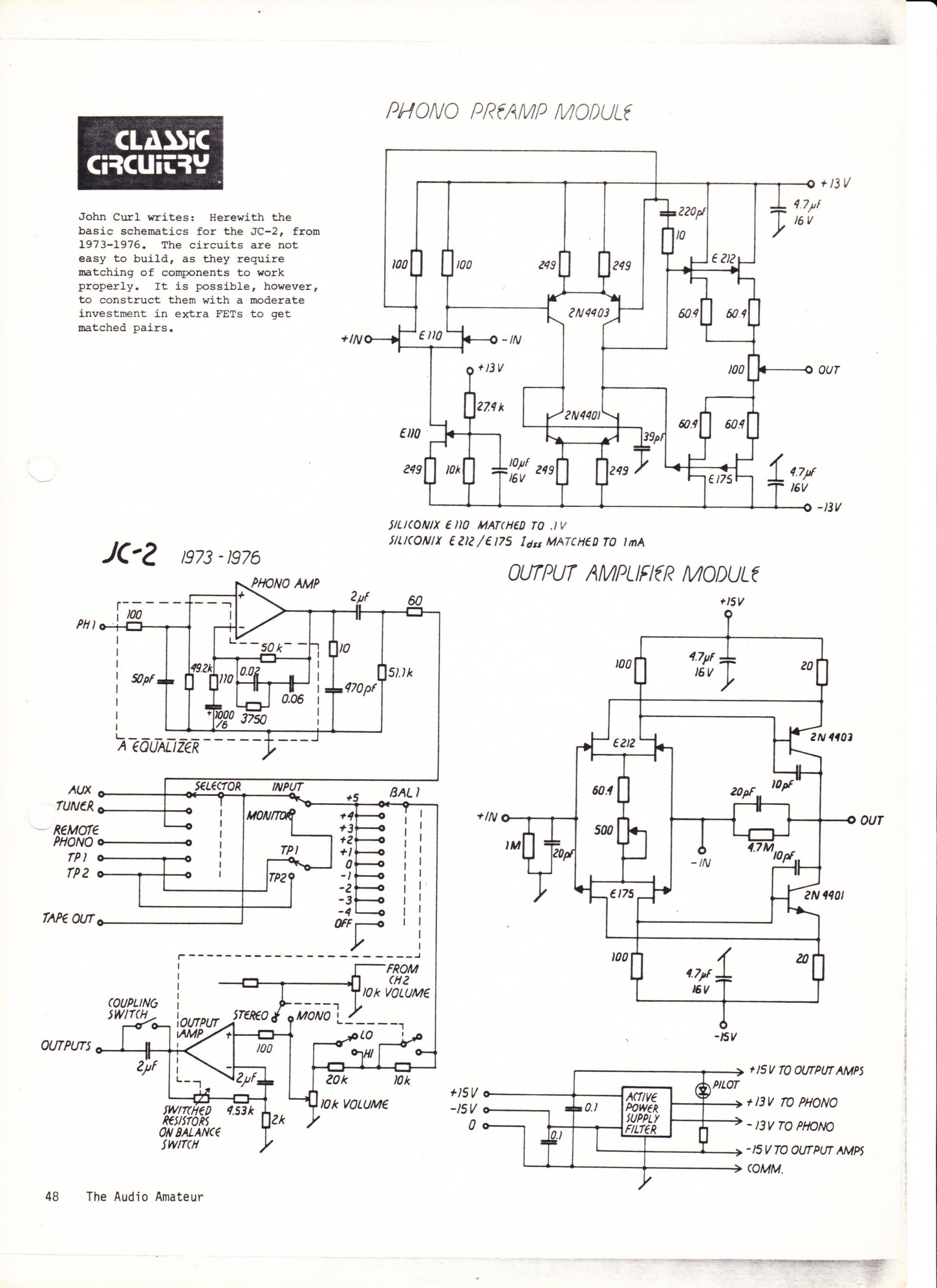

What I find interesting is this: look at the attached schematic of the JC-2 John Curl published in the Audio Amateur in 1977, after some issues with Mark Levinson: the E5 is very similar to the phono amp, top, and the E4 looks a lot like the line amp, bottom, with an output stage added.
The E5 is based on a very common topology; the Marantz 15, from 1966, is a nice example, with BJT at the input. It's something that's (relatively) easy to get right, and suited for mass production, especially in the mid-fi area where it dominates.
The complementary differential JFet topology in the JC-2 line amp and the E4 is a totally different story: because of the fundamental difference between the N channel and the P channel, a perfect matching is impossible, as I've shown previously. And even a near matching, using Idss only, takes a lot of time and effort. Because of the difficulties, you only find them in the high end stuff.
So, I'm not surprised the E5, designed to be buildable/sellable, could sound better than the E4 under the same circonstances: it's easier to get right.
However, the E4 kit appeals to me because I think it has more potential for improvements, as shown in the link EUVL provided above. Consider it as a low cost starting point into the hi-end, hopefully, by playing with the operating conditions, the components, the supporting circuitries like the power supply and so forth. The only constrain I see is the layout of the PCB: it looks OK, but as of now, I don't know for sure if it's really up to my expectations.
Coming up next, I'll look into some details of the circuit.

It is interesting that you found the E5 to be better sounding than the E4. Does that mean that the Marantz HDAM input topology is better than the JC2 dual differential jFET? They have different driver stage too. Is it the driver stage that makes the major difference in sound?

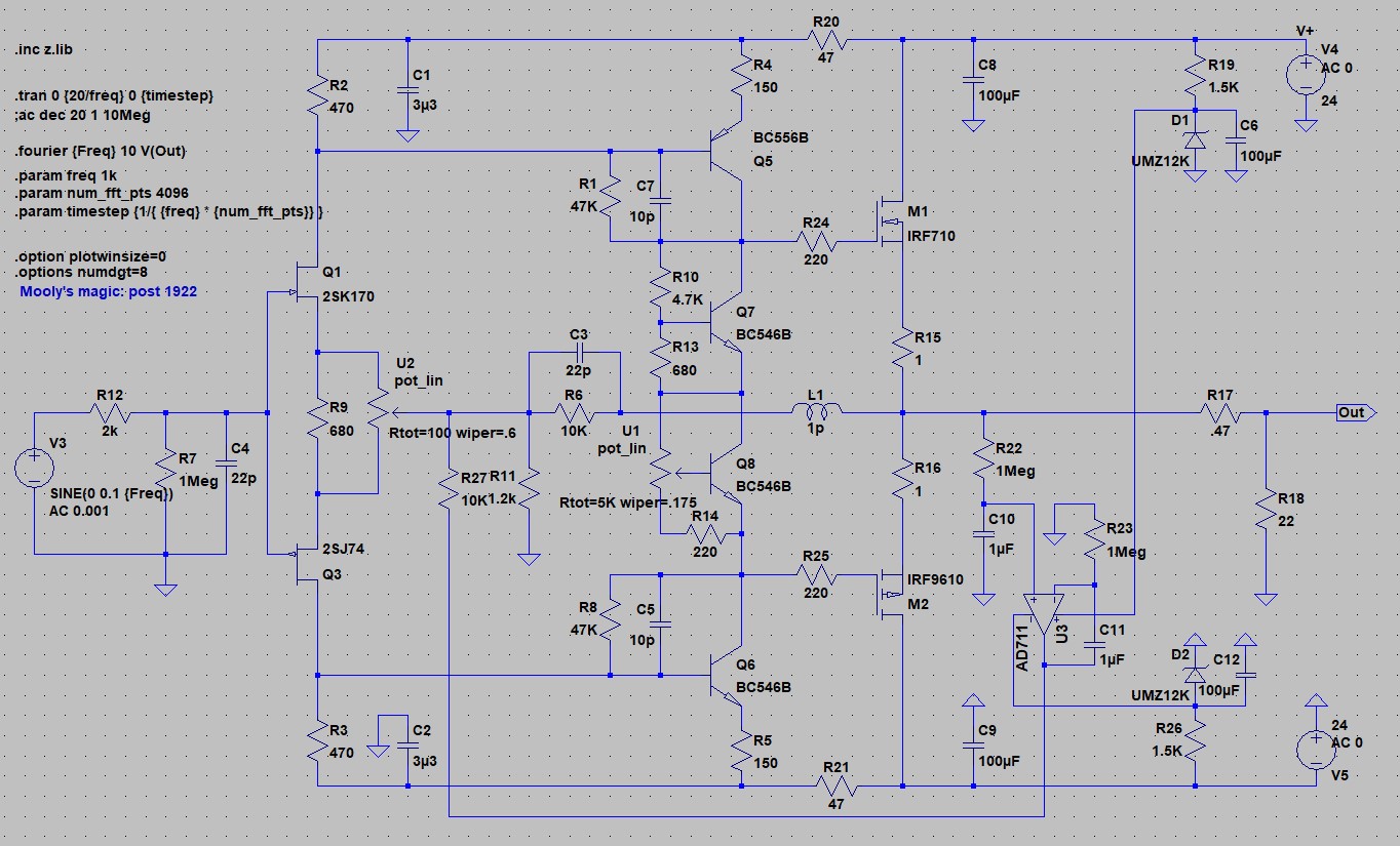

Good enough for sure. But if you want to go this way, you should consider using half of the input stage at half the cost.
Before I knew how well the Fets are matched from this seller, I had a plan B like this.
Does complementary input sound better than differential input? You mentioned earlier that it is easier to match N vs. N-channel than N and P-channel.

Does complementary input sound better than differential input? You mentioned earlier that it is easier to match N vs. N-channel than N and P-channel...
See above.
If you have to go the differential route, it can be good, and even better with dual Fets. I once used the 2N5566 with satisfactory results.
