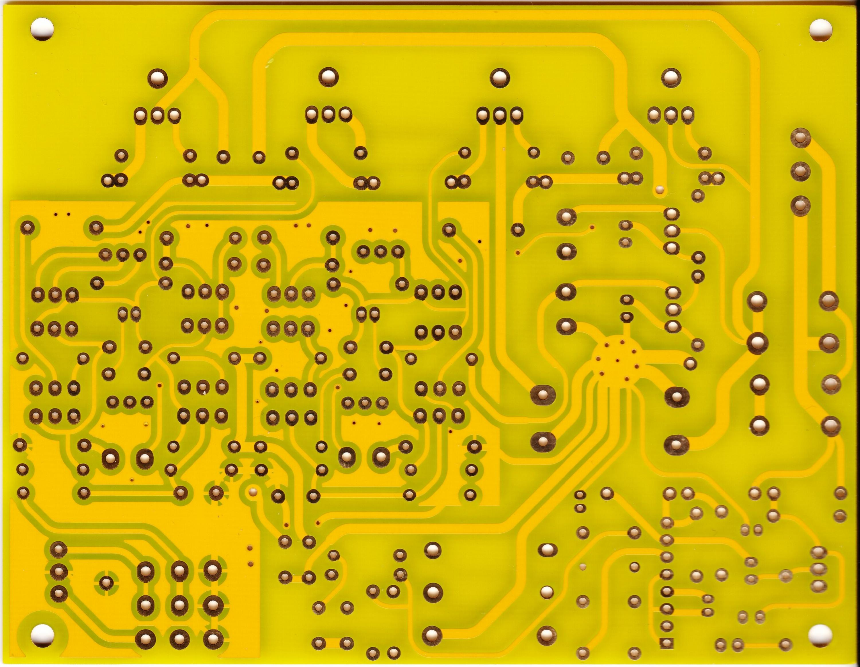

THE HPA: the PCB
For those of you who plan on messing with the circuit/components/etc, here's a scan of the PCB. The BOM I uploaded previously has the pin spacing of the 'lytics (labeled "Pitch")

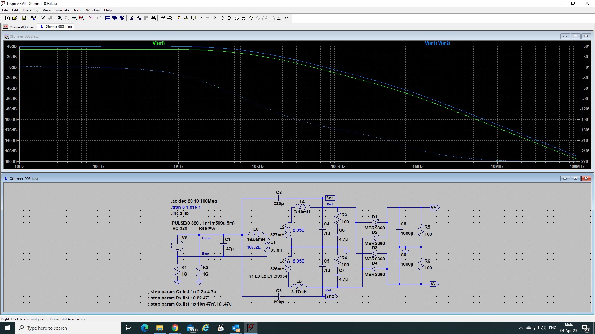

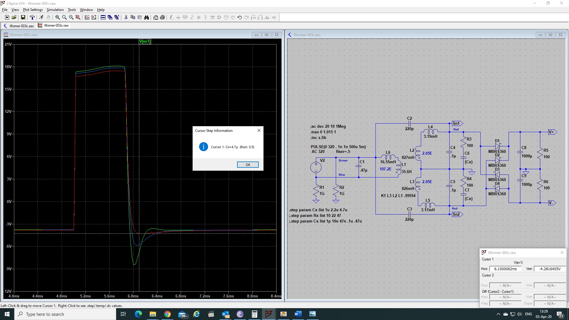

THE HPA: Tweak: power supply: erratum
There are BIG mistakes in the values of the transformer (copy/paste from another project). Here's the correct asc - Sorry about that.
Please note the "snubber" values differ significantly from those in the Quasimodo results thread, which average out at about Cx=10n, Cs=150n, Rs=10-100E, with comparable transformers. I think, tentatively, the Quasimodo smacks the secondary, unloaded, whereas I ping the primary with the secondary fully loaded. I'm also building a Quasimodo, and I'll get back to you with findings, if any.
Mark, if you're reading this, would you care to comment?

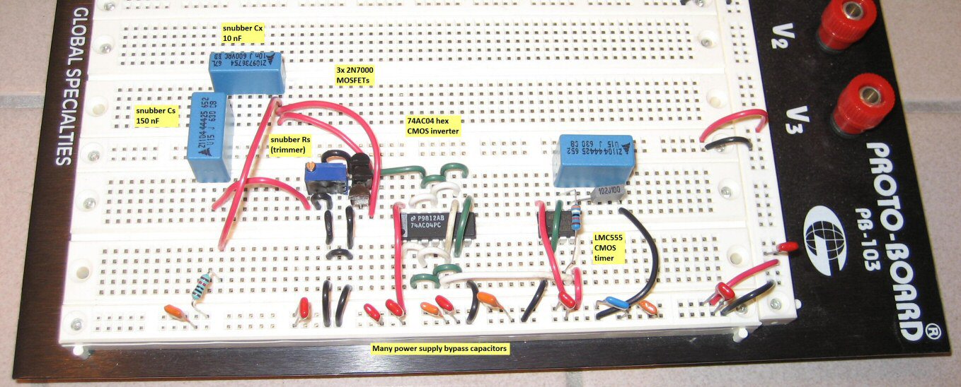

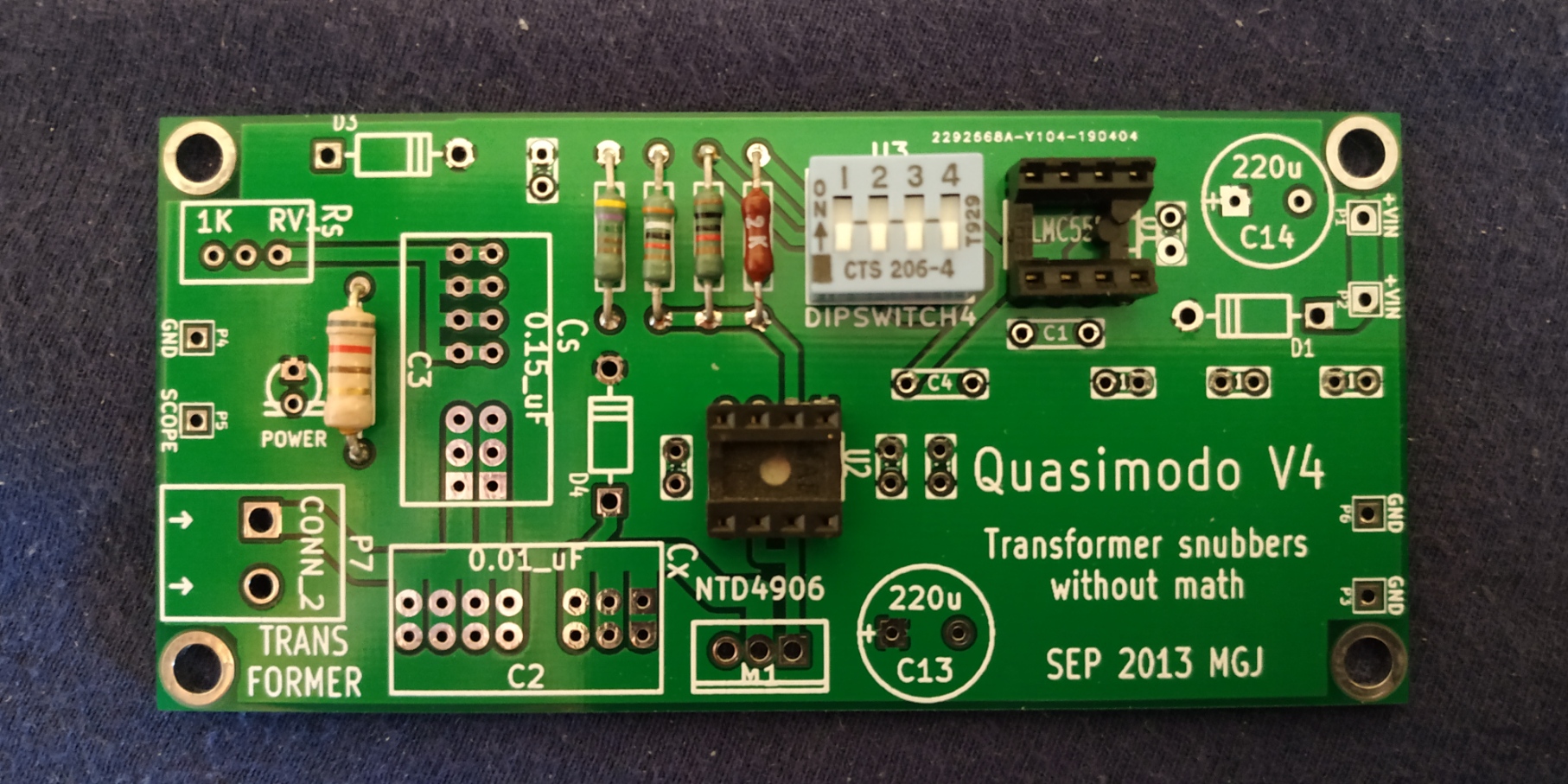

There is a test jig called Quasimodo described here on diyAudio, which simplifies the selection of component values for snubbers.

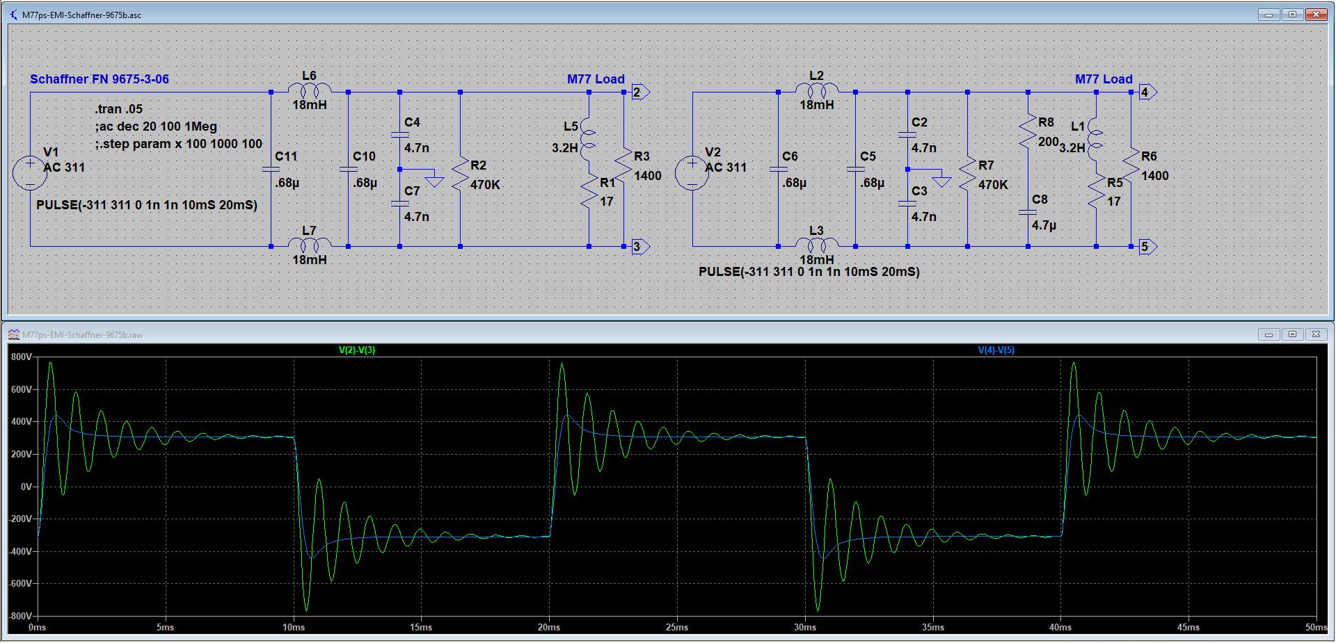

I looked at some commercially available mains filter, even those deemed "audiophile quality", simulated them, and they all ring like bells.
739995d1551532564-john-curls-blowtorch-preamplifier-iii-emi-schaffner-9675b-jpg
But they do look a lot like snubbers, don't they? Therefore my reasoning is: why not kill 2 birds with 1 snubber? (Birds: the cruelty is not for real).
So Mark, that's the meaning of the question I asked a few posts back: I simulate with a pulse hitting the primary, and step the RC values for best damping at the secondary, fully loaded with rectifiers and smoothers. The values I come up with are 10x what people get using your Quasimodo. Any comments?

Obviously the thing to do is to perform a controlled experiment with a transformer and Quasimodo.
In Part_1 you short the primary wires and also short all secondary wires except one single secondary winding. Connect that winding to Quasimodo, turn it on, and dial up whatever potentiometer setting gives zeta=1 critical damped response. Write the measured value of snub resistance Rs in your laboratory notebook.
In Part_2 you use the exact same setup, with one modification. You connect the output of the RFI filter module to the transformer primary winding(s) exactly as would be used in your 230V/115V application; then, short the INPUTS to the RFI filter module (where the mains would be applied). Turn on Quasimodo a second time, and dial up whatever potentiometer setting gives zeta=1 critical damped response. Write the measured value of snub resistance Rs in your laboratory notebook.
I don't recall ever seeing published data for an experiment like this. Certainly I've never tried it myself. Thus nobody knows whether to expect (Part_1_Rs >> Part_2_Rs) , or to expect (Part_1_Rs ~=~ Part_2_Rs) , or instead (Part_1_Rs << Part_2_Rs) . The trailblazing pioneer who tries this experiment the very first time, gets the thrill of discovering just what actually happens in real hardware.

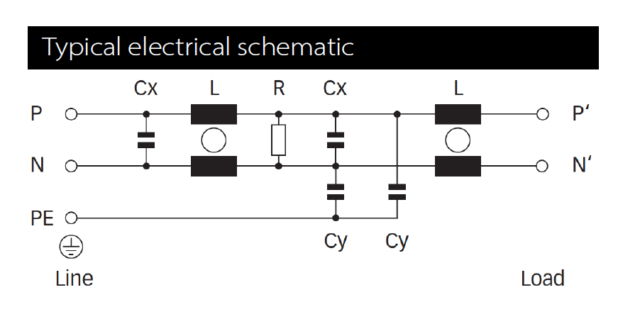

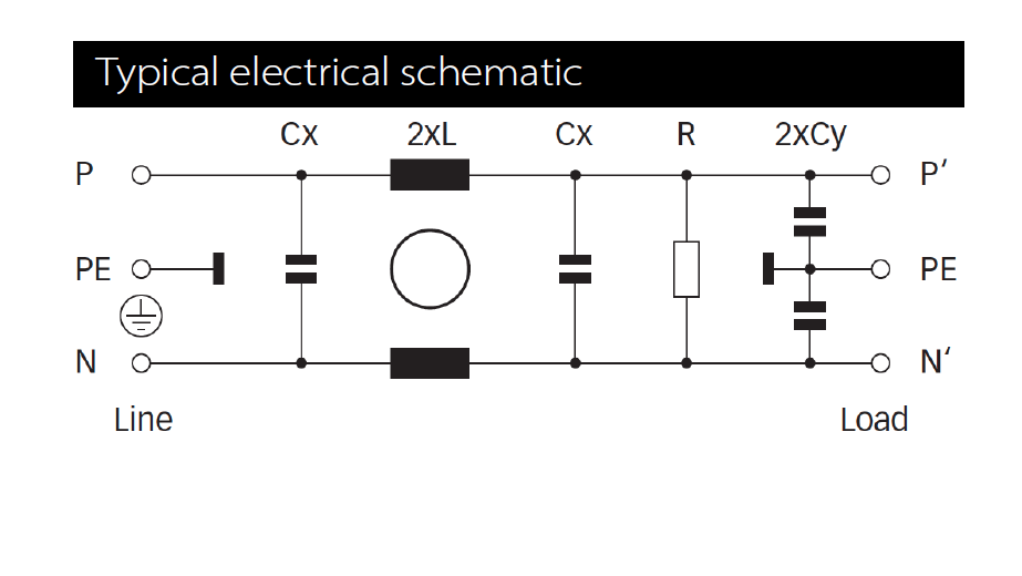

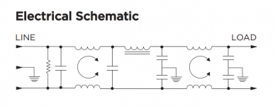

A meticulous and thorough experimenter might divide Part_2 into three pieces (Part_2a, Part_2b, Part_2c) and perform the test with three different RFI filter modules. Perhaps with different max load current ratings {thus different wire gauge in the inductors, thus different inductances}. Perhaps with different numbers of series stages of filtering; one, two, and three stage filters are on the shelf at DigiKey, schematics below. Perhaps with different physical mounting configurations: one a rear panel IEC inlet module with integrated fuses and filter; another, a standalone sealed metal box with screw terminal I/O; etc.

Actually, my thinking is not to use a RFI filter at all, maybe just a Cx instead, and rely solely on the snubber at the secondary to deal with the RFI at the primary.
830146d1585915263-jc2-hpa-headphone-amplifier-xformer-003c-jpg
LTspice says it's possible, but I don't have any means to verify it yet, my Quasimodo is still missing some parts. Maybe by the end of the month, as China is still in recovery.
