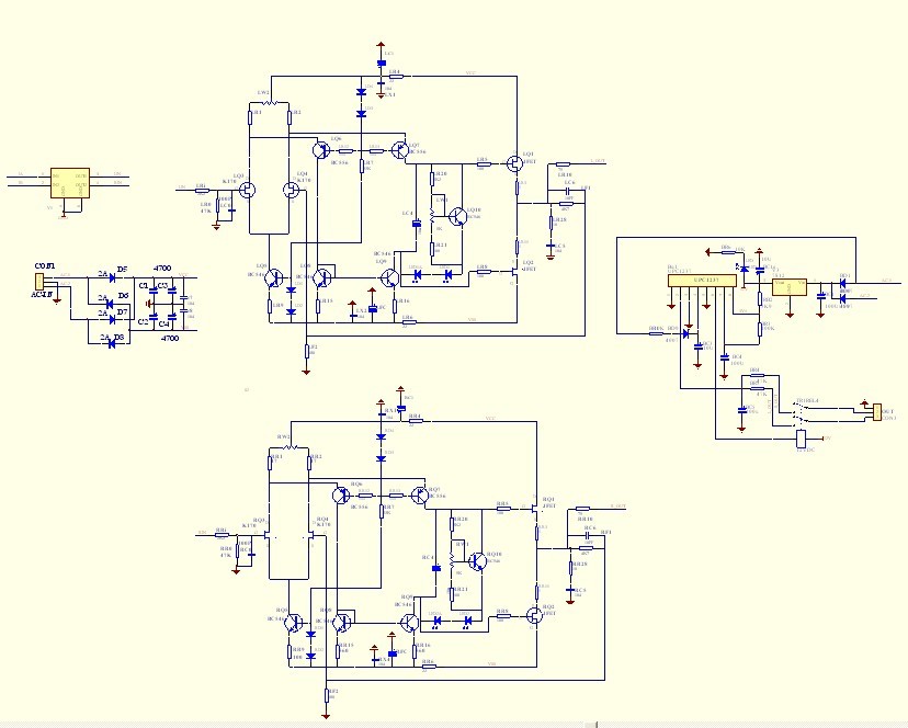

Did you short out the feedback capacitor?
It should be a low voltage high capacitance electrolytic near the gate of the second Fet, maybe 50-200uF. 10-20V. It reduces the DC gain to 1 and therefore minimizes the offset/drift. But it's also in the signal path and can be evil.
No. I did not notice that in the signal path or the feedback in the PCB pictures. There are a bunch of low voltage high capacitance electrolytic around the UPC1237 which are not in the signal path.Did you short out the feedback capacitor?
I will open the headphone amp box to look again later today.
If it is there to reduce the DC gain to 1, it passes through the input stage DC offset, but should not reduce it.
What I mean is: if you have a mismatch of 1mV at the input, and a DC gain 10, the offset at the output would be 10mV, unless you have a, let's call it "DC feedback blocking cap", in which case the DC gain is 1.
These are the ones I circled in red in the attached schematic.
It's from one of those Ali/eBay headphone amps advertised as Audio-Technica HA5000 clone; should be close to the E5, I think.

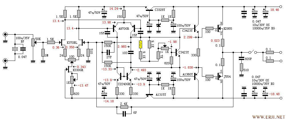

Edit: silly me, weiliang published the E5 schematic, and it's a DC amp (no NFB cap):
It's pretty close to the AT, sans the driver.
Zung shows the schematic of E5 that Weilliang posted at this forum in 2012. I do not have the E5 and do not know how much detail and fidelity Weilliang showed of the actual board.Ah, ok, wasn’t sure, didn’t recognize it...
On the AT HA-5000 discussion thread, we call this the small blue PCB clone. I bought one of this, but decided to sell it and kept the E19.What I mean is: if you have a mismatch of 1mV at the input, and a DC gain 10, the offset at the output would be 10mV, unless you have a, let's call it "DC feedback blocking cap", in which case the DC gain is 1.
The other AT HA-5000 clone made by Zero Zone is a 3 PCB kit and a copy of the Shanling PH-100. The Shanling PH-100 is supposed to be a clone of the AT HA-5000. This does not have the 100uF electrolytic in the feedback.

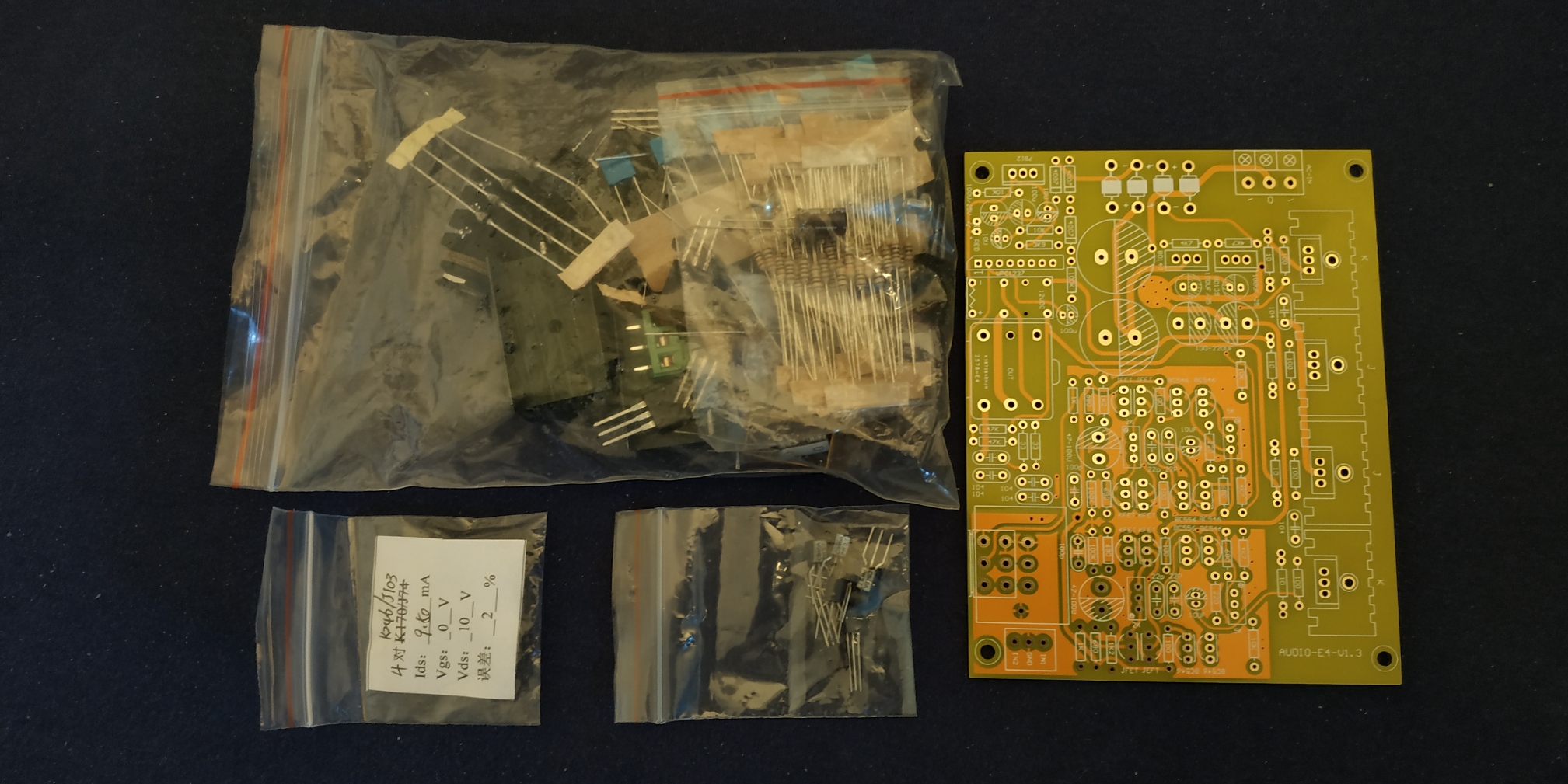

My 2nd kit came in today: ordered on Jan 18th, shipped on Mar 11th, and received on Apr 20th, oh well, nobody's fault I presume...
The content is not as great as the 1st kit: the supplier clearly has some problems with their testing process: the same sex matching is near perfect, the opposite sex matching is terrible. I left the following feedback:
Good item, great value, but...
The matching of the input FET needs improvement:
- All the N-channels are well matched: 8.89, 8.89, 8.88, 8.89; average is 8.89 mA: excellent
- All the P-channels are well matched 11.73, 11.71, 11.76, 11.73; average is 11.73 mA: excellent
***BUT the matching between N and P is BAD!!!***
Clearly, this is a problem with the testing process. Please forward this mail to your supplier so they can fix it.

It seems to confirm that, in Chinese kit, a differential input is easier to implement than the complementary differential input.
The K170 and J74 are relative cheap from Chinese sellers on e-bay. Did anyone see any test report on them? How easy is it to find a matched quad?
