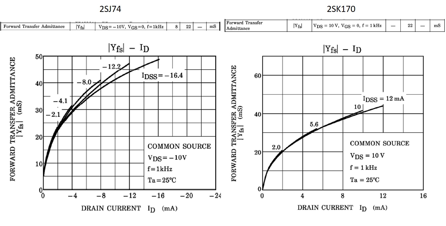

Scott, you should more carefully check the data sheets, before challenging me. MY Toshiba handbook shows at 4ma: 28,000 for the 2SK170, and 29,000 for the 2SJ74. It is the CAPACITANCE that is so different.
Manufacturing tolerances are probably 5-10%, as I've said before there are no commercial FET's to fake these with, re-brands are way off on Vp, Idss, and Yfs and are just a take the money and run scam. The Yfs vs Id plot is all that matters I have never seen a single other FET that come close. Promoting the sorting of FET's by Idss only helps those selling fakes, they take high Idss switches from someone like Fairchild which have large Vp's and the Yfs is way off but no one notices.
Zung, you probably have fake jfets, the n and p Toshiba devices should be almost exactly the same for Gm. Yours differ. (for example)
Not quite if you look at the datasheets.
The devil is in the detail (and the scale).
I did a little montage here for your enjoyments: you can see the advertized ("typical") Yfs is the same, but if you look at the Yfs vs Id curves, with Idss=12mA, the J74 is slightly ahead at about 47mS, while the K170 is a bit behind at about 44mS. I'd call it 5-10% diff. In my batch of 50, I have an average of 38mS for the J, and 33mS for the K for about 15% diff.
Btw, I was expecting mines to be fakes; I just wanted to know how fake they can be, and I'm satisfied with the results. For a definitive answer, I guess I'll have to build something to measure the noise. Maybe someday.

They look pretty good if you change your plots to the same coordinate scales.

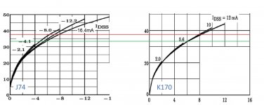

You're right. Here's a photoshopped version.
Now that gives me yet another crazy idea: if we intentionally mismatched the Idss and took, say the J74 @ -16.4 mA and the K170 @ 12 mA, and ran them at reduced Id? The matching seems pretty good in the area between the red and the green line, Id = 6 to 8 mA. Maybe that's why I noticed lower distortion while running the sim's.
Doable?

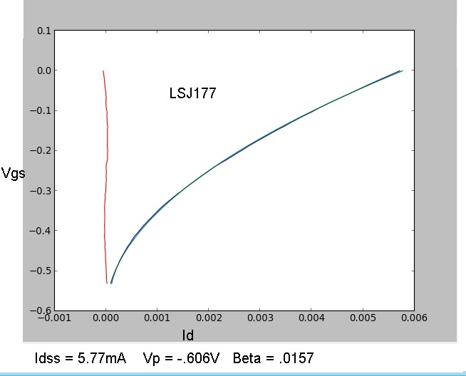

This is more elaborate than most folks might do, but I did this when Linear Systems was first sampling their parts and I wanted to provide some feedback.
I took the Digilent Analog Discovery USB card and made a simple curve tracer with a few Python scripts. Taking Vgs vs Id at 100 points quickly there are no self heating issues. The data was least squares fit to the ideal JFET equation, here the plot of the data and the fit are nearly coincident. The red line is the difference here shown as current delta vs Vgs. The fit is very good, the slight "s" shape error is typical with slight deviation at the high end for high current effects and parasitic resistances, at the low end for sub-threshold effects.
I might add this is IMO a better way to extract Vp because it fits the data where you are going to use the FET not the usual way of measuring it in deep sub-threshold. Once you have Vp and Idss you can compute the gm, operating point, and matching in almost any application. A simple rearrangement of the FET equation can include a small source degeneration to cover even more applications.
Saving the data to a two column file you can use Excell to sort in any dimension you want.

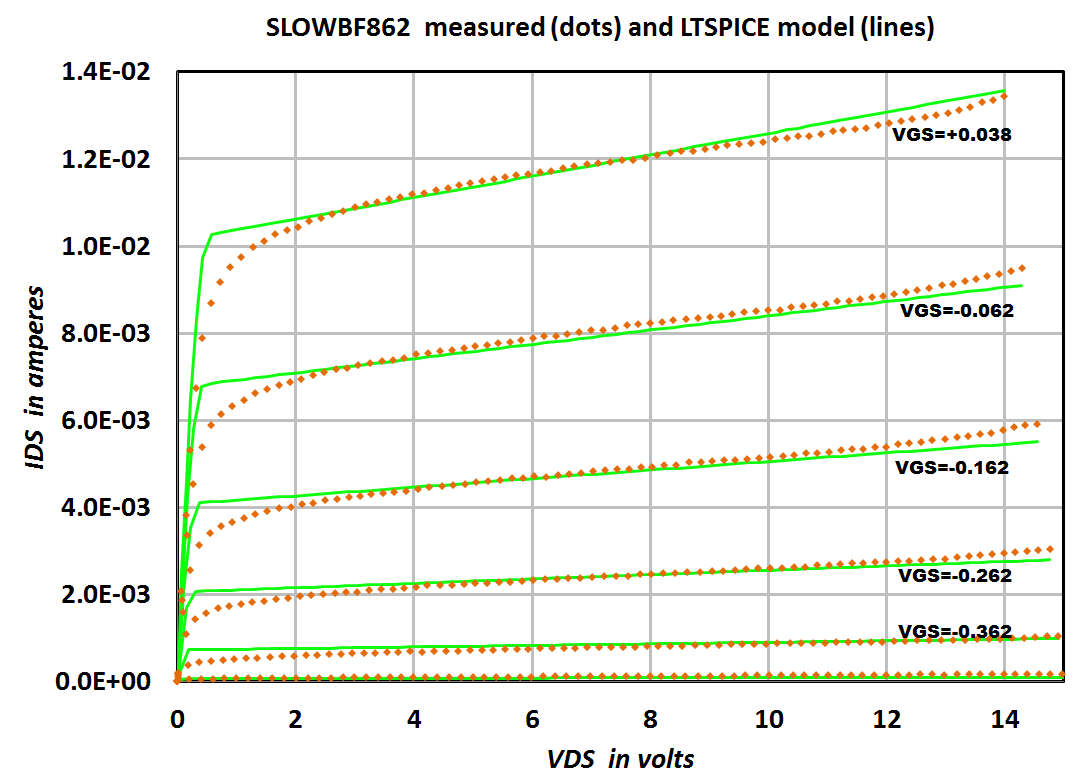

I did similar things with a "Locky-Z Intelligent Curve Tracer" and a BF862 JFET. I found that the JFET modeling equation in LTSPICE has only three parameters that matter for DC I-V curves in normal operating modes: BETA, VTO, and LAMBDA.
LAMBDA sets the slope (dIds/dVds) in the saturation region and can be fitted separately.
This leaves only VTO and BETA. They can be extracted from triplets of measured data (Vgs, Vds, Ids) using Excel, either with Trendlines or the built in optimizer. The results are pleasant:

.MODEL  SLOWBF862  NJF( VTO=-5.083E-1  BETA=3.394E-2  LAMBDA=2.426E-2 IS=1.19E-13   N=1.255
+                       ISR=3P         NR=2           RS=0.5         RD=0.5         BETATCE=-0.5
+                       VTOTC=-2E-3    ALPHA=1E-3     VK=6.0E2       M=0.6          PB=0.5
+                       FC=0.5         CGS=9.5P       CGD=7.5P       KF=8.75E-17    AF=1
+                       MFG=NXP)
I left Lambda out for several reasons most importantly it adds an extra dimension that is mostly useful for simulations. Using an average Vds worked very well, and there was not a 2 dimensional search for matching where one of the dimensions made very little difference.
