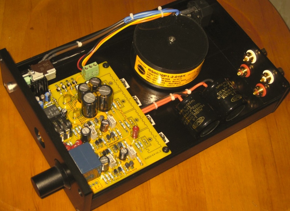

A couple years ago I purchased the “E4” to use since the E5 was mia. I recently added an aluminum volume knob, and shortly afterwards had an esd incident (dress shoes/carpet) that took out the input fets I’m assuming.

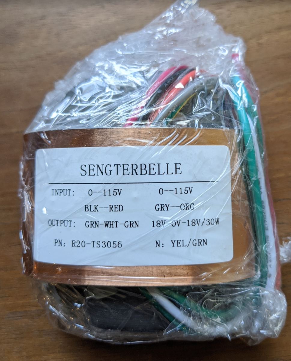

I saw this thread and decided to buy one of these kits: thought it would be a fun challenge and I might learn something. I appreciate all the great info Zung & others have provided, including the sims and suggested mods.
A little on my experience with the kit so far and then some questions.
JFETs and BJTs:
I measured the IDSS of the JFETS (haven't measured the Yfs/Gm yet). I didn't control the temperature so take these #'s with a grain of salt.
I also used my DMM's hFE tester to measure the hFE of the small signal transistors.

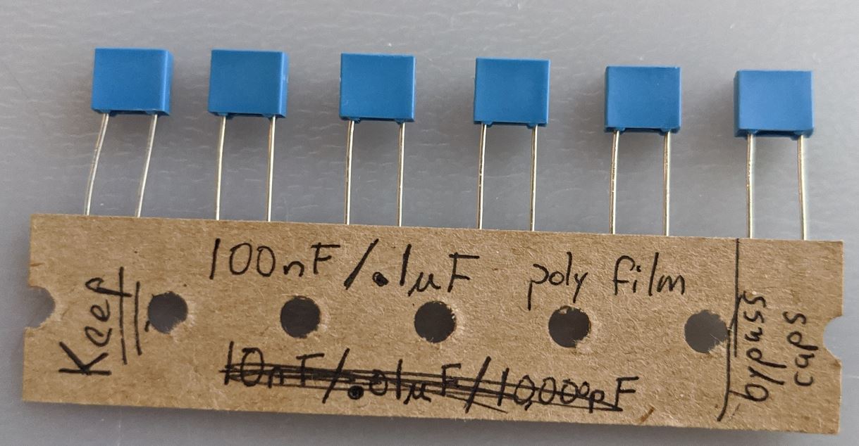

Rather than ceramic bypass caps, my kit came with .1uF poly caps, so I plan to use those. It also came with two types of small axial-leaded caps of a type I've never seen before (pictured) which I assume to be the 22pF and 100pF's based on the schematic and my powers of inference alone. I don't think my DMM can properly measure down the picofarad range.
Misc other parts:
Some of the electrolytics are labeled Nichicon, even some Silmic II's. Plan to use a mixture of what came in the kit and what I have in stock (plenty of electrolytics left over from other projects). I received the same sinterglass ultra-fast diodes for the rectifier.
The heatsinks do indeed seem wimpy -- waiting to receive the case but it's TBD whether or not I will use them versus mounting the MOSFETs to the chassis. Drilling holes in metal is not my favorite activity, even in quarantine.
Questions:
Thanks again for all the great info and in advance for any advice.

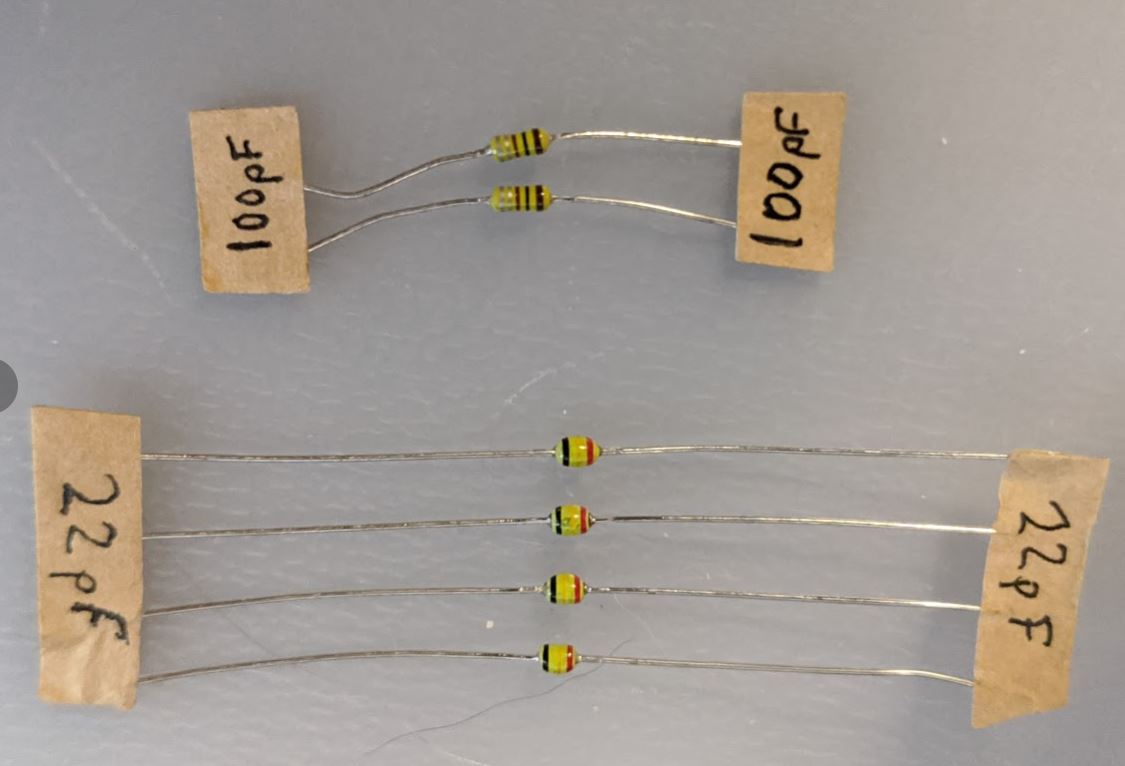

- Rather than deal with the mystery 22pF and 100pF (presumably) caps, I was planning to follow Zung's substitution guide and use 22pF and 100pF Micas in their place. Thoughts/opinions? Holy hell they're expensive.

Hey metaphile, thank you for your kind words. I'm in the process of moving to a new place, so everything is boxed, and I can only gives answers from memory. Be aware I'm world famous for the fact that I've got 3.5 neurons left, so feel free to mark my words as suspicious. 🙂
Power supply
2x18V will give you about +/-25Vdc, the semiconductors will take it, so it should work.
Regarding the sound of passive vs active PSU, I did an experiment about 40 years ago: in the blue corner, a SS preamp, based on a pretty standard topology: Fet in, BJT VAS, MOSfet out and on-board cap multipliers; this one has a regulated PSU, all discrete, low loop gain & high bandwidth. In the red corner, the exact same preamp with a passive PSU with 4 massives caps, 100,000uF each I think. The contest was done, sighted and long term, with a grand total of 2 test subjects: me and a friend. The verdict:
Active:
BJT's
No technical reason not to use the supplied ones, especially yours have better Hfe match than mine.
Cap
Compensation: the supplied ones could be ceramic (= evil). Mica's are better alternatives, and polystyrene are best, but they'll need a bit of yoga to fit, maybe vertically.
Bypass: what makes you think the supplied ones are poly's? Anyway, mylar/polyester's are only slightly less evil than ceramics. I use polyprop's, the Chinese ones are only a quarter a piece.
Electrolytics: I wouldn't rely on the markings of the supplied ones. I used them only in the protection circuit, with the exception of BC5, for which I use a Silmic. Everything else are either true blue Silmics or Nichicon UKT's; they're available at Digikey.
