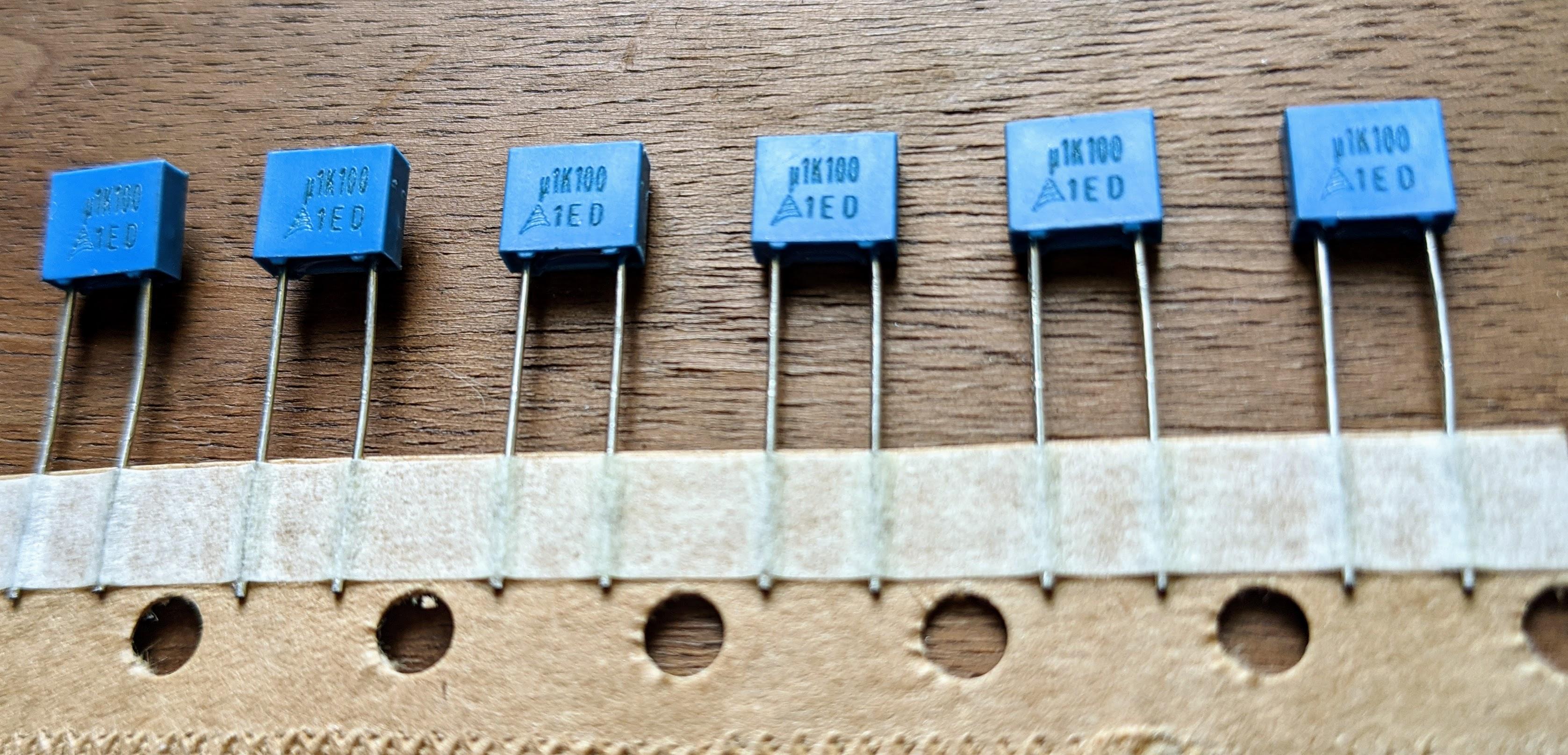

- .1uF blue box-type bypass caps (pic attached, probably polyester given the form factor) - there's not much space on the board for these, so I plan to replace the supplied ones with with .1uF PPS caps from Kemet (from what I'm reading, Polyphenylene Sulfide seems a better alternative to Polyester without the massive size of Polypropylene)

Better than mica, IMHO :

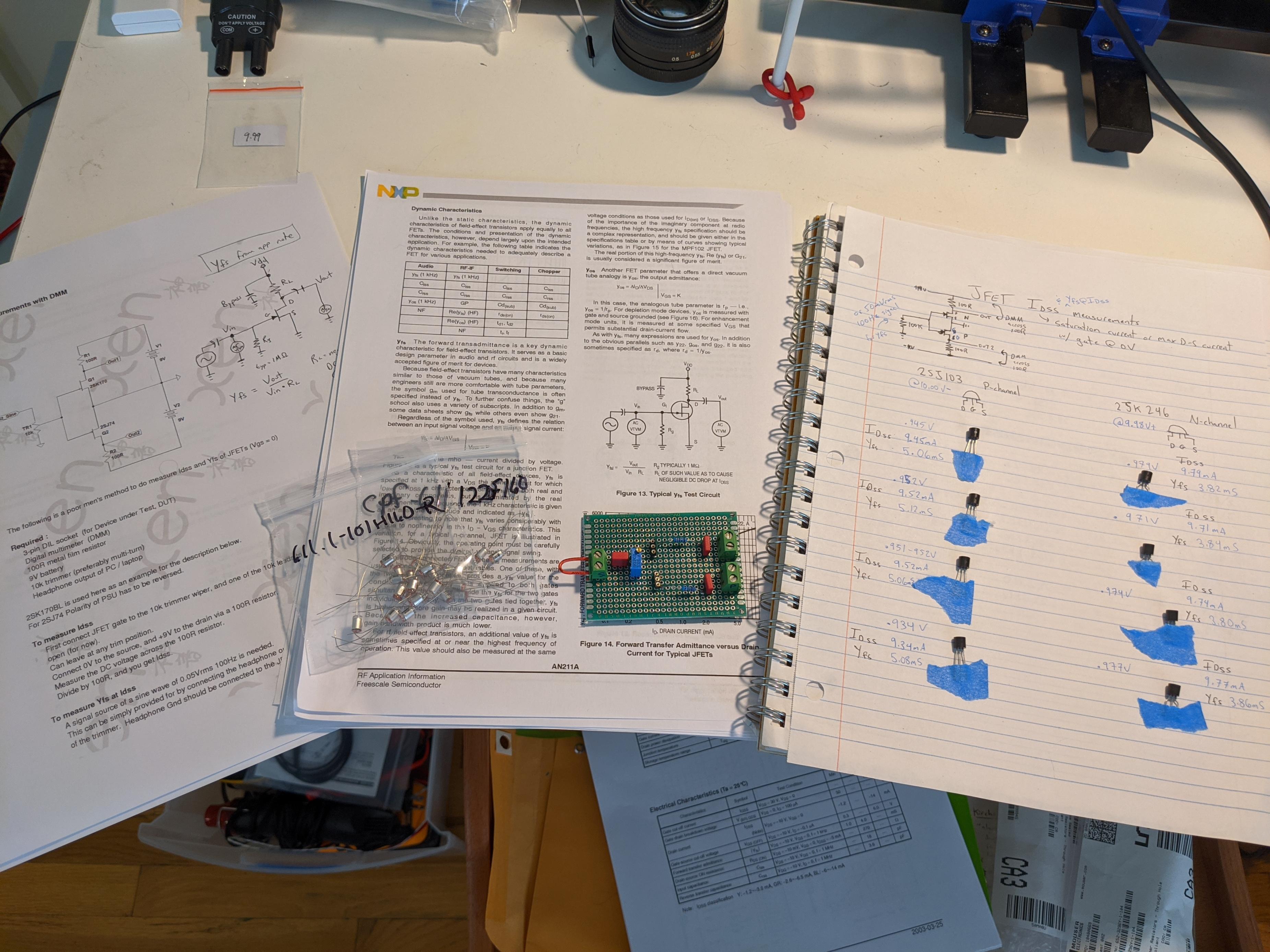

I measured the IDSS of the JFETS (haven't measured the Yfs/Gm yet). I didn't control the temperature so take these #'s with a grain of salt.
2SJ103: 9.34, 9.45, 9.52, 9.52mA
2SK246: 9.71, 9.74, 9.77, 9.79mA
I tested the Yfs/Gm of the JFETs last night @ IDSS w/ a 104Hz signal (made a typo in the software -- should have been 100Hz) at 50mVrms. Shout out to Patrick for the test jig circuit.
In the same order as they appear above, measurements were:
- 2SJ103: 5.06mS, 5.12mS, 50.6mS, 5.08mS
- 2SK246: 3.82mS, 3.84mS, 3.80mS, 3.86mS
So my experience is very similar to Zung's -- close same-sex matching but not so w/ the opposite sex.
I also received the 100pF and 22pF polystyrene capacitors from surplus sales of Nebraska. They made a typo in the original address and my order was shipped to the wrong place but quickly sent another identical order to the correct address once I contacted them. Good customer service - will shop there again.
Pic attached of the JFETs, matching jig, caps, and some very helpful documentation
(On a personal note - I haven't even reached the FET chapter in Art of Electronics yet -- I'm still on the chapter about BJTs -- so this kit & thread have expanded my learning & gotten me peeking ahead)

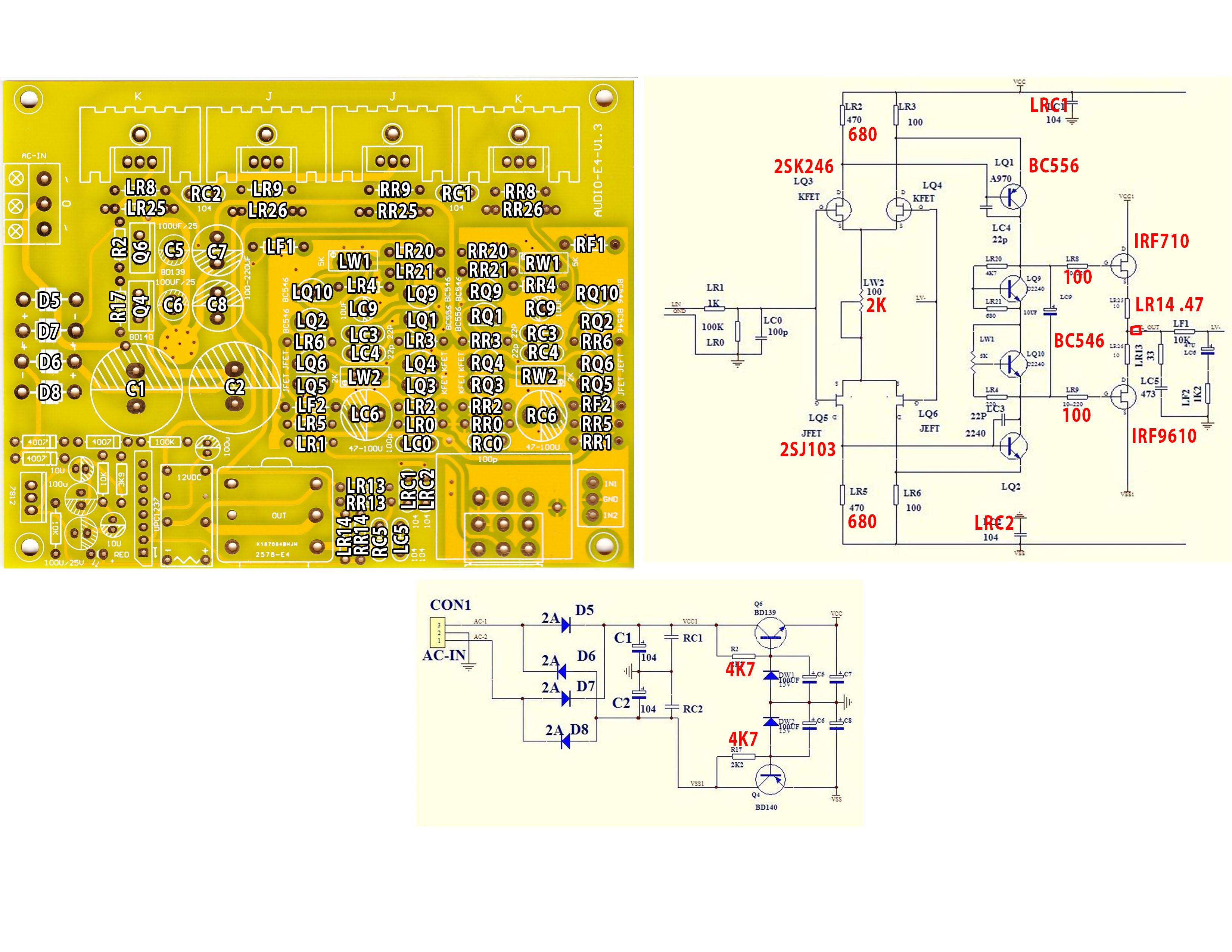

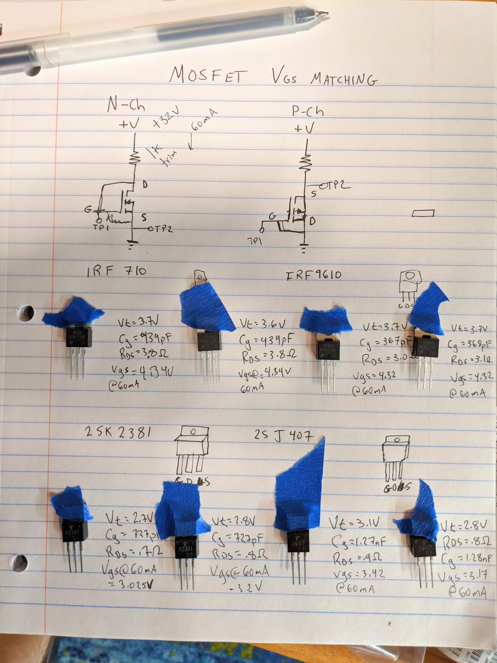

Hey folks,
Today I took the time to go through the PCB and the schematic offered by the supplier and label everything. I also marked up the schematic to reflect the resistor values on the PCB screenprint. Results are attached. If anyone who is planning on building one of these would like a high-resolution printable PDF, just message me and I'll share.
I also took the opportunity to test the Vgs of the MOSFETs @ 60mA -- both the supplied 2SK2381/2SJ407 pairs and the IRF710/IRF9610 I purchased from Mouser.
Results were as follows:
2SK2381:
2SJ407:
IRF710:
IRF9610:
I was pleased with the matching of the IRF710/IRF9610 pairs and will use those rather than the Toshibas.
2SK2381:
- 3.025V
- 3.2V
2SJ407:
- 3.42V
- 3.17V
IRF710:
- 4.34V
- 4.34V
IRF9610:
- 4.32V
- 4.32V

Whoops, just noticed a mistake in my markup of the seller's schematic.
LR14 & RR14 are actually 47K -- I had marked these up as .47K. Corrected annotated schematic attached.
Also note that I left out the protection circuit altogether. The 47K resistor appears to be a part of that -- it actually connects between the relay and the C137HA IC, so my clumsy addition of it to the schematic (see red hand-drawn box) isn't really accurate.
