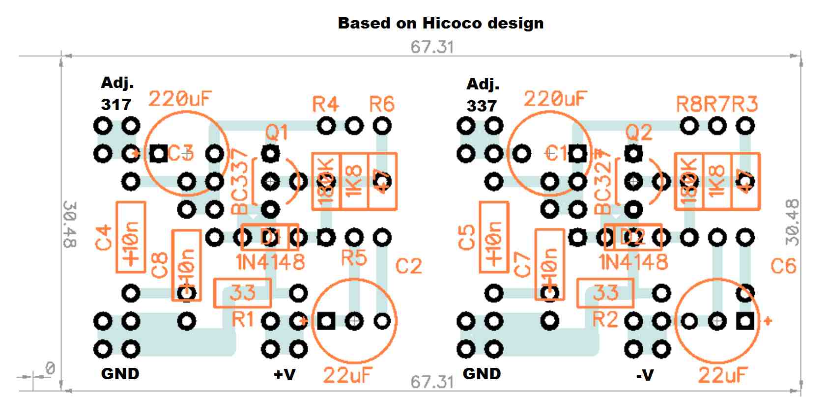

I took the trouble to design a Dinoizator assembly on a prototype pre-drilled board, that you can get anywhere.
So you can simply add it to the 317/337 kit you bought.
Or better yet, wait till I do the same with the Dienoisator, designed by and which simulates a lot better than Dinoizator.
What I did was use the pcb program, Diptrace, and use to place the parts. The traces are the part's wires, but you can do a clean job this way, instead of waiting for the pcbs to come.
I did that many times to prove a circuit worked and then have the pcb done.
Let's hope you understand what I did. The pcb is a standard size you can get on eBay. And I just showed the holes you will need.

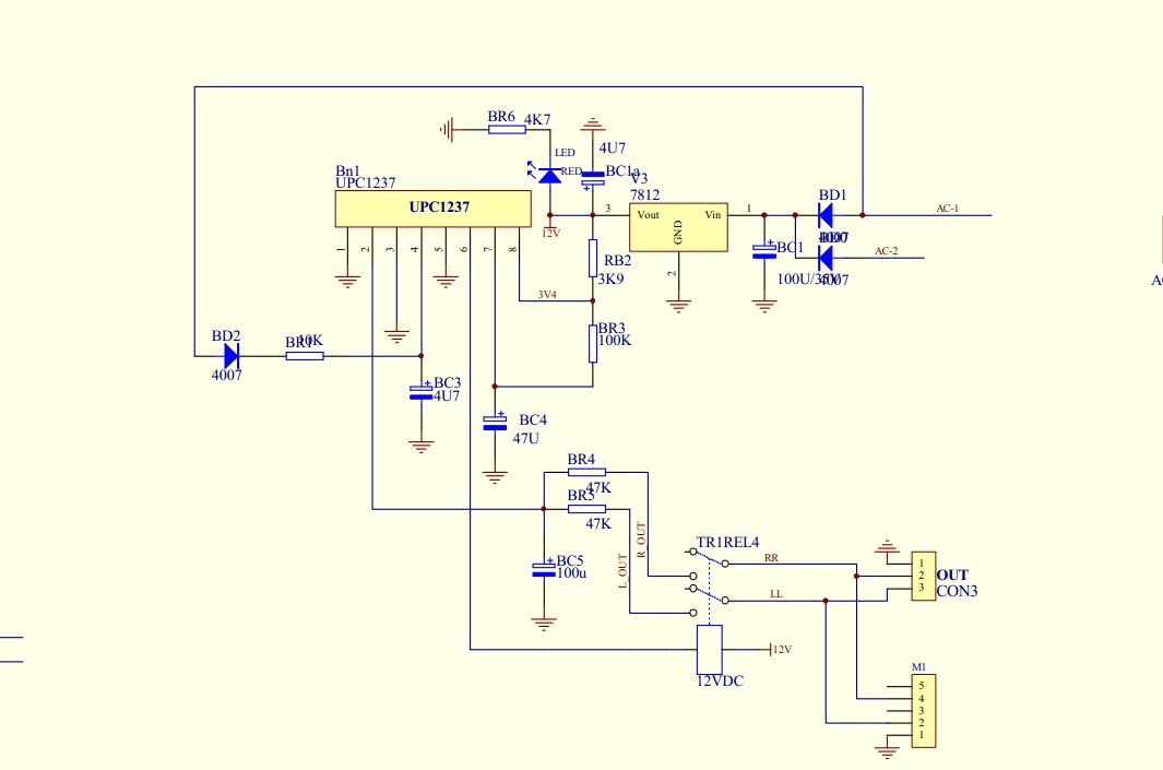

I'm hoping that Zung or someone else who has experience with the kit can weigh in on a little troubleshooting issue I'm having.
I built up the amp on the bench this weekend and biased it up using my lab bench supply. Biased fine, for now I'm running the JFETs at 2mA and tried the MOSFETS at 60mA and 80mA.
I don't have any output at the headphone jack. I think I have a bad relay.
I found the schematic for the protection circuit from another amp by the same designer and verified that the voltages I am seeing on the IC are sensible. I have 12VDC on the coil of the relay. But it's not switching.
The signal from the amplifier appears on pins 4 and 5 of the relay. IIUC, with 12V on the coil, the relay should connect pins 2 and 7 (the pins that connect to the headphone jack) to pins 4 and 5, thereby passing the signal to the headphone jack.
Here's the data on the relay. I've attached the schematic I found of the protection circuit. Here's the datasheet for the UPC1237 IC.
The voltages on the UPC1237 are well within the parameters that should switch the relay (and - as I mentioned - since I have 12VDC on the coil it seems it's operating correctly and trying to engage the relay.)
Here are the measurements I took off the IC, followd by the threshold or reference values listed in the IC datasheet:
  • Pin 1 - Overload detect - 0VDC (Vth values are .58-.76V)
  • Pin 2 - Offset detection - 11mV (Vth .54 to .7VDC, -.12 to -.23VDC)
  • Pin 4 - AC-off detector 1.4mV (Vth .6-.9V)
  • Pin 6 - Output of relay - 12.1VDC
  • Pin 7 - Vcc ON mute, setting delay time - 18.4mVDC
  • Pin 8 - VCC - 2.4V (Vref = 3.0-3.8V)
So - am I right about this? Bad relay? Or am I somehow missing something here?

You're way ahead of me, my board is not stuffed yet, and all my gears are boxed to move to my new place 🙂
But you can still do something:
  1. Measure the resistance of the coil (between pin 1 and 6) to see if it's anywhere near the published data (960-320 ohms). Depending on your DVM, you may want to reverse the probes and take a second reading.
  2. If the relay looks OK, turn on the HPA, and measure the DC voltage at "L Out" and "R Out": the output offset should be in the range of 1-100 mV.
  3. If the output offset is OK, connect some expendable earphones directly to the L-R Out to see if the HPA is working.
  4. If the relay is NOT OK, desolder it and try it with a bench supply or a wall wart. Worse case, replace it, and use the opportunity to fit an outboard XXL one, with silver contacts. This topic has been discussed at length in the CTC thread; do a search.
  5. If it were me, I'd monitor the offset over a few days/weeks. If it's stable, I'd short the relay out. But that's just me, don't do it.
Hopefully, I'll have my gears back by the end of the month, then maybe I can be more useful.

1. Resistance of the coil is at about 730 ohms
2. DC offset voltage at L Out and R Out is +22mV and -19.1mV.
3. I already checked with a scope probe and a test signal -- HPA is definitely working. Nice clean sine wave at those relay pins, around 5.5Vrms or more before visible distortion / clipping.
4. I think I'll try this next. At no point does it go "click" in-circuit despite the 12V applied. I did watch the voltage rise somewhat slowly on the coil pins at turn-on though.
5. ...and then probably just do this so I can at least hear some music 😉

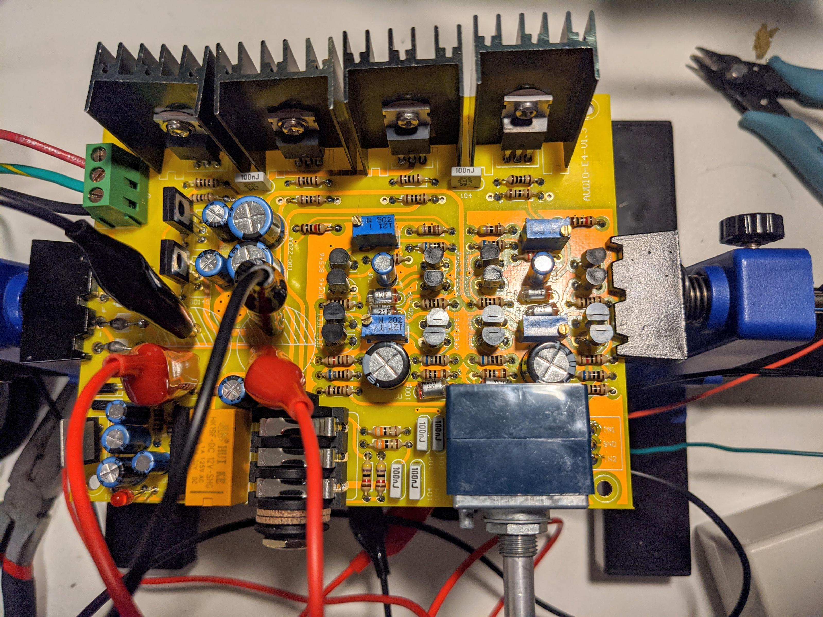

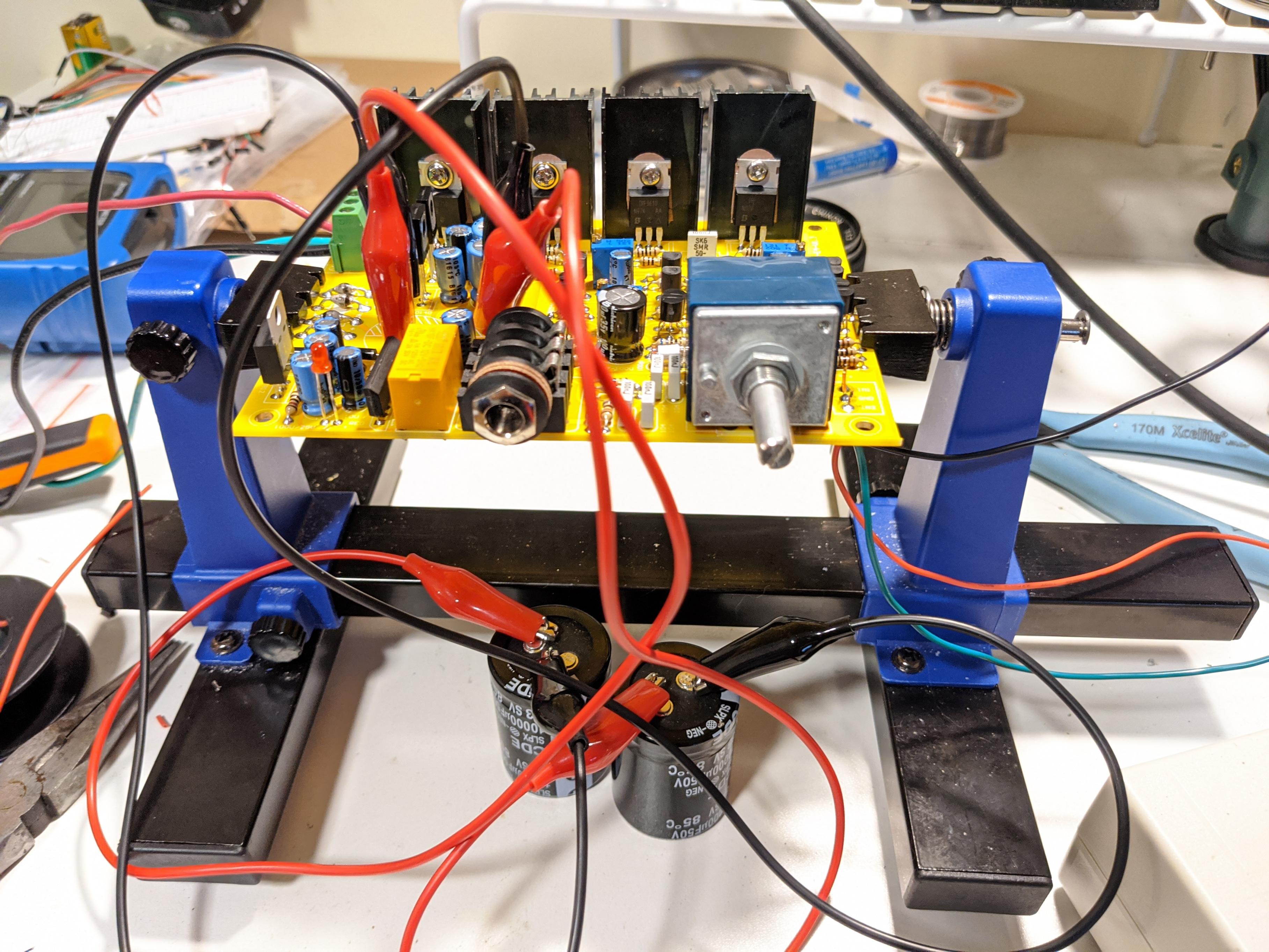

Quick update: I went ahead and jumpered the pins on the relay, and I have sound!
It sounds... nice. It certainly gets plenty loud. Lots of bass. Only had time to listen to a couple of songs on my usual pair of headphones after determining that the sacrificial pair survived being connected, so I haven't made any groundbreaking observations just yet.
Here's some pics on the bench in its test configuration. Forgive the mis-alignment of the leftmost MOSFET heatsink: this configuration is subject to change once I get the enclosure.

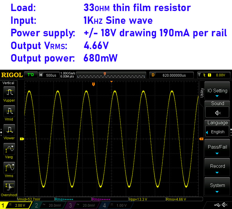

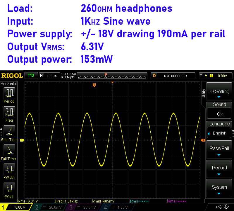

Testing output power under load
I wanted to get a better sense of how well this amplifier could drive higher and lower-impedance loads.
I did the following tests with ~80mA current in the MOSFETs and ~2mA in the JFETs. Bench supply with +/- 18V rails, and 190mA or so per rail (6.84W total power draw).
Tested with a 33ohm non-inductive thin film resistor dummy load to simulate my 32ohm Hifiman HE4XX headphones and a pair of 1975 Koss Pro 4/AA's (which InnerFidelity measured at 260ohms at 1KHz).
Results are attached measured just before clipping. Clipping - by the way - nice and symmetrical.
@33 ohms = 680mW
@260 ohms = 153mW
Hope some others may find this useful!

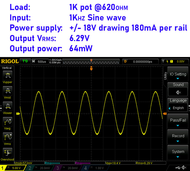

One more test - I wanted to see how this amp would do driving a really difficult load like a pair of 600 ohm headphones, so I tested it with a 1K potentiometer set to 620 ohms as a load (to simulate the Beyerdynamic DT880's as measured here).
64mW was the result -- see attached.
I also measured the amplifier unloaded and got 6.68Vrms -- so I calculate the ouput impedance to be about 15 ohms (depending on which numbers I use for the loaded voltage). This is an imprecise measurement since I am manually setting the just-before-clipping point but thought it might be interesting nonetheless.

Back to your original Q: if you have +12V at pin 6, it means the relay see 0V, so maybe it's something else.
Side Q: what do you think of the Hifiman HE4xx? I have the HE400S and think it's terrible, all bass and not much else, in spite of what InnerFidelity says.
Ah yes I understand -- should have realized that before.
While I was testing I noticed that if I short pins 7 and 8 together on the IC, the relay clicks (and voltage on Pin 6 drops, creating the voltage difference across the relay coil). I'll keep digging and see if I can figure out what might be going wrong w/ the circuit. Pin 7 is labeled "VCC ON mute, setting delay time". Now I know at least that it's not a bad relay.

... I believe I figured out the problem with the relay. The AC-Off detect on Pin 4 is expecting a voltage -- threshold is between .6 and .9V according to the datasheet. But the diode BD2 in the schematic (attached) is reverse-biased b/c I am feeding the amp w/ DC instead of AC voltage and it's being fed by the negative rail: therefore it isn't conducting and there is no voltage on Pin 4.
I'm imagine that this problem will resolve itself once I power the amp with the transformer instead of the my bench supply.
I can confirm that the relay works fine w/ the AC supply -- I tested it over the weekend w/ the supplied transformer.

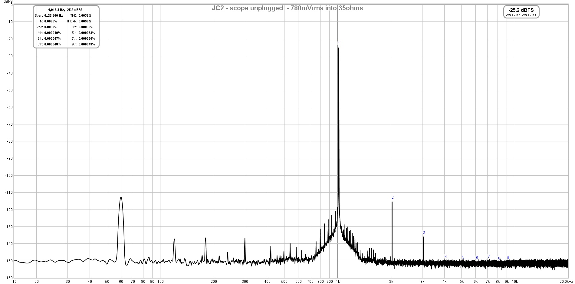

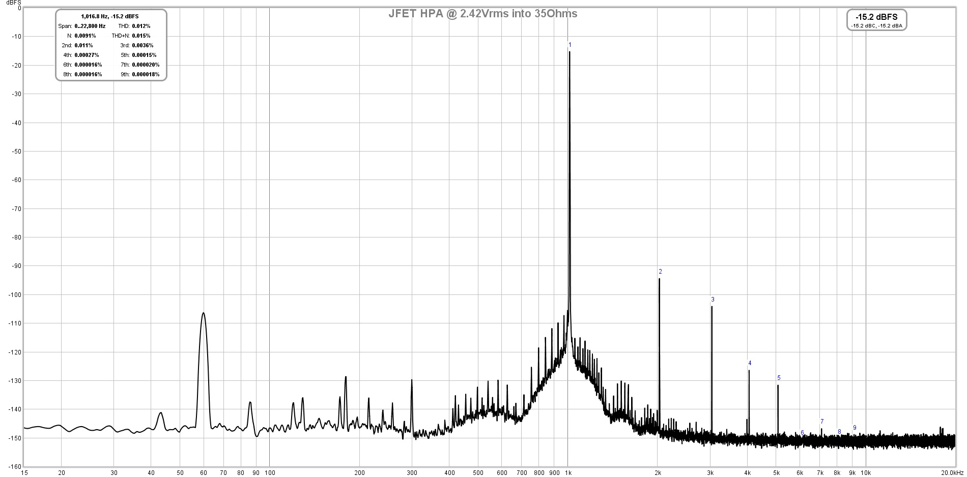

I've attached two distortion measurements. Take them with a grain of salt -- I'm not sure I really know what I'm doing yet, but I followed the advice in the Distortion Measurement with REW & Got Focusrite Scarlett 2i2 (2nd gen) for measurements. What's next? threads.
I'm using the line input on the Focusrite 2i2 w/ an Akitika 2PPM 1Khz oscillator as the signal source. These measurements were taken on the lab bench (a noisy environment) across a dummy load resistor while the HPA was powered by my lab bench supply (not the AC transformer). I left the sleeve of the unbalanced TRS cable I used unterminated per some advice in the other thread -- tip is connected to + and ring to ground. I think this is causing the cable to pick up additional noise (though advice in the Focusrite thread was to not terminate the sleeve so as to avoid a ground loop -- which may not be pertinent when not using the Focusrite as the signal source)... I'll do more distortion measurements once I have the amp in the enclosure.
Evidently, ~780mVrms is the sweet spot for the Focusrite so that's probably the more relevant of the two measurements.

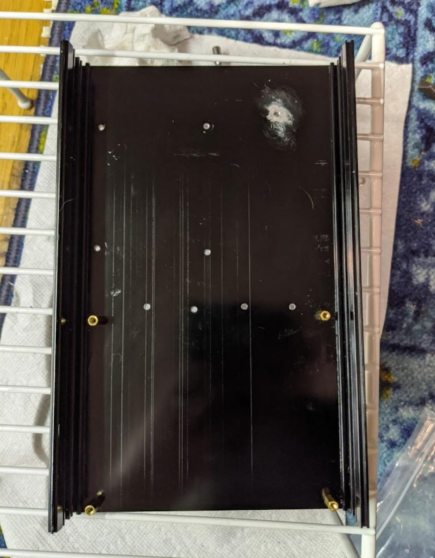

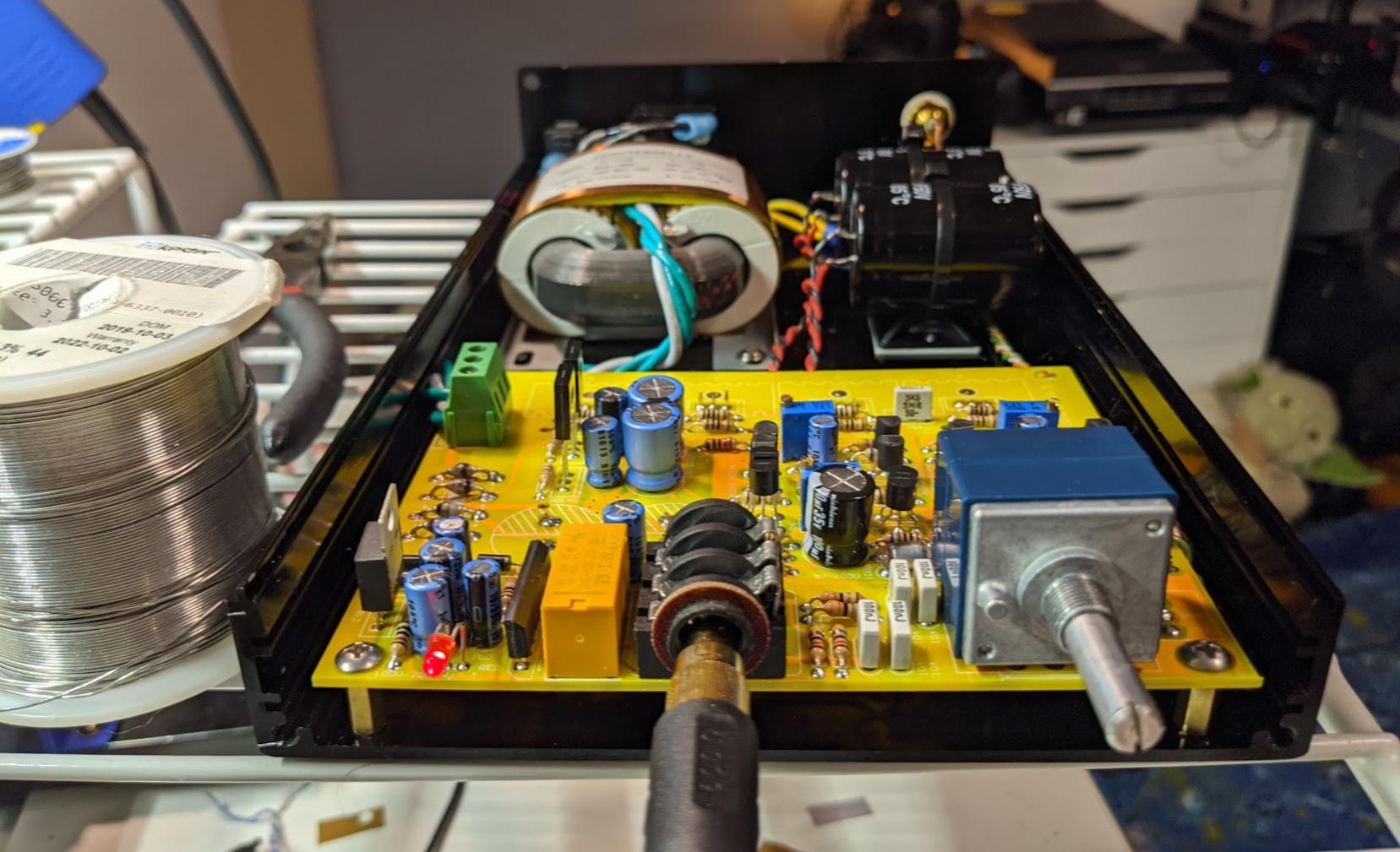

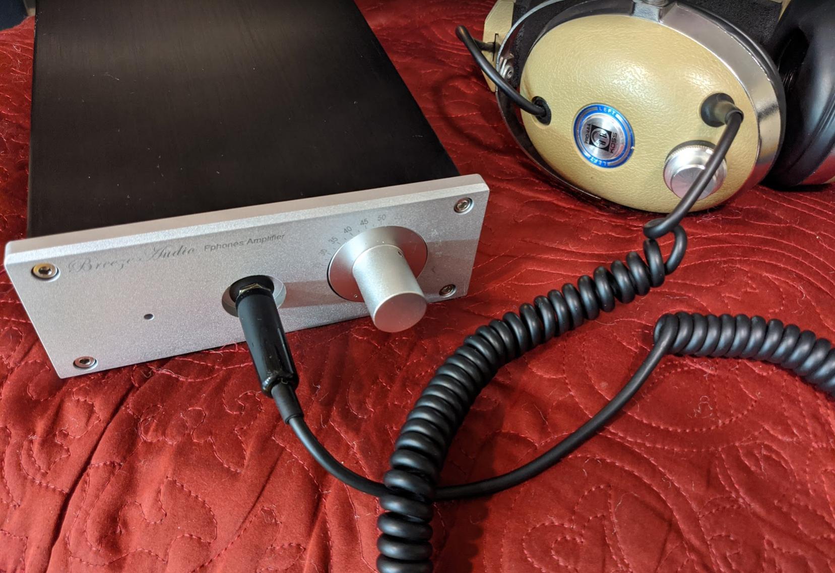

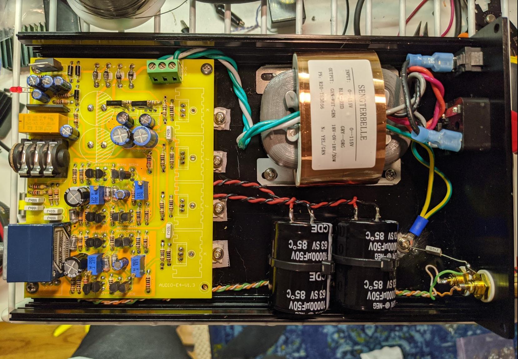

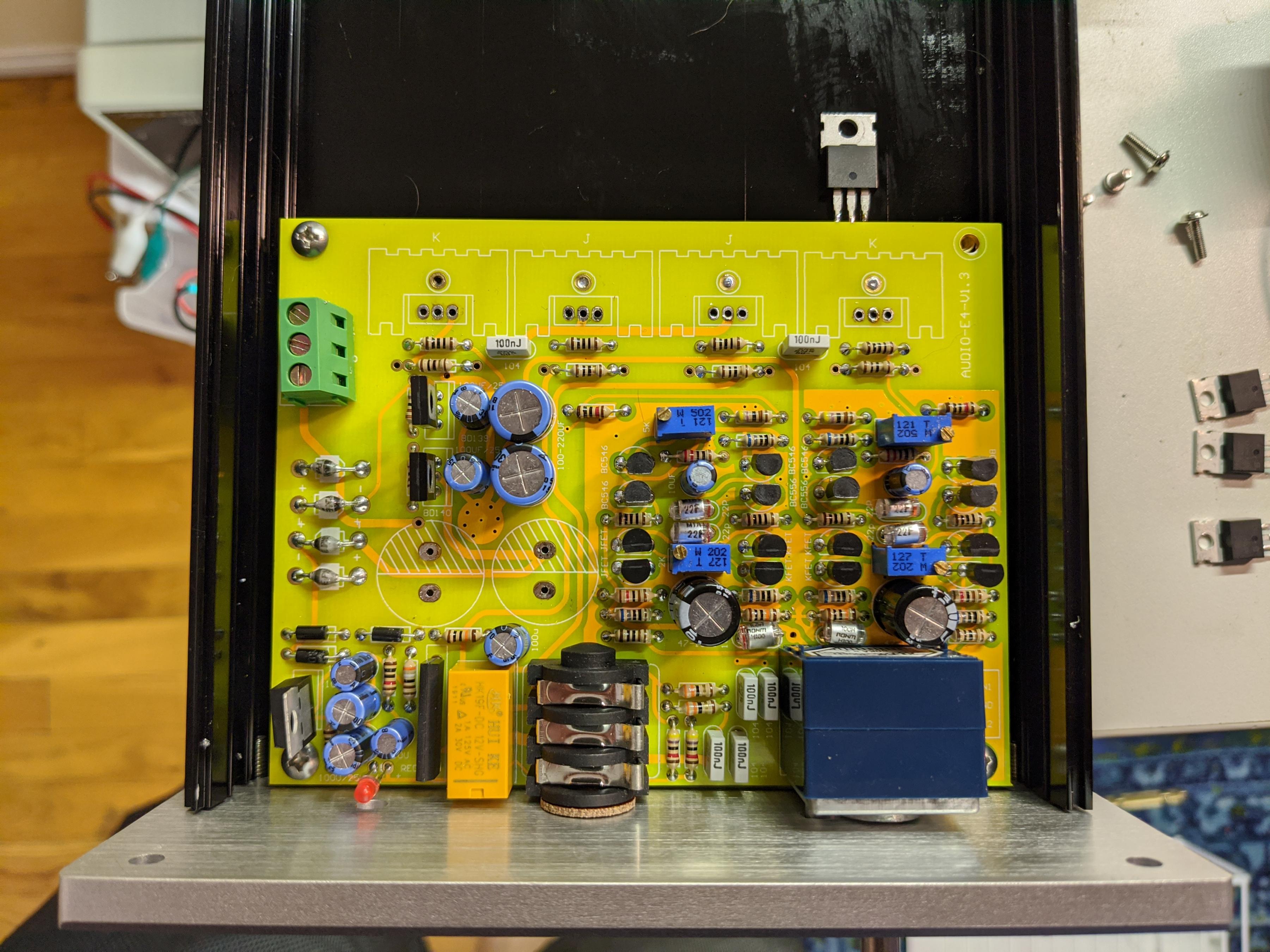

Build photos
Last week I finished the physical construction of the amp.
I drilled and tapped (by hand, with varying levels of success) holes for the PCB, transformer, and MOSFETs which are attached to the bottom side of the chassis. The chassis gets a little warm but not hot w/ 80mA of current in the MOSFETs.
My potentiometer is evidently not perfectly straight on the PCB, which causes some minor friction on the volume knob. Lesson learned here: PCB-attached potentiometers must be carefully aligned to protrude perfectly straight & centered from the chassis.
I picked up a set of 600 ohm Beyerdynamic DT880's and it drives them to high volumes with ease. Black background, no hum or hiss, seems to have good dynamics and bass reproduction. I'm happy with it. I'll probably leave the linear power supply as-is -- at least until the tinkering itch strikes me again. I'm thinking of building an OTL headphone amp to compare.

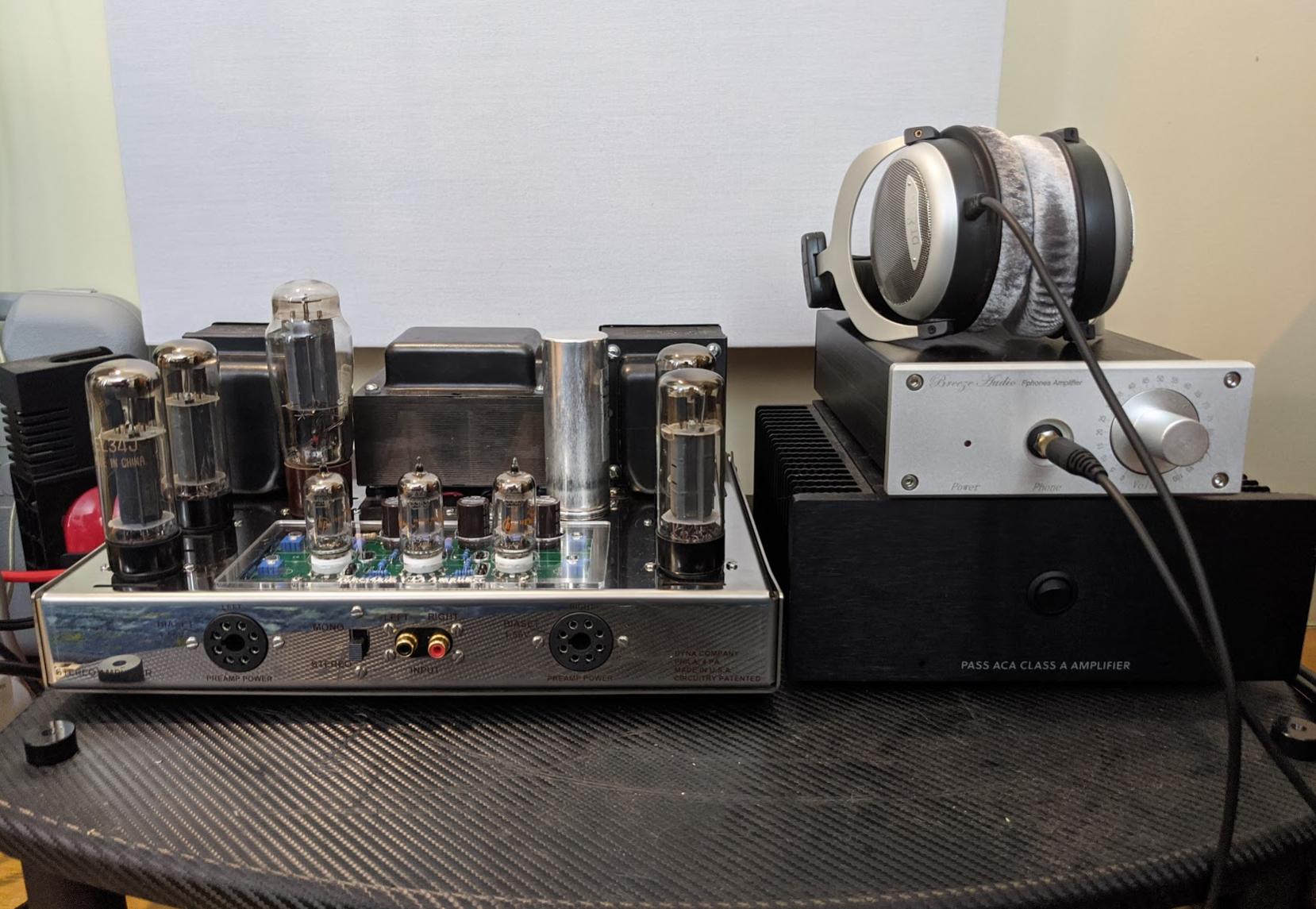

Hey keilau,
The ACA was my first amplifier build and I enjoyed learning on it. It sounds quite good here in a small room w/ big 3-way 90dB/1W/1M spec'ed speakers. Produces ample volume and satisfying imaging.
I will be the first to admit I am not particularly golden-eared, though, so I can't make any hyper-specific comments about the sound.
These days I do most of my listening on the VTA ST-70 pictured.
