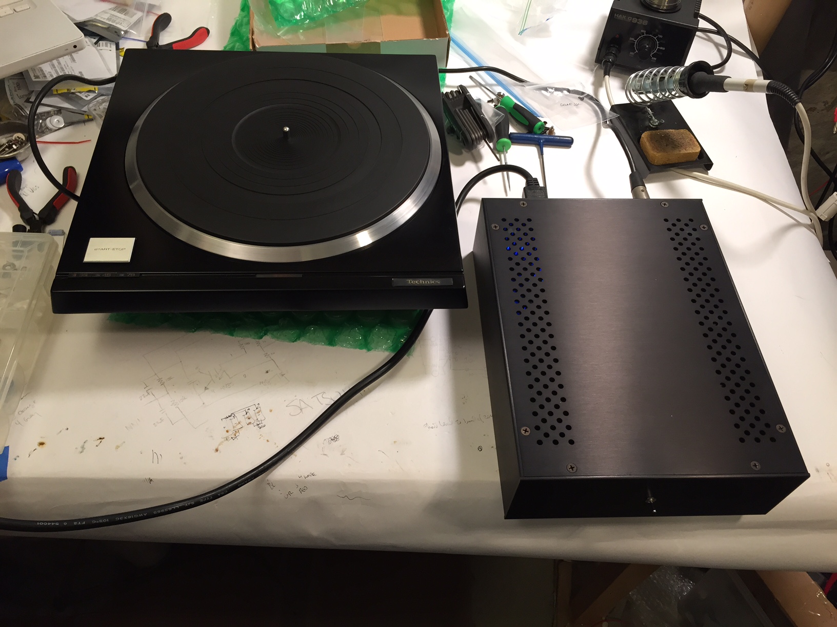

Looks great, what was the metal finishing process ?
I had the opportunity to talk to my brother-in-law Steve today, and got some clarification of what was done. The specifics are as follows;
Abrasive wheel to remove the old paint and corrosion.
Etching primer for aluminum
A 2-part 'glazing putty' was used to fill the deep bits
Then it was normal autobody process from there -
Prime
Sand
Paint
Clearcoat (a bit of flattening agent was put in the clear to cut the gloss to my specific request)
Back together and running smoothly -

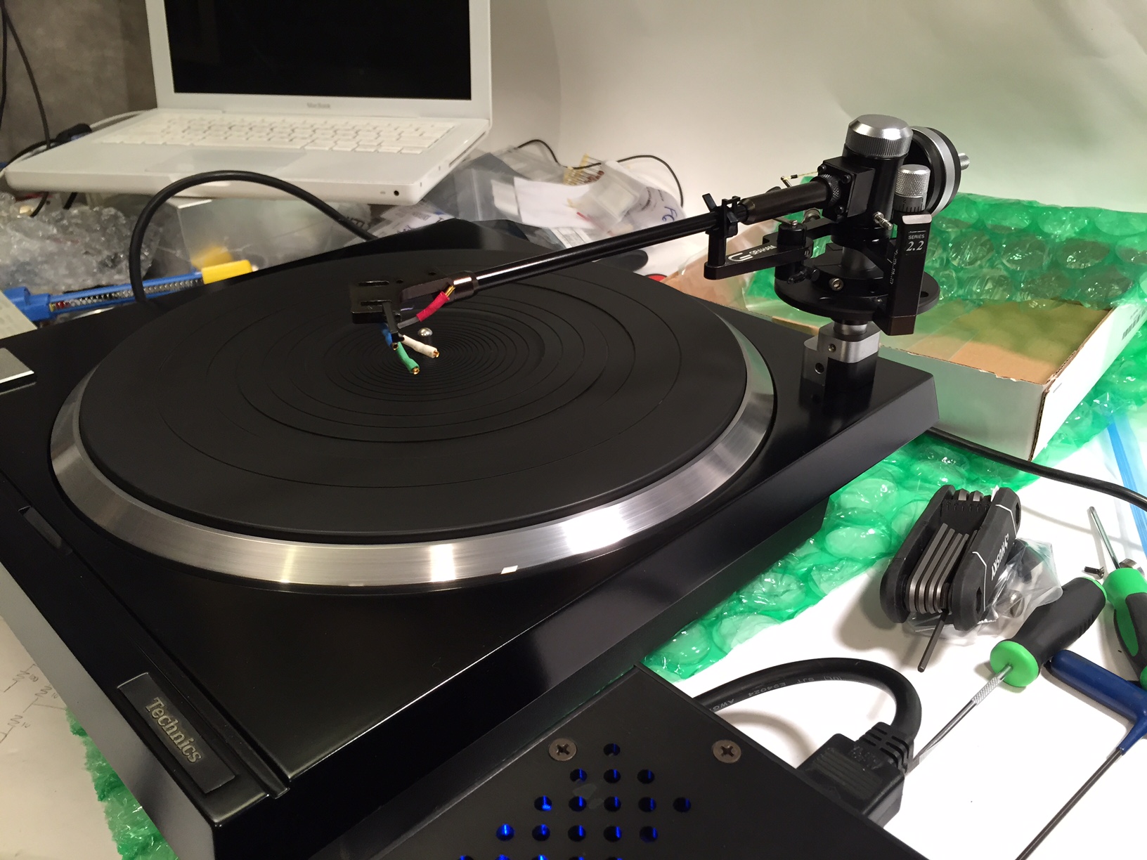

Here's the arm for it -
Next, remove the guts from the other one, send it to Einric_99 who is making the plinths, then get it repainted.
looking really good. I admire your ability with electronics.
I'm using a Graham 2.2 on mine. Happy camper.
