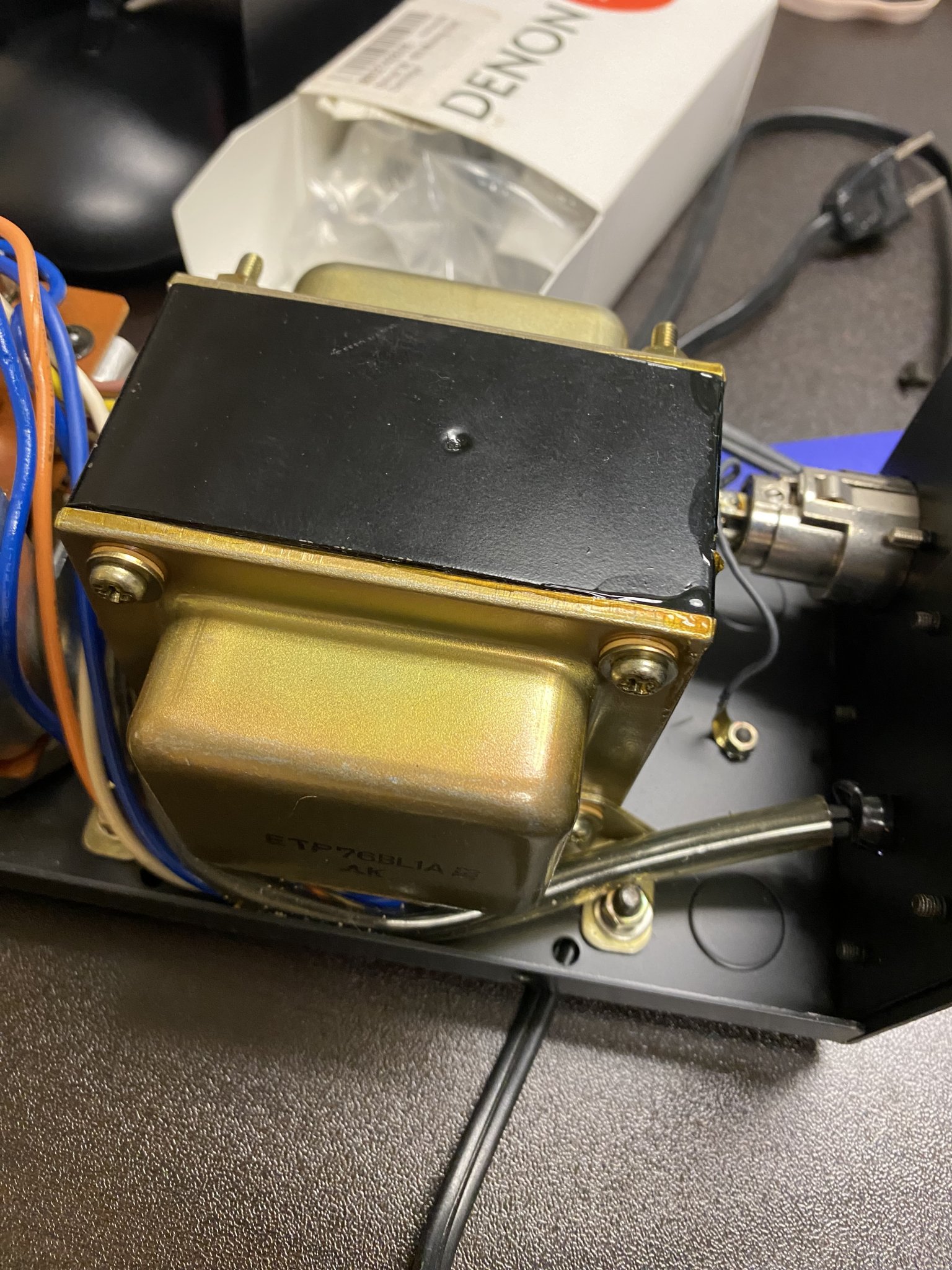

The rest of the screws in the unit are +2 size.
Those Vessel drivers are my go-to for everything now. Phillips are designed to cam out - these are not. Plus, they're JIS compatible.

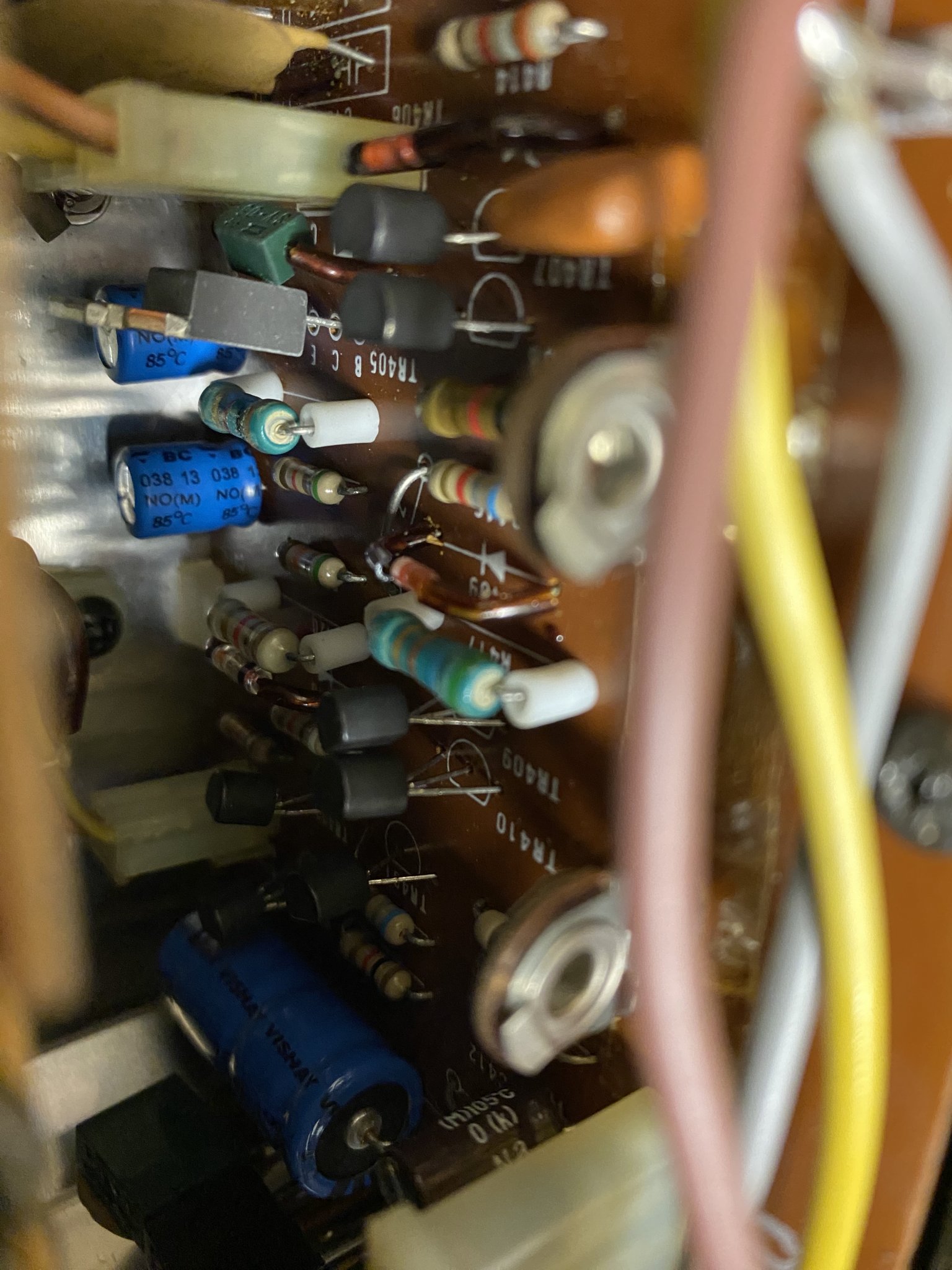

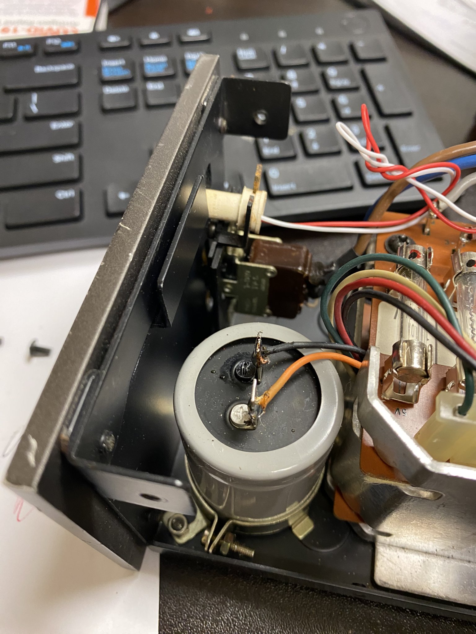

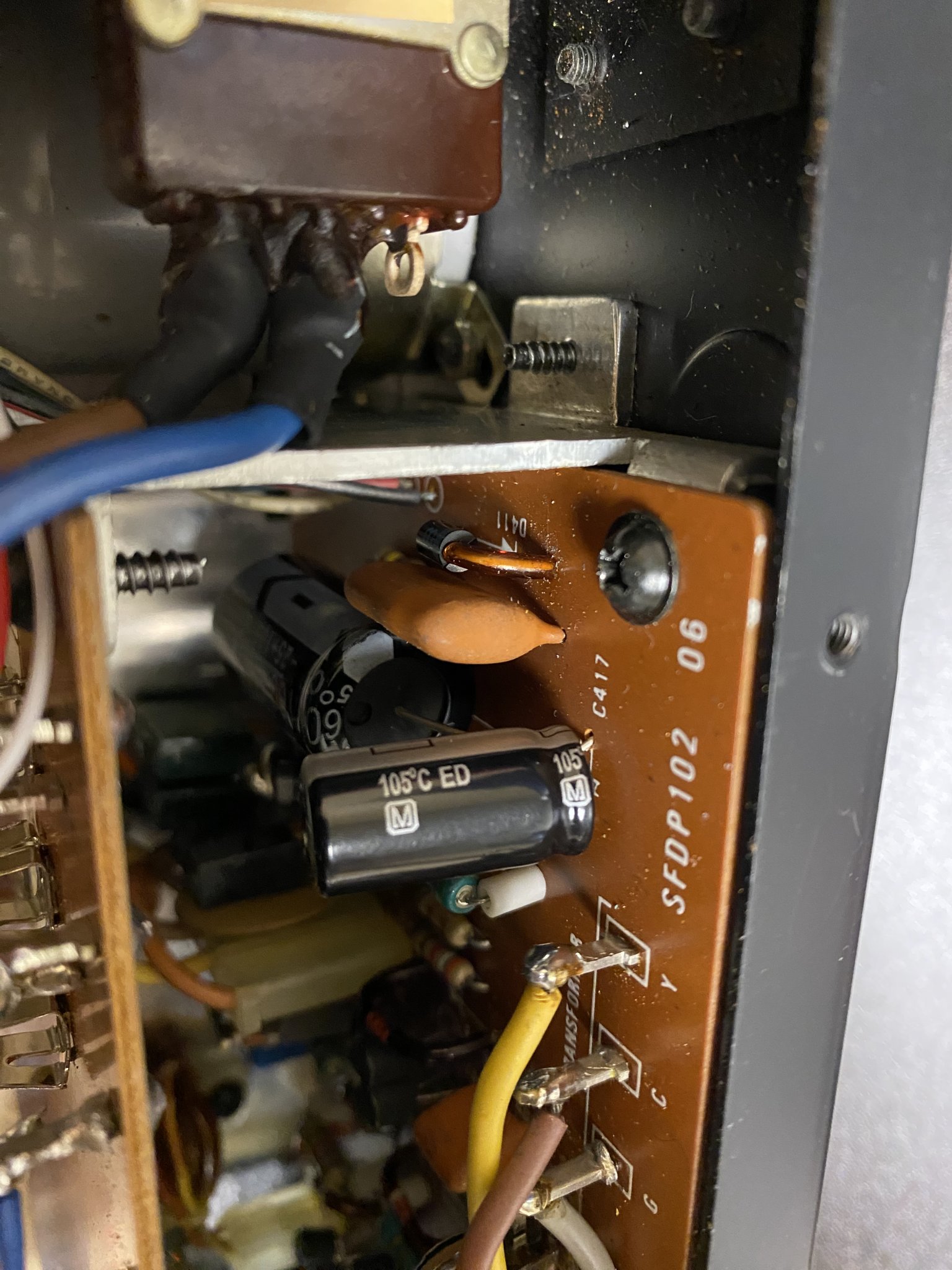

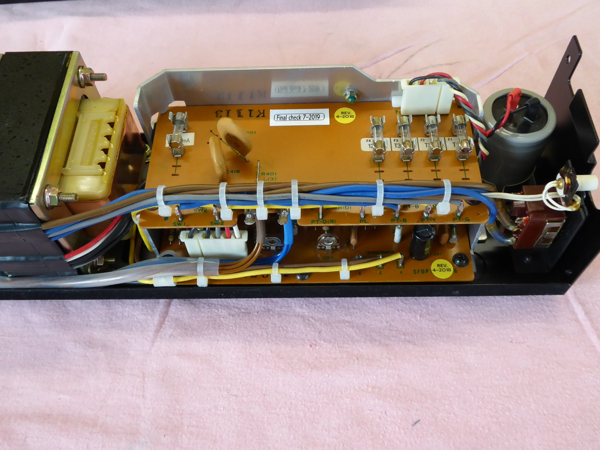

Yeah this driver is great, got in here just fine. Before I do more disassembly than necessary, I think I’m in okay shape in here unless I’m missing a clear red flag (new to this line of work haha)
View attachment 1132265 View attachment 1132266 View attachment 1132268 View attachment 1132269
Those caps have been replaced and look good no signs of bulging. The large cap is OEM and I'd leave it. Just check and adjust the 32 and 5V. Do this prior to plugging the PS into the SP10 then again after with the TT running, the reason I do this is if the 5V is way high it could blow the chips. I also switch the DVM to AC and check ripple on the 32 and 5V.

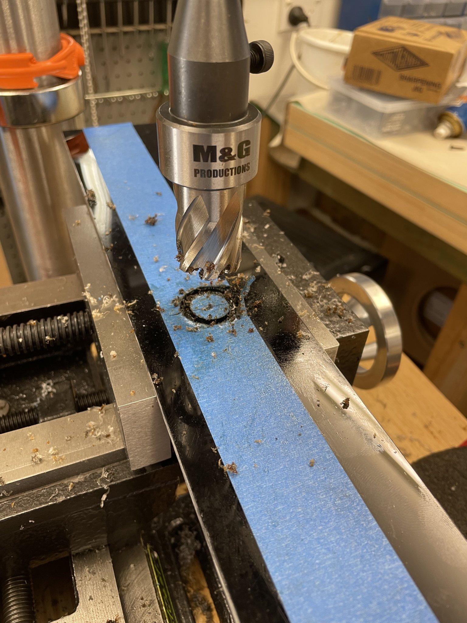

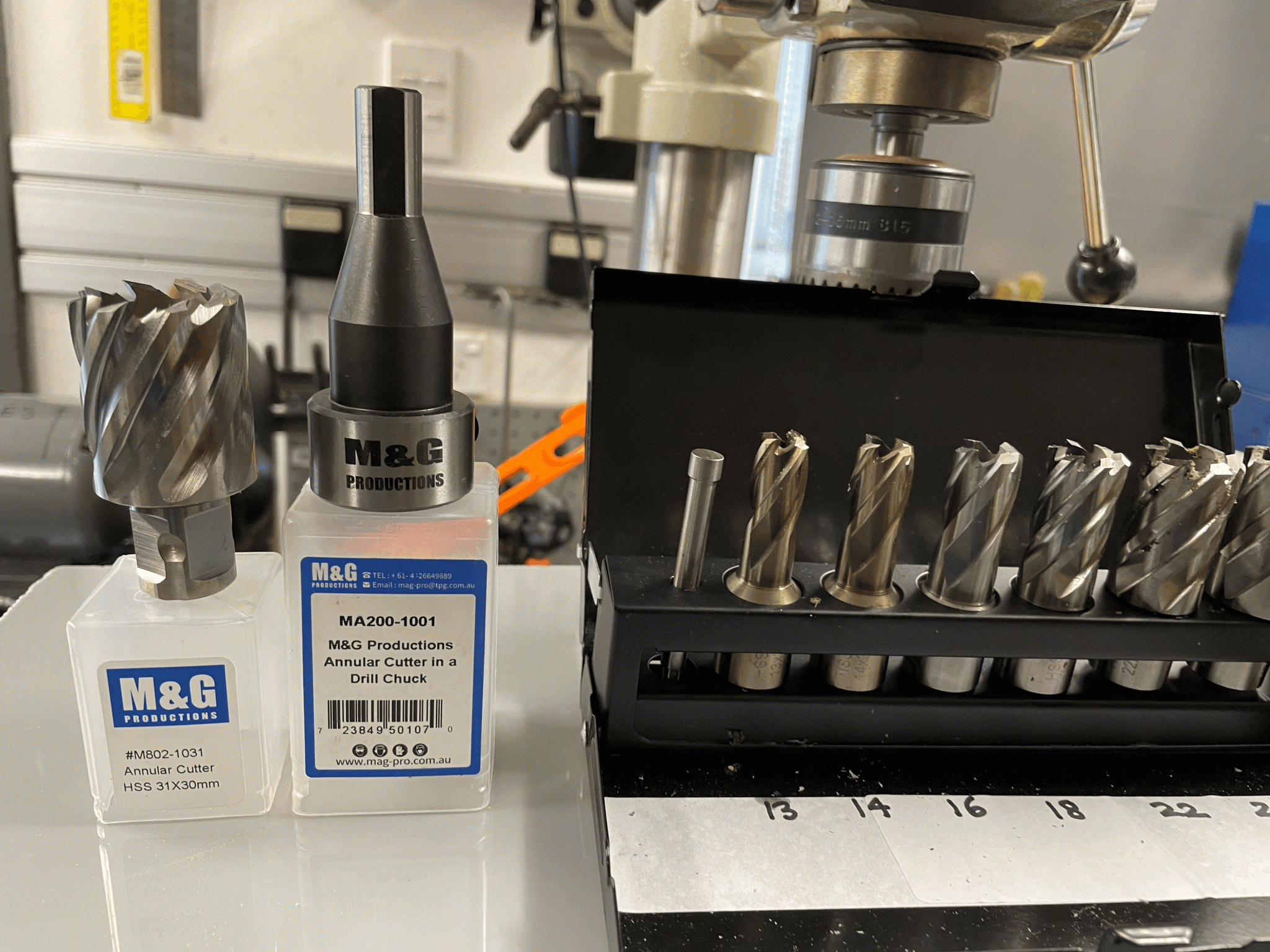

HELP! I need suggestions. I am working on two plinths. One is the Resin/Bento plinth. The tonearm is an EPA 100 which requires a 38mm diameter hole to mount the tonearm. The plinth is 28mm thick at the mount point. I thought I would drill it with a step drill but that is not working. The drill basically stalls out part way through and will not penetrate the material.
Looking for suggestions on the best way to drill the 38mm hole in the R/B plinth. I do not have a CNC machine to do it.
Thanks,
Don
Thanks,
Don
@Don
Annular cutters are very efficient at cutting large holes in difficult materials because the cutting area is much smaller than a conventional drill bit. You will need an adapter for the drill chuck. The plinth needs to be held down securely. I suggest practice with a scrap piece and watch a few Youtube videos.

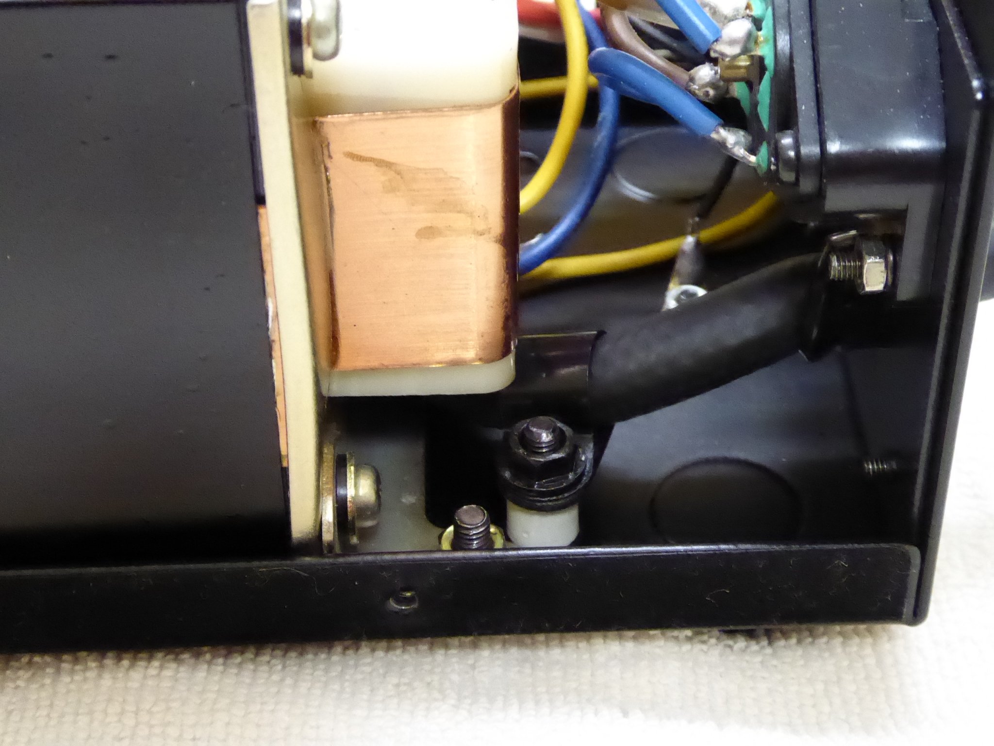

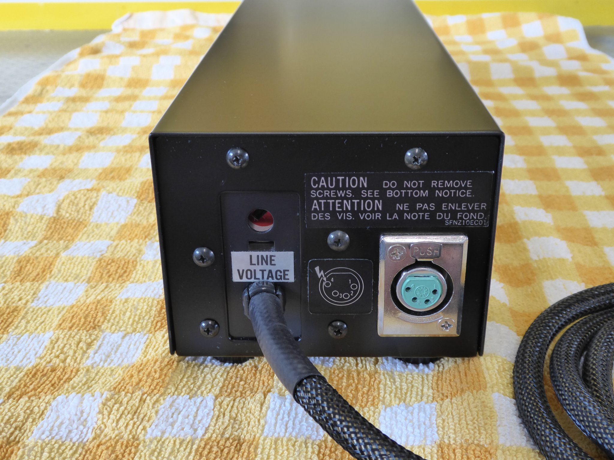

if you believe in the sound of the power cables or if you want to improve the original one without making invasive changes to the rear panel, you can easily do it.
Here you see some VDH Mainsserver power cable.

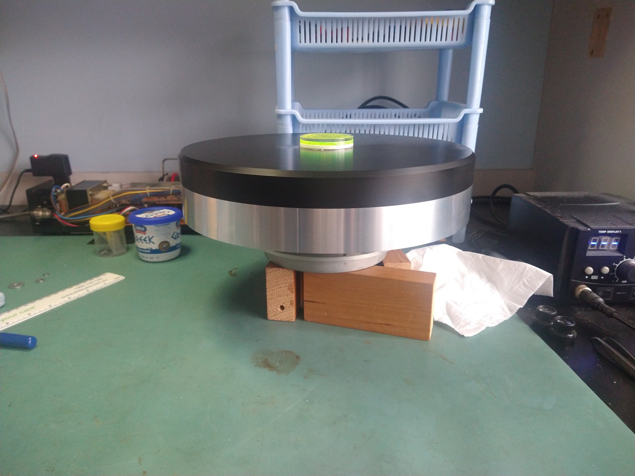

Here is a preview of my inverted bearing SP10mk2 motor. The platter not yet properly balanced, this will be done with the magnet and FG mounted in the rotor.
The platter is currently spinning on a 2mm SI3N4 ball inside the platter. There is currently NO sleeve so the platter is spinning balanced on the pivot point only. Once I have the platter balanced a very thin ring will be added in the rotor as a sleeve to prevent the platter tilting.

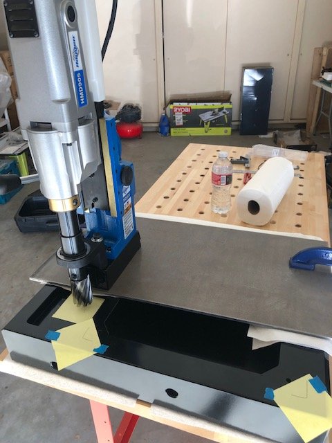

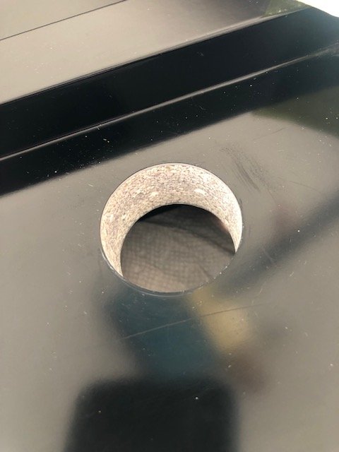

Good news, bad news.
I drilled the 38mm tone arm hole. Used an annular drill bit and mag drill. Worked perfectly. Dead nuts on location and a perfect hole mic'd at 38.11mm using a 38.1mm drill (1 1/2"). Whole different world using the right equipment. Thanks for the tip Bon. Pics attached.
Now the bad news. I totally screwed up the Tonearm elevation. I have to rework that part of the plinth. Top and bottom surfaces since I need to maintain appropriate material thickness for the tonearm mount. Then repaint it.
