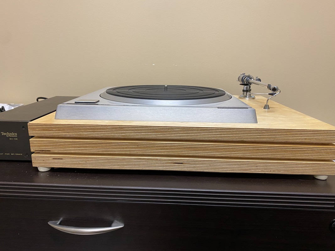

Well, I’m 50 pages in trying to learn along the way. Just adopted an SP10 MKII of my own. Comes with a birch plinth and Grace g560l tonearm, power supply and possibly more have been re-capped (previous owner not totally sure, had a tech do it and says he bought a kit,) so I’ll probably be opening it up soon to take a look for myself. Maybe I’ll find out as I make my way through the second half of this thread, but I’m wondering if anyone has anodized the base or platter? Anywho, back to reading!

Sounds good. Have a stock Denon 103 and a headshell ready to go once I confirm it’s on speed and no caps are ready to kick the bucket. And nothing says I can’t give the visible part of the platter a nice spit shine though, right?!
Looking back at your plinth has me thinking about weighing down my birch until some day in the future when I’d be ready to consider Panzerholz. So much information and inspiration in here, thank you for birthing it!

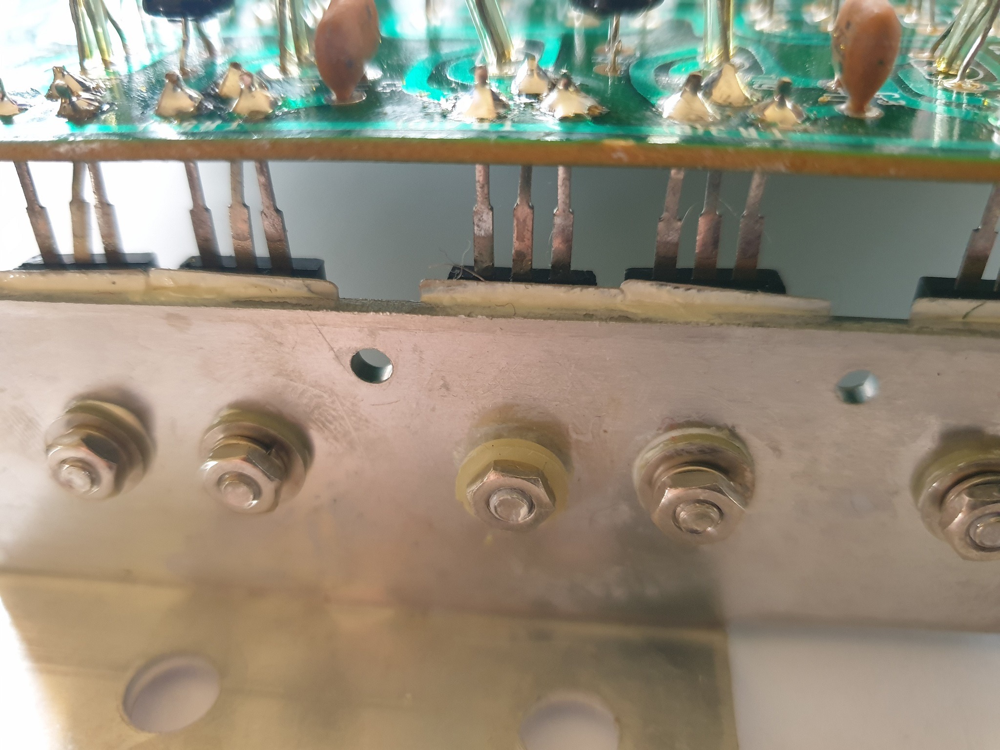

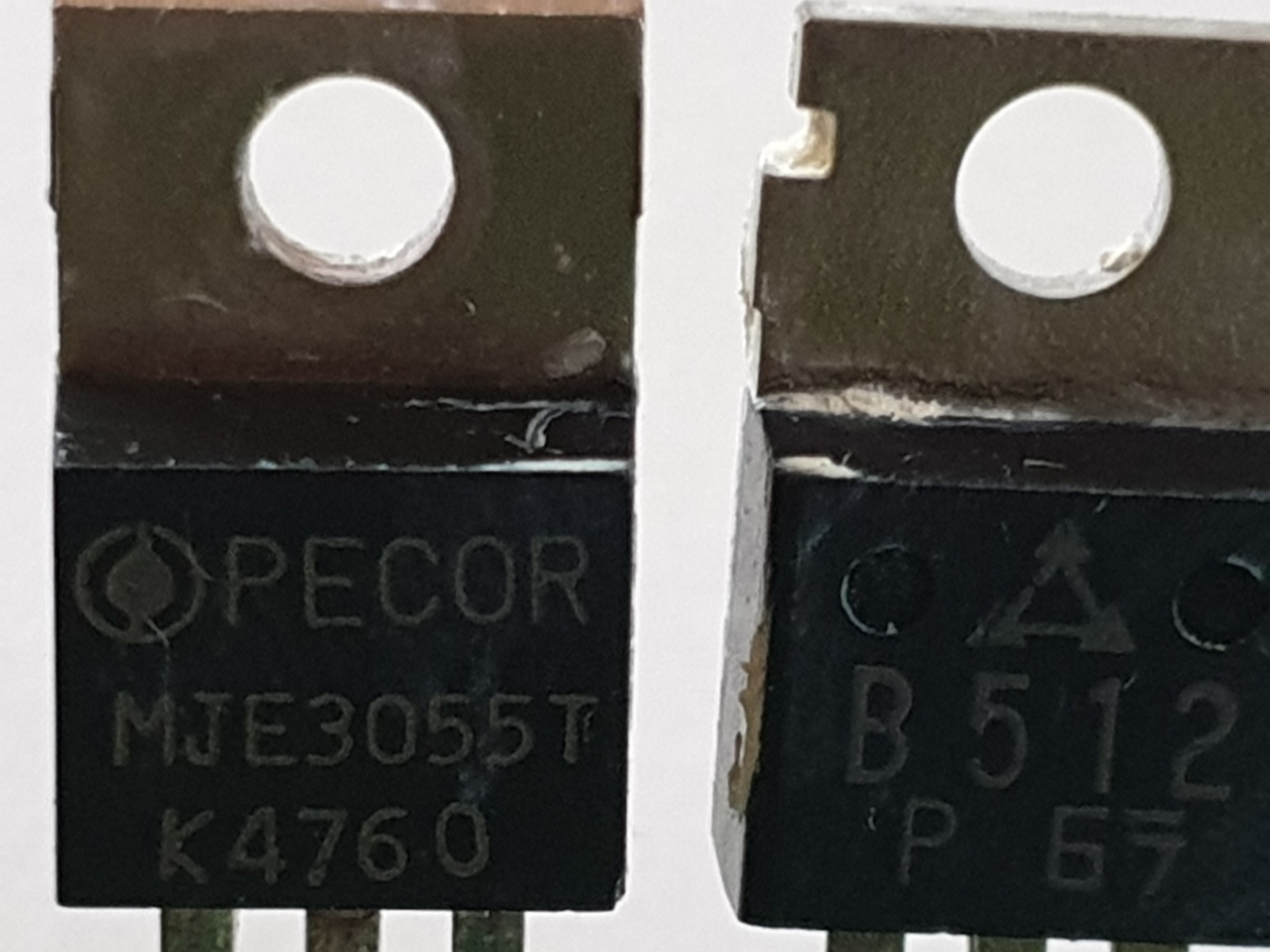

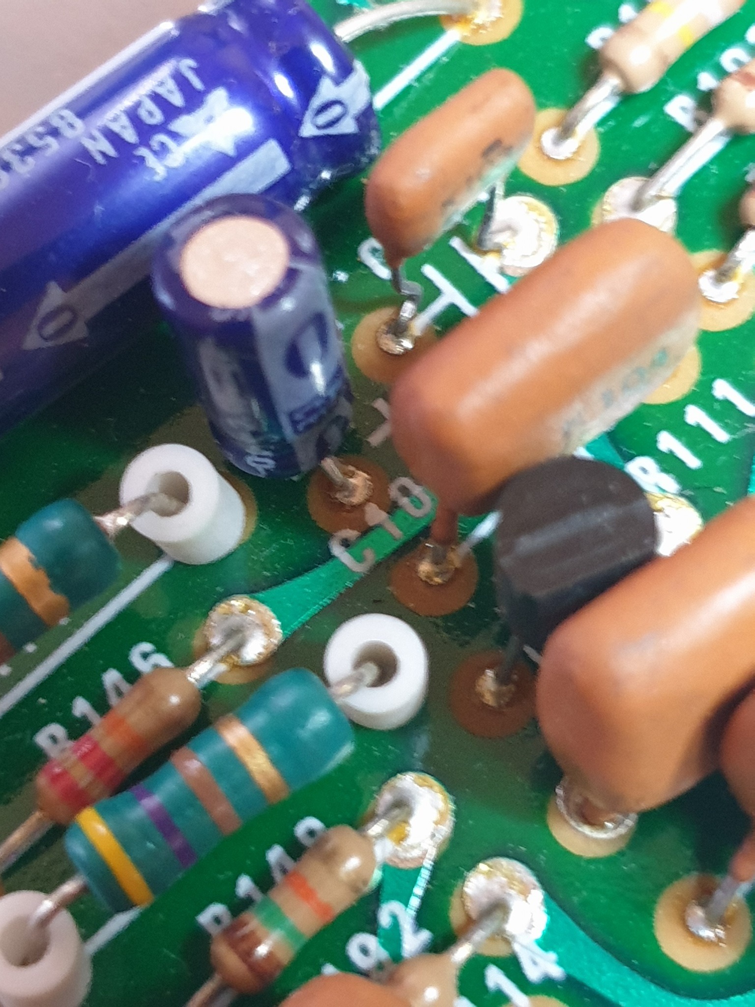

It's a good idea to check the PCBs even if they have been recapped. I am currently refurbishing a SP-10 MkII that had been recapped and the drive transistors replaced. C106 had been installed back-to-front, sending the FG signal to ground, and one of the 2SD389 transistors had been substituted with an MJE3055. Some of the shoulder washers holding the drive transistors were not properly seated. The thrust pad needs changing but otherwise the turntable is in pretty good condition.
This is a common issue I see with SP10's serviced by DIY. I repaired an SP10 recently where the large cap in the power supply was replaced with one with screw terminals. The tech soldered the wires into the terminals compromising the capacitor the SP10 worked for a few months before the cap gave out and caused all maner of platter rotation issues.

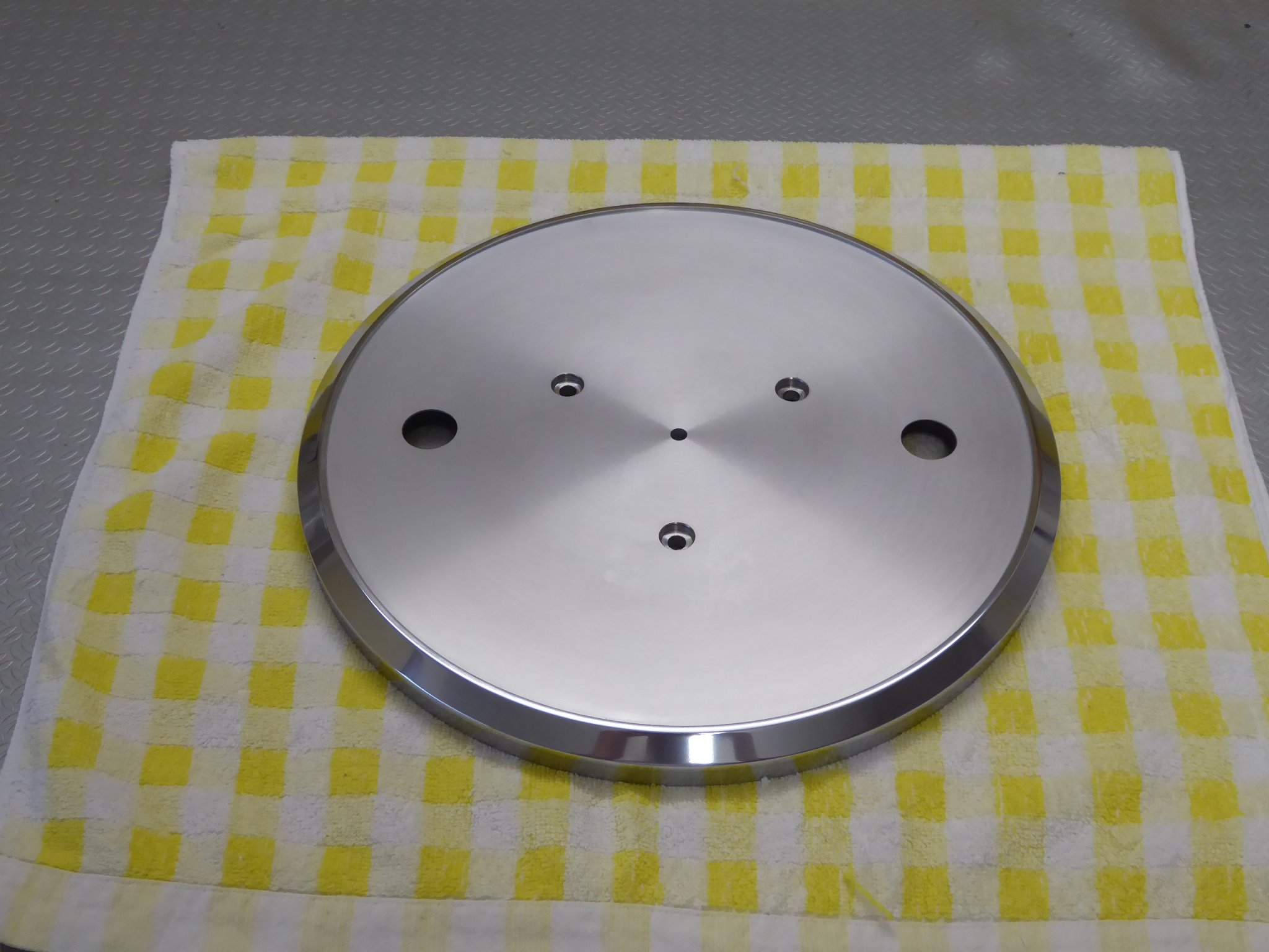

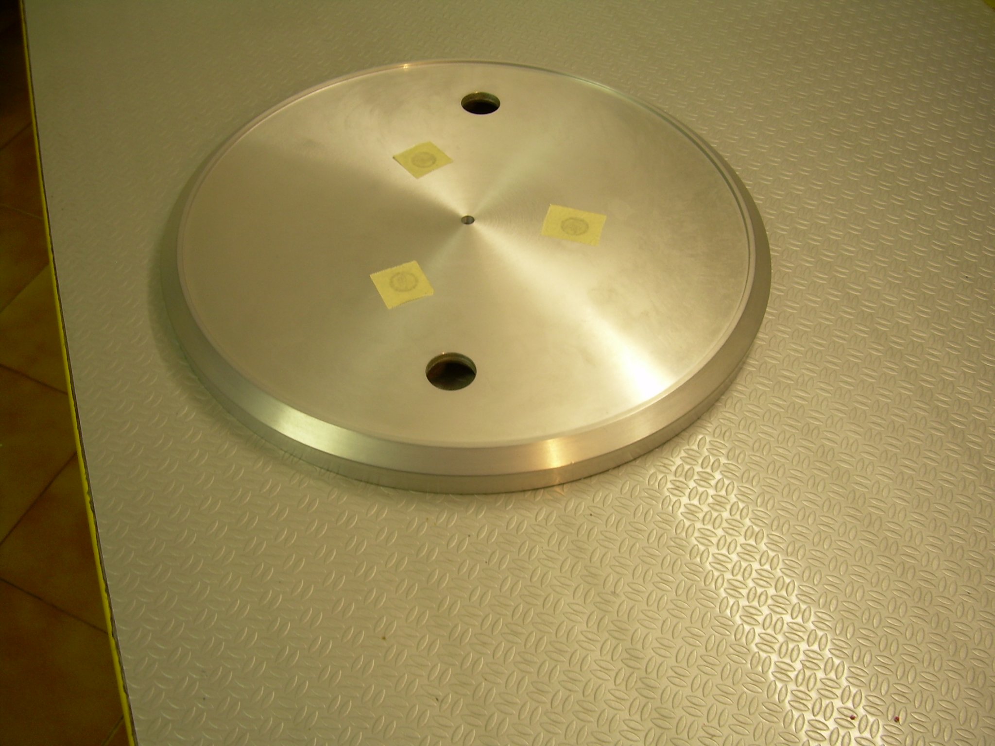

Hi,the base cannot be anodized as it is not aluminum but zamac and the zamac can be finished with a brushing but it is not possible anodized; for this reason the turntable was originally protected with varnish.
Perhaps the plate can be anodized but it is better not to do it, instead polishing it is possible and in my opinion much more beautiful.

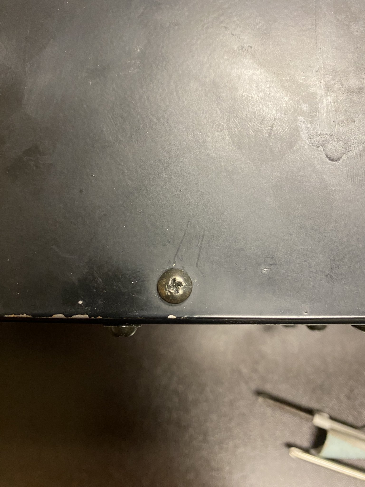

This is the silliest of questions, but unfortunately it’s the second time I’ve run across this issue with vintage electrics in recent history. When reassembled they used a thread lock, and my experience with these small machine screws is they are soft as butter and strip way too easily. Any suggestions? I don’t want to start experimenting with anything and risk damaging things.
You sure? That's a really odd thing to do.
Those are very soft. Recommend a properly sized JIS compatible driver like a Vessel +1: https://www.amazon.com/Vessel-Megadora-1x75-Screwdriver-900-1-75/dp/B000TGAMC6

The first one came out with that tell tale ‘snap’ of a screw with old thread lock, did not back out easily. That or there was some moisture buildup where it was stored and maybe some residue set in, but I’m at one for three on successful removal right now and starting to strip a bit so I stopped.
The 'snap' is from thread stiction. I find all the fasteners on the PSU cover do that and I've never seen any indication of thread lock.
