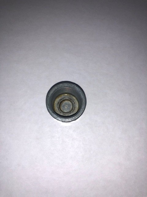

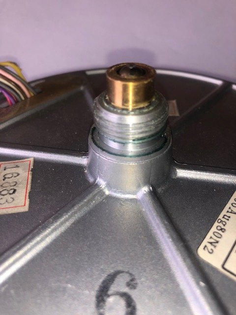

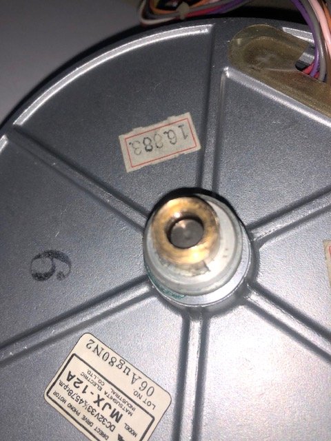

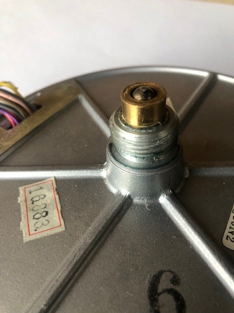

I prepared for a tussle getting the end cap off. I used Bons system to hold the motor and put heat to it with a propane torch. It unwound with virtually no force. Nothing like getting the locktite to release. Pictures attached.
I then tried to bonk the thrust ball out per 6L6's post #878. No go.
I used bamboo skewers taped together and even hitting them with a hammer it did not release.
Need suggestions. I don't want to force it. looking inside the cap it looks like both the sleve bearing and the ball bear on the cap. Do I need to take the bearing out?
Don

No you don't need to take the bearing out. I use a bit of hardwood dowel down the top of the sleeve. I place the bottom of the sleeve on another bit of hardwood with a 7.5mm hole in it this prevents the sleeve from exiting the motor housing and the ball can fall on the bench through the hole.
