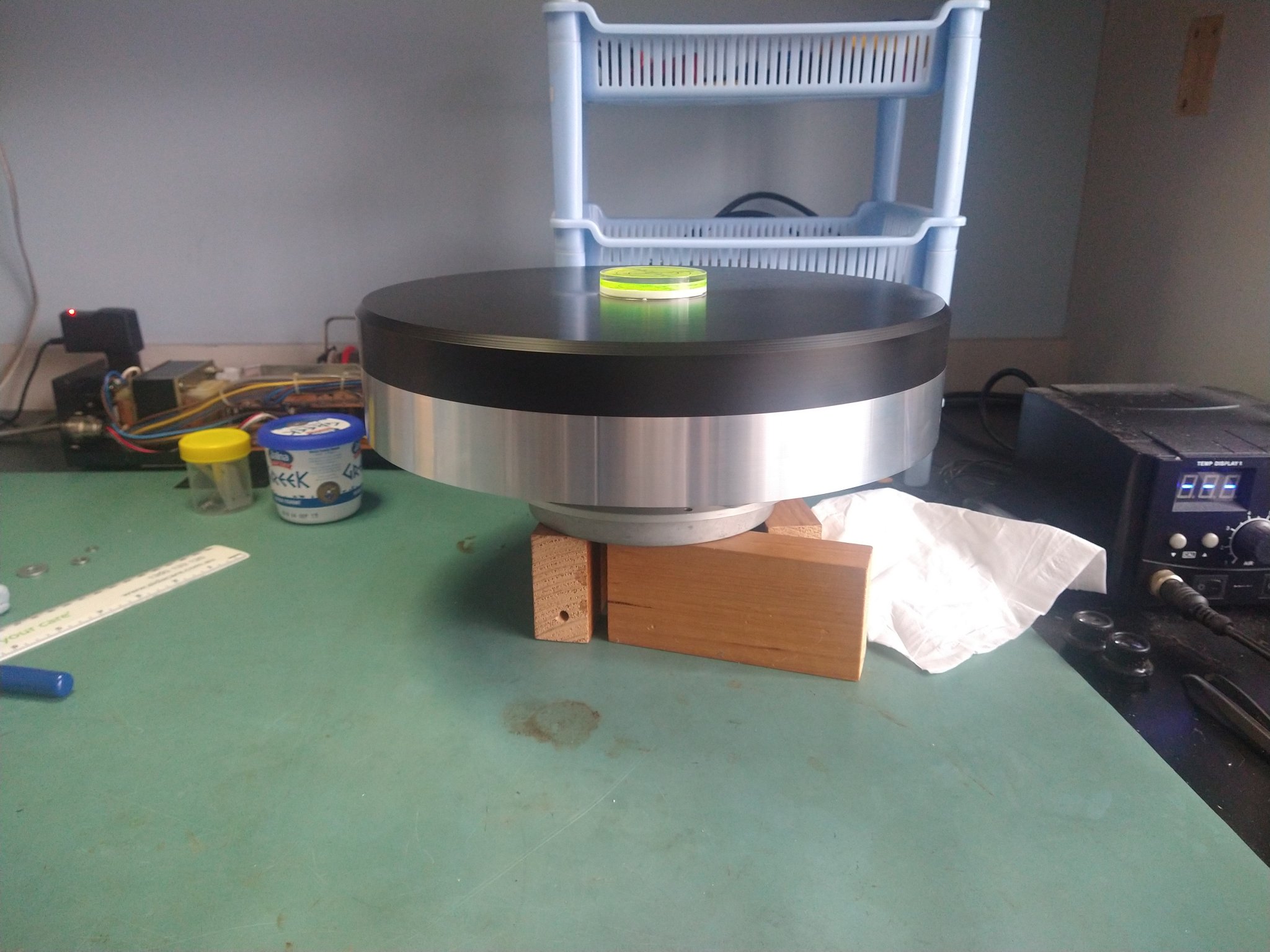

The platter was designed after calculating the sound energy traveling through the POM and Al. The thicknesses used are to spread the energy returning to the stylus. POMC also has better attenuation of energy than acrylic.
The Al is there to increase rigidity and POM has similar acoustic impedance to an LP, so energy created by the stylus in the groove passes easily into the POM.
If all goes well and I don't get side tracked I should have it up and running in a week or so.
With the platter resting on the bench and a stethoscope on the POM tapping the bench there is no sound in the platter so it has good isolation. Even tapping the Al the sound is well damped hardly a dull thud.
Here is a preview of my inverted bearing SP10mk2 motor. The platter not yet properly balanced, this will be done with the magnet and FG mounted in the rotor.
The platter is currently spinning on a 2mm SI3N4 ball inside the platter. There is currently NO sleeve so the platter is spinning balanced on the pivot point only. Once I have the platter balanced a very thin ring will be added in the rotor as a sleeve to prevent the platter tilting.

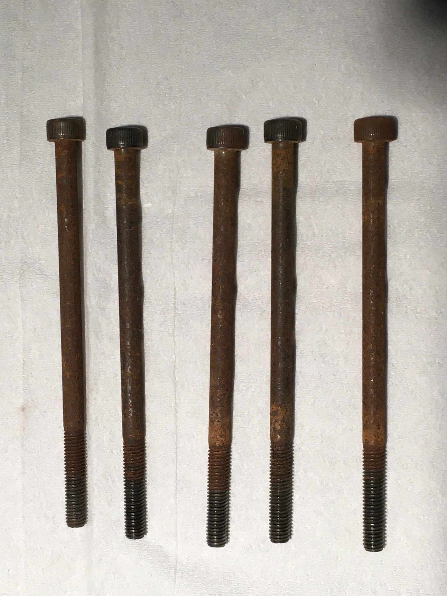

For peace of mind I use 304 stainless fastenings where possible. I found hardened steel bolts through resin/bento corroded over time.
I concluded the resin outgassing is corrosive. Since densified wood products like Panzerholz, Permali etc are resin infused, they may also be corrosive to hardened steel, although I have not seen such reported. Where the resin/bento is sealed with many coats of primer/paint/clearcoat I have seen nothing of concern. It is only the through holes into the raw material where I notice the problem. Nothing to report since using 304 stainless bolts/nuts/screws.
Here are 5 mkII bolts after about 5 years in a resin/bento plinth. The end threads and hex caps outside of the resin/bento are unaffected. The replacement 304 stainless hardware are still perfect.
