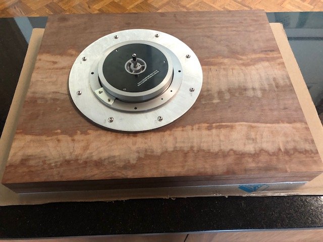

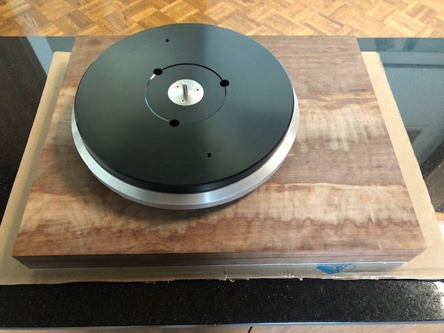

Making progress. I actually got my motor mount ring mounted on the Pz. A critical phase since the axis of the 2 Pz pieces and the motor mount ring had to be precisely co-liniar. A requirement to not stress the spindle axis. Now it gets to the tone arm install. I'll post separately on that. Pics attached.

Don, You can cut a hole in the Pz for the arm mount. The other alternative is to mount the TA so the CL armboard hangs over the edge of the plinth to give access to install the cable in the bottom of the EPA-100.
My LP surface is 4" above the top of the plinth and I don't have room to install the cable in my EPA-100, 5" would give clearance.

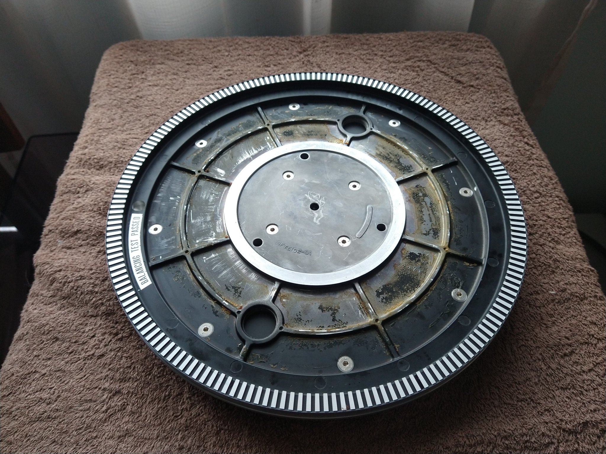

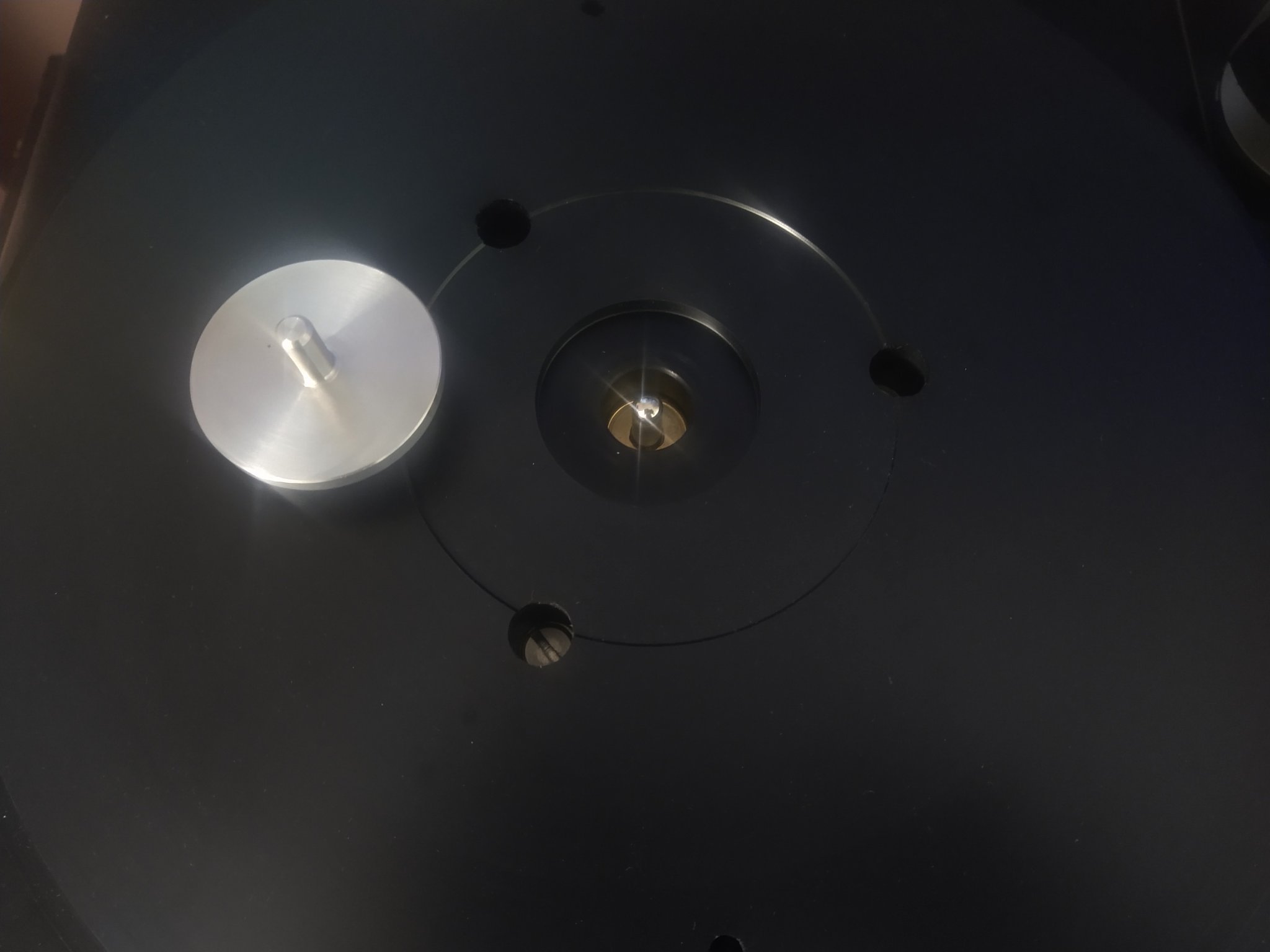

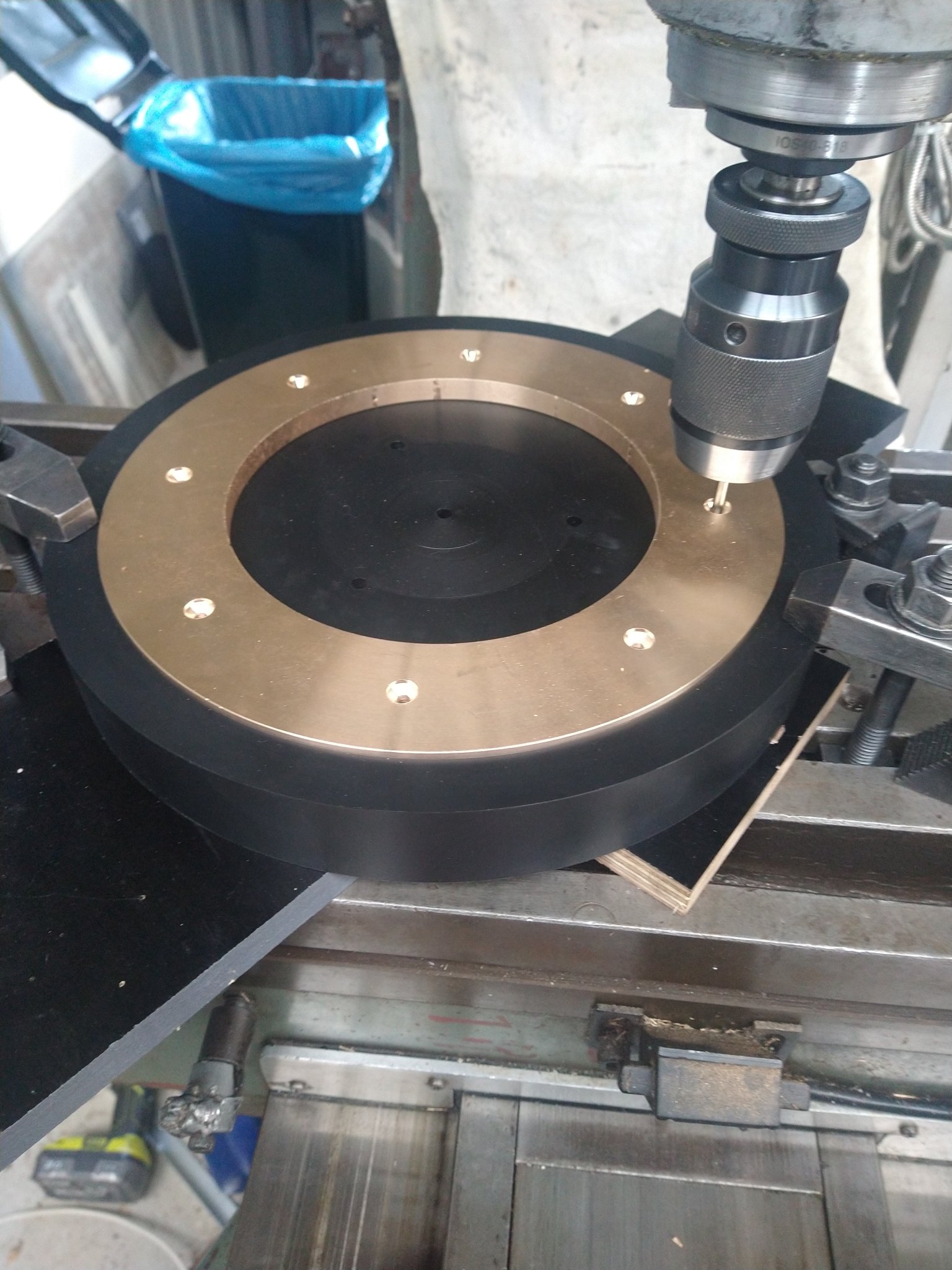

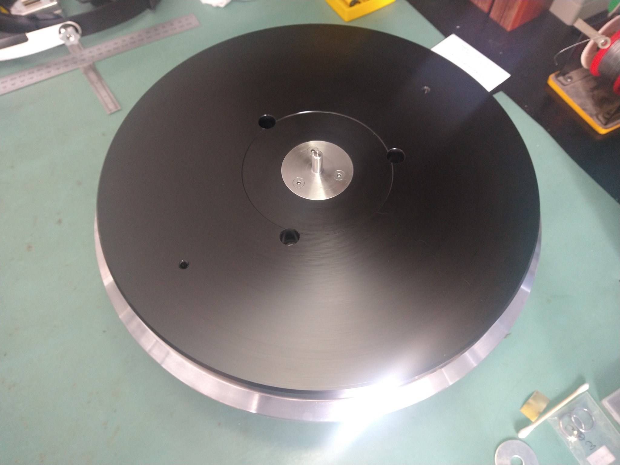

I do have a dxf of the OEM/POM platter, which I use mainly for measurements, but I have no instructions. Do you have machining capability?
The POM is machined flat and bolted to the platter after the OEM rubber is removed. 2nd pic shows an early decoupled spindle and the 3rd pic is a recent platter the decoupled spindle is fixed to the POM so a reflex clamp can be used and the POM edge is chamfered at 50deg rather than stepped to prevent fluting.
The top of the platter also has threaded holes for lifting the platter as it's almost impossible to remove a platter from a chassis without them.
