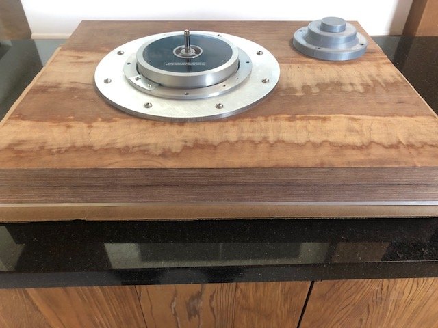

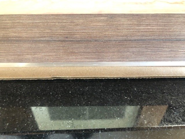

I glued the Pz together this weekend. Like everything diy, I am always nervous how it will come out the first time. Try to be prepared. I am real happy with the seam. Good thing, there is no undoing this step.
Next is mounting the motor and TA. Then the wiring. Then I get to turn it on. That will be nice.😀

Looking at your Pz there are lot more layers than my Permalli.
One thing I have found with the Permalli plinth and POM platter is lower acoustic feedback. Play a CD or other music and place a stethoscope on the stock platter mat and I can clearly hear music in the platter and stock SP10 chaasis and the resin/bentonite plinth. My Permalli plinth and POM platter there is no audible music listening with the stethoscope.

That is the B25. 41 Layers according to the lady at BKB. I think B15 has 26. I think that is for 25mm. I have no idea what the acoustical differences are. It looks cool though. 😁 The edges are perfectly smooth when milled.Looking at your Pz there are lot more layers than my Permalli.
