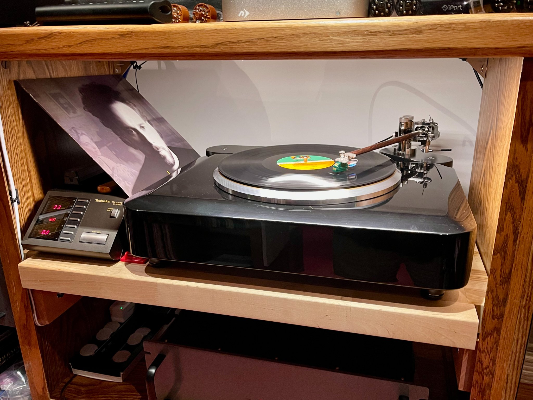

I have a Mk3 in a custom plinth. The plinth is roughly of the same size and dimensions as most that one sees.
I am seeking a maker of the flat-type dust covers. Probably don't need anything custom-designed....I suspect any that fit the usual Mk3 plinth tables will suit me as well. Just need a quality source.
