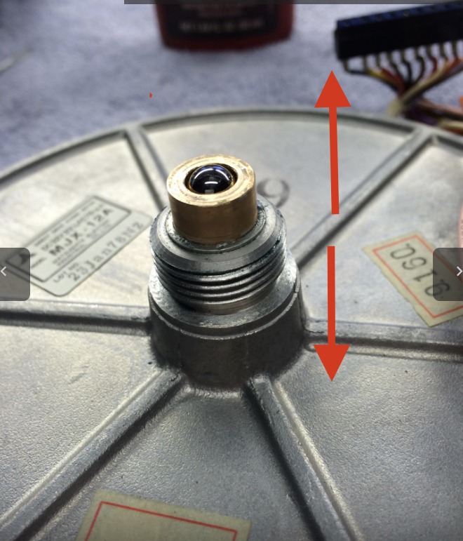

Trying to change thrust ball and the pearling cup. Unscrewed bottom metal cup and now facing 3 problems:
1) have no idea how to get the ball out.
2) have no idea how to pull the rotor out to get the the bearing cup
3) do I need to add any lube when I put new thrust ball in?
Could you please advise on these specific steps? As they are not described in details I assume it should be straightforward. Thank you!

1. Hard wood dowel, soft brass drift, etc. Best to support the brass bushing - if the ball is stuck you could knock the bushing loose if you support it by the motor frame. Easy to fix if you do but best to avoid. However, you're won'e have access to pop the ball out if the rotor is still in place...
2. Pull the two rubber caps to access the screws for the retaining plate that prevents the rotor from lifting out. Once that's off just lift it out.
3. Of course. You should make sure the shaft and bore are very clean (lint-free wipes, etc.) and apply fresh oil. Technics oil or Anderol 465.
4. Reassembly: #69

So does it supposed to go up or down (with respect to this orientation)?
I'll chime in since I had a tight ball. I posted on the removal a while back but can't remember the thread #.
1. Your last post about the brake is confusing because it is assumed that you removed the motor in its entirety..
Start there. Take the entire motor out of the chassis. The 12 pin female connector will have to be unconnected from its male counterpart in the chassis.. You should have nothing but the entire motor with the motor wires and 12 pin female connector.
2. Remove the bearing cap. A whole different discussion
3. Remove the small plate on the mounting flange. It may or may not have rubber caps on it.
4. With the motor right side up, grab the spindle and pull the the rotor out. The dowel goes down the spindle hole.
5. The ball sometimes is very stiff in the hole. The motor should be rightside up for this.
a. Take a wood block and drill a hole in it a little larger than the 9/32in ball. That way you can rest the sleave on the block to take the load when you knock the ball out.
b. Make a hardwood dowel that goes down the spindle hole to the ball with enough length you can hit it with a hammer and not hit the motor. It should be a true hardwood. I used ipe.
c. Rest the motor on the block with the ball over the hole.
d. Hit the dowel with a hammer. You can start semi light and increase the "power' of the hit as you go. It will come out. Mine took a fairly good hit.
All this is discussed in the thread. I recommend you read it.

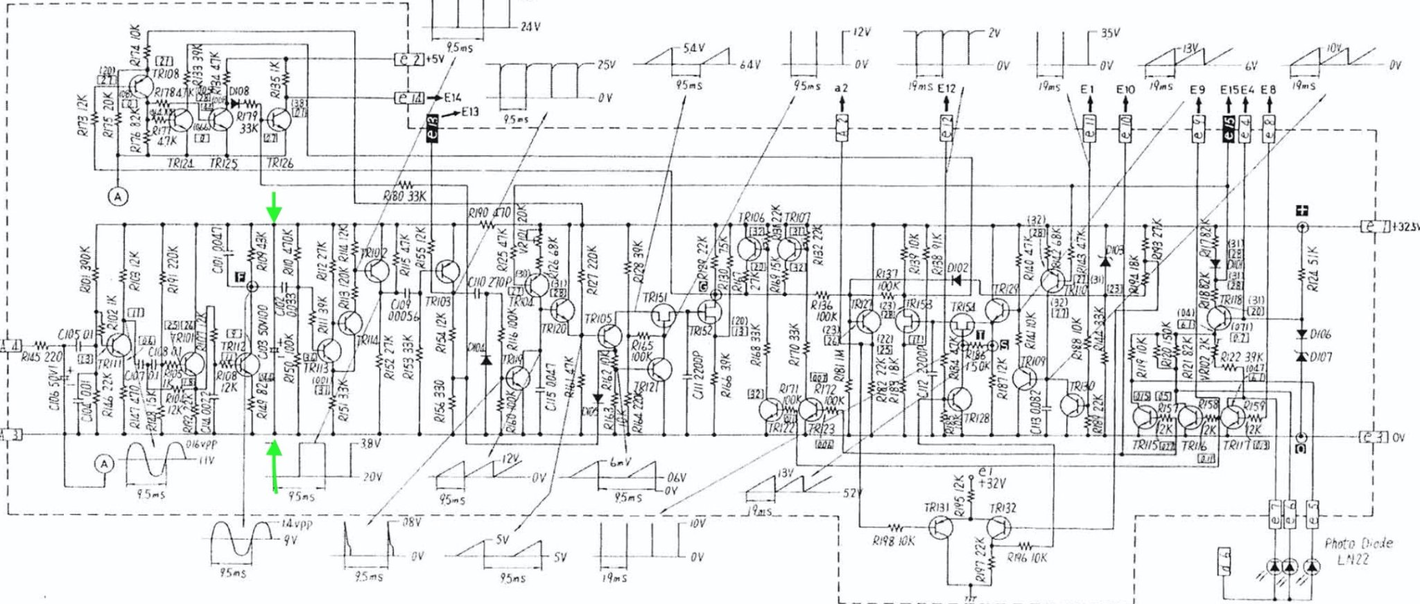

Grr... started assembling and discovered that I forgot to replace C103 on the Control Circuit board. It is 5V 100uf. I only have 330uf on hands and wanted to run by the community if should be ok dripping that one in?
