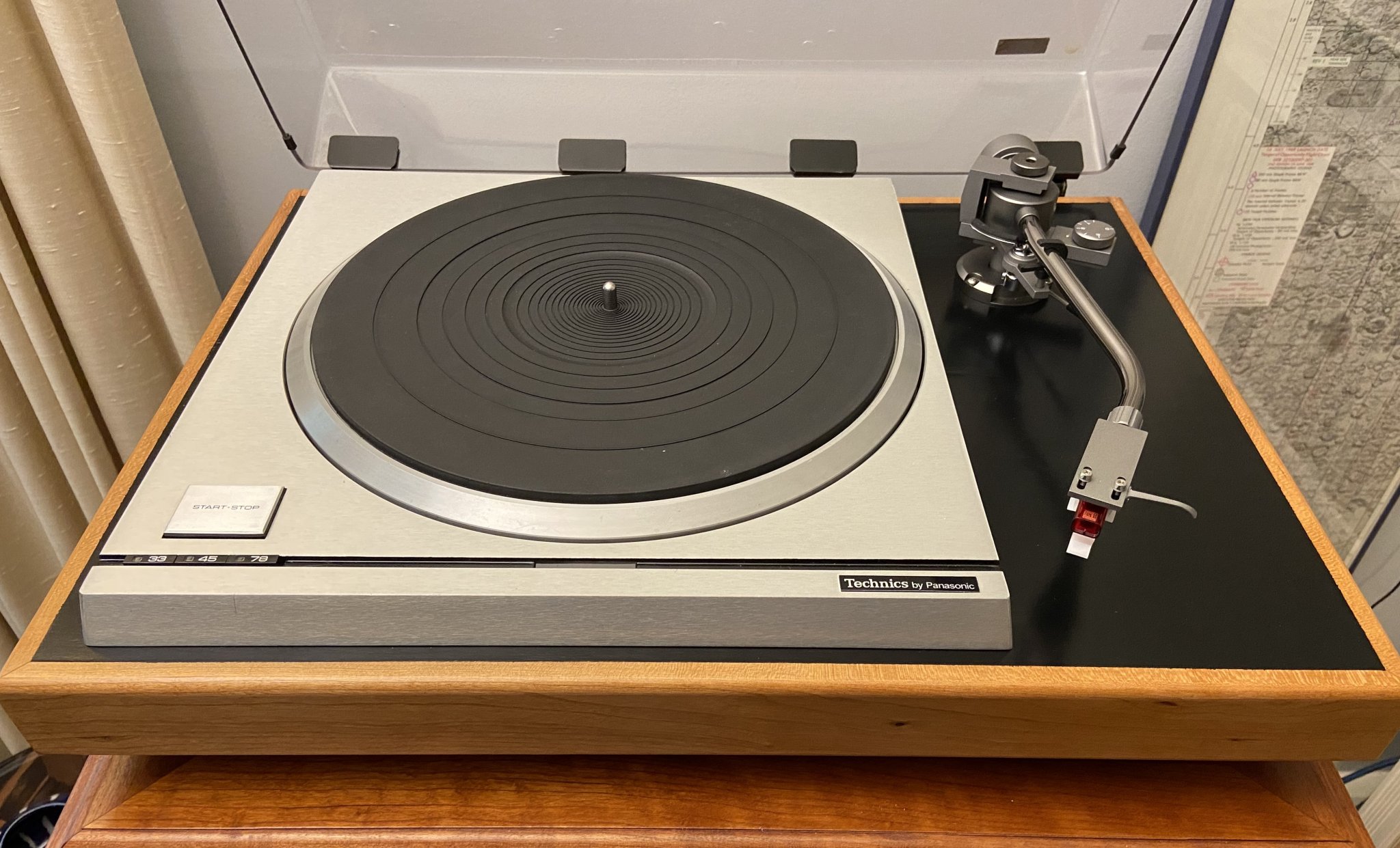

Were you able to compare the performance of the mk3 in your plinth with it mounted in the OEM Technics Non-Resonant Compound (TNRC) plinth?
If so, your opinion would be of interest to me and a few others. It might be better suited to The Incredible Technics SP-10 mk3 thread.
OTOH you might attract some undesired blowback, so I understand if you decline.

I have had good results from JMK Displays. Fairly priced and high quality. I'm not affiliated. PM me for contact info if you can't find the website.I have a Mk3 in a custom plinth. The plinth is roughly of the same size and dimensions as most that one sees.
I am seeking a maker of the flat-type dust covers. Probably don't need anything custom-designed....I suspect any that fit the usual Mk3 plinth tables will suit me as well. Just need a quality source.

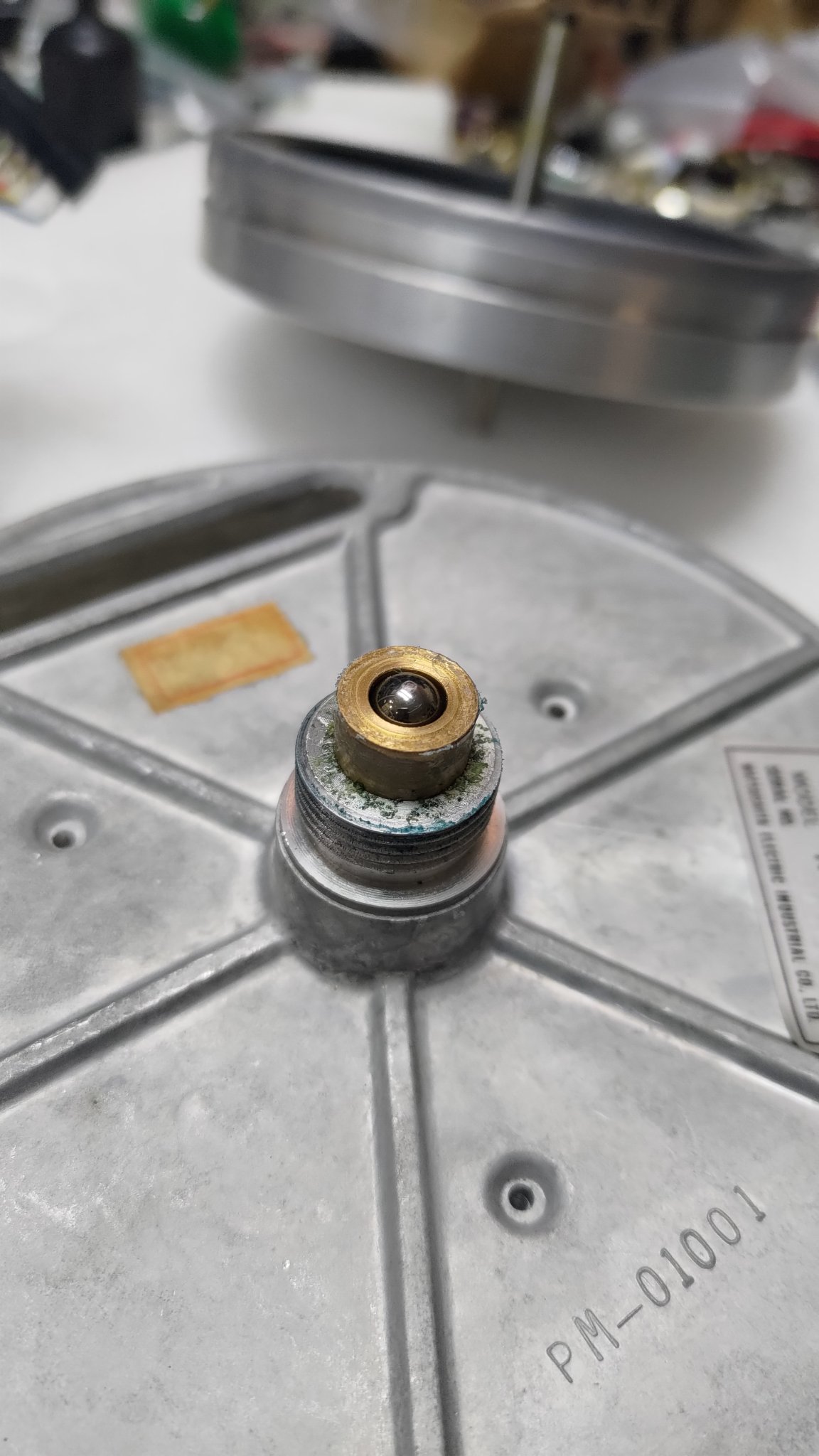

I've machined the new spindle from BS1407 tool steel. All that remains is to harden and polish the spindle, assemble the motor and change the motor connector.
@Simon Templar
Actually, no.
I've no experience with the OEM plinths
.....sT
That is gorgeous...Despite the fact that I thought you had used slate...Not that there is anything wrong with your solution but I had hoped to be able to copy your solutions for a lovely pies of slate that I have.

his047: See detailed instructions for the cap removal under the Motor Refurb section of my first SP-10 refurb, here.
Basically, heat up the end cap with a heat gun and use water pump pliers. Then push a wood stick from the top and give it a tap to pop the bearing out - its a friction fit.
