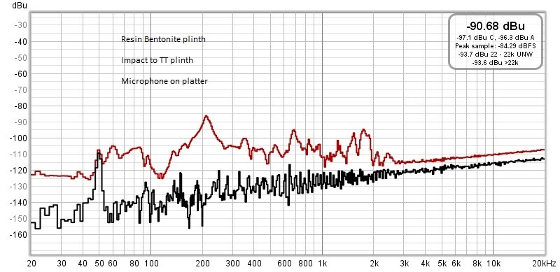

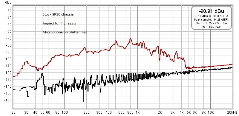

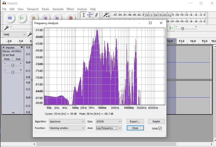

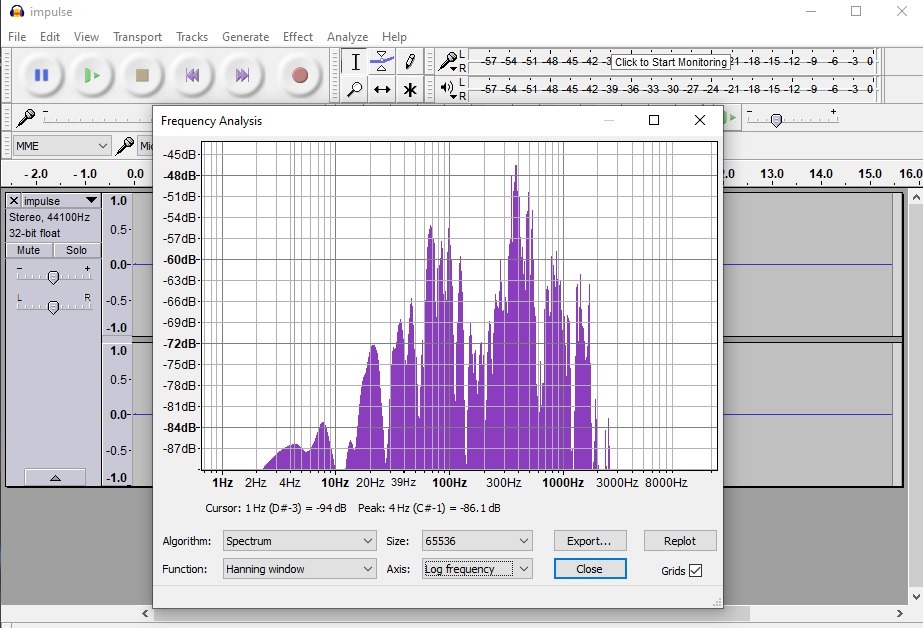

Here are some test results. Testing was done using a marble dropped from a predetermined height. For those who don't know the reasoning for impulse testing - this test excites the natural resonance in the unit under test, these resonances will be excited by any program material at the same frequencies causing peaks and dips in the frequency response at the problem frequencies.
These are impulse response tests on the plinth. 1st is Resin/bentonite 2nd is Permalli. This test was performed before and after I migrated my motor/platter from the R/B to the Permalli plinths.

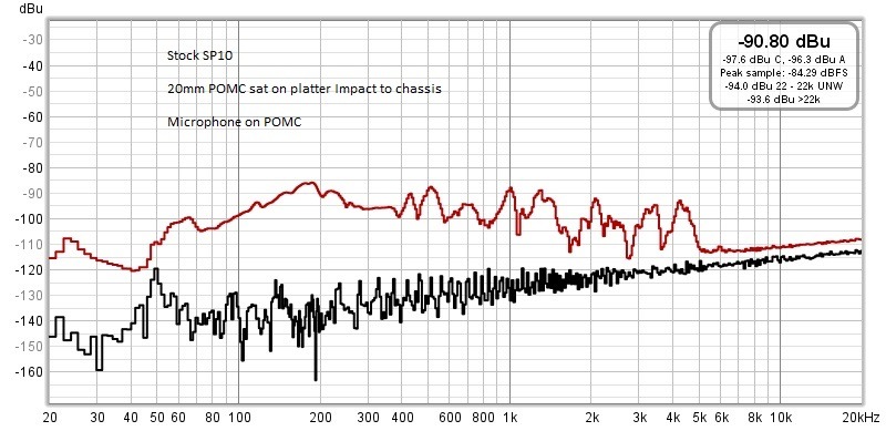

These are stock SP10's. 1st is totally stock SP10 in a marine plywood plinth and 2nd same TT with OEM/20mm POM platter.

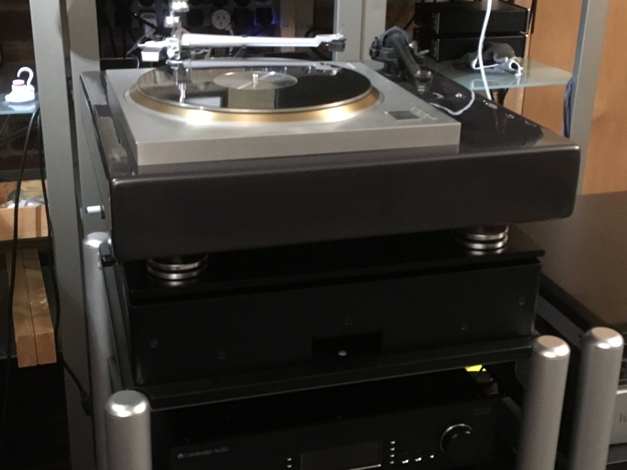

This one is a remote mounted motor in a resin/bento plinth with POM platter.

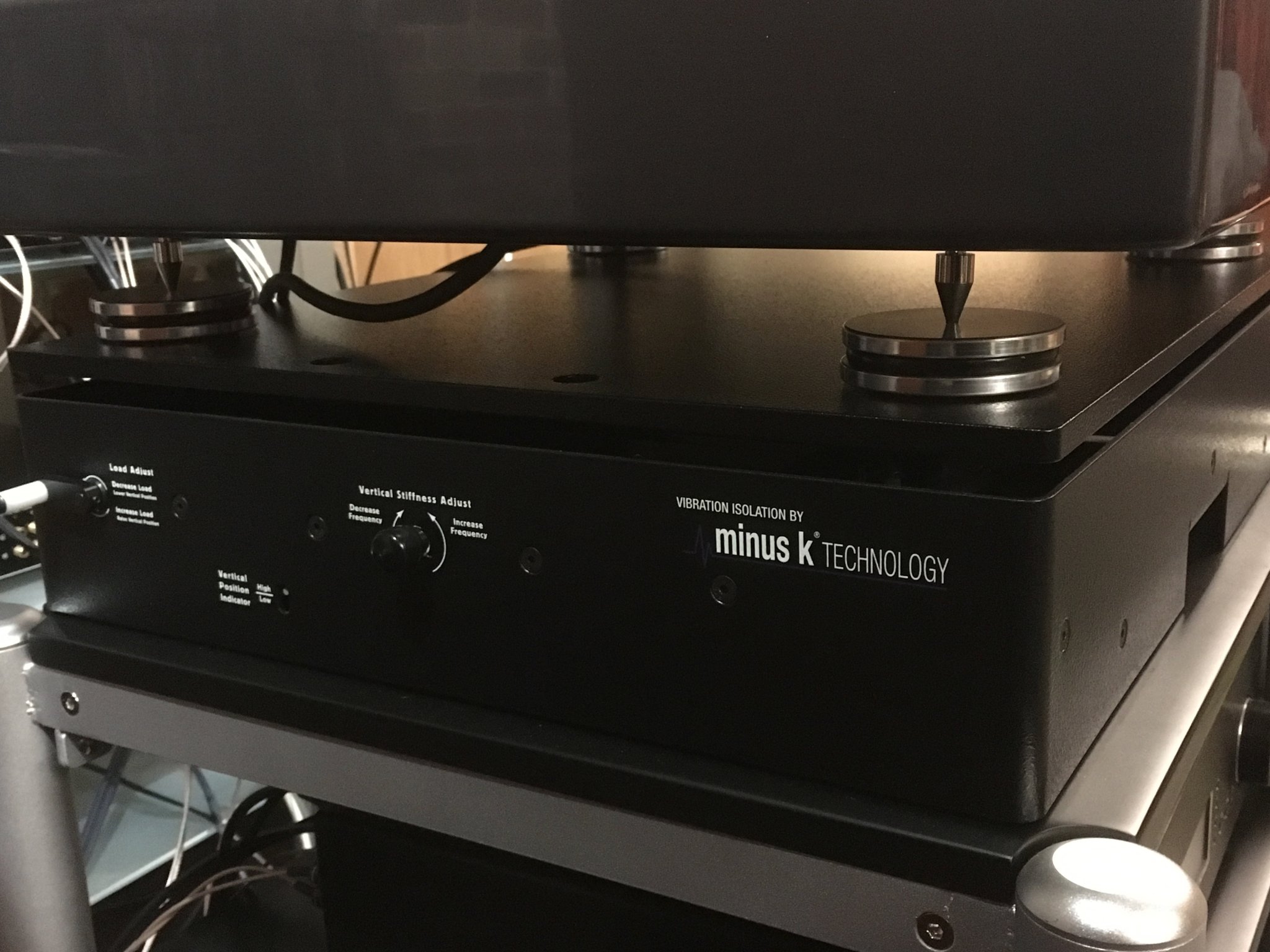

The 10R is the best measuring turntable that I know of. It sits in a bento/res plinth on a MinusK isolation base. It supports an SME IV and an SME V12 with various excellent cartridges, phono stages and pre-amps. It has been given the best opportunity to perform in my system over an extended period.
I have compared the 10R with my modified mkII over a 5 year period, swapping cartridges back and forth.

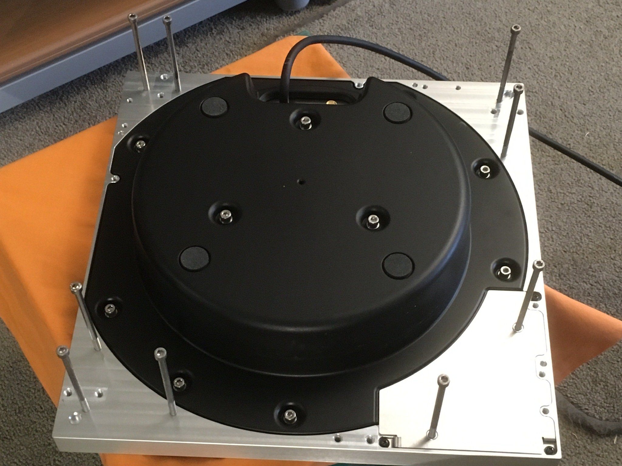

In my opinion Technics missed an opportunity with the 10R by retaining the legacy chassis format. Out of the box, I was concerned that the underneath on/off switch cover produced a noticeable rattle when lightly tapped. To my ears, the Kaneta bento/res POM mkII is preferred to the 10R by a good margin.

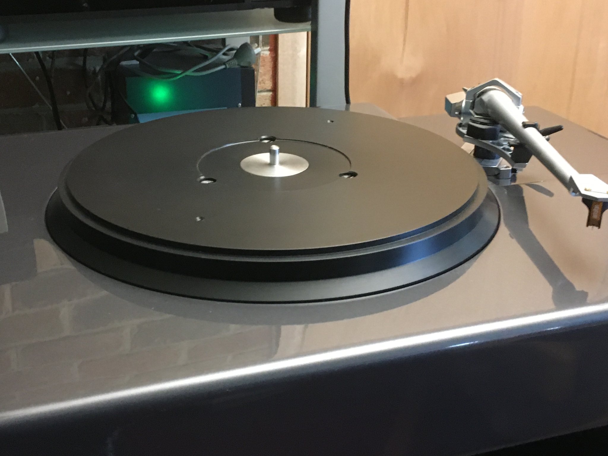

Below are pictures of the Kaneta/bentores/POM/gunmetal 10mkII and the 10R on the MinusK. Also the 10R underneath.

It's impossible to play an audio track and with a confidence of better than 1 Sigma differentiate between modifications. This requires testing the system with the equipment we have and remembering I no longer have access to the vibration laboratory where I worked where this could be done with an audio track and an LDV.
Impulse testing is a valid method to approximate with a confidence better than 3 Sigma what the unit will do when excited by an external force.

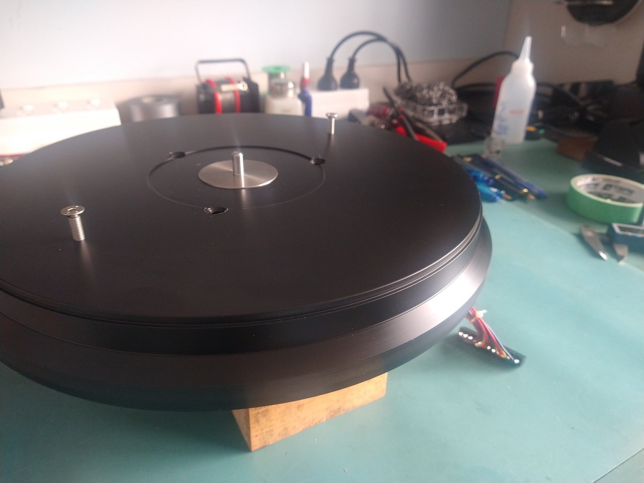

If you want to use a POM platter and have access to a machine shop that can spin an SP10 platter I'm happy to share my CAD drawing so you can have a POM platter made.

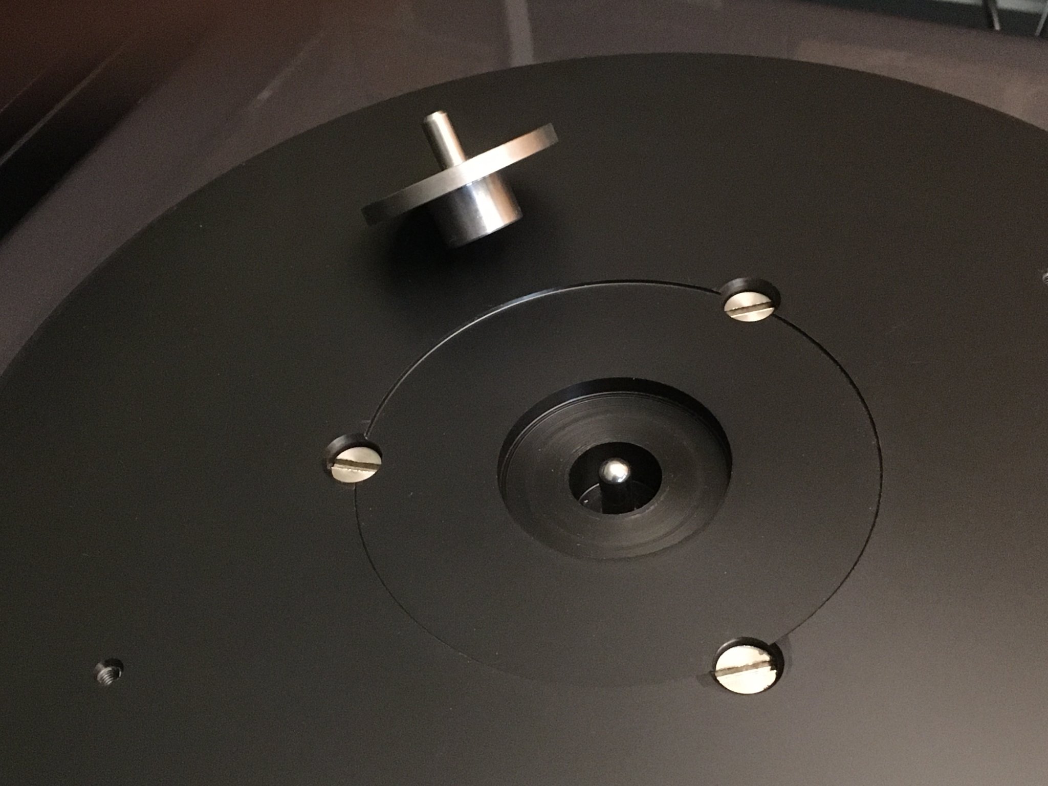

Warren, I'm having trouble with your chaotic wobble video. I think that shows vertical movement. I would think most spindle issues would manifest themselves in horizontal movement. And, could be "chaotic".
Precession is dealt with in the new inverted bearing. The uC is to improve dynamic speed stability. The SP10mk2 is very good especially when considering the design is 50years old and totally analog.
I've picked the low hanging fruit with mechanical improvements, although the inverted bearing is still to be tested but the theory is sound and the measurement is a vast improvement.
Yes it shows vertical wobble which is a transnational movement from the horizontal wobble of the spindle amplified by the radius of the platter.
It is 40mm POM with a gunmetal substrate. Only 25mm is above plinth level. I recall Warrjon saying that he did not detect a significant difference between 40mm and the 60mm POM he now uses. That was with his bento/res plinth. Things may have changed with the Permali.That platter dwarfs the motor.🙂
I think 40mm is close to the sweet spot between performance, constructional complexity and aesthetics. I find very tall platters a visual distraction.
