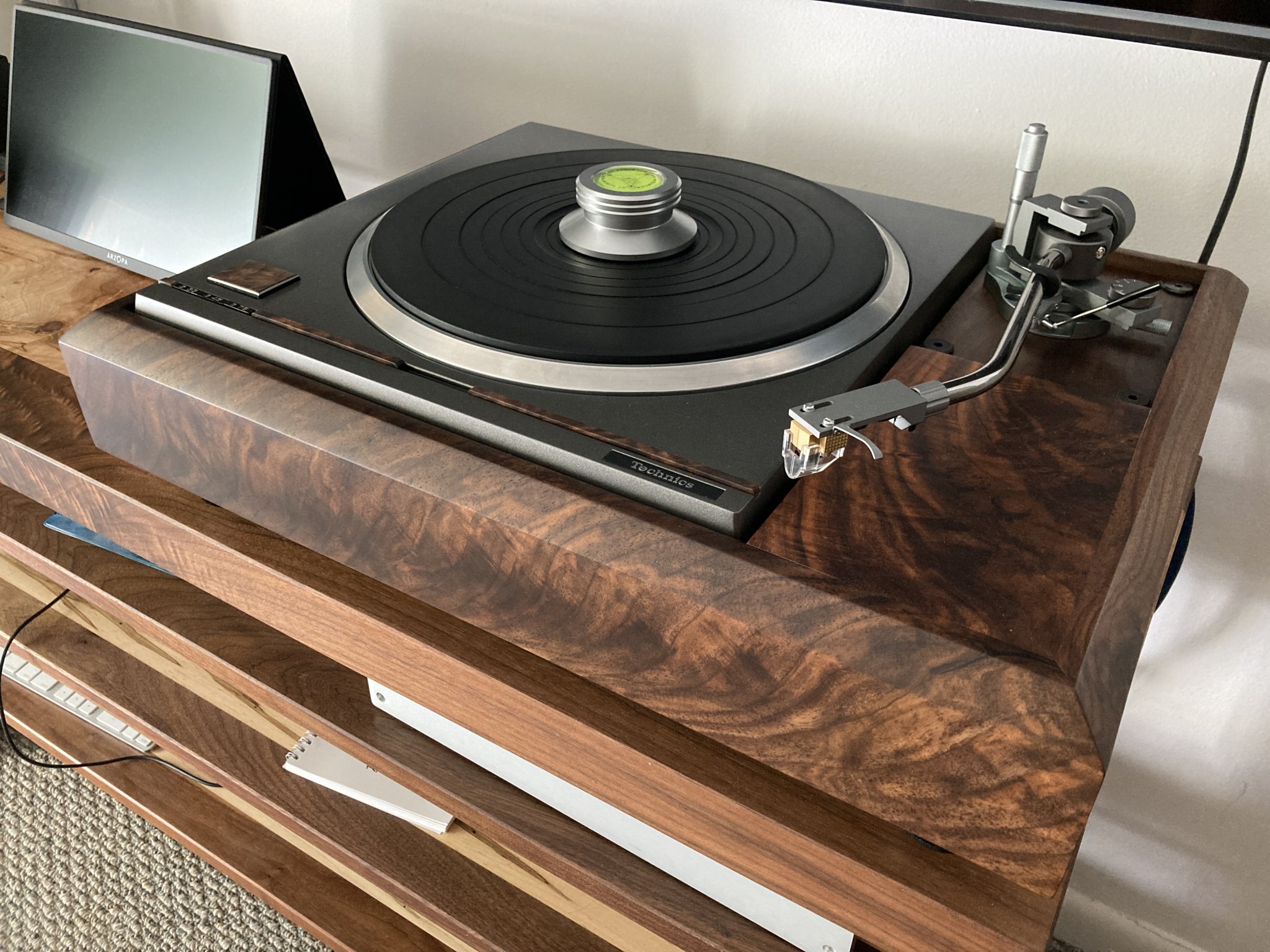

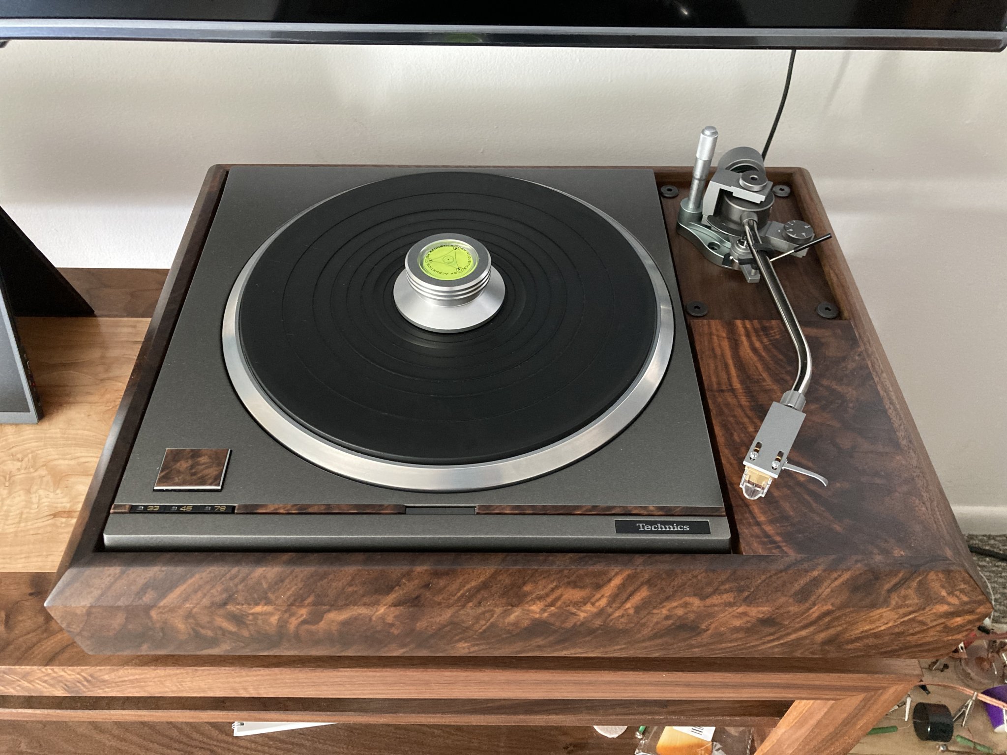

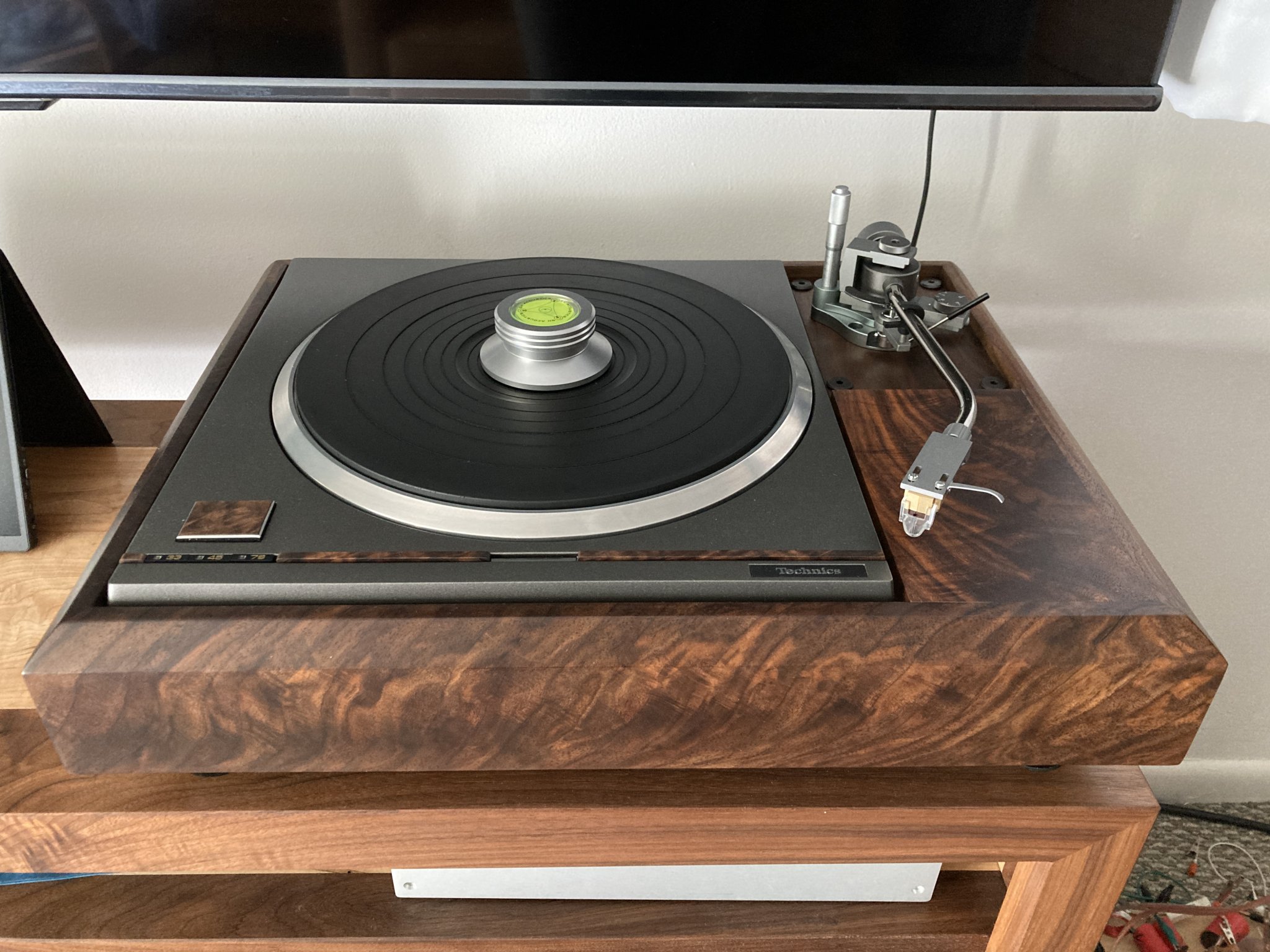

The inverted bearing motor is now installed in the plinth and operational. I need to modify the tonearm mounts to increase height as the platter now sits about 35mm higher. So there is still some work to do before I can sit down and listen to it.
I made a new de-coupled spindle and took finishing cuts on the platter which have improved runout from 0.03mm to about 0.01mm which is also repeatable removing and reinstalling the platter multiple times. I'm very happy with this result and it's a massive improvement over the stock mk2 platter wobble which the worst I have seen 0.2mm and best 0.1mm and all of the 12 units I've tested fall between these.

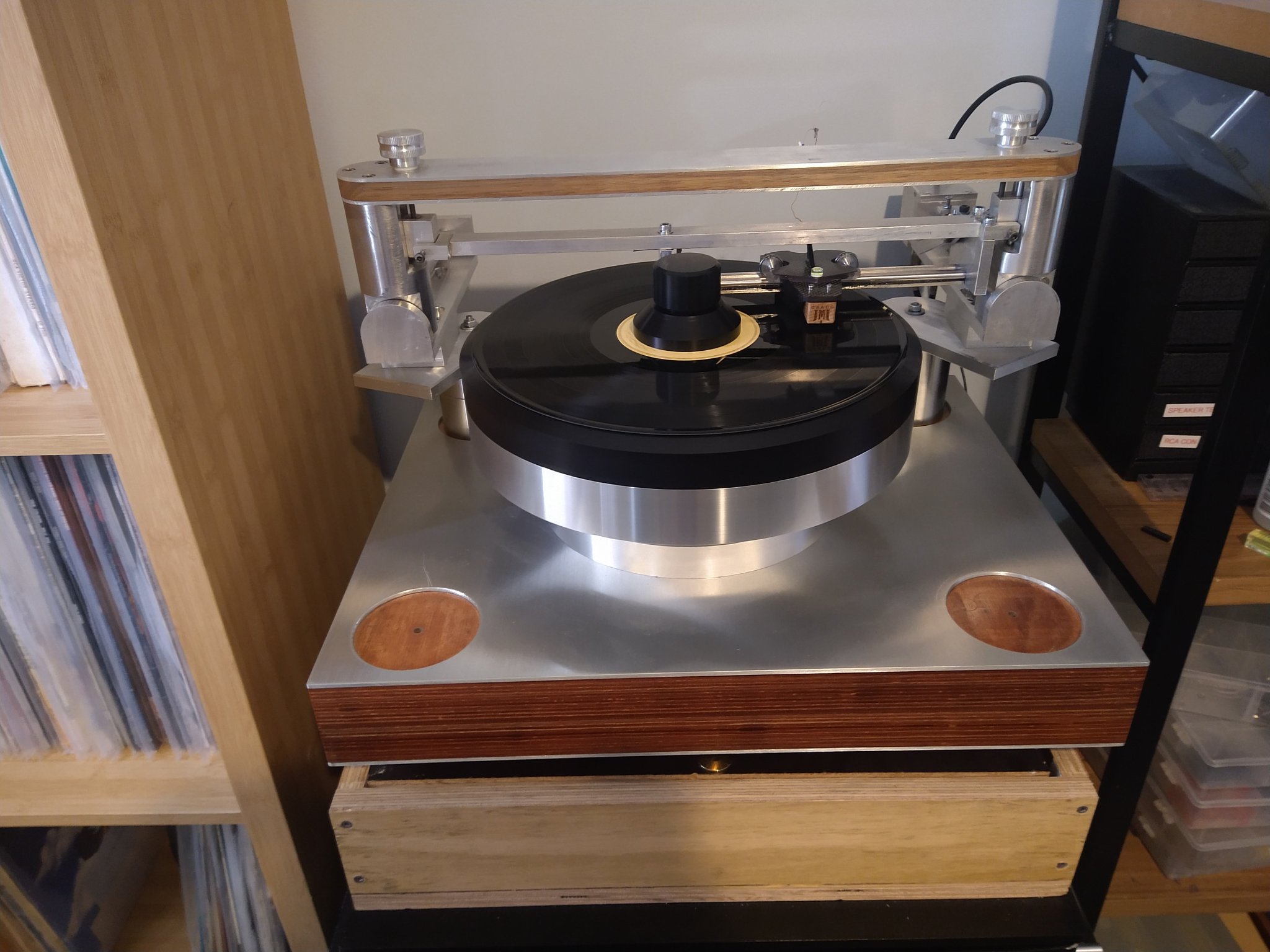

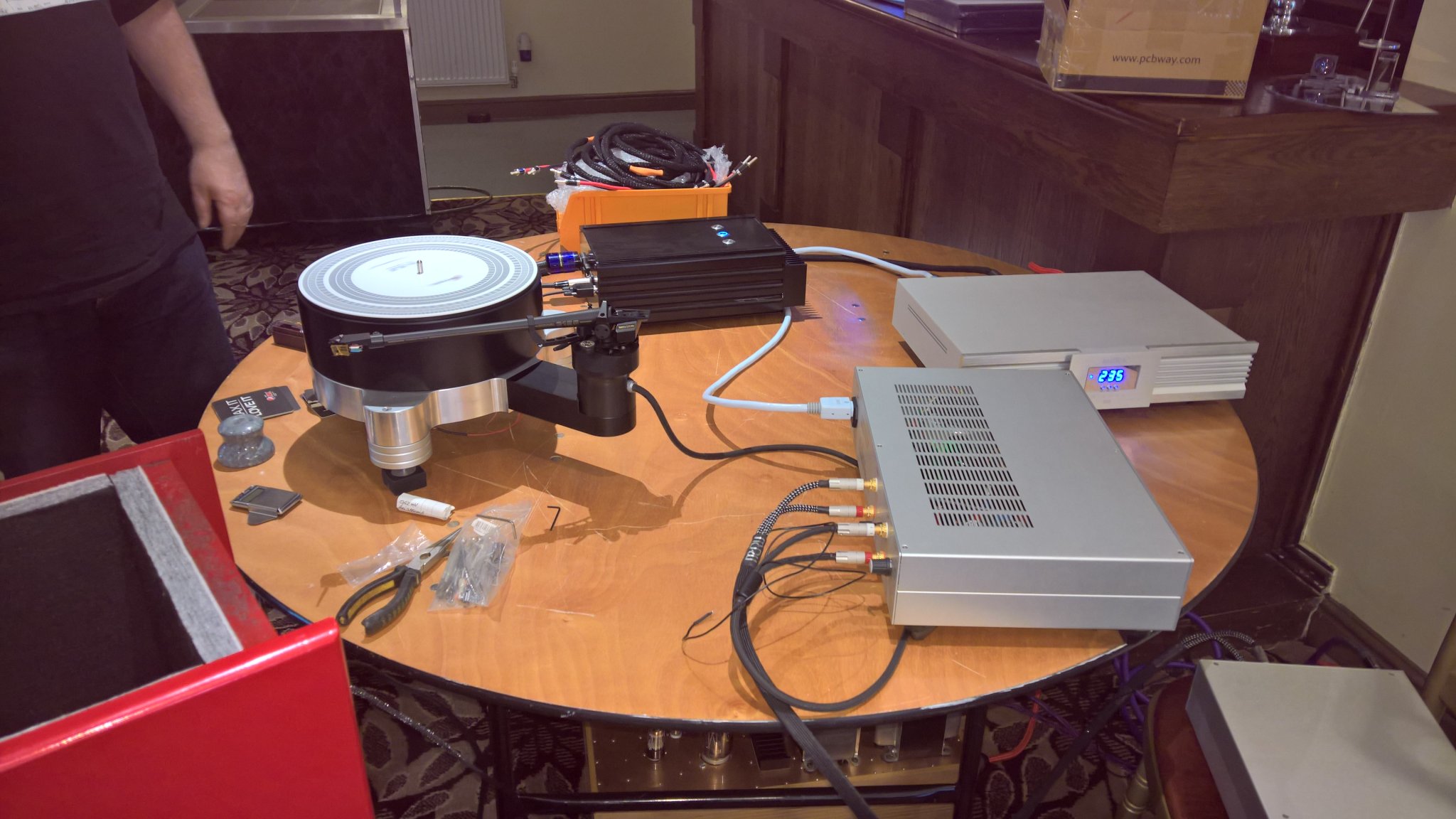

The following image is a concept DD TT presented by Nick Gorman of Long Dog Audio at a Forum Annual Event I visited in 2019.
It does seem that a substantial Delrin / Acetal used on the Platter is one area where there is a design similarity.

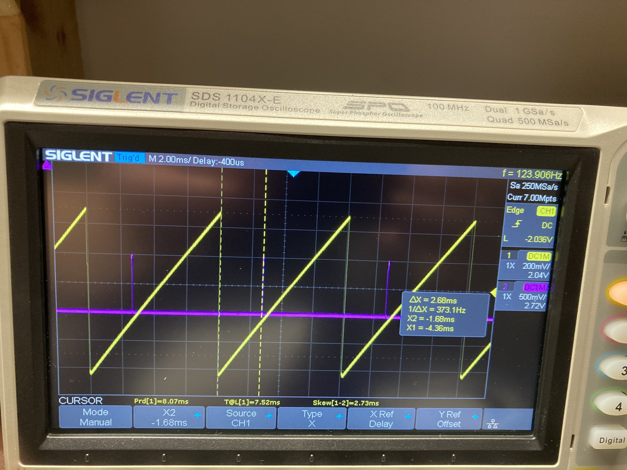

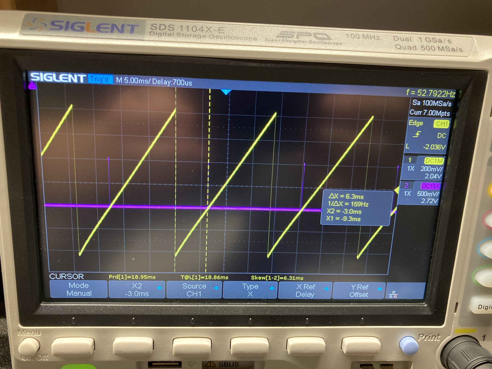

Does this look good? My first digital scope, pressing buttons figuring things out… had to change trim pots, those old were way unstable. 45rpm is at 5.3ms
