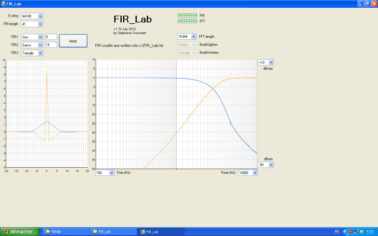

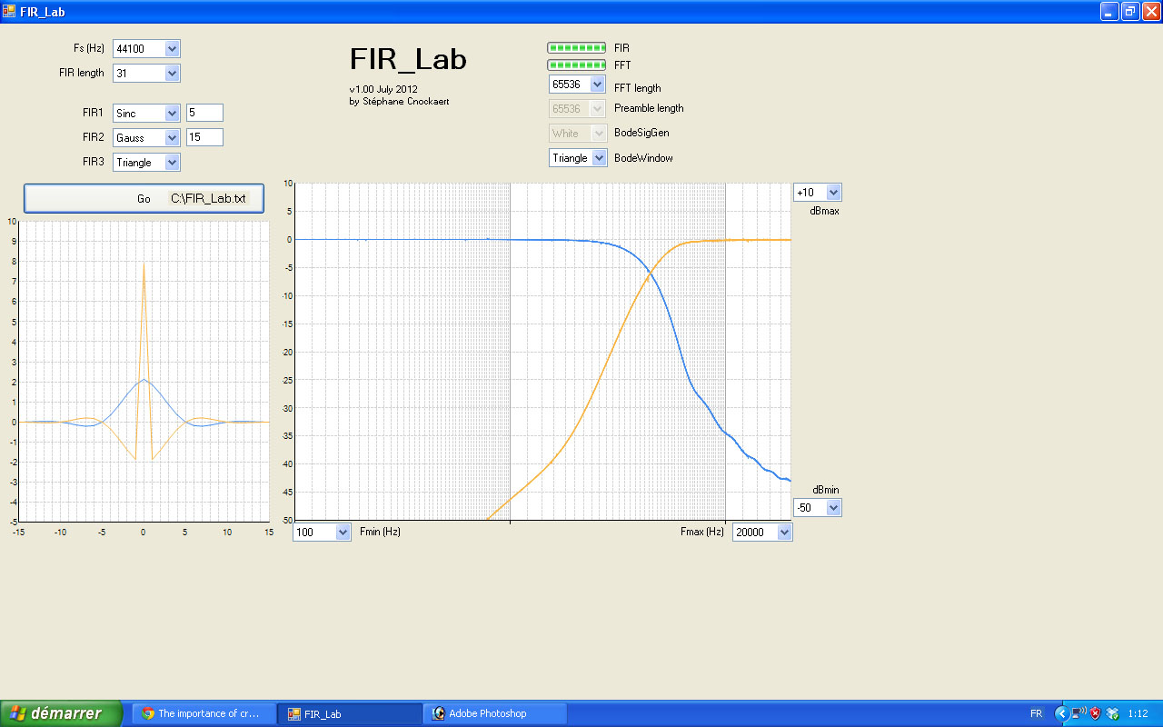

New FIR_Lab version here.
Variable FIR length. The transition band width decreases with the FIR gets longer. Due to the log frequency scale, the net effect is a crossover slope that's massively increasing with the FIR length.
Three different elements (Sinc, Gauss, Triangle) can be combined at will. Each can get bypassed (select Rectangle instead).
The Sinc parameter allows a direct crossover frequency control. This happens in a constant transition band width. Due to the log frequency scale, the net effect is a crossover slope that's massively increasing with the crossover frequency.
When using an integer for the Sinc parameter, the FIR nominal crossover frequency gets synchronized to the sampling frequency. In such case, you will observe patterns of FIR coefficients equal to zero.
The Gauss element and Gauss parameter help controlling the preshoot/ringing. Unfortunately, there are effects on the crossover frequency, and effects on the crossover slopes in the transition band. When the crossover is mainly governed by the Gauss element, the complementary highpass selectivity degenerates to a 2nd-order. This sets a practical limit to the idea of using the Gauss element for shortening the preshoot/ringing.
The Triangle element is there as optional element, for ensuring a true-zero end-window. When activating the Triangle element, the crossover slopes get more more symmetric, albeit with reduced slopes.
The FIR coefficients are written into a "FIR_Lab.txt" file on the hard disk, in the C:\ drive root.
Sorry for the "fur" that's becoming annoying when using large FIRs. I've got no time investigating the FFT buffers boundary effects (see former post).
Apart the "fur" effect, I'm pretty happy with FIR_Lab now. I like the no-nonsense approach, concentrating on the physical reality of the FIR instead of trying to emulate all sorts of things that a FIR is not.
Like you I am in search of a simple, physical, intuitive way to inject the meaning of a "slope" into FIR_Lab. A possibility is to add a second parameter to the Sinc element, bringing some short term "warping" in proportion to the nominal crossover frequency. Say a 10% frequency modulation with a certain profile over time, within the FIR. Which profile ?
Another possibility is to depart from the Sinc element. Instead of basing on 3 elements (Sinc, Gauss, Triangle), one could add a 4th element natively providing a natural transition band width control, proportional to the crossover frequency. Considering the nature of a FIR, it's not easy to identify such 4th element. Any idea welcome. Would be interesting to analytically compute the asymptotic behavior (the slope) of FFT-defined lowpass filters, linear-phase. Computing this properly may lead to mathematically expressing conditions that must be satisfied regarding the impulse response, easing the FIR design.

If you allow me to comment on that, I think that the 'fur' you and CuTop were talking about comes actually from the white noise sequence. Such a sequence of finite length can not be perfectly white. Actually, the longer it is, the 'whiter' it is as well. So in other words, there are spikes on your output signal because the spikes were originally present on your input signal.
It's not the first time I'm designing and programming a two-channel FFT analyzer. That one definitely has the taste of carrying a bug in the FFT buffers boundaries. Look how the "fur" increases with the FIR length.
In such two-channel analyzer, the more random your test signal, the less "fur" on the Bode plot. The two-channel analyzer gets very happy to have energy everywhere (at all frequency bins). He needs this for computing the out/in ratios in complex numbers, which is the Bode plot actually.
The two-channel FFT analyzer reality and practice is thus quite opposite to what you say. You will get a lot of fur "fur" if you feed it with a sinus. With a sinus, energy is missing in many frequency bins, and the out/in computation gets corrupt by noise in many frequency bins.

First thing I'd like to say is that I'm coming in peace to praise your work like I'd praise anyone's sincere effort.
Second thing is that I never mentioned a sine anywhere in my previous post. Now talking about analyzing a sine with fft, you don't get 'fur' but you get the side lobes of the window you have selected.
This happens because when you are analyzing a signal, you must split it into portions, and the fact of slicing the signal is what is creating these lobes.
You know there are several kinds of windows, and all of them are a compromise of frequency selectivity (main lobe width) and side lobes level.
If you just split the signal, then you're actually applying a rectangular window. This has excellent frequency selectivity but high lateral lobes (-13 dB). The 'fur' you observe is nothing about noise corruption, it's just a property of your window and you get the same 'fur' even if you're computing with 1024 bits of precision.
Now coming back to the original topic, based on your screenshots it seemed that there were less spikes with longer fft. Apologies if this is not actually the behavior you have observed.
Finally, if your application is happy with displaying the frequency response corresponding to a computed impulse response, I'd suggest to forget about the fft and just compute the Fourier transform in plain.
The 'fur' you observe is nothing about noise corruption, it's just a property of your window and you get the same 'fur' even if you're computing with 1024 bits of precision. Now coming back to the original topic, based on your screenshots it seemed that there were less spikes with longer fft. Apologies if this is not actually the behavior you have observed.
I said longer FIR. Not longer FFT. Try yourself and you'll see there is a bug I still need to correct in FIR_Lab. By experience I know that once the bug will be gone, the "fur" won't increase when we increase the FIR length.
Of course. At the moment I prefer doing the whole FFT stuff in order to get the same look and feel than SpectraLab 4.32 (32762 point FFT in realtime).
FIR_lab is debugged, updated, and exhibits no "fur" anymore, just as expected.
FIR_Lab allows to graphically design complementary phase-linear digital crossovers, FIR-based, in a matter of seconds instead of hours or days.
The sum of the Lowpass and Highpass is the unity transfer function, in amplitude and in phase. As consequence, the acoustic reconstruction will be perfect.
There is no phase shift between the woofer and the tweeter, across all frequencies. As consequence the main radiation lobe should remain stable over the full audio frequency bandwidth, exhibiting no angular shift when varying the frequency.
1 - Basically, the crossover frequency gets defined by a parametric Sinc function (Sinus cardinal) tending to a brickwall filter when the FIR length gets considerable.
2 - The FIR length has a direct influence on the Lowpass and Highpass selectivity, transition band width, and slope. Basically, shortening the FIR length decreases the selectivity, increases the transition band width, and reduces the slope.
3 - Preshoot and ringing can be reduced using a parametric Gauss function applied on top of the Sinc function.
4 - For increasing the smoothness, a triangular window can be applied, as final touch.
The resulting FIR coefficients are written into a c:\FIR_Lab.txt file.
See attached files.

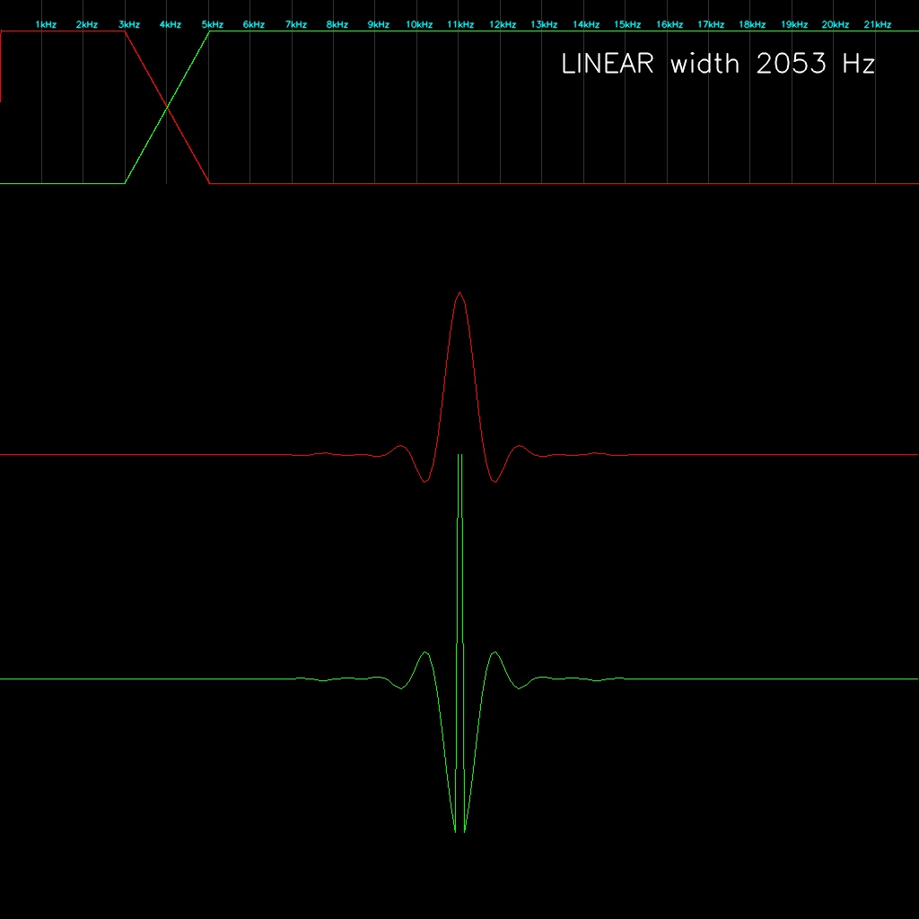

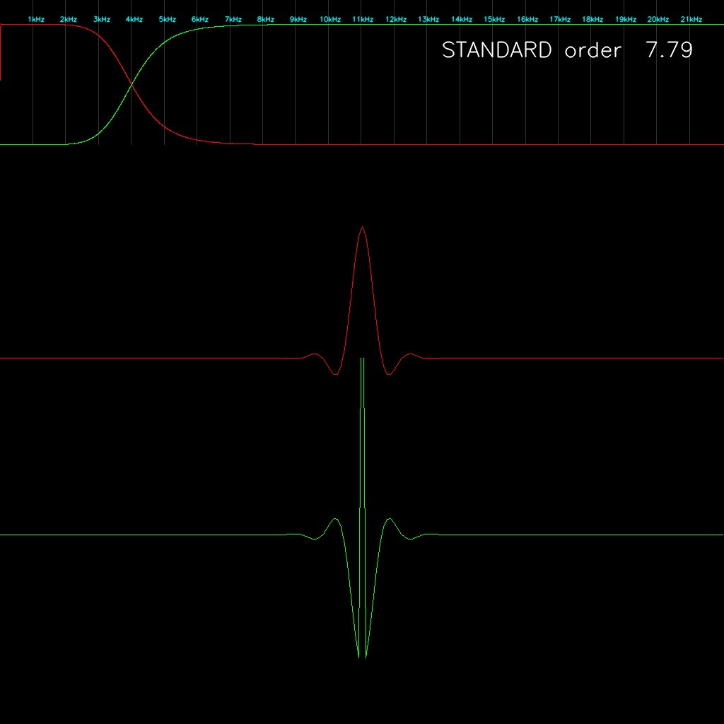

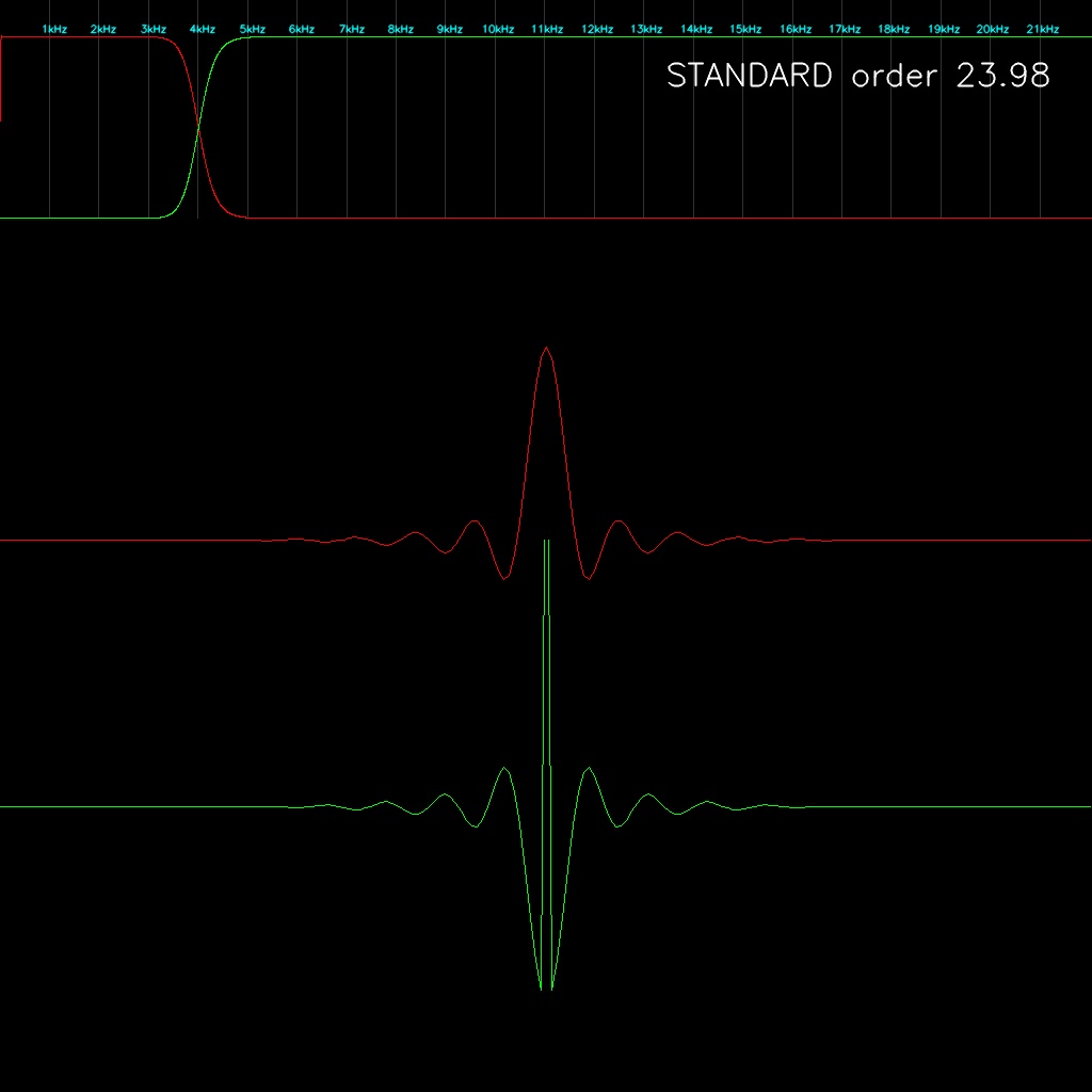

In the last few posts we've been talking about shallow crossovers causing intermodulation when signal components reach the drivers that they're incapable of reproducing properly. Whereas, steep crossovers ring and overshoot, so we're relying on acoustic cancellation to neutralise the effect.
If I look on a linear/linear scale at the frequency response of, say, a 4th order 'standard' filter on a crossover frequency of 4 kHz, I can see that the tweeter is still going to be getting some 'visible' signal at just over 1 kHz, and the woofer will be getting something at up to 14 kHz. Surely this must cause some audible degradation. The situation with the 8th order is a little better, but not great. (If you insist I can go away and come back with some properly measured figures!)
If I switch to the linear crossover, I can set it at, say, a precise 2 kHz width, and be sure that the amplitude to each driver will be zero* outside of this range. The impulse response shows minuscule ringing for a long time on either side of the centre - far longer than any 'standard' filter, but the central ringing and overshoot looks fairly tame.
To get something approaching the same level of attenuation at the extreme frequencies using a 'standard' filter, I reckon I would need to use 24th order. The central slope would be steeper than that of the linear filter, (but unless it's lobing we're concerned with this is the region where we're confident in our drivers' abilities), and would, in fact, give rise to much higher overshoot and ringing close to the centre of the impulse response.
Does this suggest that we want our crossover filter to be steepest at both extremities of the crossover region where we really want to kill the 'contamination' for each driver while maintaining the complementarity** of the filters, and then we can relax a little in the middle where we're confident our drivers are capable of behaving properly?
Just wondering whether my linear crossover does, in fact, have the advantage of doing something not too far off this..? I could imagine just rounding off the corners a bit, so that the attenuation when very close to zero was more 'asymptotic' or something like that...
I enclose a few screenshots to illustrate what I'm on about.
* It's not perfect, because that would require an infinitely long FIR, probably, but I'm using a pretty large FFT, and even after windowing it's very close. The enclosed images show the frequency response after windowing the impulse response.
** It's a real word!

CopperTop, can you post those frequency response plots with a dB vertical scale? And perhaps on a log horizontal scale?
Also, when you refer to your "standard" filters, exactly how are these created?
I haven't quite got round to plotting log axes yet! I'll work on it.
The 'standard' filter is based solely on the formula given in post #71 - I'm not claiming to be an expert on standard filters, so I'm relying on the author's words:
This expression yields an amplitude response with an nth order roll off and a response with magnitude 20 Log(Q) at f = 1.0. For n equal to 2 the amplitude given be Eq(1) is consistent with that of any standard 2nd order filter, Butterworth, Bessel or Linkwitz/Riley, for example. For n greater than 2 the response is only consistent with symmetric higher order filters. These include Butterworth filters (n even or odd, Q = 0.707) and Linkwitz/Riley filter (n even, Q = 0.5), but not higher order Bessel filters
I'm using Q = 0.5.
