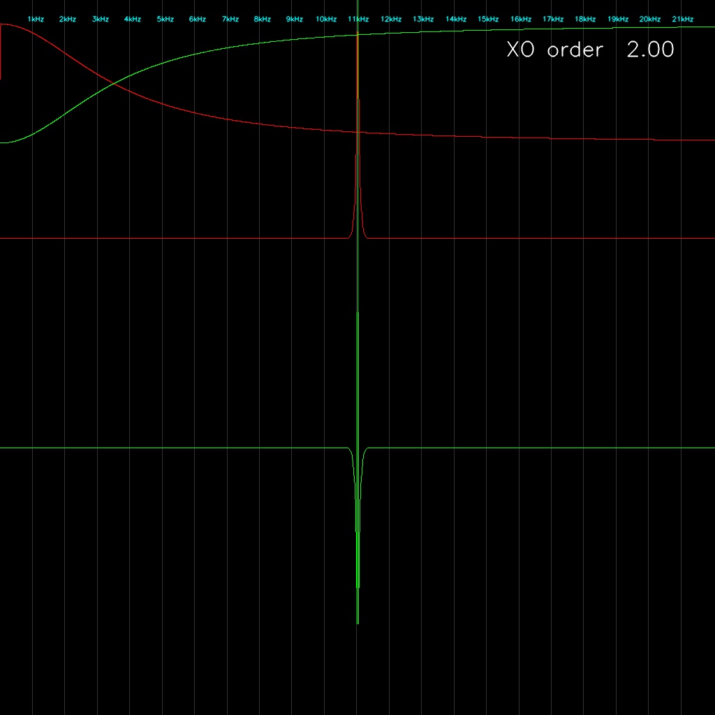

OK, here's something remarkable (I think). I've modified my active crossover program to allow me to switch instantaneously between extremes of crossover steepness while listening. I can go between 2nd order and 256th with a keypress. Just to recap: I'm using a two way speaker (Mission 702e) and I've set the crossover frequency to 3.5 kHz.
The result with music in a real room is virtually no audible difference whatsoever! I can't even hear any difference when moving in relation to the speakers. If I listen to woofers or tweeters only, then the effect is extreme, with the 256th order sounding appalling. However, the drivers combined results in almost perfect acoustic cancellation of the high order filtering artefacts. I really wouldn't have believed it was possible.
Here are the two screenshots showing the linear frequency responses and zoomed in impulse responses (apologies for the random-ish layout of the screen).
What I take away from this is that, in practice, crossover steepness within reasonable limits is not critical, but I'm happy to be contradicted...

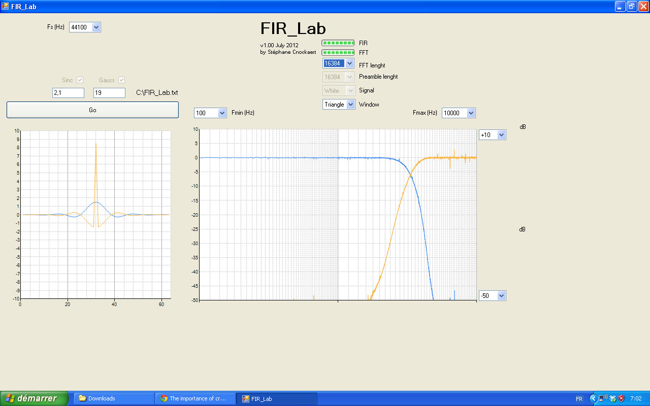

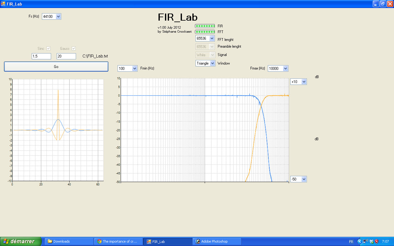

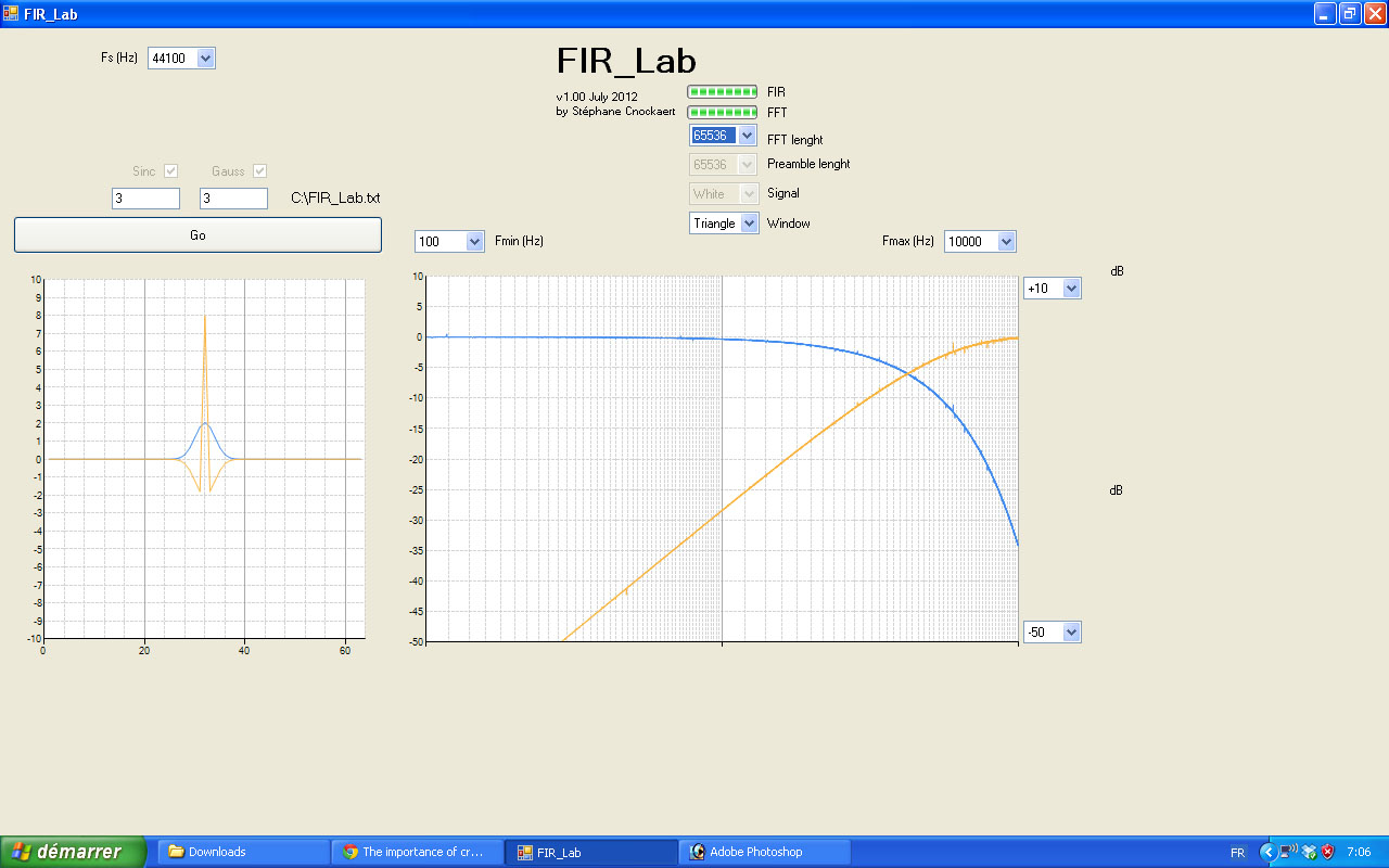

I just wrote FIR_Lab, a Visual Basic program enabling to play with complementary FIRs. See attached .zip file and screenshots. The program automatically writes the FIR coefficients in a FIR_Lab.txt file located on C:\ (rooth).

OK, looking at the Gaussian alongside the 'standard' 2nd order filter I can see that it is clearly superior in terms of selectivity. And thanks gberchin for the formula for higher order Gaussian-derived filters.
This brings me to my somewhat hazy grasp of filters! I know that a particular filter order is related to "the slope" in terms of dB/octave. I also know (I think) that an Nth-order filter can only be realised with at least N filter taps in an FIR filter. I also have some inkling that it is related to the highest exponent in the frequency response expression. It may also have something to do with Laplace transforms and transfer functions but I've erased those horrible memories from my brain over the years. The filter order is also related to the number of delay elements in an IIR filter.
What may be confusing to people like me is that filters of the same cutoff frequency and order (and therefore apparently by definition the same slope in terms of dB/octave) are not all equal in terms of performance. In frequency response terms how does the filter's order affect the possibilities for what happens in the passband? Given an arbitrary frequency response (or transfer function), you could find an Nth order polynomial that fitted, but the term to the power of N might be very small. You might also find a <Nth order polynomial that fitted almost as well. Would this filter be usefully defined as Nth order, or something else? Presumably the definition depends on how accurately you implement the filter..?
And then there's the relationship between digital filters and analogue. I was tremendously excited when I found that I could create a filter with any frequency and phase response I wanted, even linear phase, using the FFT and windowing. Why, then, I thought, would anyone want to emulate analogue filters? I'm still wondering about that. People seem to stick with integer even values for the order, and they still talk about Butterworth, Bessel etc. What is the relationship between analogue filtering, and digital FIR filtering? Are analogue filter responses in some way fundamentally good and pure, and therefore it is natural that they are emulated digitally by most people, or are people simply sticking with what they know? That is, if digital FIR filters had been practical all along, would we still have come up with Butterworth, Bessel etc. before messing about with anything else?
I like the idea of the Gaussian filter. But to make a Gaussian-derived Nth order filter, you simply replace '2' with 'N'. It seems kind of arbitrary, somehow. Is it inevitable that the Gaussian-derived higher order filter will inherit a proportion of the desirable characteristics of the pure Gaussian?
I like it.
Is the slight 'fur' on the frequency response curves because you are defining the windowed impulse response first, then taking the FFT, rather than the way I've been doing it i.e. defining the frequency response then calculating the impulse response from that? Presumably my impulse responses also have tiny deviations from the ideal, but they don't show up so well.
Yes that's it. If you select the longest FFT (65536 samples) on FIR_Lab, the "fur" gets negligible. As I wrote the program in a hurry, some "fur" may be caused by boundary issues in the FFT buffer management. The longest the FFT, the more those boundary issues get diluted.
Nice job Steph!
If you allow me to comment on that, I think that the 'fur' you and CuTop were talking about comes actually from the white noise sequence. Such a sequence of finite length can not be perfectly white. Actually, the longer it is, the 'whiter' it is as well. So in other words, there are spikes on your output signal because the spikes were originally present on your input signal.
If you're using a longer fft, then I suppose that you're also using a longer noise sequence with originally less spikes and that's why it looks smoother independently of the fft itself.
