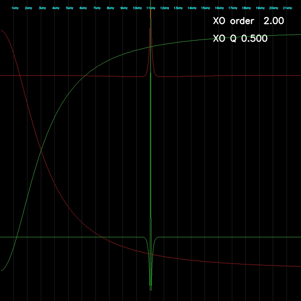

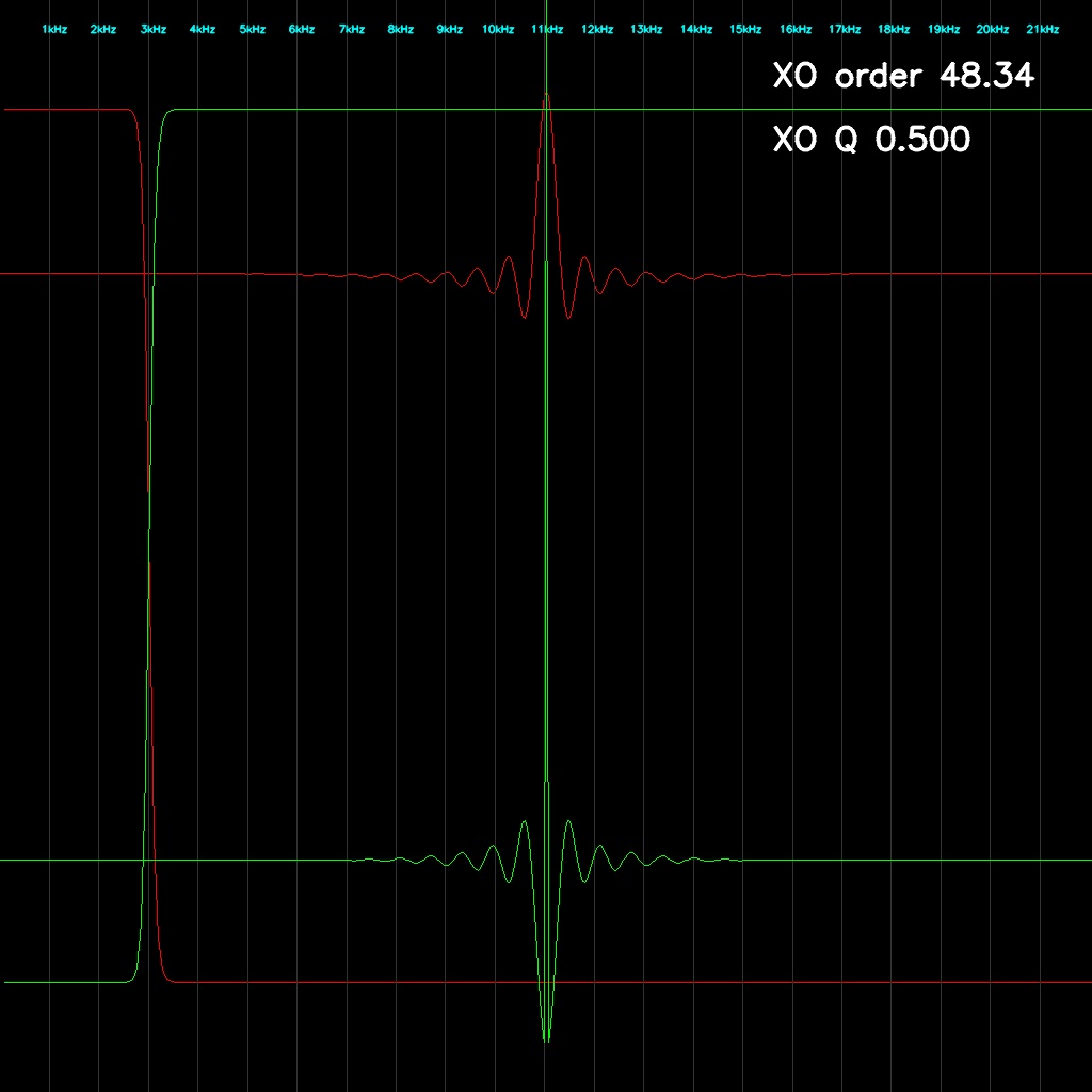

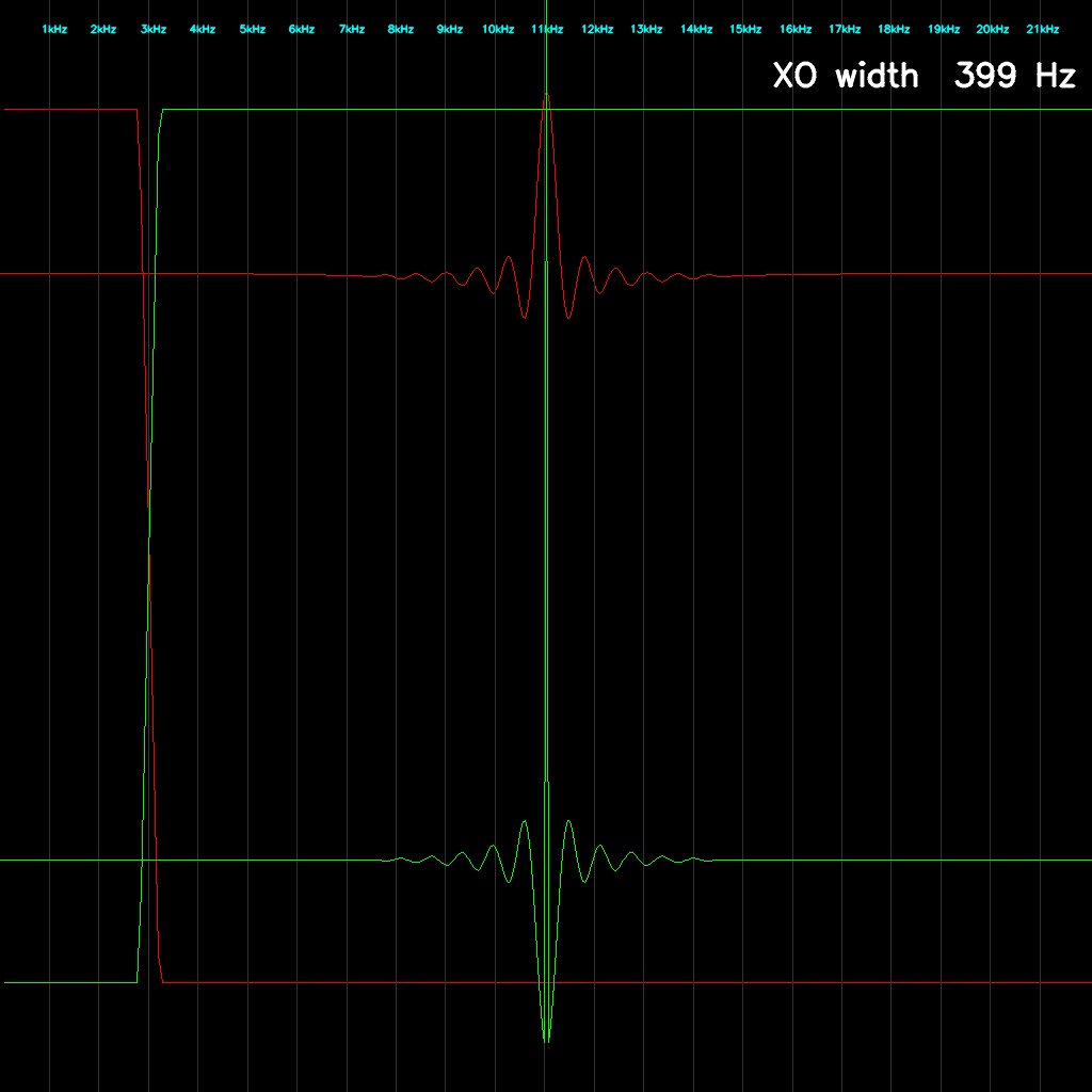

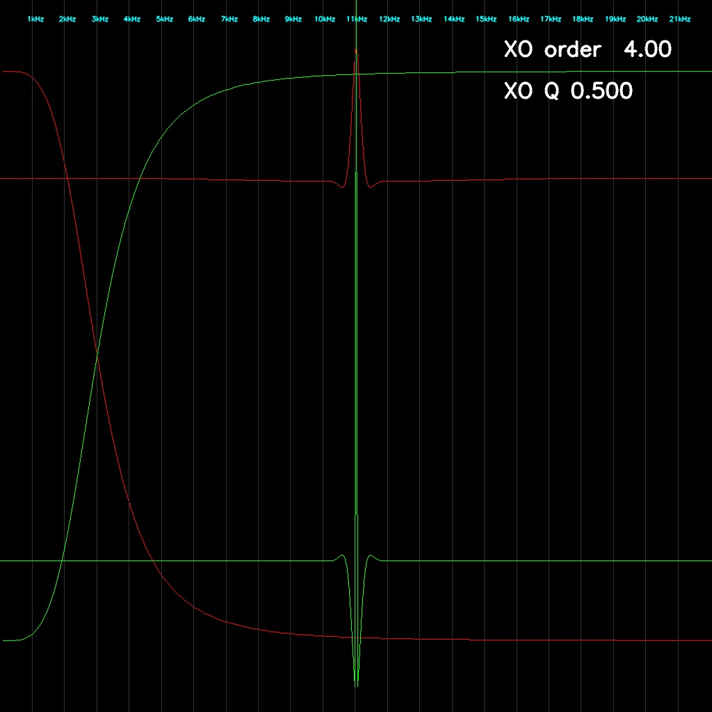

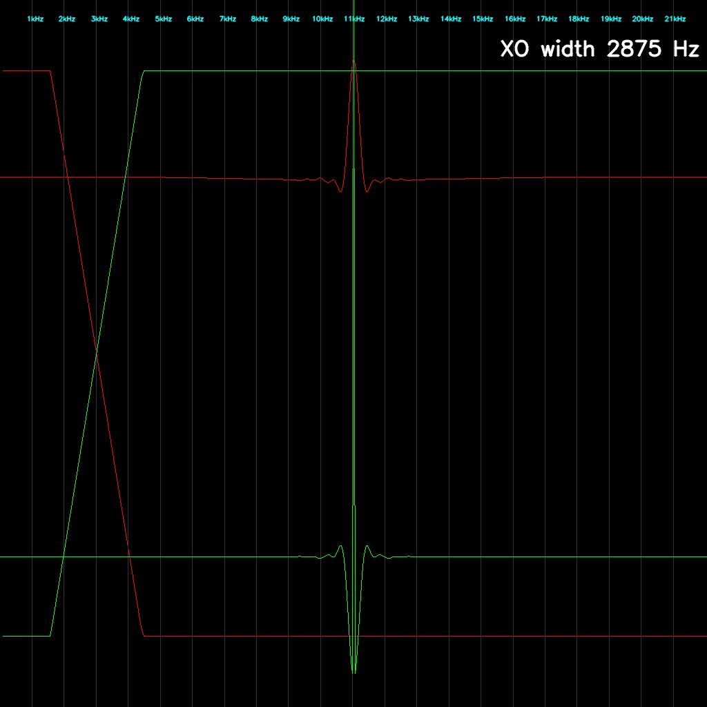

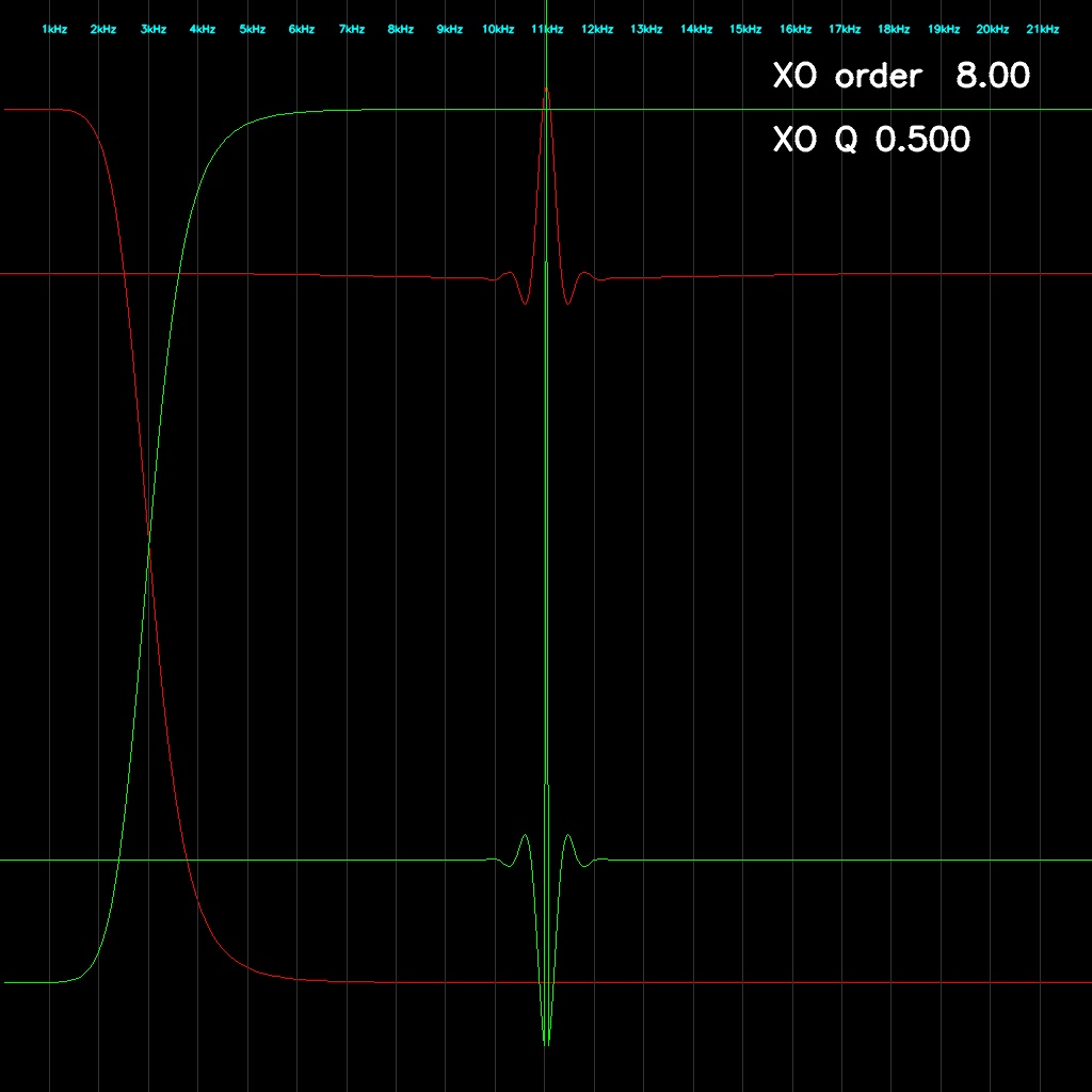

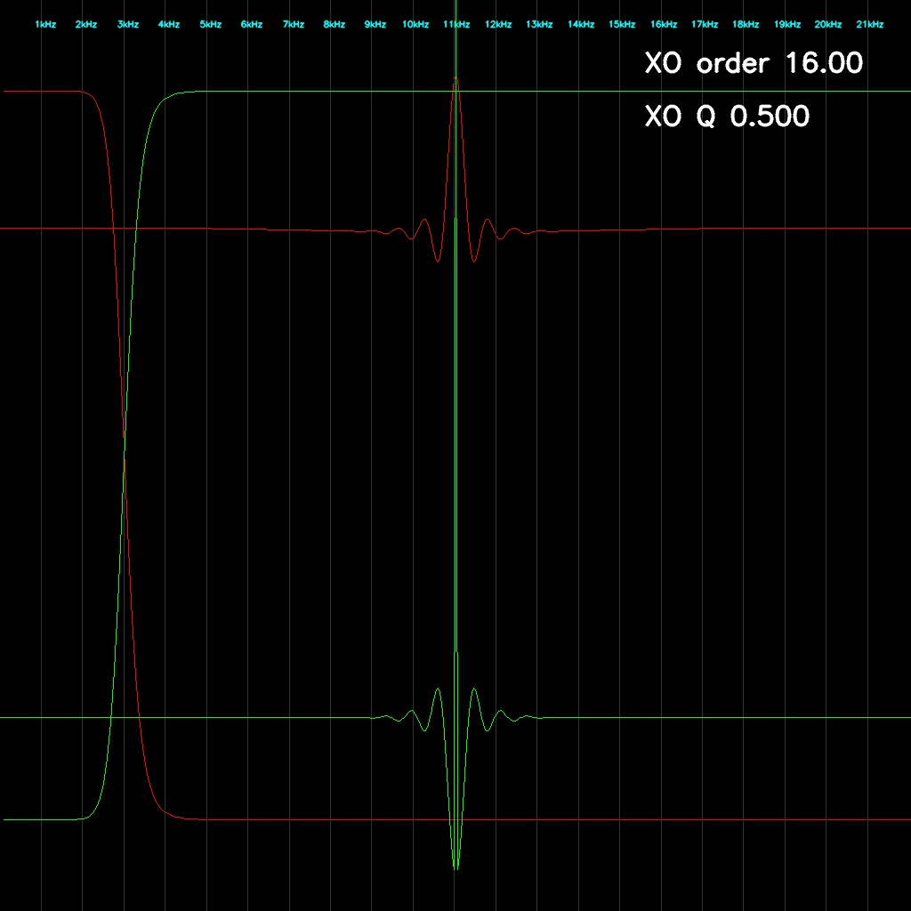

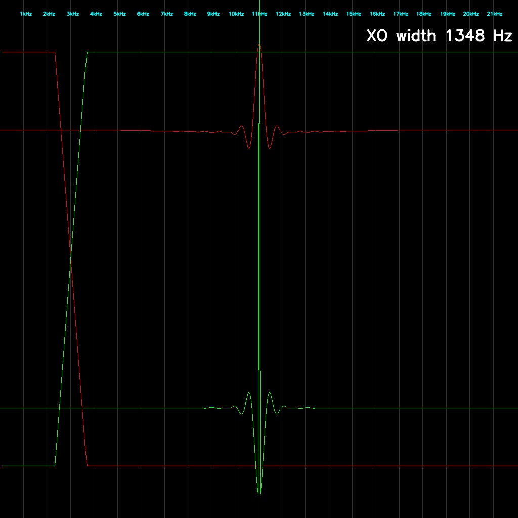

But just trying to get an intuitive grasp of all this, I've written a program simply to display the frequency and impulse responses of your standard kind of low pass filter (Gaussian derived?), plus the complementary high pass filter. I can animate sweeps through cutoff frequency and order. Just as a comparison I can do the same for my original naive 'linear crossover' filter.
The thing is, assuming the program's more-or-less correct, I'm finding it hard to make a bad one.
No great surprises at all: the linear crossover filter just isn't as terrifyingly bad as I thought it would be - pretty much similar to the 'correct' filter of a similar crossover steepness. And I'm not seeing 'nulls' or anything interesting in the ringing when the cutoff frequency is some factor of the sample frequency.
So, without any maths, is it the case that if I fitted some 'grab handles' to the frequency response I could subtly move things around and happen upon permutations that suppressed the amplitude of the ringing? (Or, as steph suggested earlier use genetic algorithms etc. - I like that idea). Or if I did that would I correspondingly increase the duration of the ringing instead, or degrade the effectiveness of the crossover? Can I expect a startlingly better performance by optimising the standard filter further or is it very much at the margins?
(Sample freq is 44100 Hz, FFT size is 512 in these images. Display axes are lin-lin. The impulse response has been windowed with a raised cosine window).
