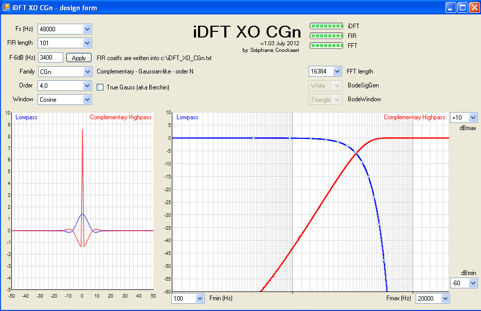

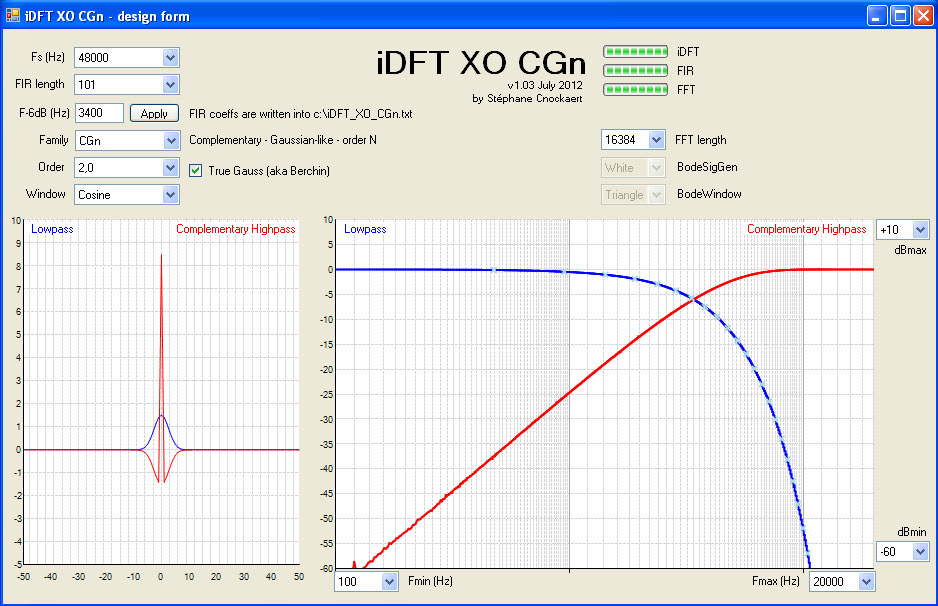

Edit: I enclose the results for Gaussian-derived (not too late to change that wording) at 2.0 (indicated as "Gaussian"), 3.0 and 4.0. Even the difference between a true 2.0 and the previous example of order 1.98 (or was it 2.02?) is noticeable.
Thank you. It really shows how "special" the true Gaussian response is. Interestingly enough, in the higher-order Gaussian-like cases, the impulse response does not appear to be significantly better than what you call the "standard" filters, which are approximations to classical filters like Butterworth and Bessel.

Now I understand, thanks. I'm attaching the corresponding design form.

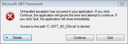

iDFT XO CGn does not work as it can not write to c:/iDFT_XO_CGn.txt
Creating a file with permission and ownership changes nothing as win7 won't allow it.
It is also bad practice to write there as EVE online found out when they modified autoexec.bat (which was their launch script) but accidentally took c:/ one instead.
