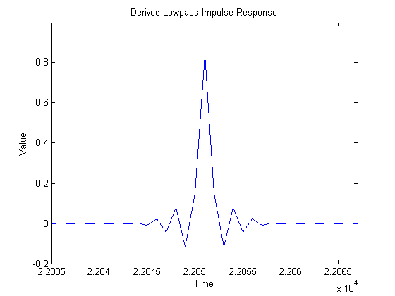

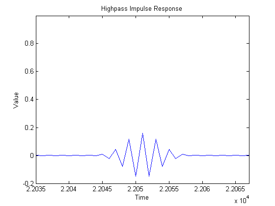

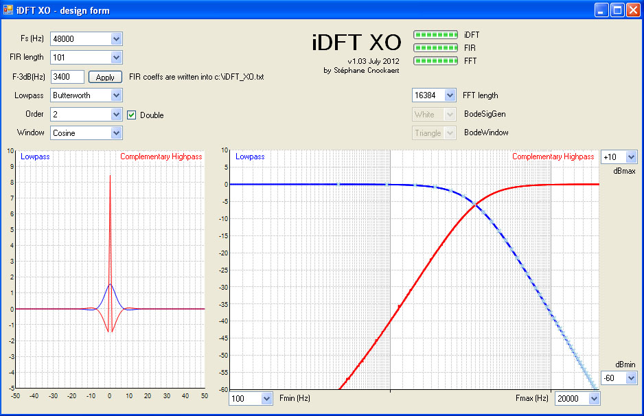

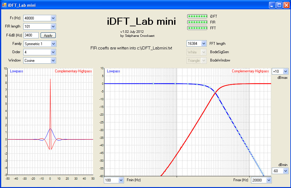

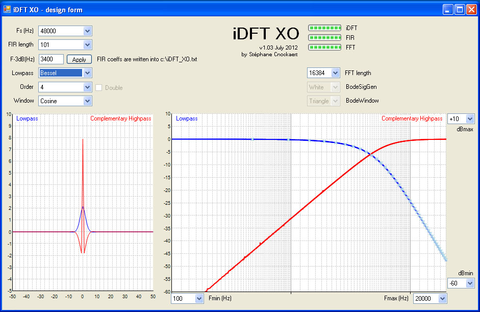

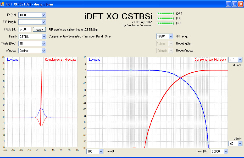

I just finished writing iDFT_Lab mini, dealing with linear phase complementary symmetric FIR crossovers.
"linear phase"
Both the lowpass and highpass exhibit a linear phase.
"complementary"
The sum of lowpass and highpass is equal to unity, both in amplitude and phase.
"symmetric"
When you view the amplitude plots with a log fequency scale, the lowpass slope and shape are the same flavour as the highpass slope and shape.

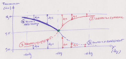

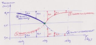

Now about the details.
For the crossover to be symmetric, the lowpass attenuation curve must exhibit certain properties.
Let us draw the lowpass amplitude using linear Y (from zero to one - this is the transmission factor) and log X (10 Hz, 1 kHz, 10 kHz, etc ...).
The X midpoint is thus 1 kHz.
Say 1kHz is Fc, the crossover frequency.
We know that at Fc, the lowpass amplitude is 0.5.
See the attached .jpg sketch
0) Let us draw the (1 kHz, 0.5) point in green, the crossing point
1) Let us draw an arbitrary lowpass amplitude on the log frequency scale spanning from 100 Hz to Fc.
2) Because of the symmetry that we are targeting, the corresponding highpass amplitude from Fc to 10 kHz, also got defined.
3) Because of the lowpass/highpass complementarity, the corresponding lowpass amplitude from Fc to 10 kHz, also got defined (dy1 and dy2 in red).
4) Because of the lowpass/highpass complementarity, the corresponding highpass amplitude from 10 Hz to Fc, also got defined (dy1 and dy2 in blue).
Looking at the four curve segments that just got defined, we realize that there is a central symmetry, with the particular (1 kHz, 0.50) point acting as centre.
The DC to Fs/2 lowpass amplitude curve serves as input for the iDFT.
The iDFT output is the corresponding impulse response in time domain. This way we get the lowpass FIR coefficients.
Knowing the lowpass impulse response, we compute the complementary highpass impulse response, the usual way. This way we get the highpass FIR coefficients.
A particular straightforward way to get a Nth-order lowpass amplitude curve exhibiting the symmetry requirement is :
For i = 0 To N
F = FS * (i / N)
If F < Fcut Then GAIN(i) = 1 - (((F / Fcut) ^ order) / 2.0)
If F = Fcut Then GAIN(i) = 0.5
If F > Fcut Then GAIN(i) = (((Fcut / F) ^ order) / 2.0)
Next
There are many other ways to generate lowpass amplitude curves exhibiting the symmetry requirement. For a given filter slope (or order), one could try softening the lowpass edge close to Fc, in order to see the effect on the time domain preshoot and ringing. Currently I have no idea how to simply (mathematically) soften the lowpass edge close to Fc. And I would hate editing the iDFT input by hand. Any suggestion welcome.

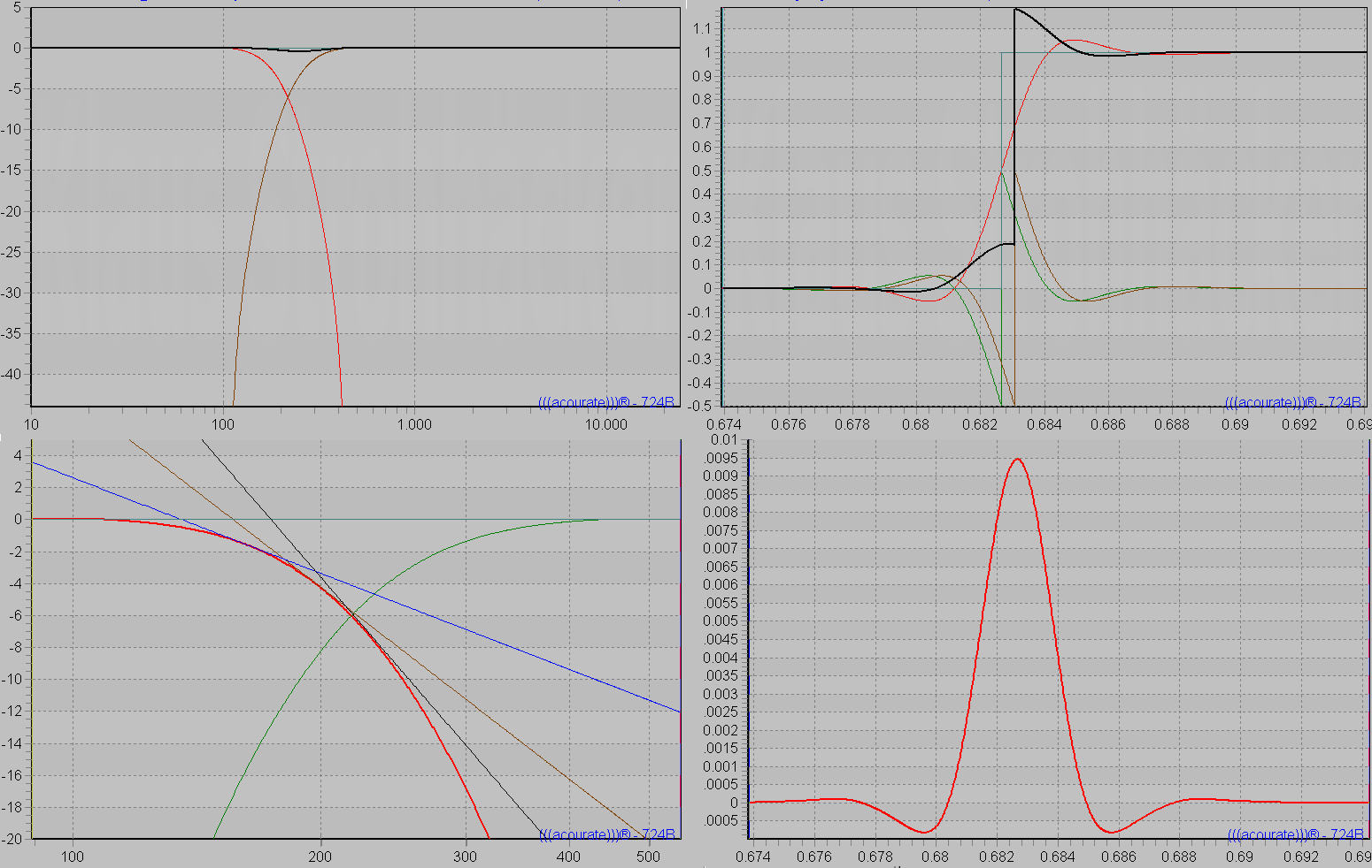

Back to FIR filtering, what do you think about linear-phase Neville-Thiele kernels as target functions?
I found that those (notably, 1st order NT) give a good overall compromise :
- compact kernels with low overshoot and low ringing
- sort of a "continuously rising filter order"-type of magnitude response
Attached a four-pic screenshot detailing the properties of a 1st oder NT at 215Hz.
Observations from top left graph, then clockwise :
- magnitude response, course. The restricton of the XO range to one octave left and right of center is clearly visible
- step responses of LP(red), HP(green), SUM(blue), delayed HP(brown) and finally sum(black) of the latter with the LP. In the mag plot we can see the delay causes a small broadband dip.
- the LP kernel impulse reponse. Has some kind of smooth "gaussianess", only a slight, 7% overshoot. Now, note the similarity of this kernel impulse to the "error shape" seen on top of the ideal step for the LP + delayed_HP case. That's why the kernel properties may be heard in some way (off-axis)**1. A Gaussian Pulse will not have a tonal character, rather it will sound like "noise pulse" (with a pitch sensation, still). The skewed, off-axis NT sum step shows some slight tonal ringing but still looks benign (try other XO functions to see). One might identify three periods of a shaped "215Hz" pulse with a fast decay at the skirts.
- close-up of the XO region, with 6dB, 12dB and 18dB slopes added for illustration, tangential to the LP response.
**1 : In minphase XOs the ringing (and it's complementary, "destructive interference" time sections in the step response) is also there, but it is masked off much better because it only post-rings.

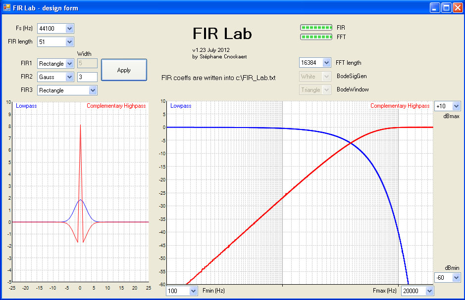

Unfortunately, that won't work well. When the Gaussian is centered at half the sampling frequency, its impulse response has a Gaussian envelope but every other sample changes algebraic sign -- it oscillates at the sampling frequency. See the attached graphs.With a subtractive filter can't the high pass section be used as the initial transfer function and then the low pass section derived from subtracting, instead of the other way around ?
Very interesting, and certainly viable. And demonstrative of the huge variety of design decisions to be made. Does one sacrifice frequency response for impulse response? Does one opt for linear phase or minimum phase (or something in-between)? Does one worry about spatial lobing due to non-coincident drivers and non-identical phase in the crossover sections? Does one worry about attenuation rates and driver overload? Does one worry about perfect reconstruction?Back to FIR filtering, what do you think about linear-phase Neville-Thiele kernels as target functions?
I am very happy to see that the trend is away from simply designing filters completely in the frequency domain, without regard to time-domain effects. It remains to be seen what levels of compromise are ultimately deemed to be "acceptable".
FIRs can deliver interesting complementary phase-linear crossovers. They can be incredibly sharp and selective, but on the other hand they exhibit presoot and ringing, and their attenuation curves are not symmetric when represented in log frequency axis. Some other varieties are less spectacular (they exhibit smaller slopes), but in exchange they don't exhibit preshoot and ringing, and their attenuation curves are symmetric when represented in log frequency axis. See attached .jpg. Which one would you try in first place?I am very happy to see that the trend is away from simply designing filters completely in the frequency domain, without regard to time-domain effects. It remains to be seen what levels of compromise are ultimately deemed to be "acceptable".

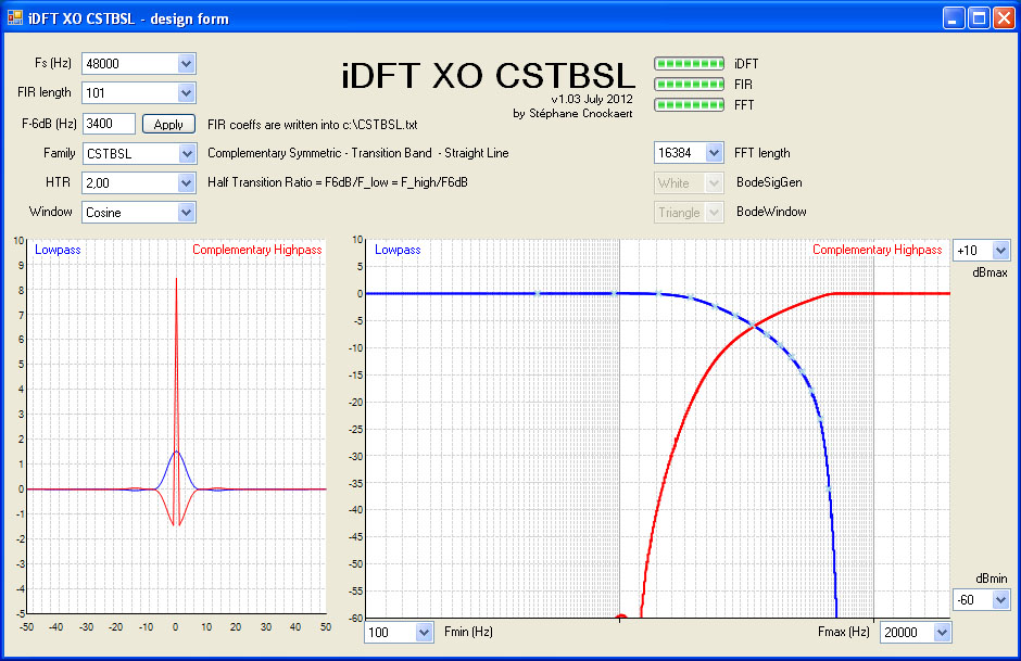

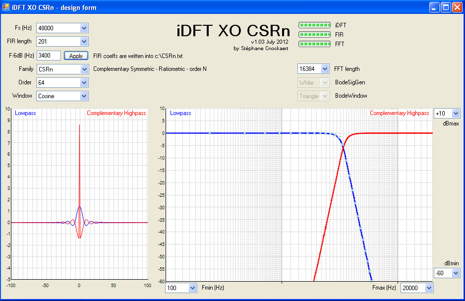

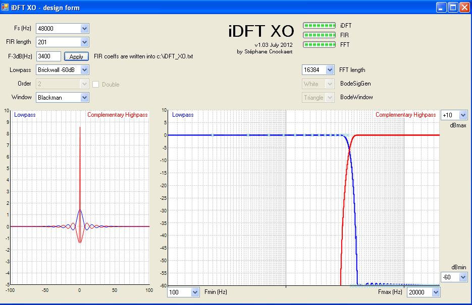

Well, as you know, I do genuinely like the look of the straight line transition band! In my earliest experiments I tried a sine-shaped transition band too, as it was intuitively more rounded than the straight line transition but, again relying on intuition, I'm thinking that slope steepness should be kept in reserve for the extremities of the crossover region, so the linear-ish transition gets closer to that.

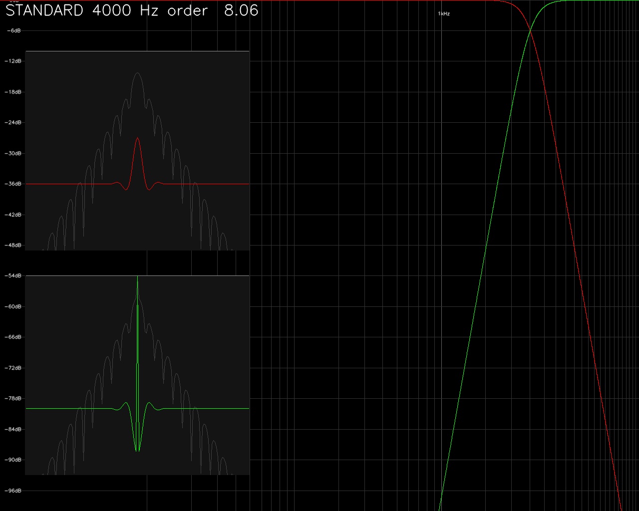

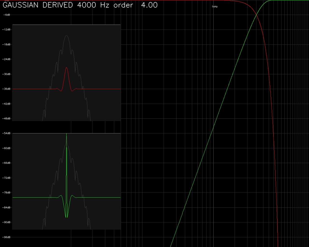

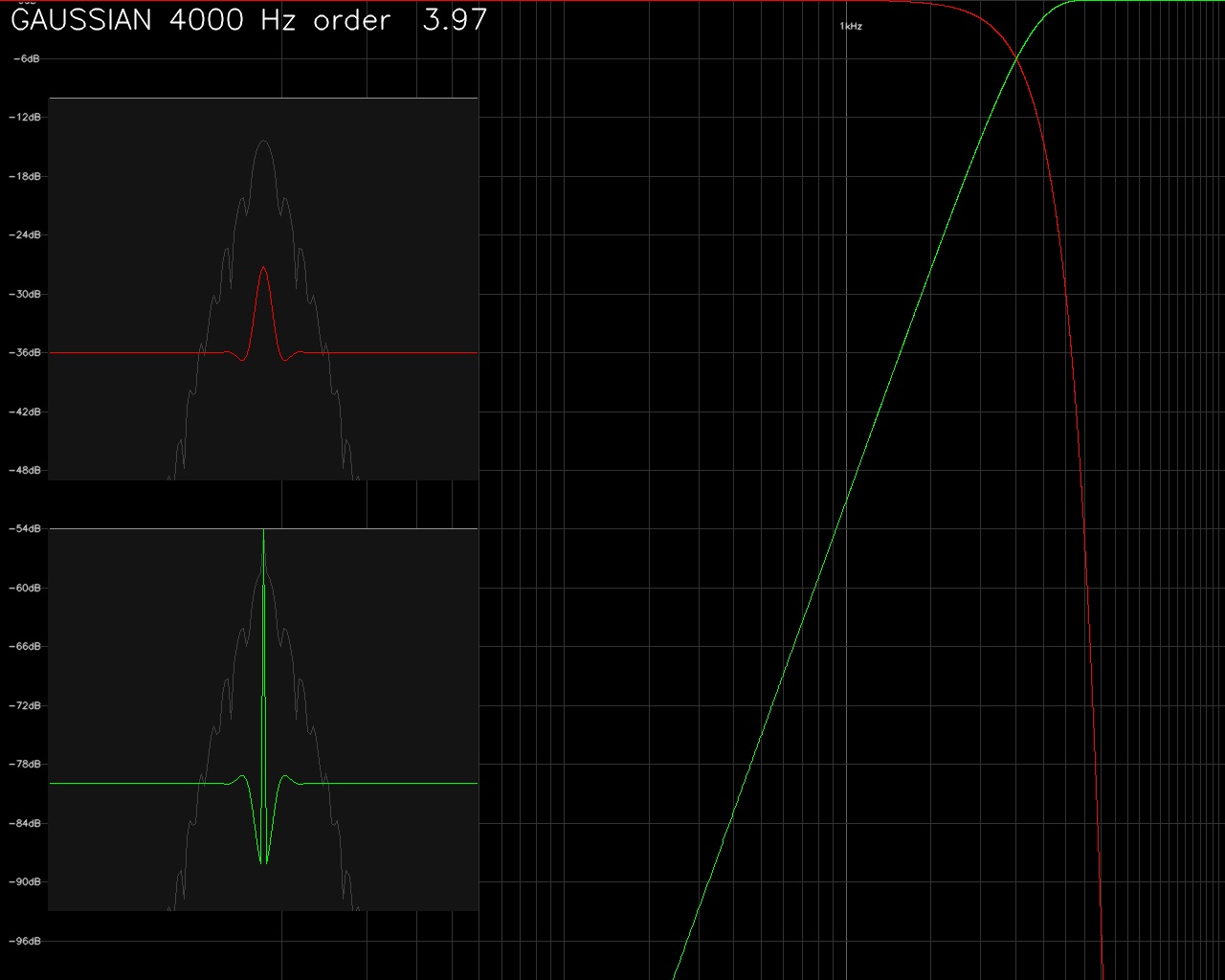

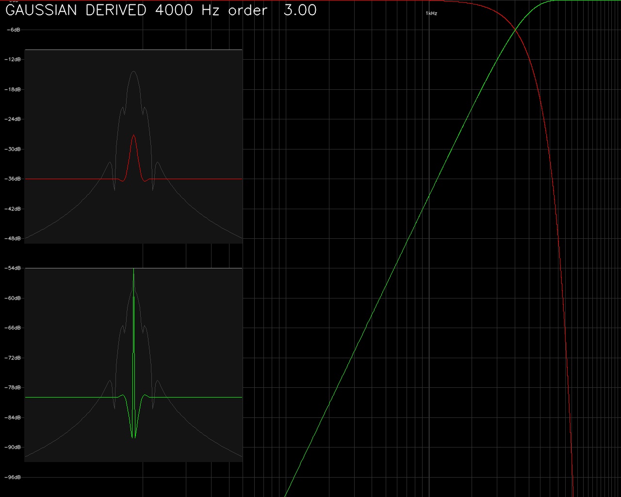

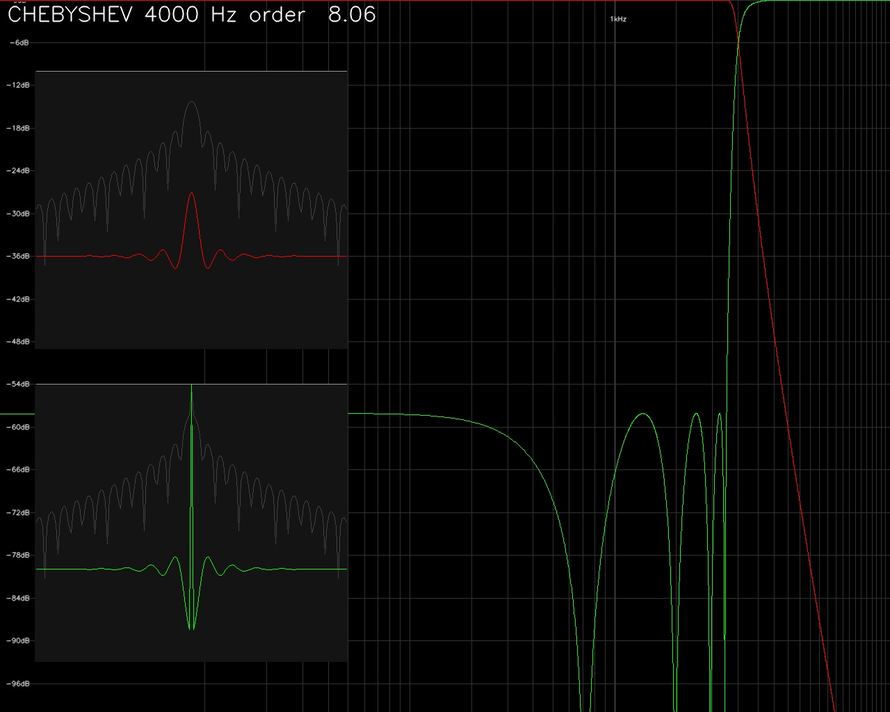

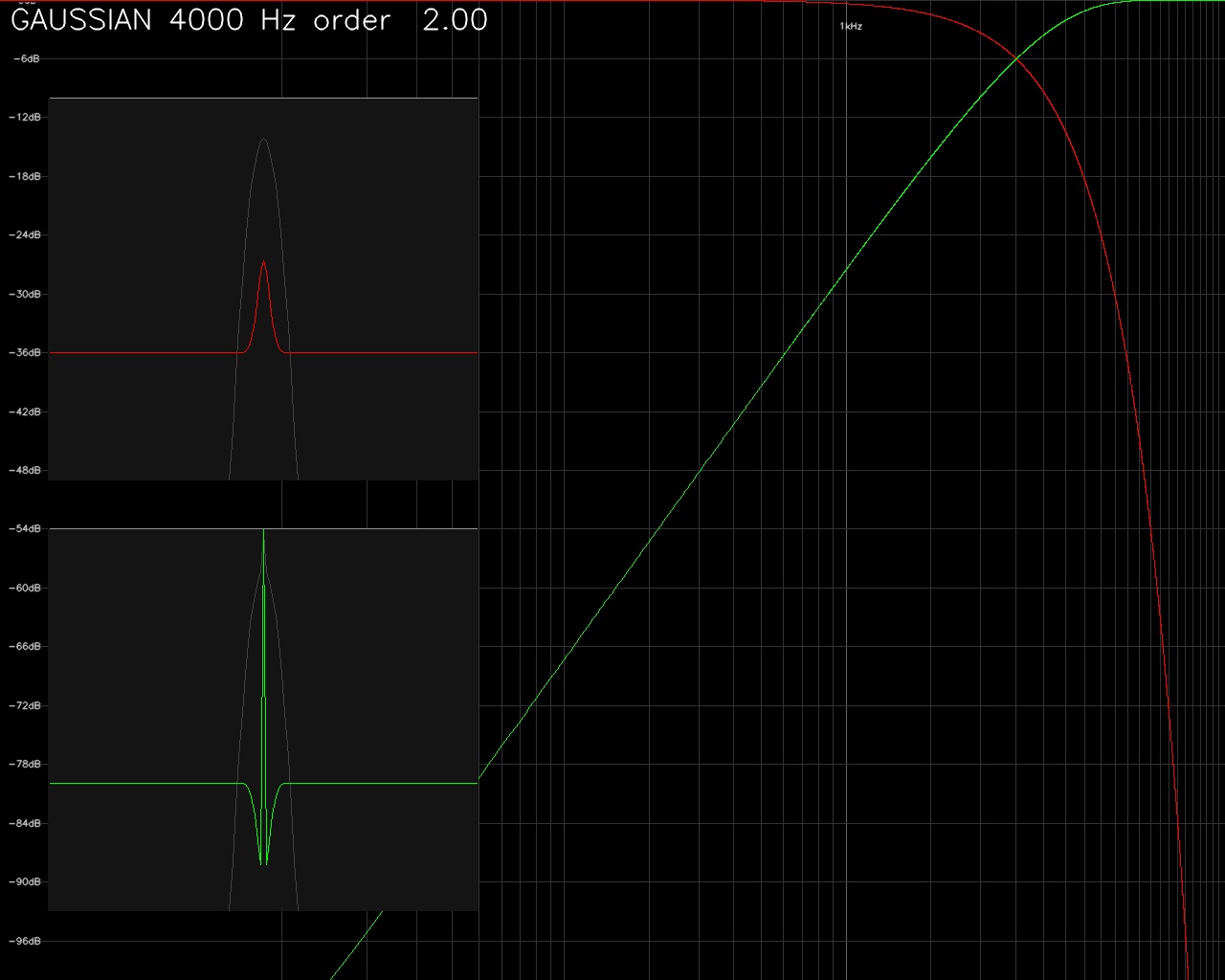

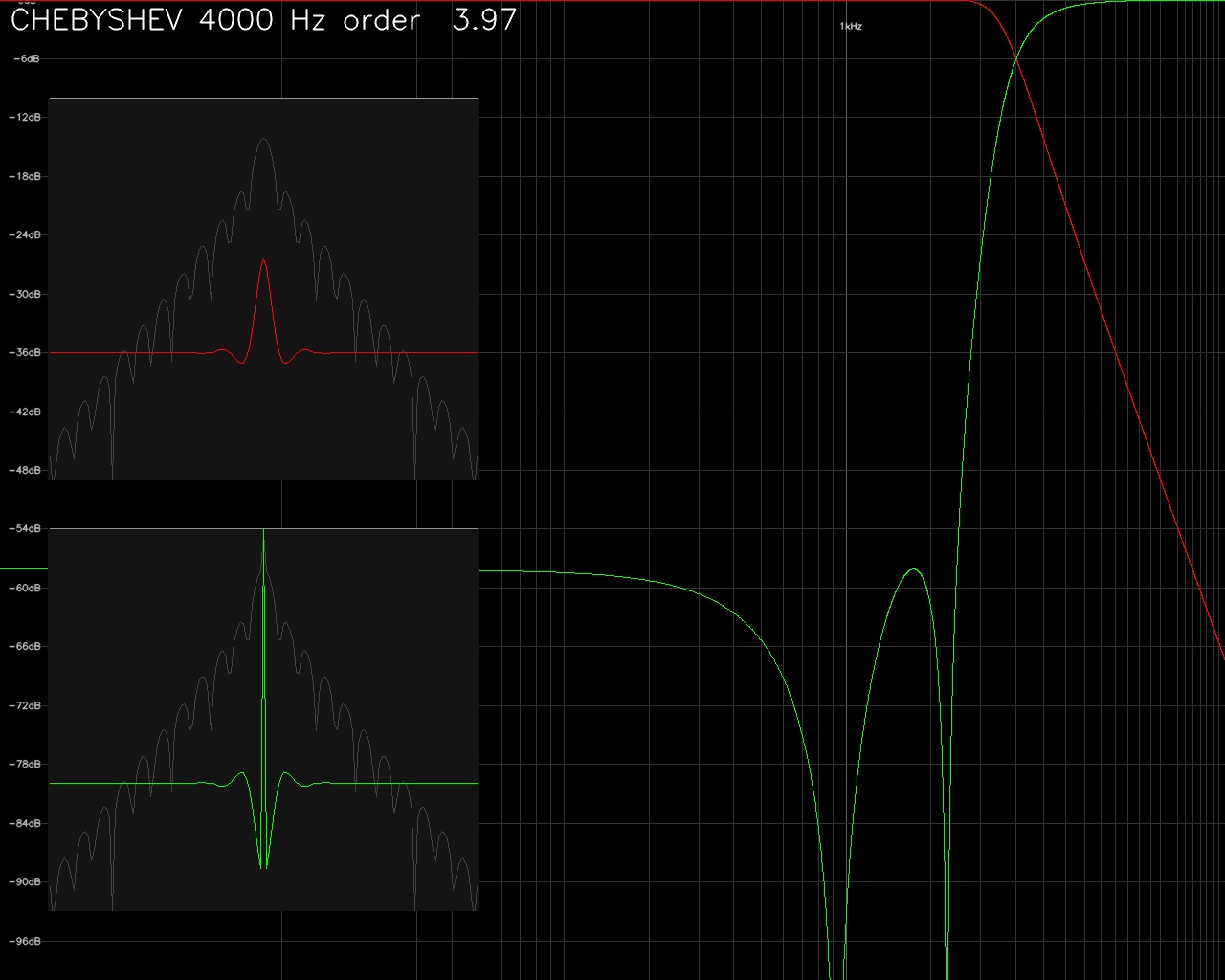

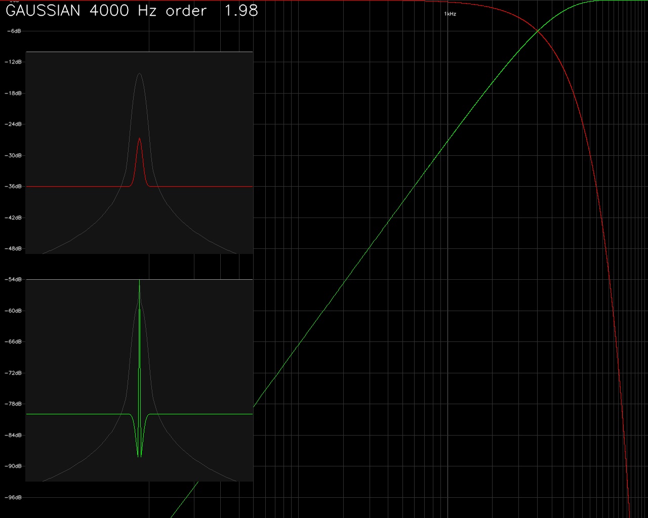

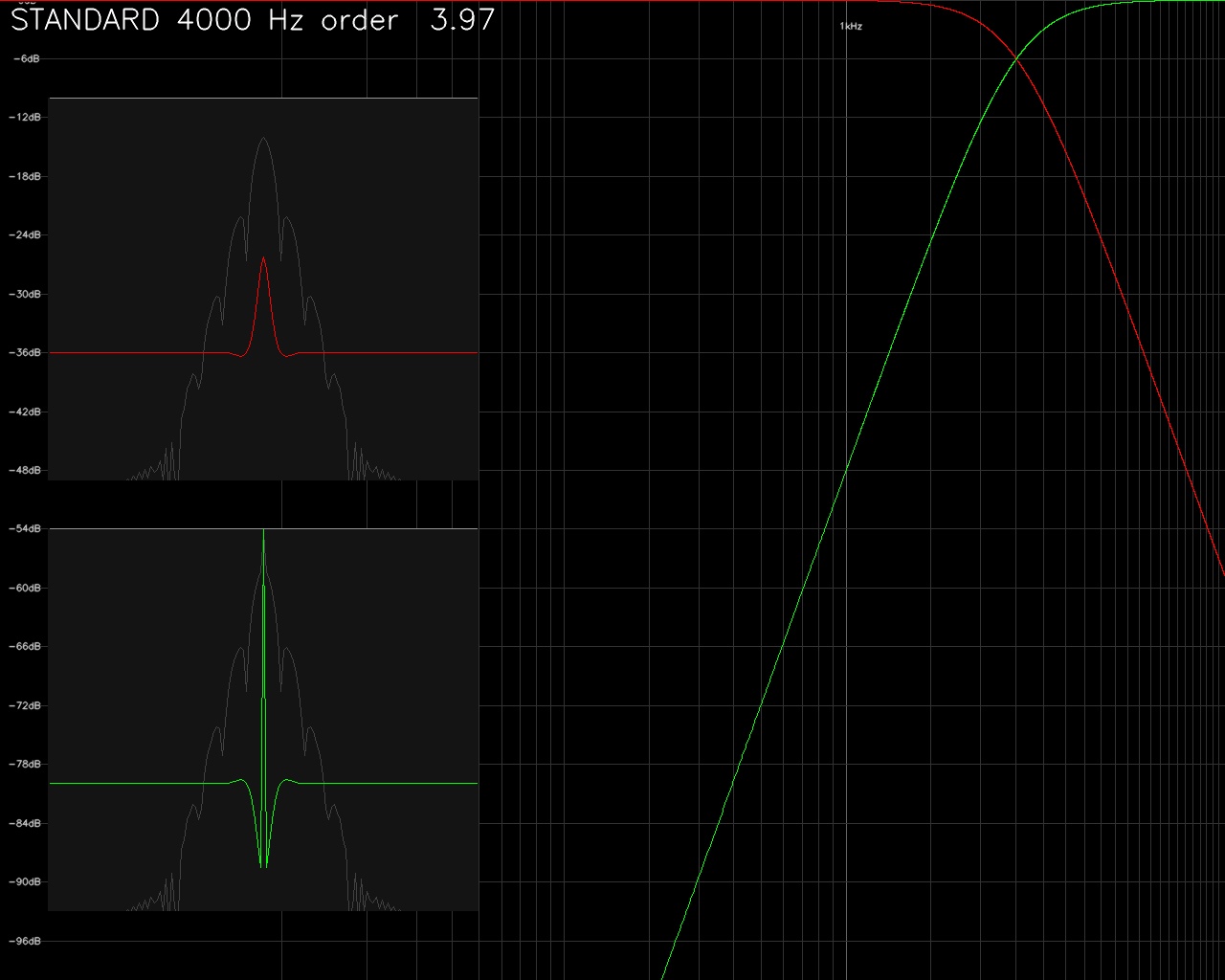

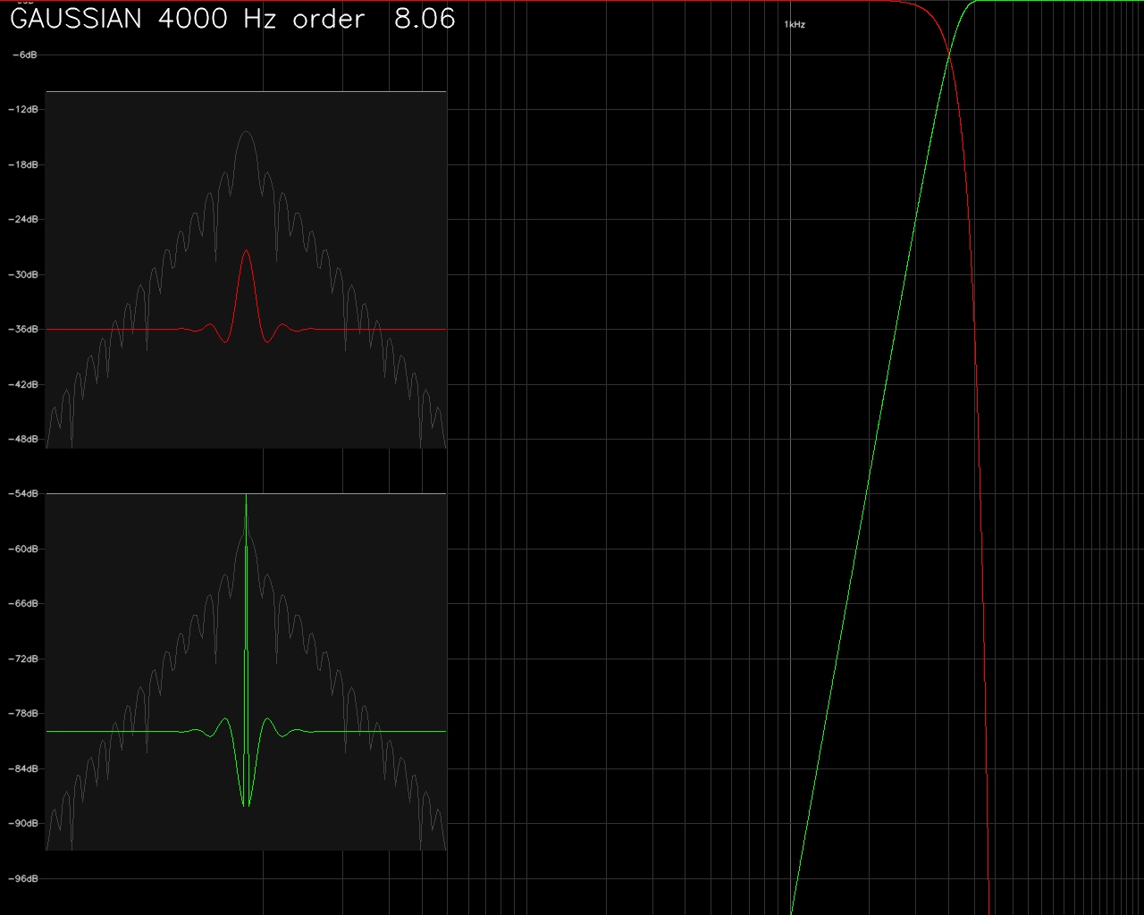

Might another graph be useful: a log representation of the magnitude of the impulse response vs. time? Using a linear display of the impulse response, it is not obvious that while some filters are good for ringing around the central impulse, they result in low level ringing that persists for longer.
I enclose some screenshots where this information is overlaid onto the normal impulse response images (I need to indicate dB etc. and I notice the frequency response dB markings next to the impulse responses are confusing.) Also, it might look better if only the peaks are used, joined into a smoother line.
Excellent! I was hoping that you would do this. It shows just how much ringing is actually occurring, even on waveforms that appear to be benign when viewed on a linear scale.Might another graph be useful: a log representation of the magnitude of the impulse response vs. time?
However, once again it appears that you are again referring to "Gaussian-like" waveforms (exp[-|x|^N], where N != 2) as "Gaussian". Please, to avoid misunderstanding, do not do that. It is only a Gaussian if N==2.
EDIT: Also, the difference between N==2 and N==4 is profound. Could you try N==3? Thanks.
Hi gberchin
Yes, sorry. What is the best description? "Gaussian-derived"?
Edit: I enclose the results for Gaussian-derived (not too late to change that wording) at 2.0 (indicated as "Gaussian"), 3.0 and 4.0. Even the difference between a true 2.0 and the previous example of order 1.98 (or was it 2.02?) is noticeable.
(I have changed my UI to give me fixed steps of 0.2 in the order rather than a multiplying factor as previously, which was good for going up to very high orders quickly but a bit arbitrary in the step size).
