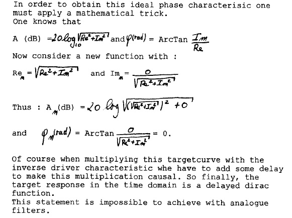

That's true. And me too, reading the 1983 Stanley P. Lipshitz and John Vanderkooy publication at the AES, I regret they have not discussed in depth the use of a Bessel lowpass as kernel, delivering a 12db/octave complementary highpass. They preferred dealing with the details of the Butterworth lowpass kernel, delivering a 18dB/octave complementary highpass.
There is a reason explaining their choice. A crossover featuring a 12dB/octave highpass rolloff in the transition band, is an insufficient performance as most unfiltered tweeters already exhibit a 12dB/octave highpass rolloff at 800 Hz or so (tweeters equipped with a back chamber) or 2 kHz or even higher (tweeters without a back chamber). Say you design the crossover for acoustically crossing at 2 kHz at 12dB/octave. The tweeter won't get properly isolated from the low frequencies. It will nearly receive all the low frequency content. You run the risk of exceeding the tweeter Xmax, and even if you don't exceed it (thanks to a stiff tweeter suspension), the bass content flowing in the tweeter coil will heat the tweeter magnet (modifying the system efficiency), and will modulate the magnetic field (it may lead to magnetic saturation).
When I read your 1999 publication, it looks like the Gaussian lowpass filter (no overshoot) is an infinite order Bessel lowpass. Because with the Gaussian filter as lowpass kernel, just like in the Lipshitz-Vanderkooy operating with a Bessel lowpass as kernel, the complementary highpass is characterized by a 12dB/octave rolloff in the transition band.
The 1993 Philips publication (6 years before yours) goes beyond this, departs from Bessel or Gaussian, and sets a new intelligent compromise, allowing a moderate woofer time-domain overshoot (say 10%), bringing a complementary 36dB/octave highpass rolloff. The design is so elegant, that both the lowpass and the highpass feature 36dB/octave slopes. All this with a 79 tap Woofer FIR and a 30 tap Tweeter FIR. Back in 1993, they did not divulged the maths. See in the attached .jpg, how they escaped from explaining the whole stuff.
Do we have an explanation, nowadays?
Using a 32768-tap FIR implemented with the FFT then inverse FFT trick, looks completely nuts unless you try to deconvolve the listening room. This would mean that we are not anymore dealing with a speaker crossover.
Considering the Philips DSS-930 results described in the 1993 AES communication, for a diyAudio FIR application on a WinXP PC, I would recommend basing on 256-tap FIRs. For a stereo 2-way system operating at 48 kHz, you only require 50 million multiply/accumulate per second, without relying on the FFT then inverse FFT trick.

There is a reason explaining their choice. A crossover featuring a 12dB/octave highpass rolloff in the transition band, is an insufficient performance as most unfiltered tweeters ...
Acknowledged. The objective behind my paper was to present the mathematically optimal solution, in terms of duration-bandwidth product, overshoot, and ringing. Application of that optimal solution to a particular driver was not a consideration.
There is a bit of hand-waving there, indeed. Basically, we can find ways to generate any response that we desire, but anything that departs from a Gaussian lowpass, and its complementary highpass, will overshoot and ring.
A very nice symmetrical solution, implementable only in FIR, is inspired by the fact that the equation for a Gaussian is exp(-x^2). If we instead use exp(-x^4) for the lowpass, then the complimentary highpass has a 4th-order slope (24 dB/octave). There is a small amount of overshoot and ringing in the time domain.
Finally, if you have a copy of my original AES paper, be aware that there is an error in the math associated with "multi-way" crossovers. Corrections are available from me, just by asking.
I would like to write a Visual Basic application dealing with such approach.
1. You would specify the sampling frequency (48 kHz), the slopes (36db/octave for the lowpass and the complementary highpass), the allowed time-domain woofer preshoot (10%)
2. You would specify the crossover frequency. In the DSS-930, the crossover frequency was 1/12th of the sampling frequency. There shall be choices like 1/32, 1/24, 1/16, 1/12, 1/8, 1/6. This may lead to optimal results and/or lots of zeros in the FIR coefficients.
3. You would specify a FIR lenght
4. As starting point, the program would take a Gaussian lowpass FIR corresponding to the specified crossover frequency (and order possibly). This is computed in a deterministic way, in a few microseconds.
5. The WinXP program would graph the lowpass and complementary highpass time-domain responses.
6. The WinXP program would graph the lowpass and highpass Bode plots (gain and delay-compensated phase).
7. In order to get the required out-of-band attenuation, the program would progressively modify the woofer FIR coefficients by introducing windowing. There may be an extra parameter associated like this, like 40 dB or 60 dB.
8. In order to get the required highpass slope (instead of the 2nd-order that's coming from the Gaussian starting point), the program would progressively modify the woofer FIR coefficients by introducing preshoot
9. The program would estimate each iteration, and only validate the ones converging towards the targeted Bode plots
Currenty I don't know if there is a deterministic way to do this straight, or if it needs to be viewed as two MLS converging to particular targets (the lowpass and the complementary highpass), or if we shall rely on genetic algorithms, etc ...
I guess the program will need to iterate through steps 5 to 9.
The user would visualize the algorithm converging to some solution, and manually halt the iteration at will.
Such approach shall remain simple, halfway between deterministic and bruteforce.

Now, if we want to add the driver compensation feature (a Bode Plot inversion), nothing prevents embedding it into the final FIR.
If we need a better frequency resolution for compensating the driver, nothing prevents from basing the whole design on a longer FIR, featuring a length that's compatible with the efficiency set we are starting from. I guess that if the high efficiency FIR was N taps, that a (2N+1) FIR lenght or (3N+1) FIR lenght won't harm the efficiency pattern.
Possibly, in the Philips DSS-930 design, the 30 tap tweeter FIR managed to do both the highpass crossover, and the tweeter Bode plot inversion.
Possibly, what Philips calls a 30 tap FIR, is in reality a 31 tap FIR, as a 31 tap FIR is only requiring 30 memory cells.
Possibly, in the Philips DSS-930 design, a 30 tap woofer FIR was too short for embedding the woofer Bode plot inversion. When looking at the woofer unfiltered frequency response featuring a steep extinction above 5 kHz, for sure such woofer was exhibiting a quite long ringing at 4.5 KHz or so, even if such natural ringing was shortened using a dedicated, IIR-based notch. Possibly Philips needed to extend the woofer FIR length to 79 tap (1.65 ms), for encompassing the 4.5 kHz residual ringing untill a decent extinction. The 1.65 ms FIR duration equal 7.4 periods at 4.5 kHz.
