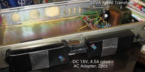

Regarding to the transformer, it is used for only heater of the tubes
and small current into two tiny tubes (DC270V, 10mA x 2ch). So 30VA
rated transformer is enough. (See attached photo).

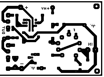

Regarding to your PCB design, I found Pin #4 and #5 are not connected
to the AC6.3V winding of the transformer. It is for the tube heaters.
Hello
I forget the heater because it was not on the schematic .
But is no to late .I will fix it .
I ask the transformer size for the mosfet part if 300VA enough .
I will correct the lay out and I posted again .

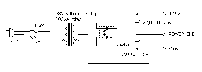

gaborbela said:I ask the transformer size for the mosfet part if 300VA enough .
200VA rated transformer is enough as shown in the attachment.
The secondary winding should be 28V to 30V (w/ CT) and 6A rated
is better to assume enough current margin. You can merge the windings
into one transformer for the tube portion of AC115V 50mA and
AC6.3V 1A so that you can use only one transformer.

I fixed the lay out , I forget .You know I look at the schematic and thinking about the best solution for the layout .
Believe me is not easy to do it with out any software .
I did made already 5-6 layout with out any program , some of them more complex .
HERE I POST THE GOOD LAYOUT !
Not tested yet but it supposed to be good . Please check it carefully .
These was design for vertical mosfet Toshiba 2SK1529 .
Greetings

gaborbela said:
That transformer for both side or one side ?
A 200VA transformer can feed to L/R channels of MOS FET power
sections.

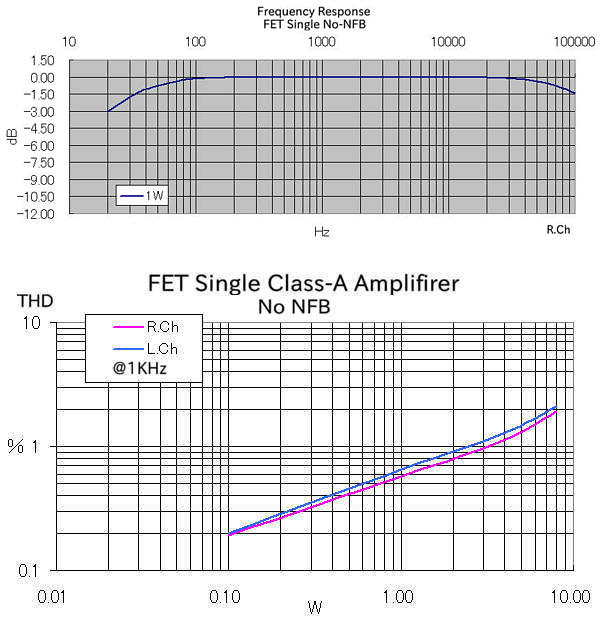

sajti said:I found, that low current mosfets (low capacitances) are better for this application.
Hi ! sajti,
The input capacitance of my MOS FET is 4,600PF given by the datasheet.
The actual frequency response is shown in the attached photo. I believe
this result is enough to get good sonic. Regarding to heatsink, yes,
forced air heatsink is mandatory required otherwise 50cm x 50cm
x 10cm sized natural cooling heatsink is needed. I used PC CPU purpose
heatsinks as shown in the below URL.
http://ja1cty.serevehttp.com/mosfet/FET-outside.jpg
