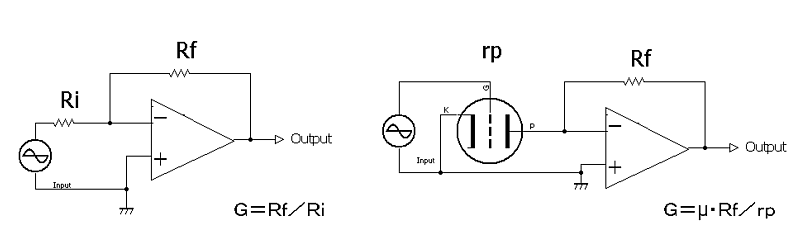

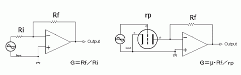

Hi, revintage. Thanks for you quick response to show your hybrid amp
schematic. It is very interesting for me. I quickly analyzed it and made
a simple diagram to analyze NFB topology as shown in the attached
photo.
You applied DG feed back for MOS FET. I assume it is an inverting op-amp.
Therefore feed back resistors consist of Rf and rp of 6H30. The total
gain is given by following formula(assuming IT ratio is 1:1).
G=Mu x Rf / rp
In this formula, rp is not linear. It depends on the signal level as makes
"Tube SONIC". Anyway, you are using simulator so that you will get
distortion vs signal level relationship. I guess it is "SOFT DISTORTION"
like tube amps.

Hi ja2dhc,
You have totally misunderstood the schematic! None of your conclusions are right! And that is a good thing !
Please download LTSpice(www.linear.com) and the Schade-paper from 1938(www.petemillett.com). This could add valuable knowledge. I can then supply you with the sim file to play around with. I can also sim your circuit for you.
If you had checked the schematic properly you should have seen that the IT is 4,5:1.
About the feedback over the MOSFET it gives you a gain of 3 and also makes the characteristics being triode- instead of pentode-like. A FFT-analyzis will show this. Input impedance is also very high and more dependant on capacitances and the inductances of the IT and capacitances of the MOSFET.
So the 6H30 works into a HIGH impedance in the midband(1M). At 20Hz it works against the primary inductance and will be ca 13k. At 20k it is working against capacitances in the IT and the MOSFET and will probably be in the ballpark of 3-500kohm.

revintage said:If you had checked the schematic properly you should have seen that the IT is 4,5:1.
My point is that your amp's characteristics is SOFT DISTORTION like
tube amp, not precise analysis. In my previous post, I indicated
"assuming IT ration 1:1". If 4.5:1 is used the formula is simply changed
as follows;
G=Mu x Rf / rp /4.5
The above includes Mu and rp which are the signal level dependent
factors, like tube amp so Tube sonic is obtained. This is my point.
I am using TINA simulator instead of LTspice. I want to see your
simulation result of SOFT DISTORTION.
