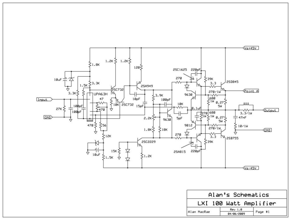

I don't know that much about hybrid amplifiers, and the schematic I am about to show is not class "A" but I would like to know if an amplifier like this could be turned into a hybrid, remove the FET chip pre stage for a tube one. If not I might try one of the other circuits but I would like to use the parts that I actually have, in this case a 100 watt LXI amp that already looks and sounds good but could be waaaay better.
Pleas don't laugh at my insane question.

Yes, it could be waay better if to use a different output stage.
So what would you suggest I do, I plan on upgrading the old Tohibas to newer ones. I have matched sets of 2SA1301's and 2SC3280's that I can parallel at the output, but I'm not sure about the input and driver stage, I just like the sound of mixing both tubes and solid state together.
I have some pictures and some other info on another forum, and I have allready planned for a tube preamp, but to Hybridise the amplifier would just be cool. 😉
http://diyaudioprojects.com/Forum/viewtopic.php?f=10&t=871

If I was building the amplifier from scratch I would be using mosfets, but I am trying to spend as little money as possible, and use as much junk parts as possible.
From what I've read Wavebourn, any of the circuits shown here are single ended mosfet and operat in class "A" the amplifier I am working on operates in class "AB" as far as I can tell, and puts out 100 watts into 8 ohms, and is not a simple design to modify.
But I think that it would be possible for me to simplify the amplifier circuit a little, and using the knowledge that I have learned exchange the input stage for a tube one, say 12AU7 or 6CG7, 6SN7? 😕
Whatever I do I will post my new schematic, and just maybe.... 😱
