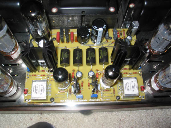

I’ve been reading this thread with some interest. For anyone interested in an amplifier with an excellent hybrid design, Kevin Carter of K&K Audio has designed upgrades for the venerable Dynaco ST70. The design makes excellent use of solid-state devices and vacuum tubes combined to work in a circuit topology that is radically different and bears no resemblance to the original ST-70. In my opinion, the word “upgrades” is a misnomer. The design is more than sufficient to stand on its own without being tied to the ST70 in any way.
Kevin’s impressive sounding, pure Class A design uses a Lundahl amorphous core input transformer for phase splitting in place of 7199 tubes. Kevin has determined that, besides achieving very accurate phase splitting across the bandwidth, the input (or interstage) transformer “provides galvanic isolation between the source and the amplifier, removing the possibility of ground loop hum involving the power amplifier…” Following the input transformer, a pair 6N23P (6922)tubes is used in a differential stage to drive the EL34 output tubes through four coupling capacitors. According to Kevin “this input stage provides relatively high gain and very symmetrical drive to the output stage at a moderately low impedance.”
In the differential PP output stage, a pair of paralleled current sources (DN2540NS) is used, to which both cathodes of the EL34s have been connected. EL34 bias is adjusted by setting the current sources for the bias current of your choice. Besides operating the input stage as a Class A differential amplifier, the output stage also is true Class A differential and can be configured to operate in ultralinear (35w per channel) or pure triode mode. No global feedback is used. Kevin also explains: “Operating the output stage differentially also means that the output tubes "track" each other dynamically (as well as their initial matching allows.) This lowers distortion and dramatically improves sound quality..."
The power supply is robust and made simple by virtue of the good power supply rejection provided by differential amplifiers.
The modified ST70 sounds very dynamic and its 10W per channel (triode connected) must be heard to be appreciated. The sound is very open, airy, transparent and musical. To my ears, it rivals some very good single-ended amps. 10 watts don’t tell the whole story. There is more than enough power to drive my pair of 90dB Green Mountain Audio EOS HD monitors effortlessly.
Kevin currently sells an upgrade kit that can be purchased in various configurations depending on budget and performance needs. Although the original A470 OT is very good (to some, even ‘legendary’) the kit can also be used with modern transformers in the chassis of your choice.
