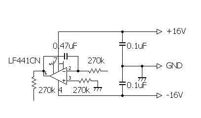

gaborbela said:Hello ca2dhc
I would like to have a question.
These is about the LF441CN IC . Do I have to connect the # 1 & 5 of the IC ?
Hello, Thanks so much to build a hybrid amp. Pin #1 and #5 are
designed for an adjustment of offset voltage. According to the datasheet
of LF441CN, the maximum offset voltage is only 0.5mV which may
be outputs to the speaker terminal. I don't think 0.5mV makes the
speaker broken or bad impact to the sonic. You can keep open #1 and #5.

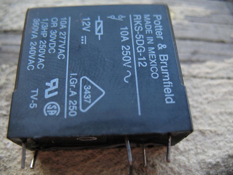

Hello
Thanks for your answer
Do I have to use the relay or is enough if I use a soft starter for the power supply .
If I have to use relay what type of relay do I use .I have at home some 12V type with 5pin I don't know if I can use them ?

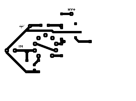

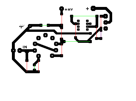

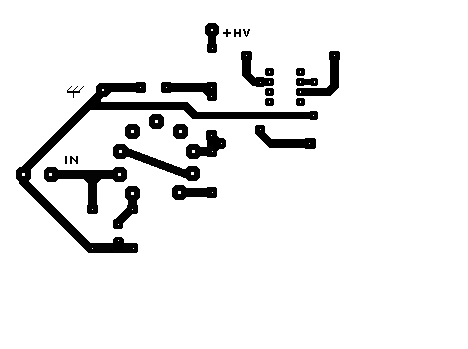

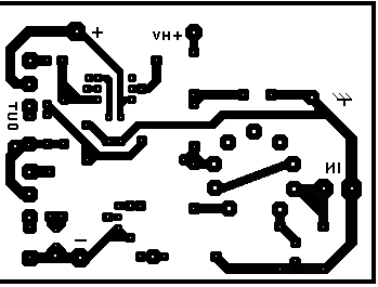

Hello
I little more work done on the PC board .
I'm planing to use large heat sink instead air forced heat sink .
I do not like the noise of the fans .
I have large heatsink . Do i have to use a preamplifier or I can connect direct to the CD player using a blue velvet Alps pot.
Greets

Hi ! very quick response, gaborbela
If a "soft starter" is used, relays are not needed but it depends on
the characteristics of "Soft Start". I recommend you to reserve a space
of relays for a back up in a case of necessity. The relay which you showed
can be used for the purpose if coil voltage is adjusted to 12V from +16V
rail by a resistor in series.

Hello
Thank you
I'm still working on the layout , I do with my hand .
One more question .
Only the three pin have to connected the LF441CN IC ?
My fried ask what about pin #4 and #7 .
I do after the schematic .
In case if I have to connect those pins please let me know .
Thank you

Thank you
One more question .
Thank you
Greetings
gaborbela said:My fried ask what about pin #4 and #7 .
The pin #4 and #7 are connected to the rails of +/-16V.
Please refer to the attached photo.
#7: +16V
#4: -16V
Don't forget by-pass capacitors of 0.1uF-10uF near by the IC
as shown in the photo.

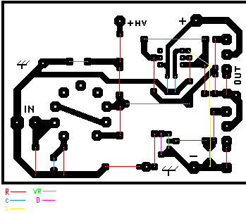

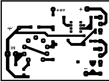

Hello
Finally I finish the layout for these amplifier .
I made it by hand so if you use it used for your responsibility .
It was not tested so it can have some mistakes etc . I would be not responsible in case if U use it and cause any damage to you .
Greetings
Greetings

I like the high voltage on the tube .
What size of transformer use for the power amp section .
300VA is enough?
I hope yes because that is I have at hand .
I will buy some Russian military tubes .
May be some carbon type resistors .
Right now I'm curious to what kind of schematic will come up revintage .I hope he shares with all of us .
The finale layout with the parts marked on .
Greets
