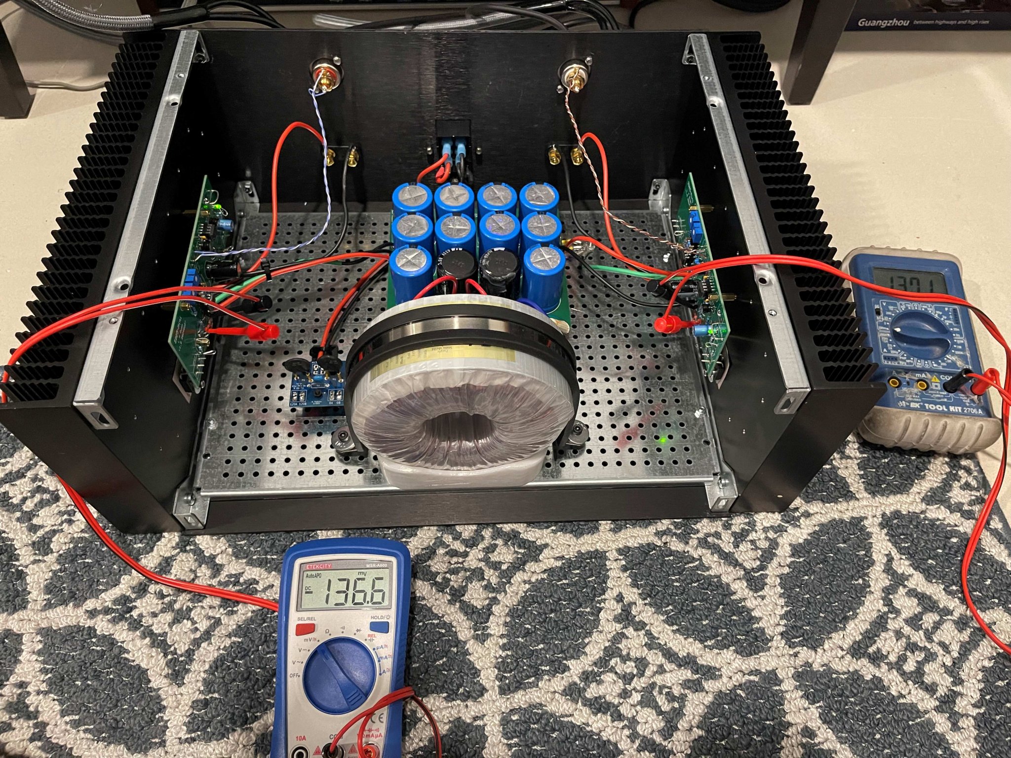

I‘m just in the process of toning down the bias to 1A (110mV across R1) which is a breeze to achieve, this amp is so calmly stable, although offset is a bit jumpyer, but i got it tamed in the sub-mV…

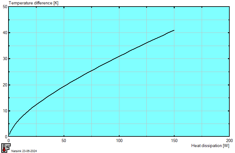

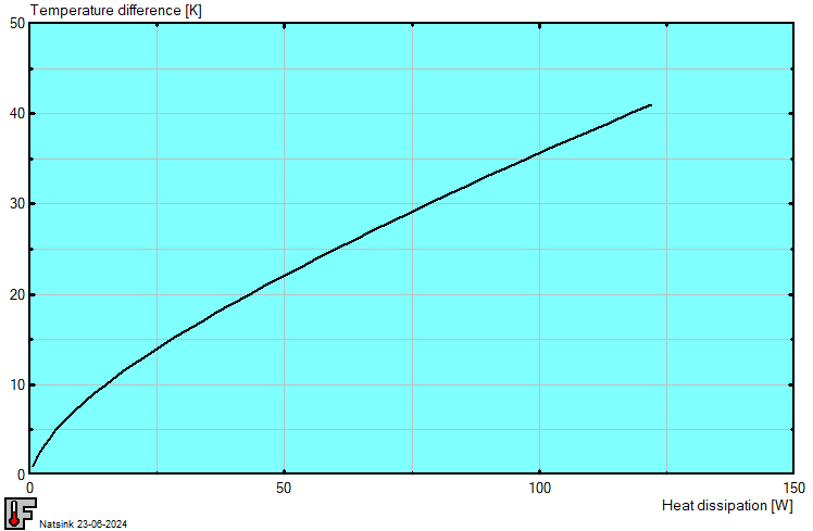

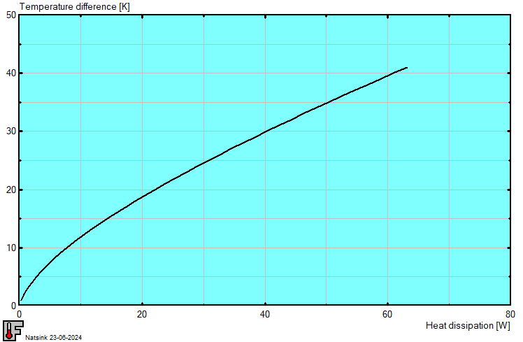

Attached are 3 simulation results from Natsink.
All of them with correct base plate thickness, trapezoidal fin dimensions, etc.
The first is the Hifi2000 sink 200x165x40mm.
You have 2x on each side, so ideally can double the power.
The second is a fictitious heatsink measuring 400x160x50mm, i.e. 10mm higher fins.
The third is what we used in the F5X, which is also similar to the Conrad heatsink MF35.
Dimensions are 350x150x50mm.
As you can see, dT/dW is not constant and is dependent on power dissipated.

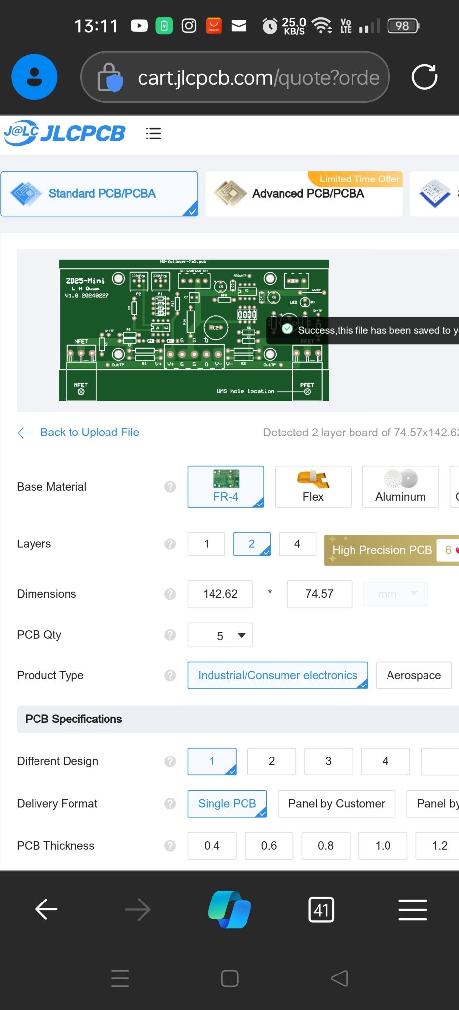

Hi guys. Just adding the gerbers into my JLCPCB basket. The ZD25.zip doesn't show any silkscreen but is the correct size. The JLC zip does have silkscreen but shows the extended board outline around the outputs as has been mentioned. Shall I just go ahead and order with the JLC file?
Thankyou
Thankyou
My understanding is that JLCPCB uses the .OLN file to define the board outline.
I had some issues submitting my order from them about this when I submitted my order that was resolved after a couple of Email exchanges.
In the future I might have to make sure that the silkscreen layer does not extend past the board outline.
I finished the amp this evening and I'm working on the bias. It went together smoothly and easily.
It plays nicely with my balanced Iron Pre. Well done, Lynn.
