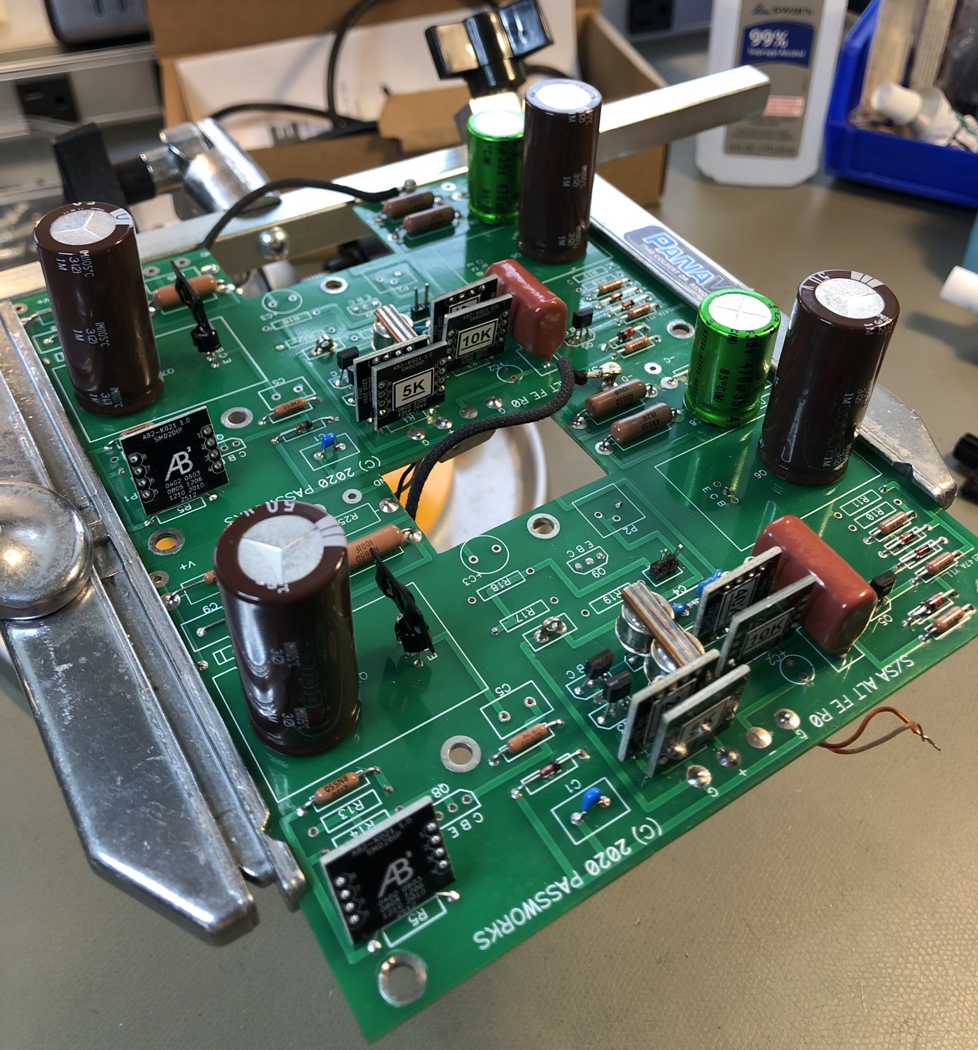

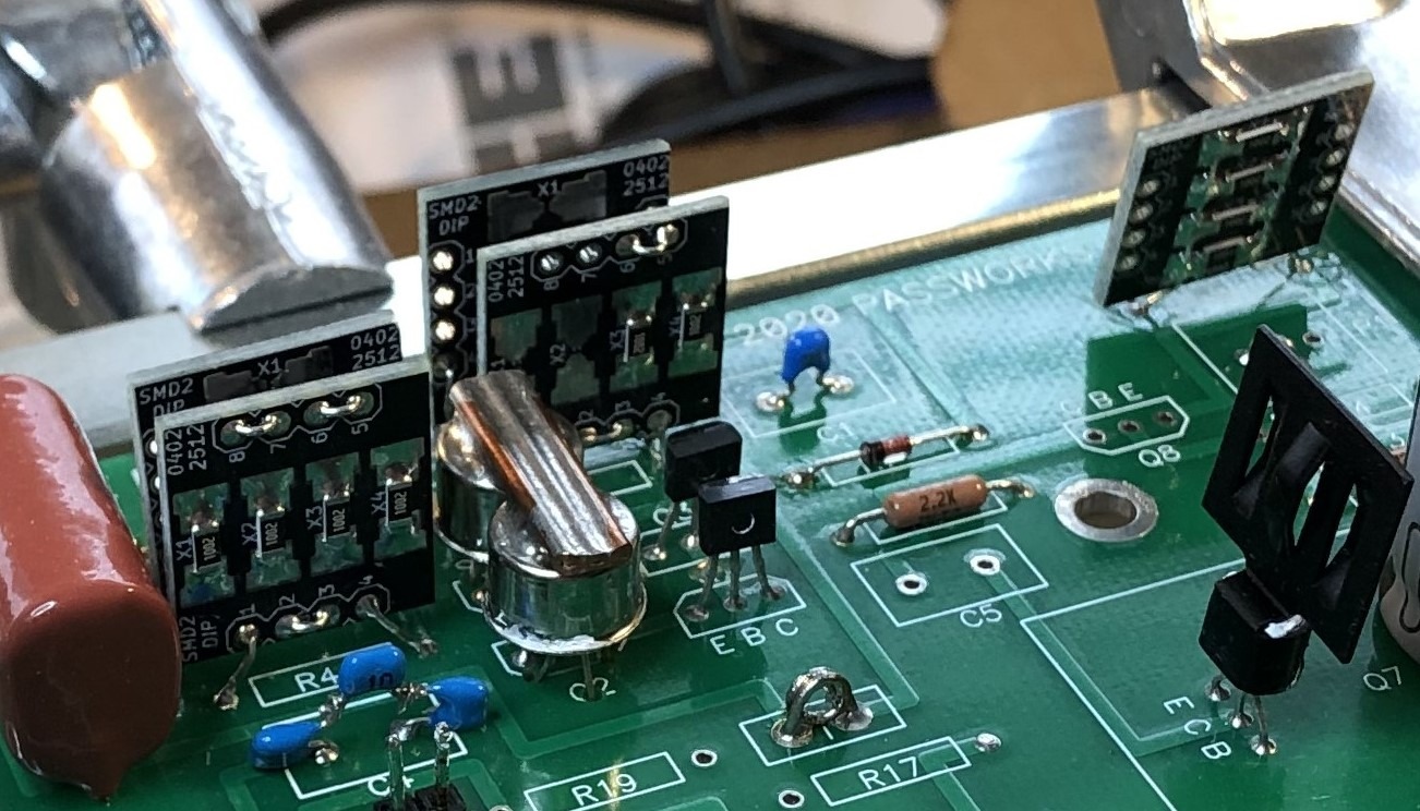

Just a sneak peek of the discrete front end to go into my HGF once I get them hauled back up to Skunkworx and disassembled. Nothing wrong with the onboard solution, but I just like to try stuff.. Those sticky-up adapter cards are loaded with Tantalum Nitride 1206 SMD's by TT Electronics. Passive's don't matter dum dum! (I know, but there it is..) Mark Levinson ad copy touts these things in critical spots (Levinson? never heard of 'em..) So the rest of it is quad K170's with zener referenced cascode on the input, bootstrapped VAS (flying rails), onboard RC rail filtering w/low ESR caps, 12db (4X) gain, blah, blah.. If it's crap EZ enough to switch back..
It's all in my head and I can't find the USB port. Maybe I'll try to cobble something together after the listening panel approves. And I really should get a 'scope on it first to make sure the compensation and such is still ok. I suspect it is but really should measure rather than assume.

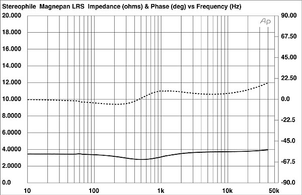

What impedance and sensitivity are the maggies?
They are 4ohm, 86dB/500Hz /2.83v
https://magnepan.com/collections/floor-standing/products/magnepan-7
So not the easiest load but the HG doesn't seem to mind them at all.
But they are literally like a resistor to an amplifier. And phase is flat as a pancake.They are 4ohm, 86dB/500Hz /2.83v
See measurement of Magnepan LRS by Stereophile below:
The .7’s probably measure very similarly. All you need is an amp with some current capability and you’ve got it.

My discrete FE is not beating (subjectively) the OPA551 built into the ZD25-Mini at this time. It's certainly not "bad", but will need some further thought and a re-tool before attempting a rematch. The Holy Grail Follower is a great amp all the way around, sounds fantastic. I'm putting together some active rectifiers just to push the PS rails up a bit. Not a huge thing, just trying to squeeze all I can out of this power supply.Will you show the schematic?
