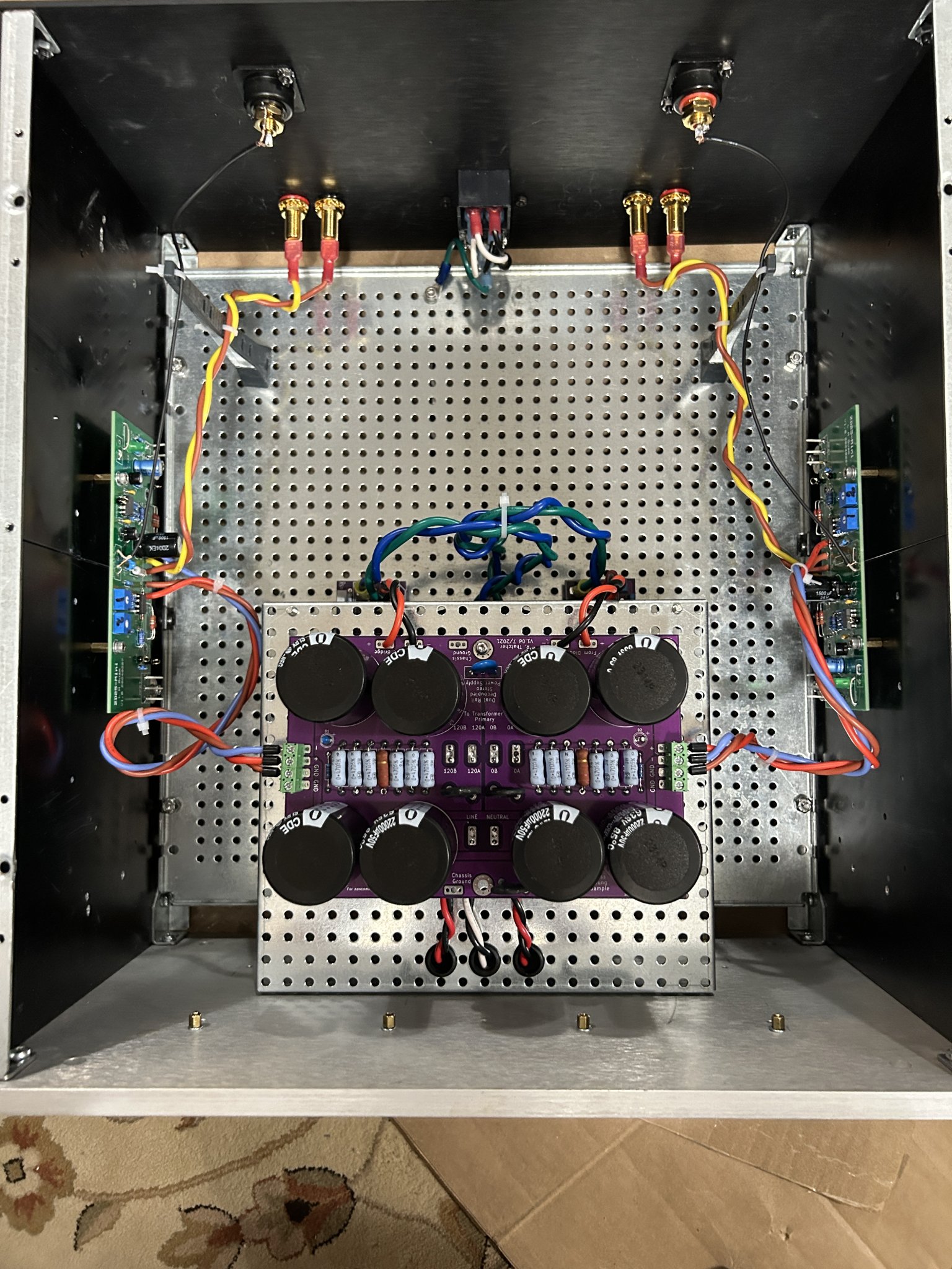

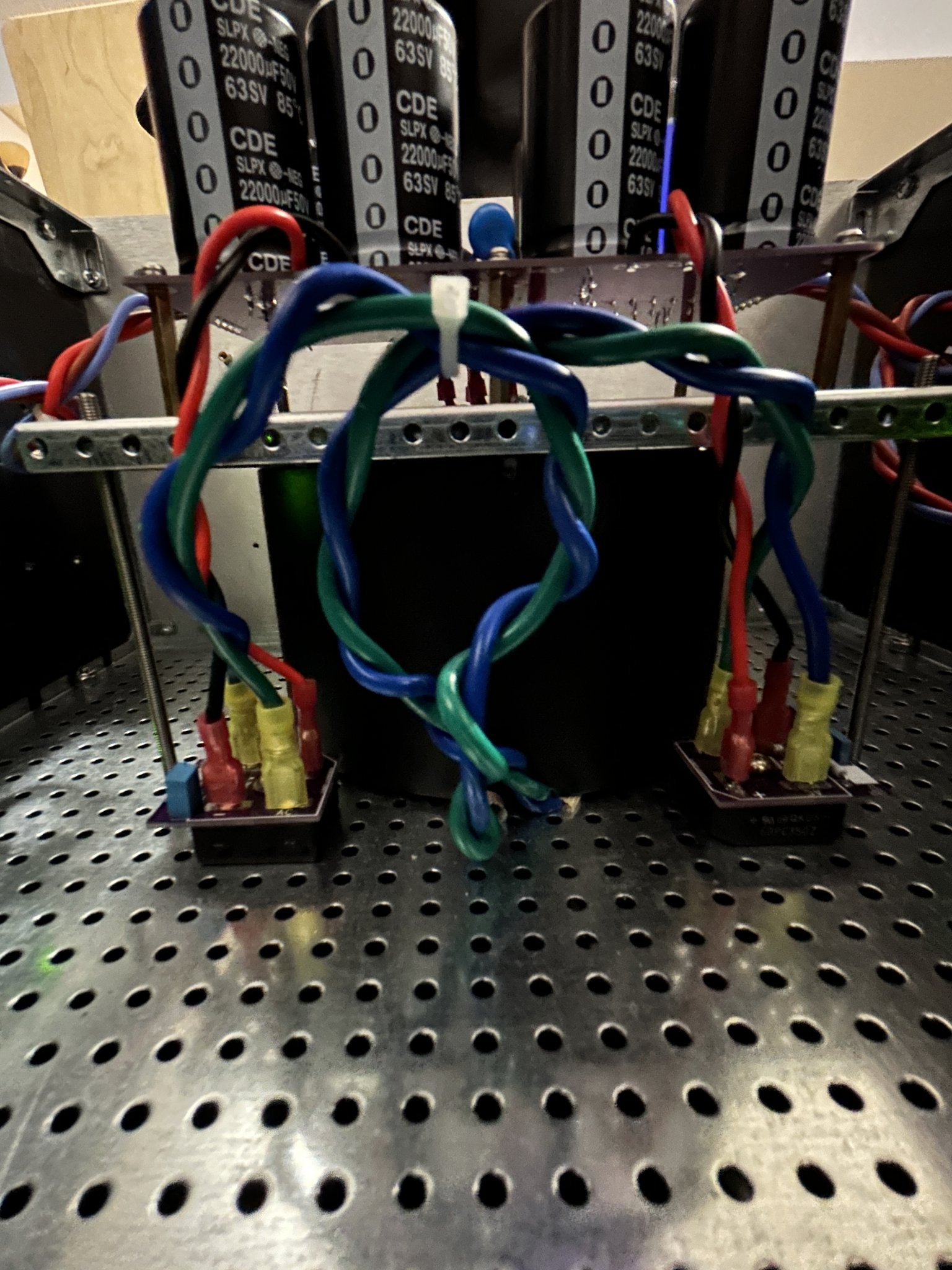

How is the perforated metal plate below the capacitor/rectifier PCB supported. I made the mistake (one time only) of connecting such a plate to a bolt going through the toroid. That is ok unless to connect anything to it, like the thermistor between signal ground and chassis. The problem is that the bolt is a 1/2 turn winding of the transformer and will develop a voltage at very high current.
new PSU and redid the layout.
That looks really nice!
Lynn,
Look in upper left and upper right corners of the perforated plate. I think those are 2 holding points. There are probably more.
But your point is well taken, shorted turns are not good.

Lynn, and Anand -
Thank you both for looking out for me. Truly appreciated.
The transformer is enclosed in a metal can made by Antek.
https://www.antekinc.com/ca-400-steel-cover/
The perforated plate is mounted with threaded rod and sits a cm or so above the toroid "can".
I did check more than a few times to make sure that I didn't unintentionally cut through any mask / traces this time.
I've been wanting to try some "R21" boards in my other PSUs, so killing it was the perfect excuse to take that PSU out and refit it... Yeah, that's what I had planned all along.

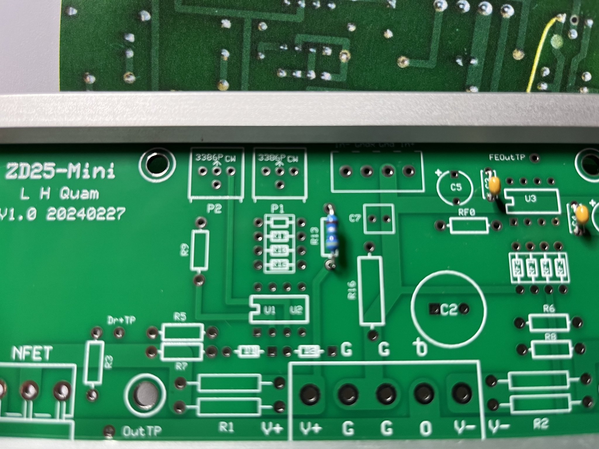

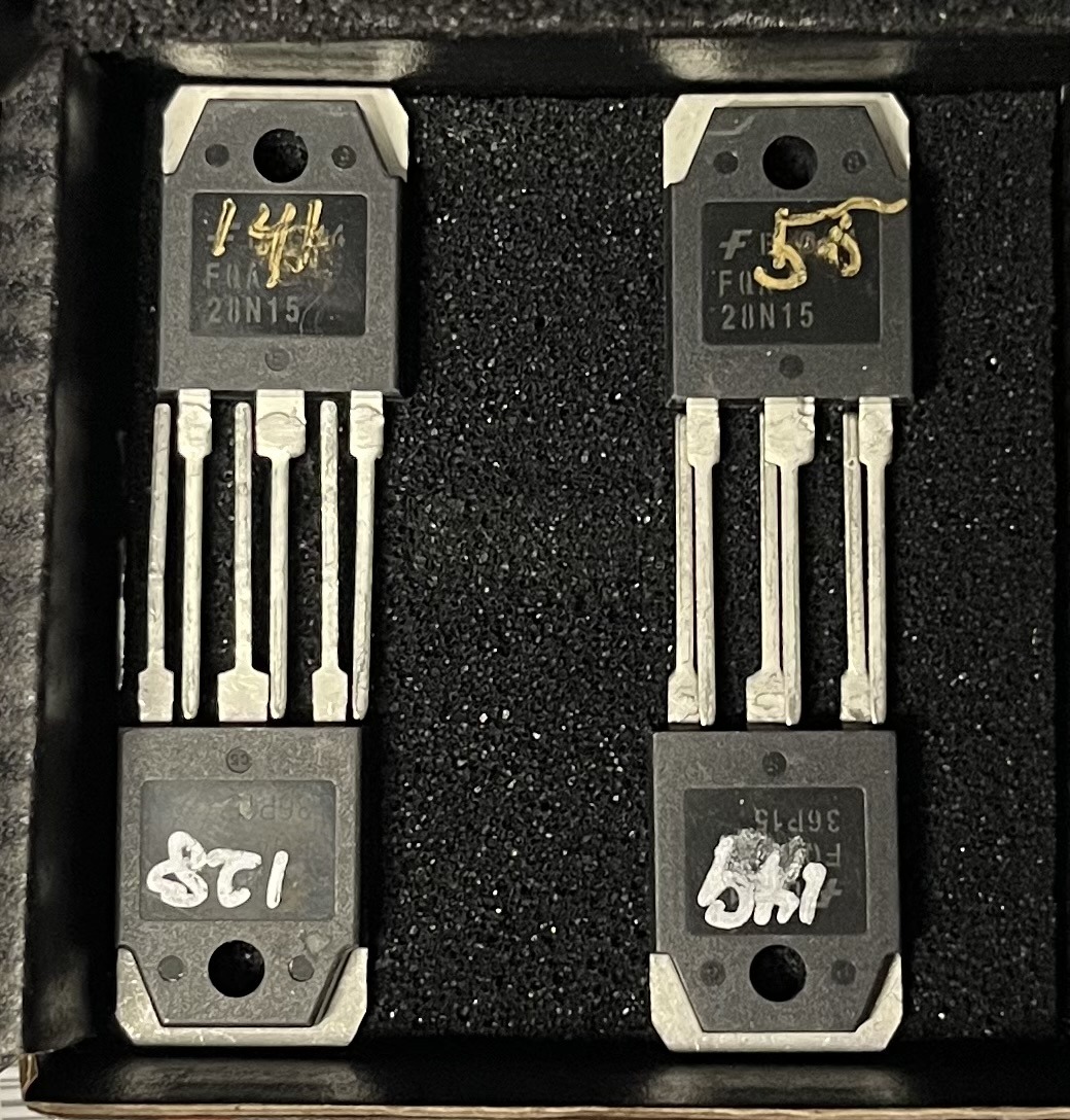

Lynn, I have a few pre-assembly questions:
- The PCB is V1.0 20240227, the trace-correction is up to me it obviously seems? (Due to my strange reply to the poll I suppose…) 😉
- the basic build will work out fine regardless what batch of output-devices I received? (Or should I go with the plugin-sockets and finetune it? I am not „very experienced“, see me and ZM‘s dialogues)
- these are my FETs, any advice on best pairing them?
Many thanks!
Many thanks!
Apology #1: I found the correction on the back of the board. Expected a plain through board hole… nice!
If you received "bonus" FETs, they are marked with an "X" on the backside. The four FETs without an "X" on the backside are the ones to use. Either NFET can be paired with either PFET.Lynn, I have a few pre-assembly questions:
Many thanks!
The P1 and P2 adjustment pots should take care of differences between the FETs pairings that I have distributed.
You should not need to use sockets for the FETs unless you plan to experiment with different FETs.

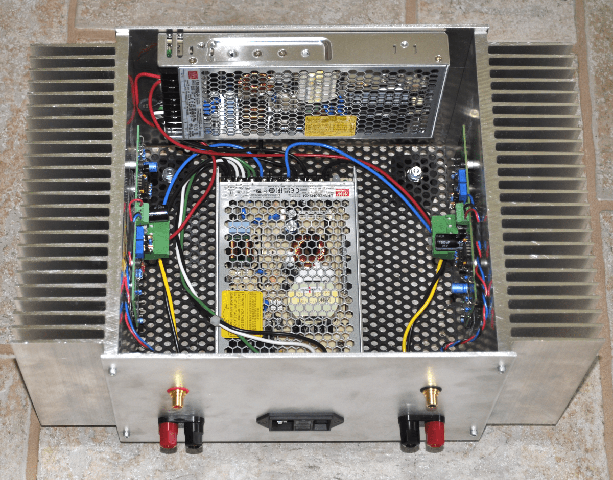

I recently completed another ZD25-Mini build in a different chassis, but using the same Heatsink USA 10.08" x 7" heatsinks, and using a pair of MeanWell LRS-200N2-24 SMPS. Those power supplies are very quiet and capable of 400W power bursts. I will provide measurement details in following posts.
Here is a layout for the diyAudio Store Delux 4U chassis, with both SMPS on the bottom: (This 3D model was just an approximation to the actual Store chassis, but the overall dimensions should be correct).
