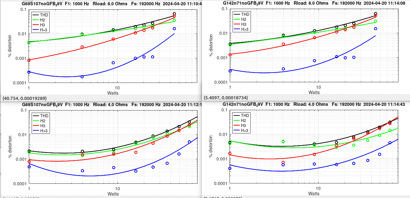

Here are sweeps of THD and harmonics for the two channels (columns) into 8R and 4R loads (rows). With an 8 Ohm load the amplifier is voltage limited to 44 Watts. With a 4 Ohm load the amplifier is voltage limited to 75 Watts.

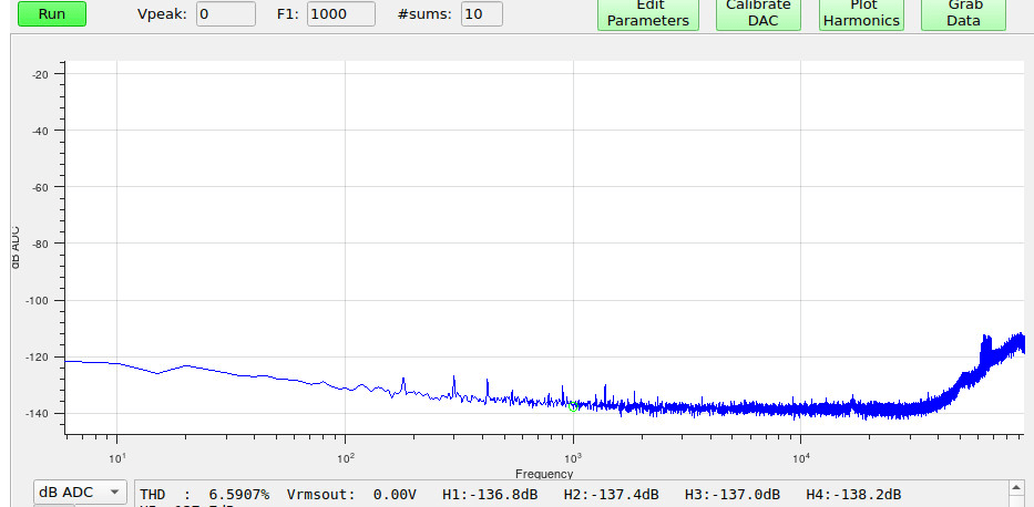

Here is a noise spectrum. -24dB corresponds to 4V peak (2,82Vrms). The noise above 40kHz is due to the noise shifting of the ADC in my measurement system.

Those are impressive figures. This is one mean output stage, eating that 4R load for lunch...

I cannot figure out why these FQA28N15 and FQA36P15 work so well in this output stage, particularly with 4 Ohm loads. I keep rechecking my instrumentation and measurements but cannot find problems. The measured distortions are far lower than shown by simulations.SMPS? Never heard of it.... 🙂

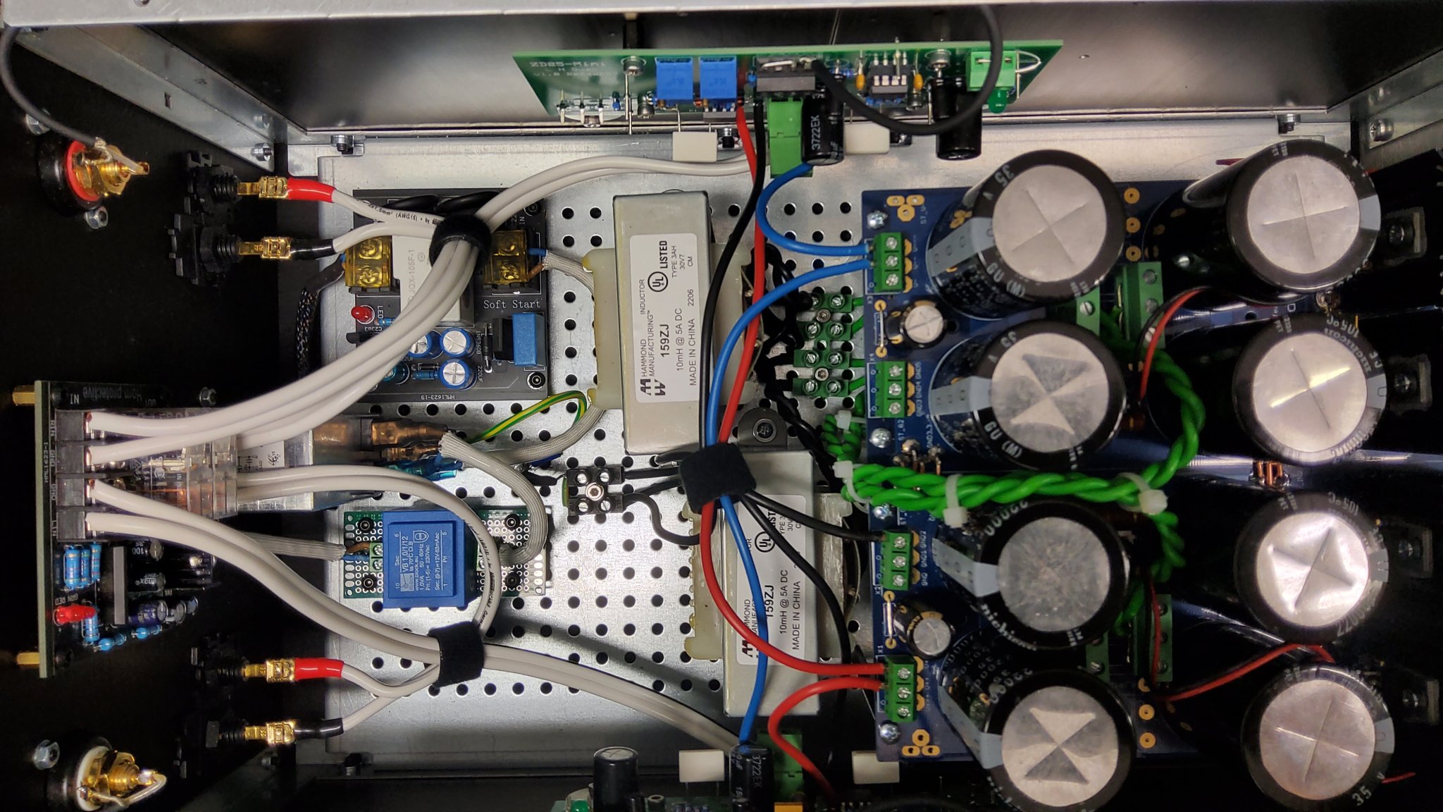

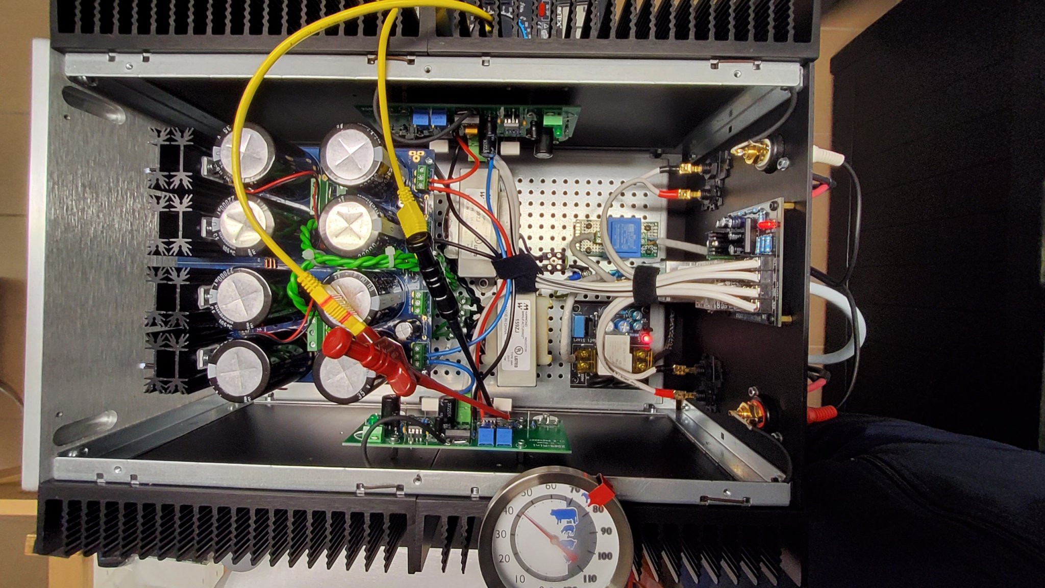

Here is the current state of my HGF version squeezed in a monoblock chassis.

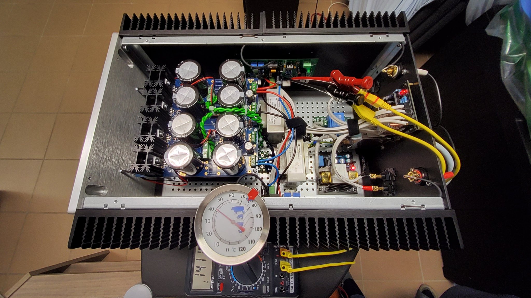

The cooking process was easy and idle Iq is set to 1.4A with a offset of a few mV. The heatsink temperature rises from 20 °C to 43 °C which corresponds to about 70W disspation for each stereo channel. This is still pleasant to touch.

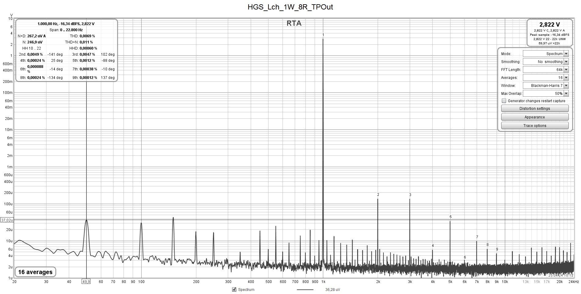

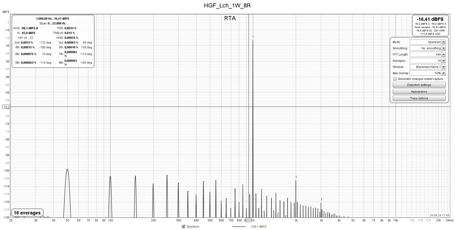

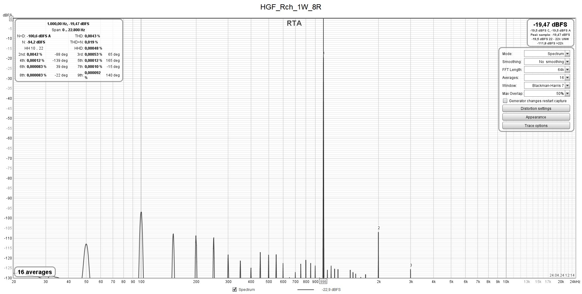

Next I did a few quick measurements before connecting test speakers. It turned out that the distribution of harmonics of the 1 kHz measurement frequency in FFT was good-natured and fell nicely with increasing frequency, but I don't really like the noise spectrum. This still needs to be improved. Especially 100 Hz and its harmonics are still too high.

I am afraid that the small spaces between PSU components and amp PCBs in the narrow monoblock could be the cause.

Maybe Mr. power supply could be evicted and moved into a new distant home as punishment. Now only allowed to talk in a civilized manner through an umbilical. Each channel board in the amp chassis could have their own final "C's", which should allow for slightly better separation... likely be a good thing (use favorite audiophool words, better imaging, improved soundstage, blah, blah)..
In the 1st image I cannot tell where the ground wires from the HGF PCBs go. The velcro tie hides them. I see one black wire connecting to rectifier/capacitor board, and the two black wires from the HGF PCBs, but I cannot see where they are connected?Here is the current state of my HGF version squeezed in a monoblock chassis.

I agree this is complaining at a high level. Relegating PSU to a separate housing would be the final solution if all civilized measures fail.
But it is now too late to speculate about moving it to a new distant home anyway, as the highly valued umbilical was cut off immediately after the last soldering process

The two black wires from the HGF PCBs and the wire from PSU board are connected to the star ground seen underneath the velcro tie.

Good. Does RCAgnd connect to GndR of one of the HGF PCBs?The two black wires from the HGF PCBs and the wire from PSU board are connected to the star ground seen underneath the velcro tie.
I didn't use the GND breaker. RCAgndL ist connected to InGndL and RCAgndR to InGndR with screened black wires under the upper chassis mount rail.
I don't have any suggestions regarding the 50Hz harmonics, other than an umbilical, simpler more compact supply, or SMPS.

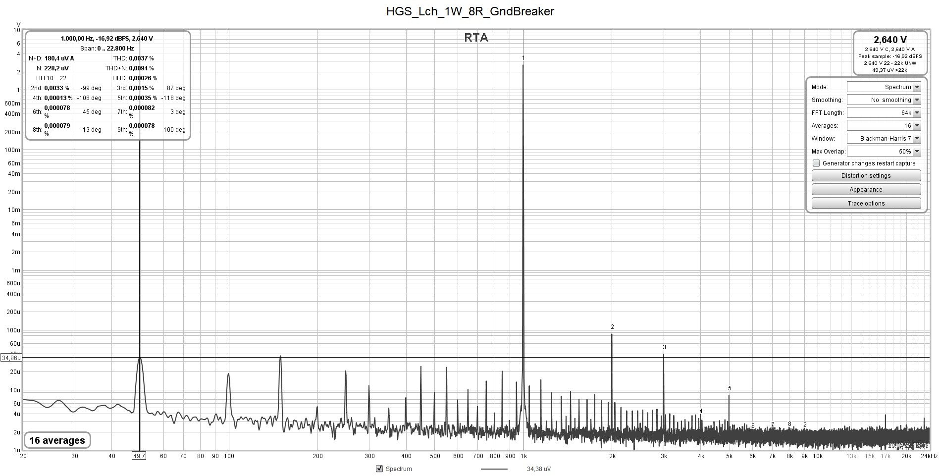

Try making the spectral measurements with the ADC inputs connected to the GND and Out test points on the PCB. Sometimes there are unsuspected ground loops involving the test equipment.
FFT spectrum directly on the PCB test point TPout showed a lower level of 50 Hz and its harmonics.
So, the layouts of the connections from PCB -> speaker protector -> Fast-on output connector were the culprits. The spacing to 159ZJ chokes was rearranged and GNDR breaker used. The result is visible and I can live with this 50 Hz under 35 uV.
