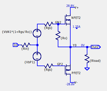

Any updates on this?For any of you thinking about doing your own PCB layout, I have a minor addition your might want to include.
For each output FET, provide for the possible addition of a resistor from gate to source. This will allow you to reduce the gm of that FET resulting in the modification of the 2nd harmonic level.
I will post some simulations showing the effect.

In a Nelson Pass that I cannot find, he described a trick to lower the gm of a FET using a voltage divider formed by the gate stopper and a resistor from gate to source. This makes it possible to lower the gm without using a source resistor, of course still requires that the the FET bias current is controlled in some manner.
This makes it possible to reemphasize the role of gm in matching the NFET to the PFET and concentrate on a different parameter(s).

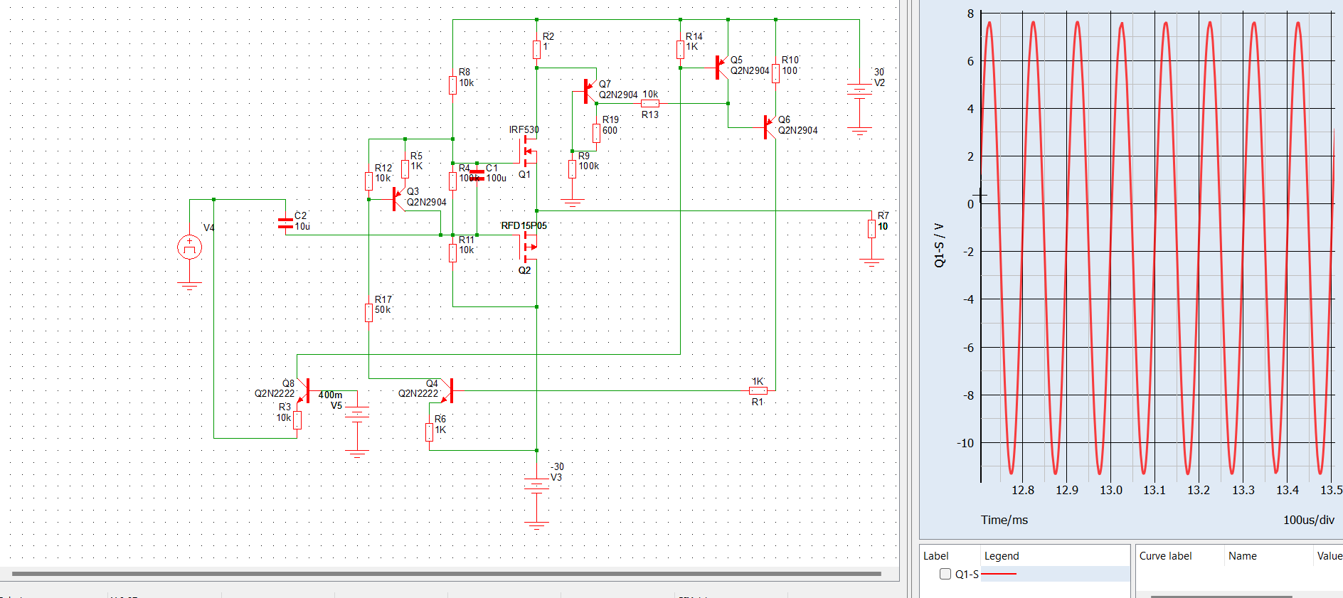

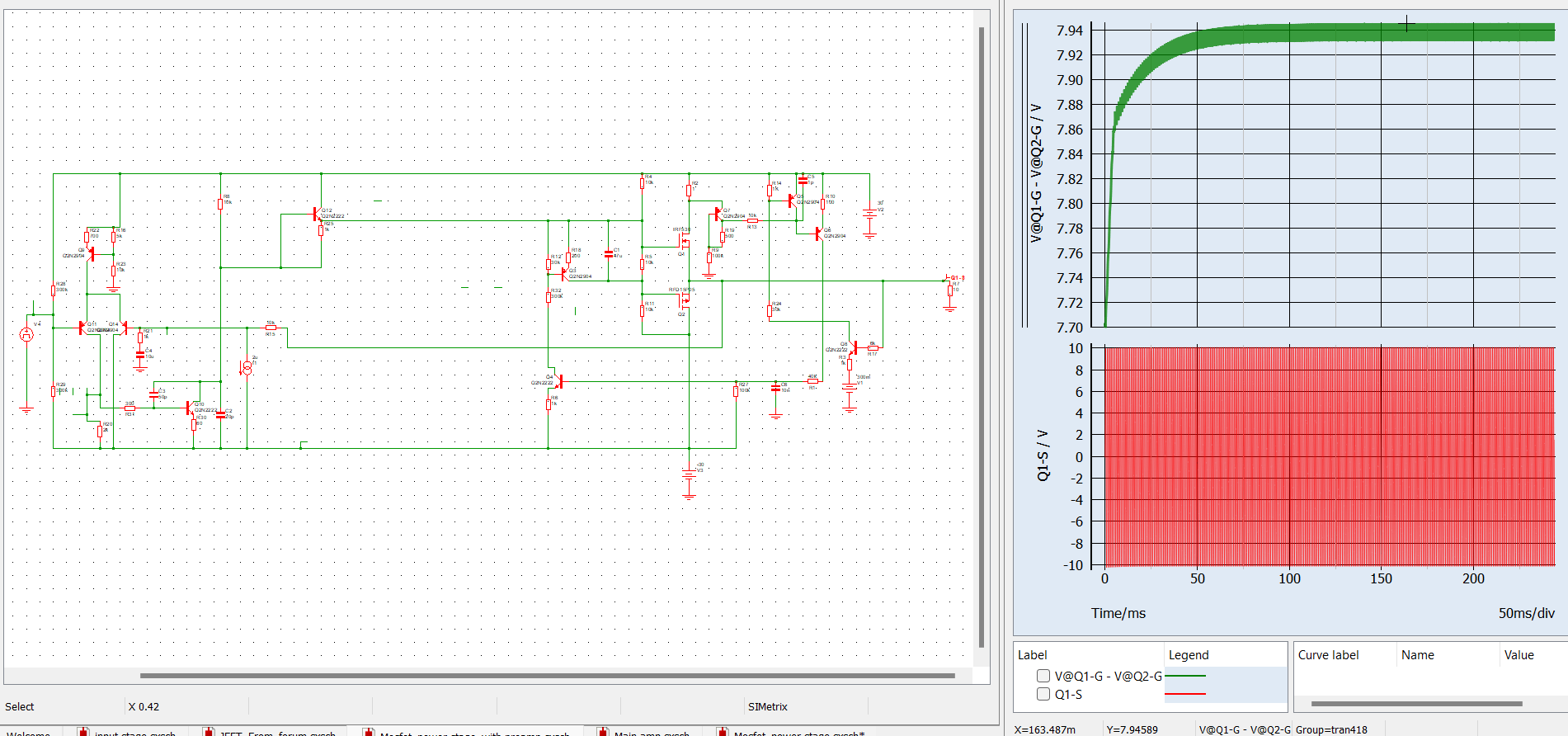

Sensing MOSFET bias during off-cycle of N MOSFET and integrating in dedicated feedback loop . Controls bias to 20mA. Including preamp stage this time
Green trace is differential bias voltage between gates.

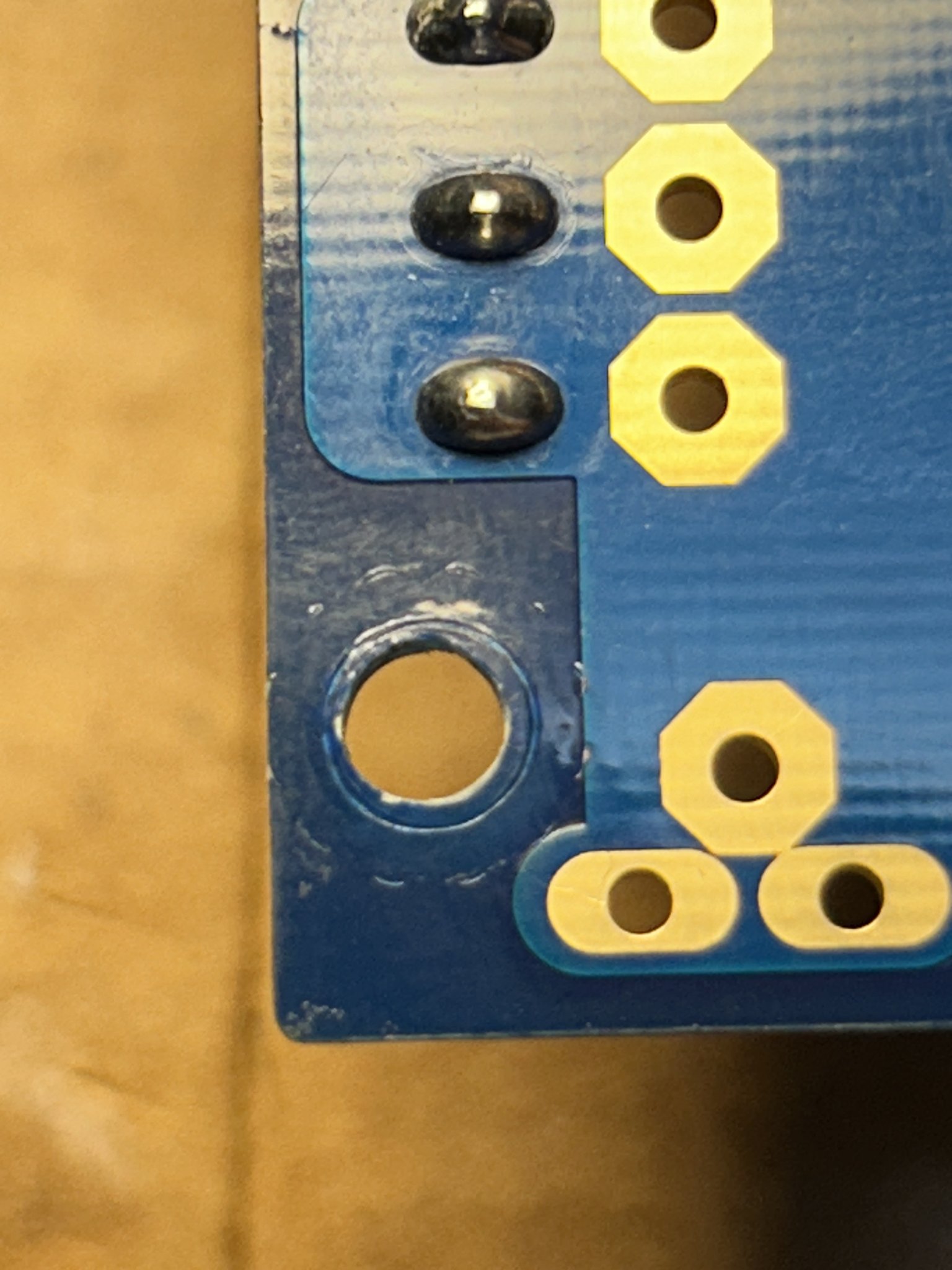

I took out the PSU yesterday just after William's post. I added additional jumpers between the GND points from the "+" rail side to the "-" rail side of the PSU board per everyone's kind suggestions. I thought it would be also be a wonderful time to redo the layout a little to add some physical space between the DC wiring and the PEM.
Well .... I have now joined the "You can't fix stupid" club.
My intention was to "go vertical" and move the PSU board toward the front of the chassis. It was mounted on threaded rods to raise it over the toroid. I've mounted things similarly before with another PSU. I put a set of cap boards over the inductors/chokes in a "CLC".
I was in a hurry (stupid) and didn't check the clearances. My K-lock nut on the underside of the board was large enough to overlap slightly with one (or both) of the supply traces/pours. Additionally, I had tightened it enough to where it cut through the solder mask and shorted one of the rails to chassis GND through my mounting rod.
I typically have these boards mounted with nylon spacers.
I was
Thankfully, I was at least smart enough to re-check the PSU with a variable transformer before re-connecting the amp boards. I didn't however have it on a DBT and wasn't using a 0A5 fuse per my normal process. It was at about 40VAC at the primaries when it when poof. So, at the moment, I am trying to figure out which component(s) released that little puff of smoke. Troubleshooting is not my strong suit...
So, if anyone has a tip for boneheads, I'm all ears. I had mentioned wanted to use a different PSU anyway.
So, I'm putting together another PSU in the interim, until I decide what to use permanently.
Moral of the story... don't be a doofus like me.
I have done similar things. One common failure is blown resistors in the CRC filter. Check them first. Look for discoloration. Put an ohmmeter across them. Most multimeters cannot accurately measure below 1 ohm, but you can tell if the resistors are totally blown.
Another possibility is blown rectifiers.
