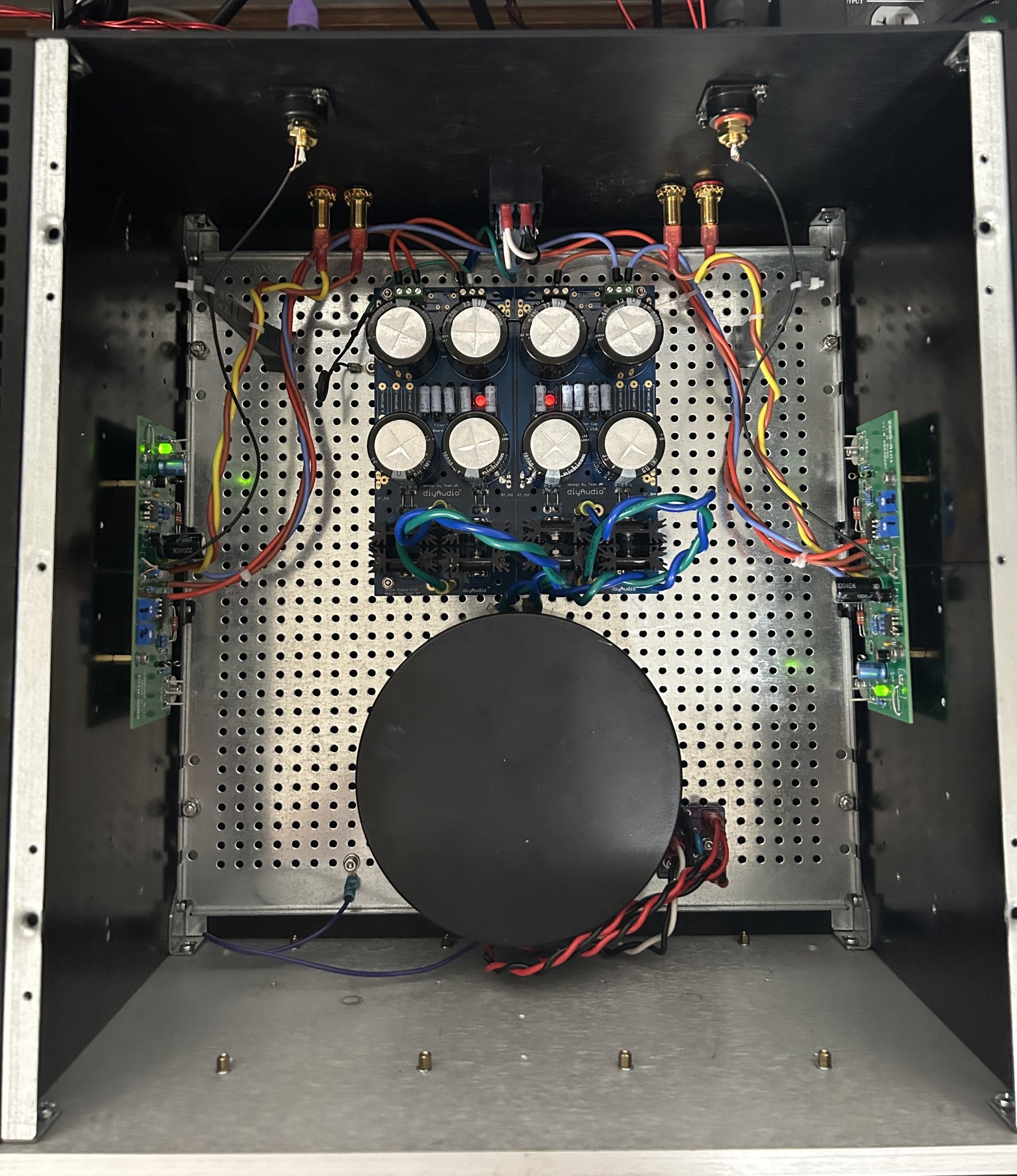

Well, with Lynn's incredible help, she's up and making beautiful music. I'd have never figured out the issue with the suspect board. Two resistor changes to a new value to allow it to bias up properly and we're off and running like a herd of turtles.

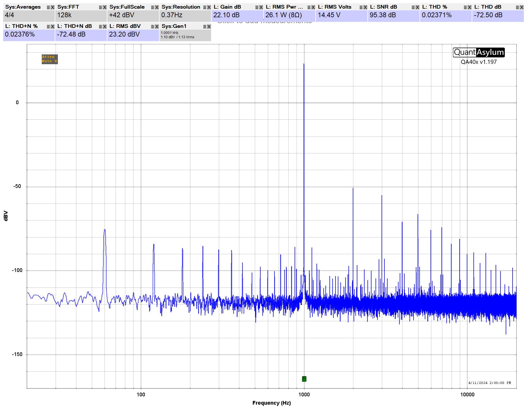

I couldn't resist hooking it up to some actual speakers to give it a listen. Even after all the abuse I gave that one poor board taking it in and out and in and out etc. the thing is rock stable (knock wood).
I biased it up to ~175mV across the sense resistors ... so ~75W dissipation per side. I was also targeting ~50W@4R. I wasn't being precise.
Here's the current state of affairs.
I'll be changing PSUs at some point down the road. I think it 'deserves' something with a little less ripple. That will also give me a chance to try a few other layouts. I'm not thrilled that my nice clean DC runs right under my PEM. Either way... I'm tickled pink.

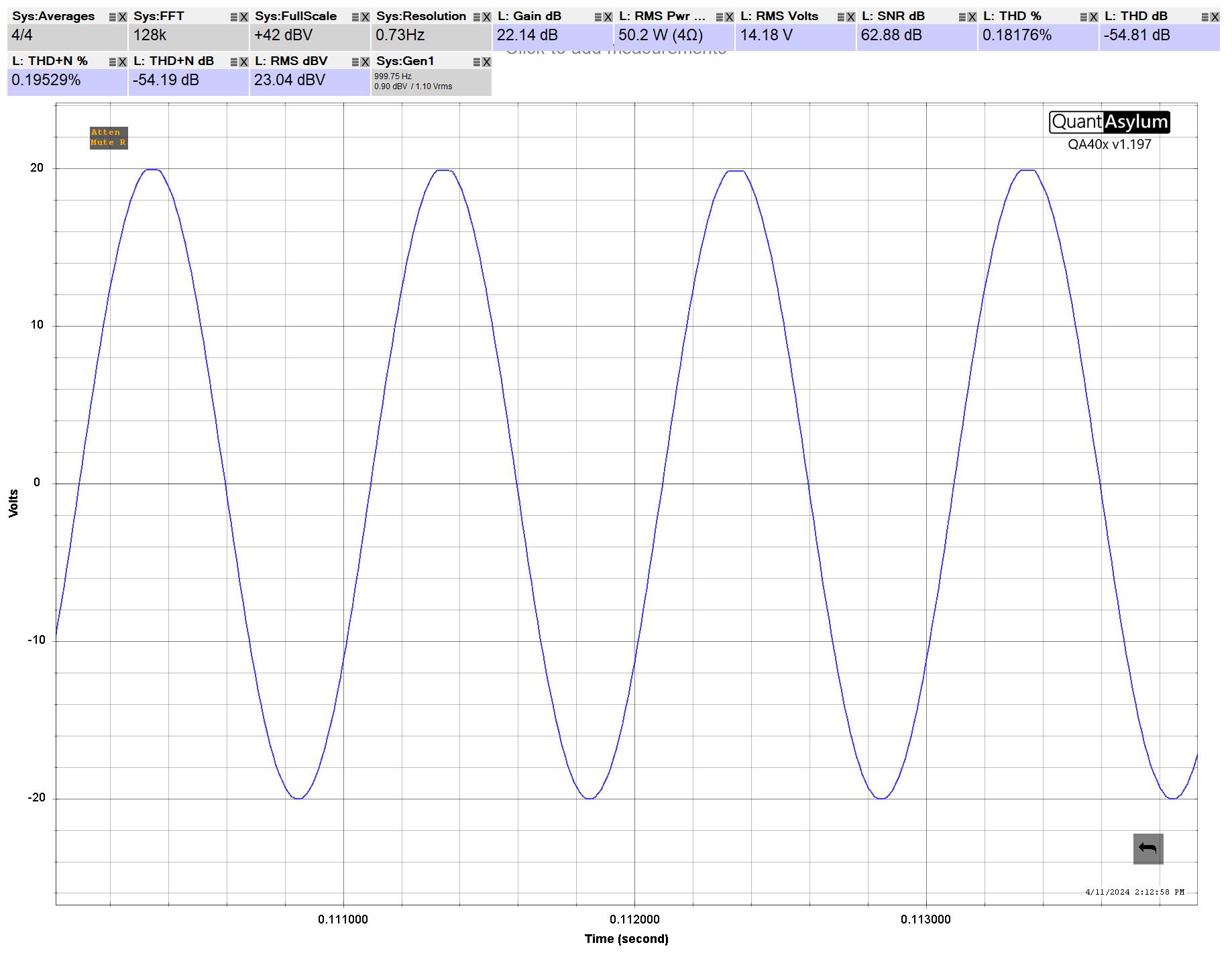

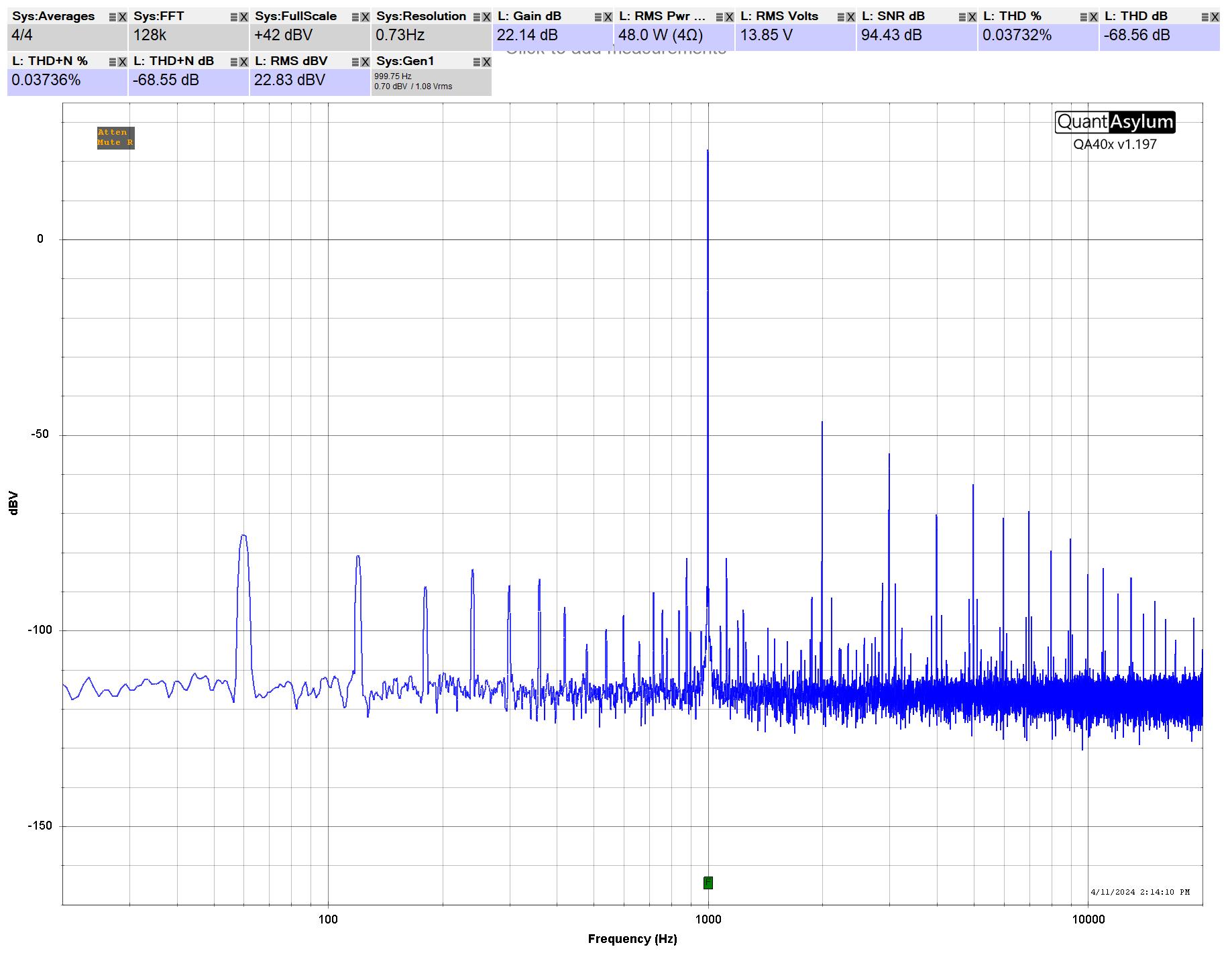

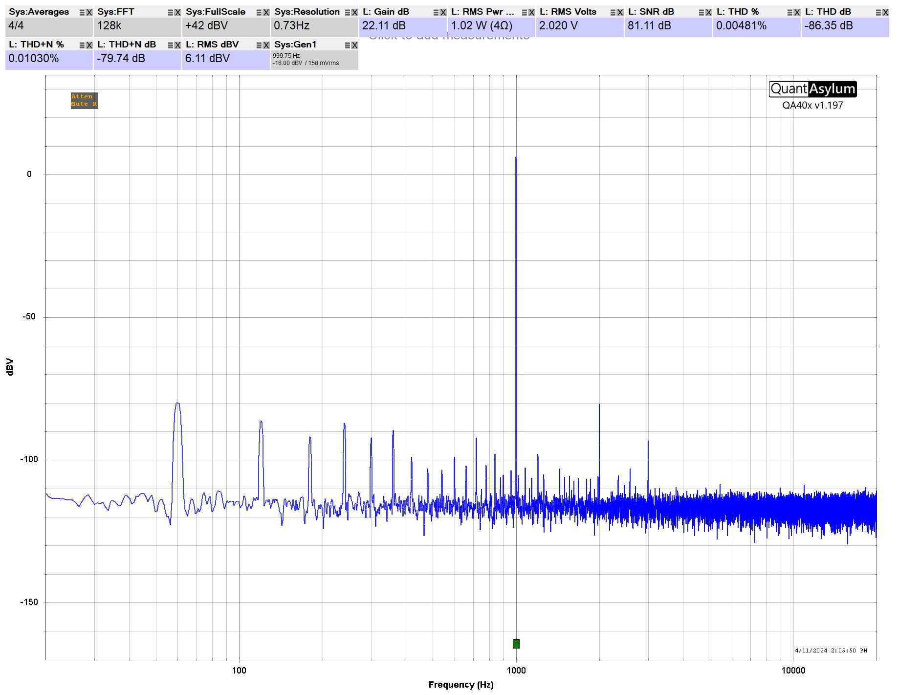

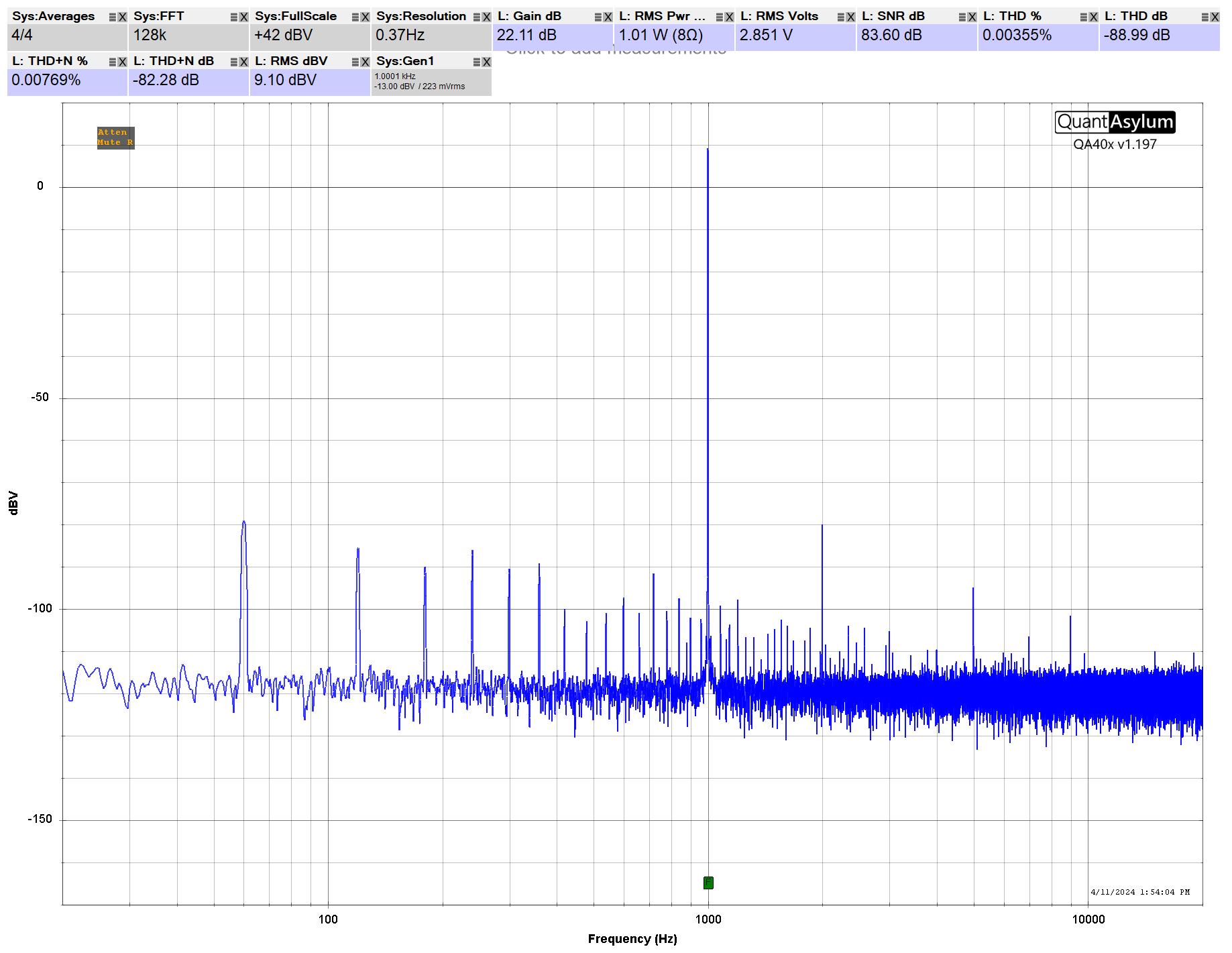

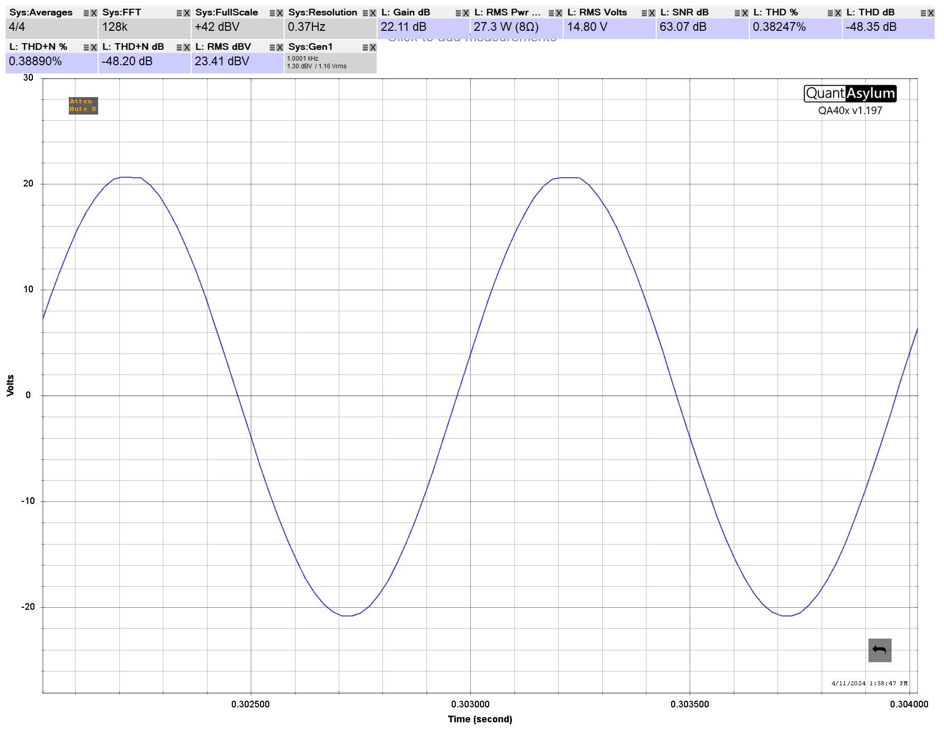

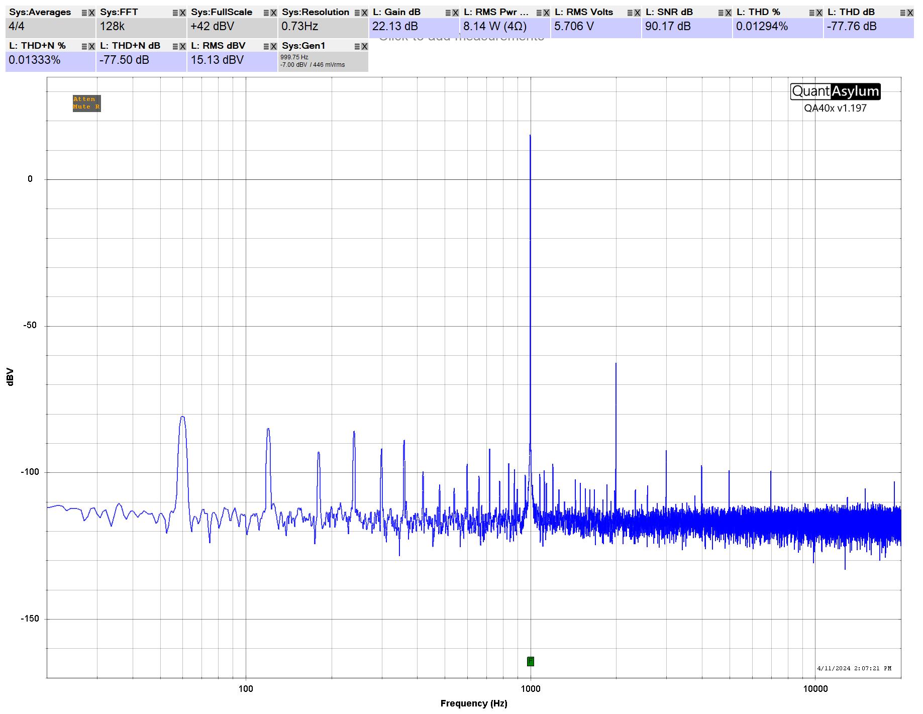

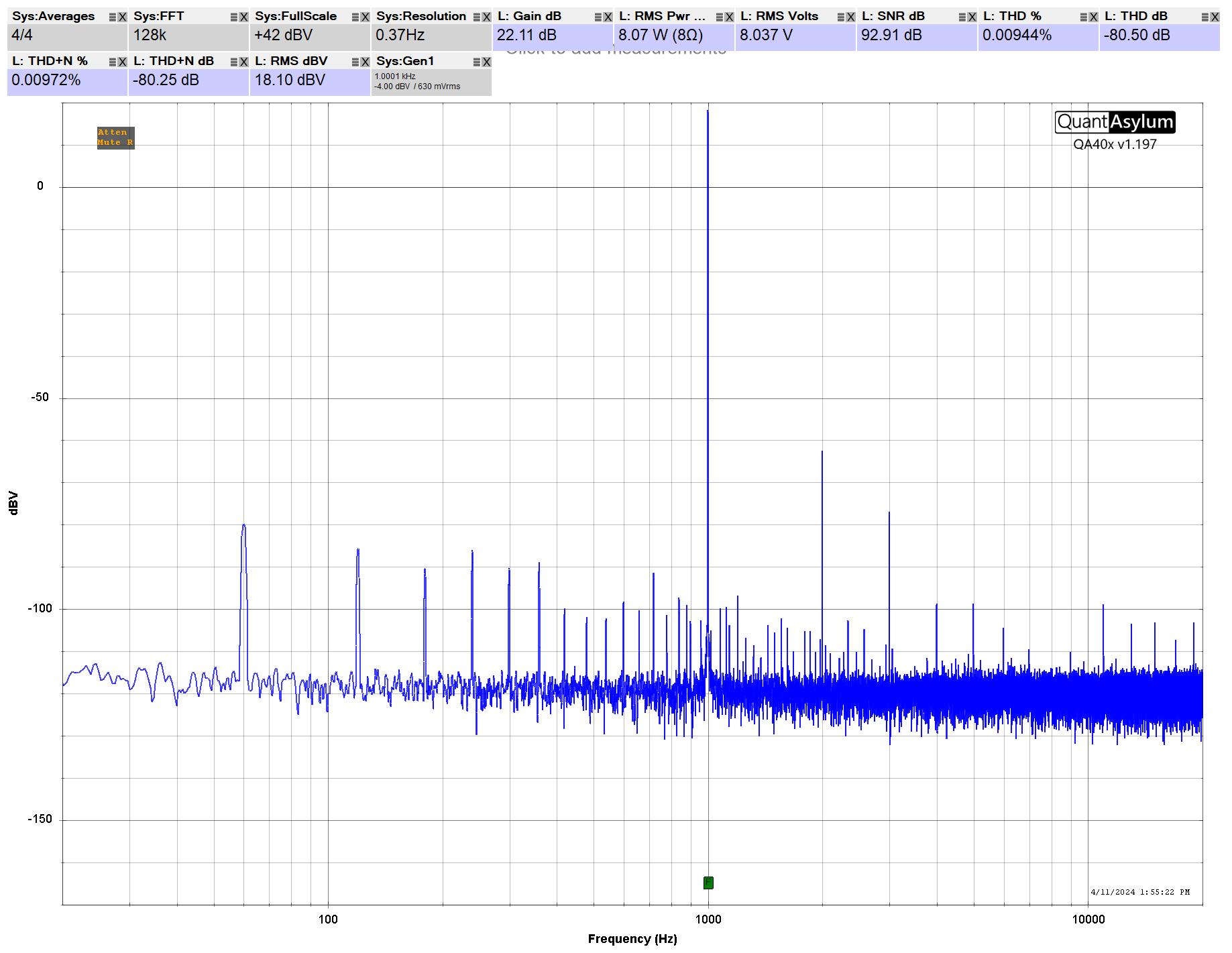

I did a few VERY quick and DIRTY measurements. Even when test speakers don't fold in on themselves, I've been burnt. So, I do at least a few basic things before anything gets hooked up to a 'system'.
1W FFT @ 4R and 8R
8W FFT @ 4R and 8R
Max output FFT before clipping (roughly) 4R and 8R

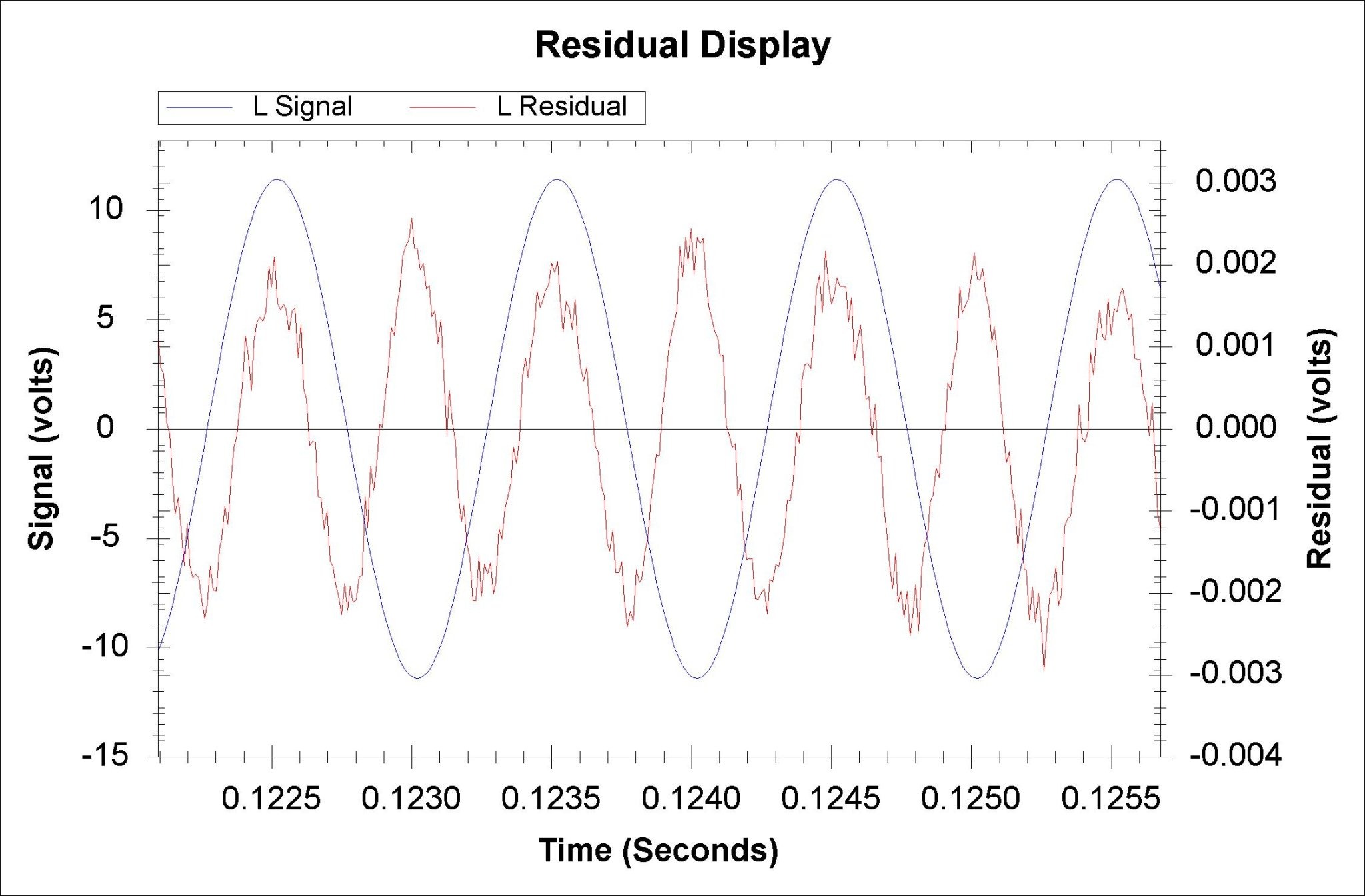

Time domain clipping behavior 4R and 8R
Distortion is low enough that you have to 'pump it up a bit' for this software to show a clean visual of the residual. Nice positive 2nd (best I can tell).

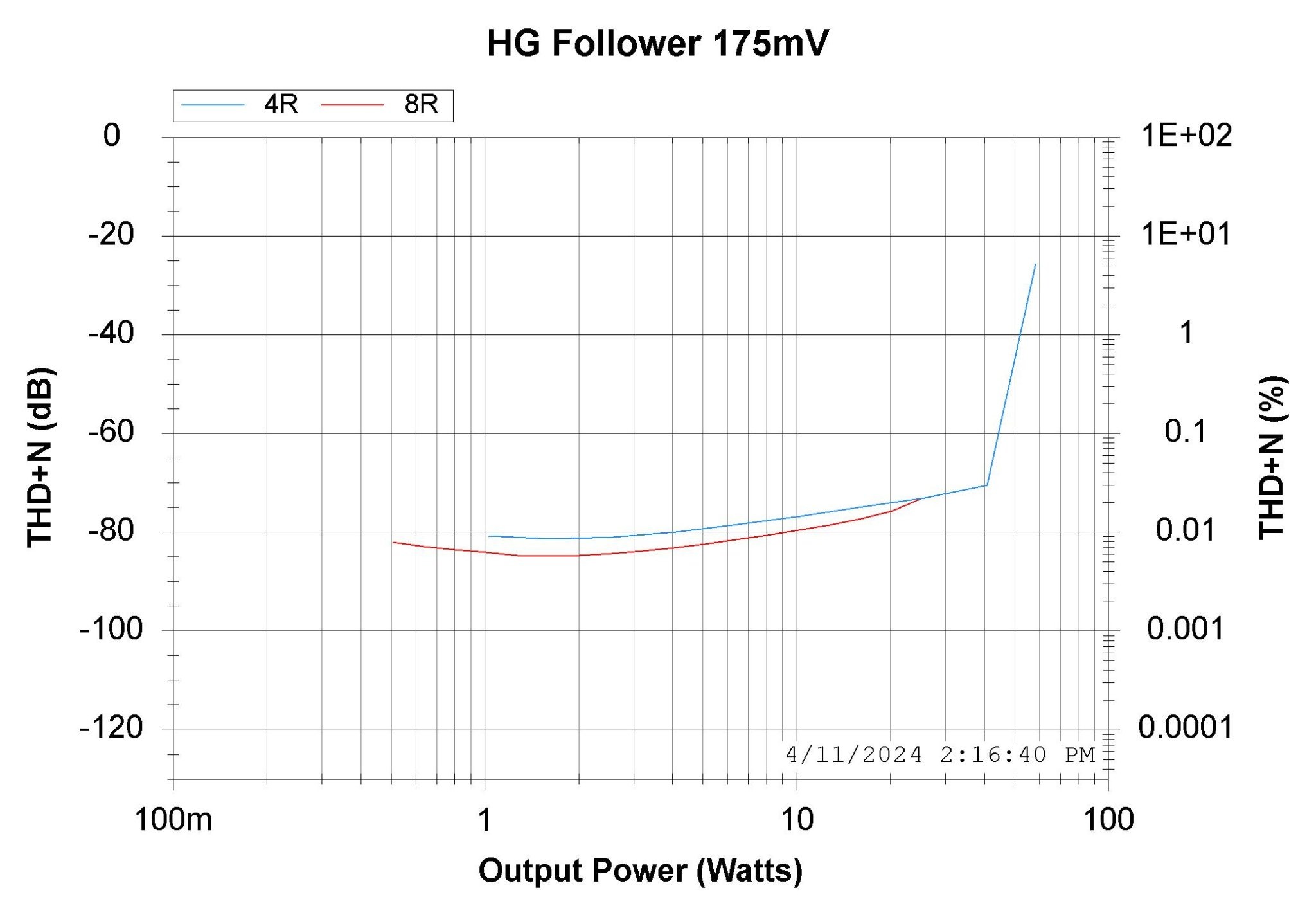

And a quick and dirty power vs. THD.
There's no questioning the performance. It's close to ruler flat when it comes to distortion throughout the power band.
