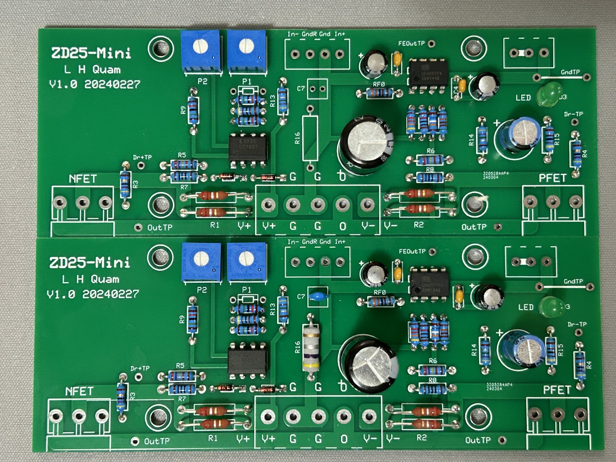

I got a little time after supper to put together the boards (sans MOSFETs).
I chose to go the "Basic/Baseline" route for the first (and maybe only) iteration. I read the lovely guide and picked up a lot more understanding re: the gain variance. The instructions for optimizing the bias circuit through altering R11 and R12 were crystal clear, and I feel like I could have handled it. However, I'm good with the "nominal", and yes, I would be worried about bias current becoming temporarily very large if I left them completely out.
The gain is perfectly fine with 'standard' values, but I might tweak it lower down the road. No need for the XLR inputs for me on this amp. Given the low distortion already, and the fact that if I'm careful, I can keep noise down... no worries. With that said, I went ahead and installed the ground loop breaker. I'm just weird that way.
Lynn, the build guide is wonderful. It's about the 4th time I've read it, and each time I read it... I pick up a tad bit more.
It will be a wonderful experimenter's platform, but for now... I'll see how it works out. If I've done anything particularly nutso that someone spots, please shout it out.

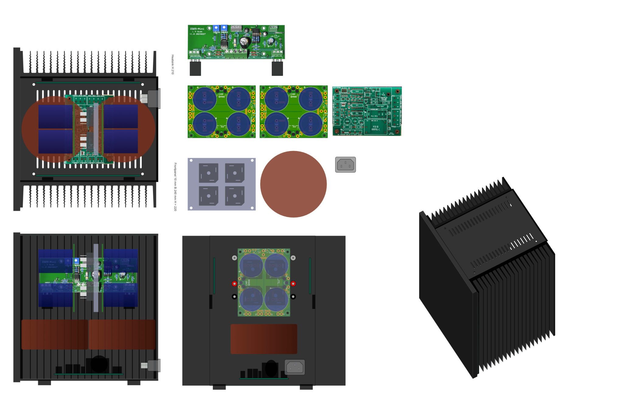

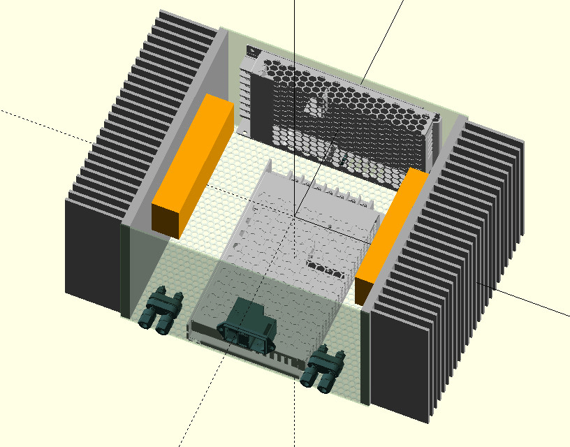

Plan is to perhaps steal an open 5U/400 chassis... which will be overkill perhaps, but it's the only thing that doesn't have an amp in it at the moment. I'll likely start off with a "basic" First Watt type PSU ... 18VAC 400VA toroid / 24V rails (ish) / CRC. Then, it will be highly likely that I'll swap that out.
Let's see what tomorrow brings in terms of free time.
Thanks again, L,ynn, for making your designs available, and kudos for taking the time to help teach by writing your methodology and how your projects evolve. :worship:
Edited for clarity and to add that I haven't installed test points or the jumper to the FE yet either (clearly).
