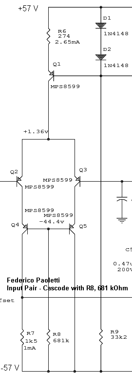

What do you think about this cascode method !!! ??? 😎
Just select one suitable resistor to get the cascode voltage you want.
A little hook only.
We need a rather precise bias current for LTP pair.
So is perfect for CCS biased LTP.
I find it simple & very elegant.
I have no doubt it is very good (the italian designer is one pro).

As I see it:
In a cascode circuit the base of the common base stage should have a constant voltage.
In the design you are showing the Base voltage isn't constant.

no the base potential is related to supply
from pure technical side, it is not easy to see any benefit
compared for example with the MJL21193 CCS cascode connected to LTP emitters
anyway, it may be interesting to try what kind of performance differences this gives
the designer, as said, is wellknown for highly regarded amplifiers
something good must be in this .. or

What happens if the beta of Q4 and Q5 changes by, say, a factor of two (maybe by substitution of parts)? What is the impedance looking into the emitters of Q4 and Q5? Is it larger or smaller than R7? Does this defeat the purpose of a common-base amp?
I originally thought you may have posted this circuit as a joke.

You are right I don't see any benefit in the discussed circuit.
I have not seen MJL's cascode, but are you sure the cascode is on the emitter of the LTP, and not on the collector of the CCS?
I know it will look the same on the schematic, but anyway if it's a cascode there it's on the CCS and not on the emitter of the LTP.
The first thing I would do is to place a CB (Cascode) on the collector of the LTP., and even include a correction circuit.

Why not? I like the simple solutions.
OTOH, the voltage divider will give more precise and selectable results without much added complexity.

andy_c said:What happens if the beta of Q4 and Q5 changes by, say, a factor of two (maybe by substitution of parts)? What is the impedance looking into the emitters of Q4 and Q5? Is it larger or smaller than R7? Does this defeat the purpose of a common-base amp?
I agrre as I have stated before I don't see any usage of this circuit.

OK I have seen it now, but that's an ordinarry cascode and it's on the collector of the LTP and not the Emitter as Lineup sayd.

I've seen a similar cascode to what MJL suggests in post 337 used on the AEM9000 amp by Tillbrook, but with a zener in place of the resistor used from cascode base to the LTP current sink.

The LED is just a voltage drop, so a zener would do the job.
Stinius
A zener is fine. You'll get better PSRR if the zener is referenced to ground rather than the supply. See the Leach amp schematic for details.

Yes, I think that lineup might have miss-worded it. The scheme he suggested was also an ordinary cascode.
