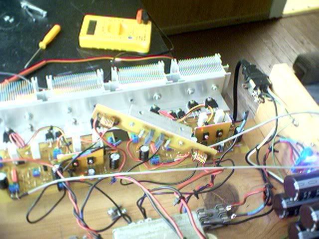

I took the time to build a variable power supply that goes from 5 to 30V. I always start a new design on 5 volts to see if there is a fault.
I did these things , but still #@%&ed UP!!😡
BTW, thats a NJW0281..1/4" die. Still , I only blew 2, 1-0281
and 1- 0302. the other two survived and are now running in
the blown amp. I found out what I did (didn't) do which
is very important after frying ones first OP's. Duhhh, I didn't
screw down one of the 0281's, it thermally "ran away" and
POP.. out went the fuse.
In the end 2 amps are blasting away.(one channel w/only 2 OP's)
After surviving the whole album of "classical thunder".. WOW
(1812 overture clean)bye bye frugalamp 1, hello FA2.
The bass is incredible compared to the "blameless" with a
non-stressed smooth midrange and those same ear tingling highs
of FA1. A MUCH better sounding amp than the first one.
For some reason it runs much cooler than the original ,too,
even as both amps are biased the same (60ma/device).
Since I think I'll stick with this one, BOM, PCB,and detailed
layout is due to follow..

Here's the board..300 DPI ,4.5" X 6",active components keyed.
0 errors.. it's playing right now.
Merry XMAS..
OS
Sounds Nice , no real flavor to it's sound (very little H2) great bass.
electrically it has >2MV (before trim ,after .2MV)offset, no turn
on/off thump , dead silent , and seems to stabilize well thermally.
Sounds like a bigger faster Symasym (I built that).I only have
been running it for a day now, but it seems to be very stable.
I have included extra pads on PCB for differential comp. and
VAS/OP comp (like symasysm) so any future anticipated
improvements can be realized.

I never connect the output transistors at first switch on.
I just loop the VAs output back into the LTP and setup output offset. I then set the bias to minimum volts before connecting teh outptu stage.
By MJL - Good looking board OS. I like the sideways mounted emitter resistors and I really like how the silkscreen has the component values. This saves so much time and more than one mistake during assembly. You have completed a winning design here.
thank you. Mjl , if I post the one I want for myself(70's style) ,can you do "something" new year surprise.. 😀 (you know what I mean)
here it is..
By nigel - I just loop the VAs output back into the LTP and setup output offset. I then set the bias to minimum volts before connecting teh outptu stage.
I do that too, but was a dummy and forgot to screw down a OP device😡 blew 2
