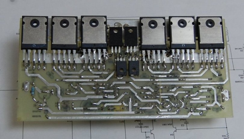

MJL21193 said:Is that for both channels? That would be tight!
137mm wide, 73mm deep:
Per channel - one on either side of the case (but without the fins exposed - this wouldn't have a very high WAF 😉
Your board shows me that it's doable 🙂

that amp looks like an electronic centipede.by Mjl - MJL21193 has attached this image:
Many legs...🙂
